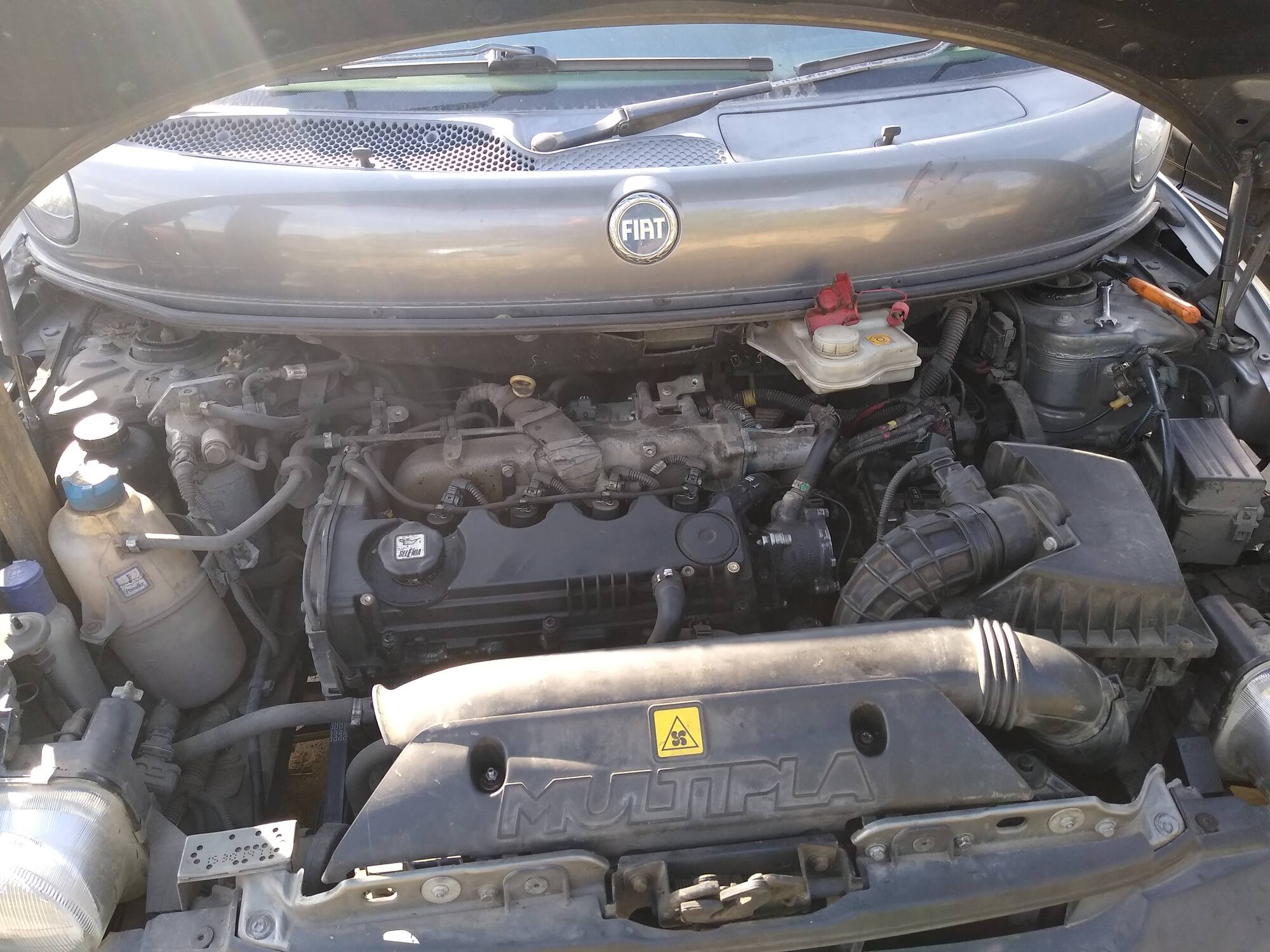

So after passing the MOT the clutch got so bad (biting point below the floor) that the Multipla was unusable.
After putting a fit sale thread up @shedenvy sent me a guide on changing the clutch. As a Peugeot 206 HDi is doing daily duties (65+mpg FTW) there is no rush so the of couple of hours are spent on it.
Started by removing the engine cover then battery tray, two hidden bolts tricky but not too bad. Then the slave cylinder came off.

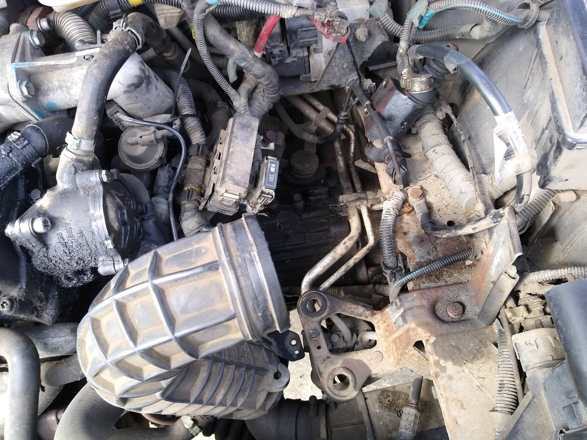

The started some of the engine to gearbox bolts. Then removed the rear support, two very tight 13 mm bolts. The second of which needed a rounded bolt removal socket and a fucking big bar. Had to wait for a new set at the Irwin one wouldn't fit without the other half of the set you have to buy separately. eBay provided the red box, as well as the blue box of Allen key end sockets for removing the nearside driveshaft which is where I stopped.

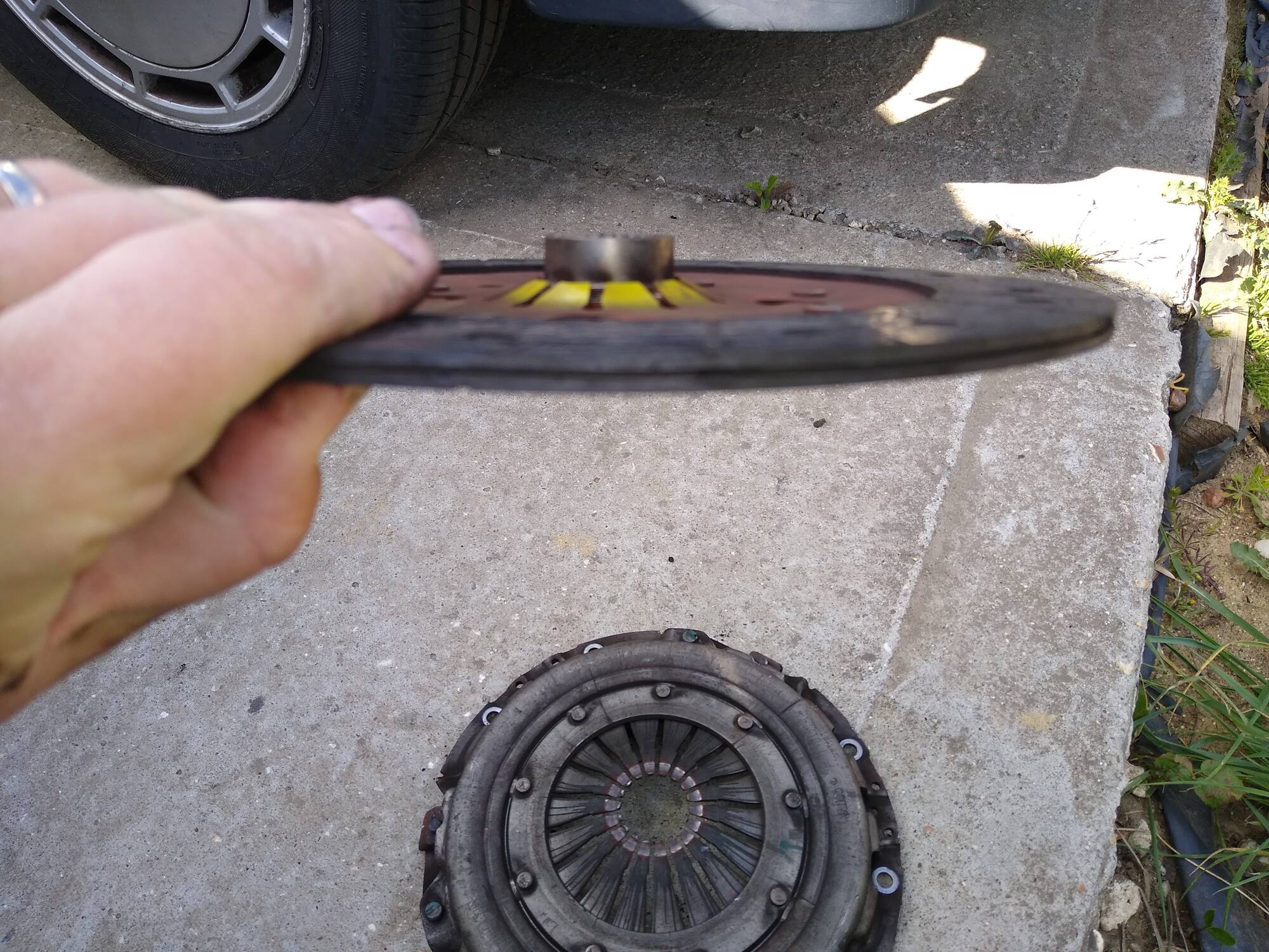

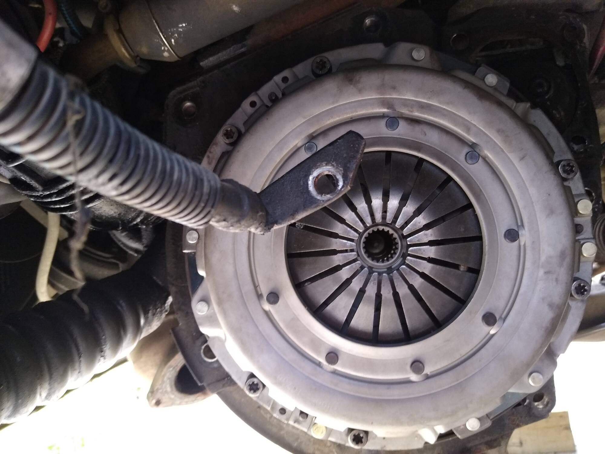

Had a spare ten minutes today. I've been waiting for some male Torx drive sockets to arrive in the post as I only had a female set.
Once they arrived the six bolts were removed and the clutch came off. Still waiting for the clutch alignment tool to arrive before I can put it back together. The DM Flywheel looks undamaged doesn't appear to be delaminating. At over £250 for a new one I'll take a gamble.
The fingers on the clutch cover (where the colour changes in the picture) are very worn, the Fiat forum suggests that may be the cause of the very low biting point if the grumbling release bearing isn't at fault.
What's the release bearing like? My worn one was only slightly gritty but made it impossible to change gear.
Also clutch alignment tools are for the prosperous. 1/2 inch extension with a bit of electrical tape wrapped around to take up the slack.
Check how much the flywheel can rotate - should be 1 oclock either direction max and with a little spring force.

The release bearing sounds the same, a bit gritty and noisy but less than I had thought it would be.
It would be a waste of the £7.49 if I didn't use it now ?
It does have a little movement then springs back, haven't measured it but it did seem like more than a degree, more like 5 probably.
They do seem to be getting harder to find, thanks again for the encouragement to get it fixed.
