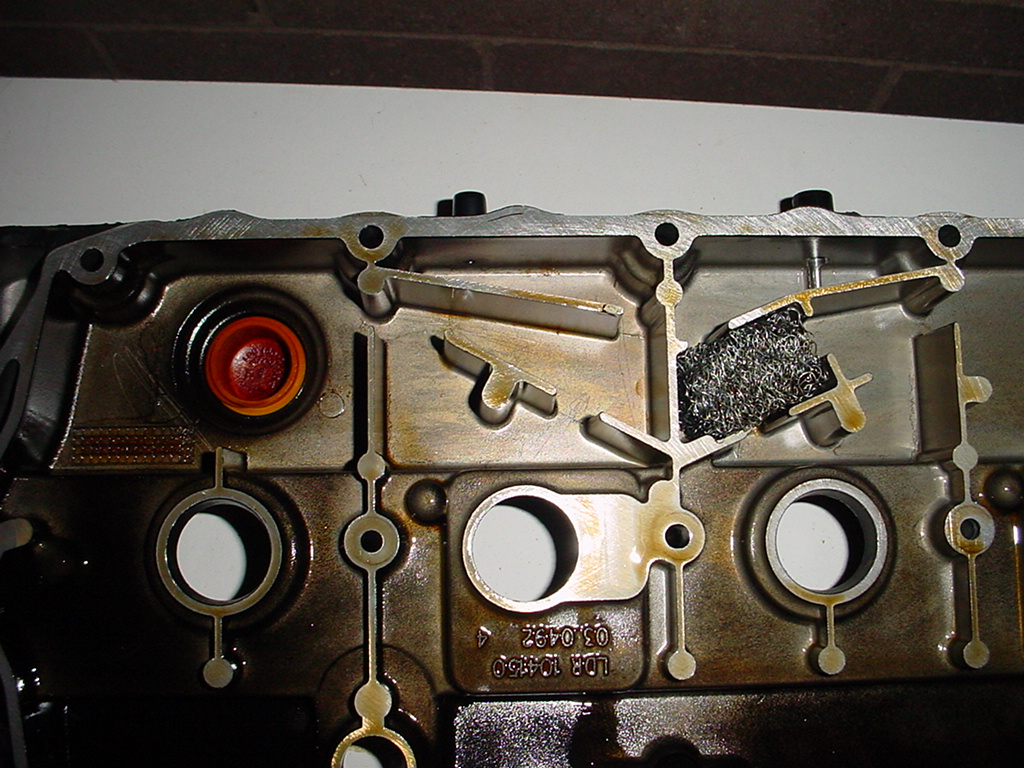

Barry Cade Posted April 5, 2014 Posted April 5, 2014 There are mesh "blocks" inside the cam cover where the pipes connect- these need to be clear,otherwise they can give the problems you describe-if you've had HGF or a lack of oil changes, they can block with crud/carbon and upset the whole caboodle. If you have a dent in your tank, and fuel starvation, is the tank vent clear? I've seen a tank crush like a coke can if the breather is blocked- usually the pump will get really noisy before the car falters as its working so hard to overcome the vaccum. Worth a look- run with the fuel cap off to see if it makes any difference. SambaS 1

saucedoctor Posted April 5, 2014 Posted April 5, 2014 Here's a page from my website showing the mesh filter blocks mentioned. There's also instructions on how to make your own heater resistor pack if the new one you got fails. I couldn't find an unfucked one either. http://class-ni.weebly.com/engineering.html
SambaS Posted April 5, 2014 Author Posted April 5, 2014 The S shaped breather breathes through the tiny hole and some wire mesh, the longer pipe through a bigger hole and same sort of mesh. The mesh looked so course to me I though it couldn't possibly have got blocked, so I didn't pay it any attention.

SambaS Posted April 5, 2014 Author Posted April 5, 2014 All the Rovers at the yard had HGF and these mesh things were in a right old mess. Also they all only had one on the big hole side. One of mine looked new so I put it on the side causing trouble. Now it runs fine with all breathers connected. I cleaned the other as best I could and put it on the side with the bigger hole. Took a tank off to but it's rusty so waste of time really. I'm deliberating whether it's worth putting on for the time being. Trouble being I had to destroy everything to get it off, obviously this isn't a choice on my car. But whatever happens I will need a brand new pair of petrol tank straps as the design is so shit they will not come off without being cut off. And for the giant pain in the arse this job is I think it's only really worth my time fitting a new one. With some additional paint, and some stone chip, then it will be good for a while. And not look like this ^^ after a few years. I can only conclude by 2004 MG R were skimping on quality because my tank has no rust on it, but this on a 2004 car is about paggered. saucedoctor 1
saucedoctor Posted April 5, 2014 Posted April 5, 2014 My engine only had one in it as well, and it was drawing oil into the TB from where the "missing" one wasn't, if that makes sense. I nabbed a couple from a 214 in the breakers and cleaned them up. Coffee jar+half pint of white spirit+shake well.Someone on MacDroitwich added the other mesh (can't remember who, soz) and it cleared up his smoky startup issues.The Project D®ive bulletins that I have don't show the deletion of one of the mesh filers, but I wouldn't be surprised if it was part of it. Or Powertrain are just slack bastards. scruff 1
