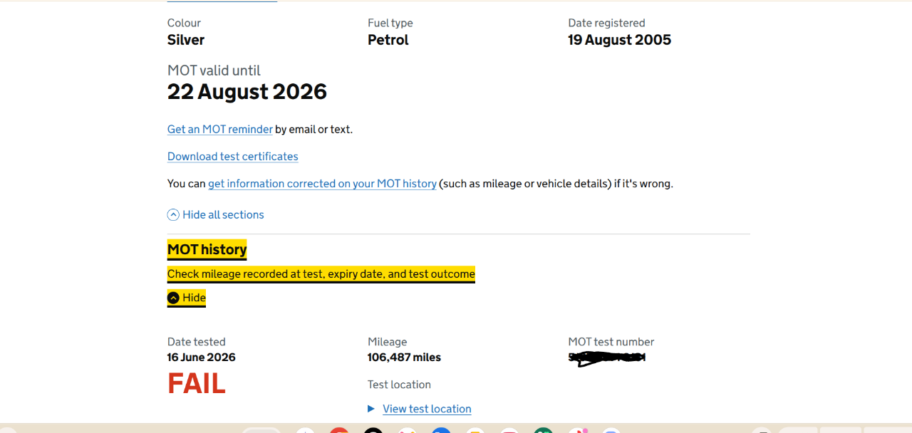

At we work we appeared to have gained a Saab 95 trade in, as Mrs MDH has a soft spot for these Sabdahooligan cars, I sent her a picture and she did what anyone with time to spare would do and immediately checked the MOT history!
When you go into it it shows as MOT until August but if you click on the history button,  you get a fail form the middle of last month and no re test?
I had assumed that any fail would void its current MOT no matter how long it had to run? Is this not the case or is there a glitch at VOSA?

It does still show as having a valid test on the system even if it fails, as long as the fail is within it still having a valid test, if that makes sense. I took my MG in for test on January 2nd, but the MOT for the previous year didn’t expire until January 27th, so despite failing it did show as still valid. I don’t know the legalities around driving a car that way. I’d assume not legal.
Nope. Not the case. It never has. Once it has 12 months MOT, it has it until it expires.
A fail in the middle won't void the MOT. That's why it's stated an MOT certificate isn't a guarantee of roadworthiness and it's up to the owner/operator to ensure it is at all times on the road.

the subject of "car still within 12 months of valid MOT pass but with a fail in the meantime" keeps popping up in various places.  Some people will absolutely swear that the vehicle cannot be driven, however as far as I can see the legislation states no such thing, only that the vehicle has to have a valid MOT test certificate.
I suspect the main issue has come about with computerised MOT testing, as it essentially means that someone has told you the car is not roadworthy, and it's there for the world to see.  It has ALWAYS been true that a vehicle has to be maintained at a minimum standard, and if anything falls below that standard, then the car isn't technically roadworthy.  The difference is that before 2005, you could get another MOT test, fail it badly, but not tell anyone and it wasn't an issue.  Now, it's highly visible that your vehicle is rotten/broken/whatever.
After all, the vehicle would have still been just as rotten/broken/dangerous/etc. for the previous day/week/month before you did the second MOT test, but not visible.  Now it's visible.

Lets imagine you decide to MOT your car with 6 months remaining on the old MOT and it fails. It's Saturday morning and the MOT garage can't do a retest until Monday.
But on Sunday you are heading to the airport for a few weeks in the sun.
Something as serious as a tyre.
Saturday afternoon. You buy that tyre.
Car is now safe, and you still have a valid MOT, so you can drive to the airport.
On your return you go to get a retest, and they want to charge you, because you took it away and its been too long and they don't like you.
Unfortunately all your money was spent on holiday. No matter. Legally your car has 5 and a bit months of MOT remaining.
Obviously if you get stopped by the police for driving like a dick they will check all the failure points and advisories as they are easy to see.  But legally its all good.
