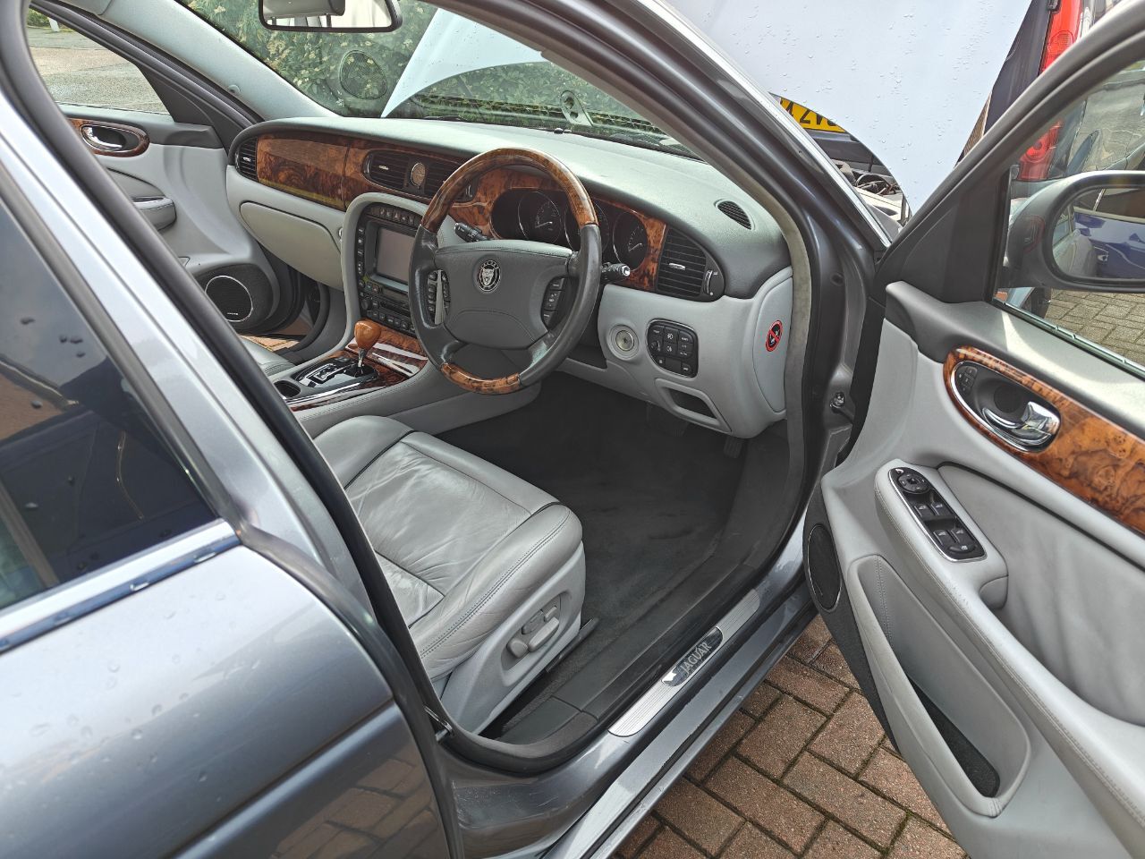

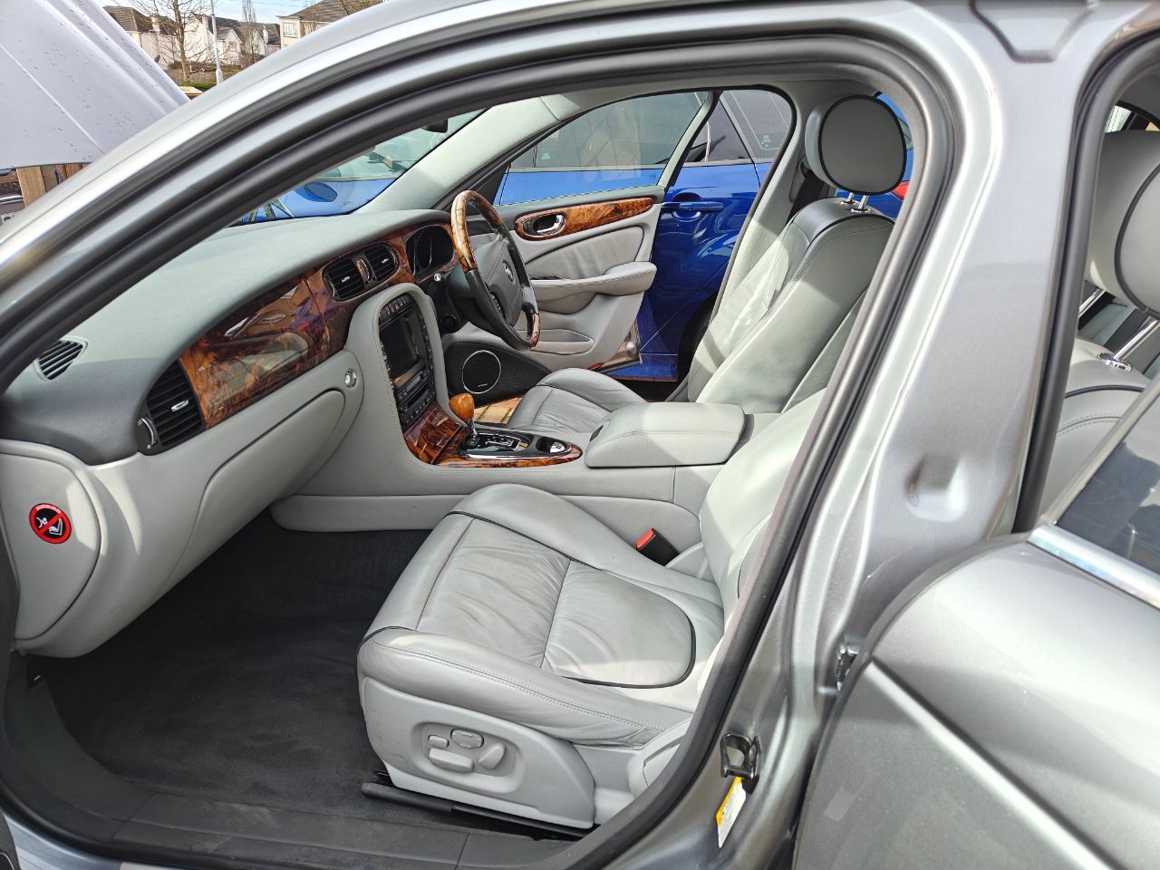

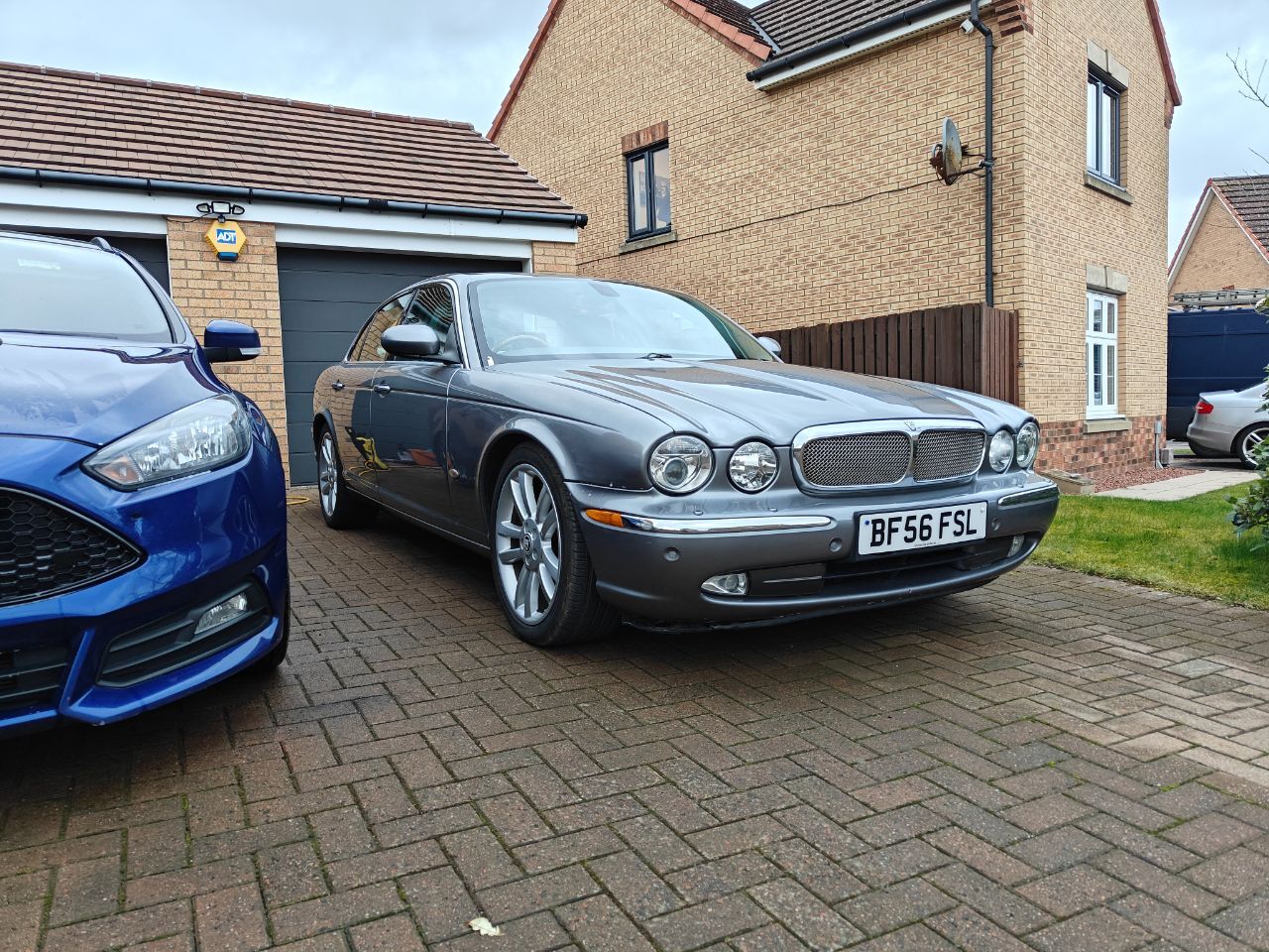

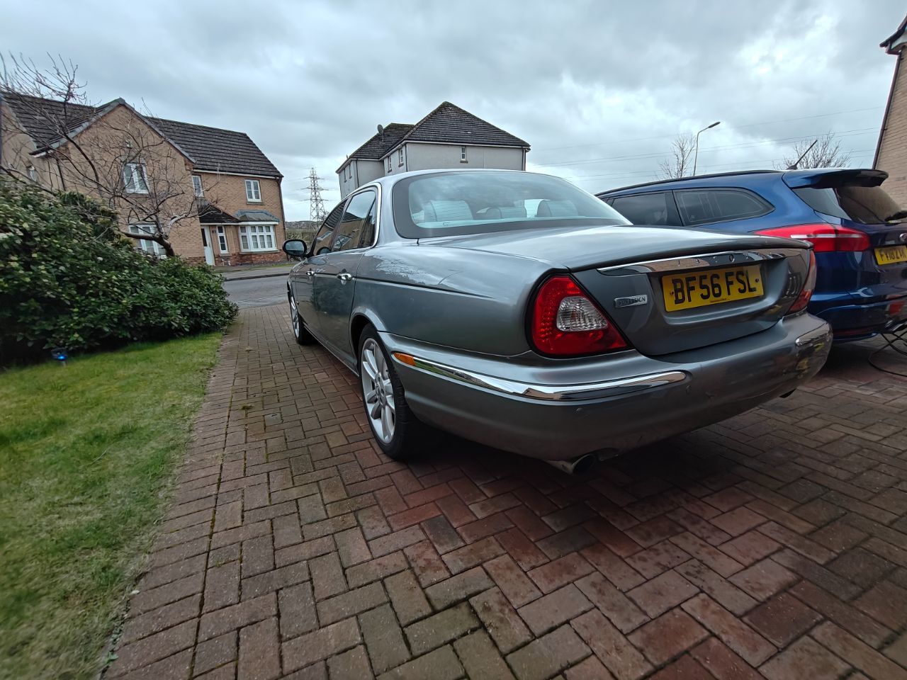

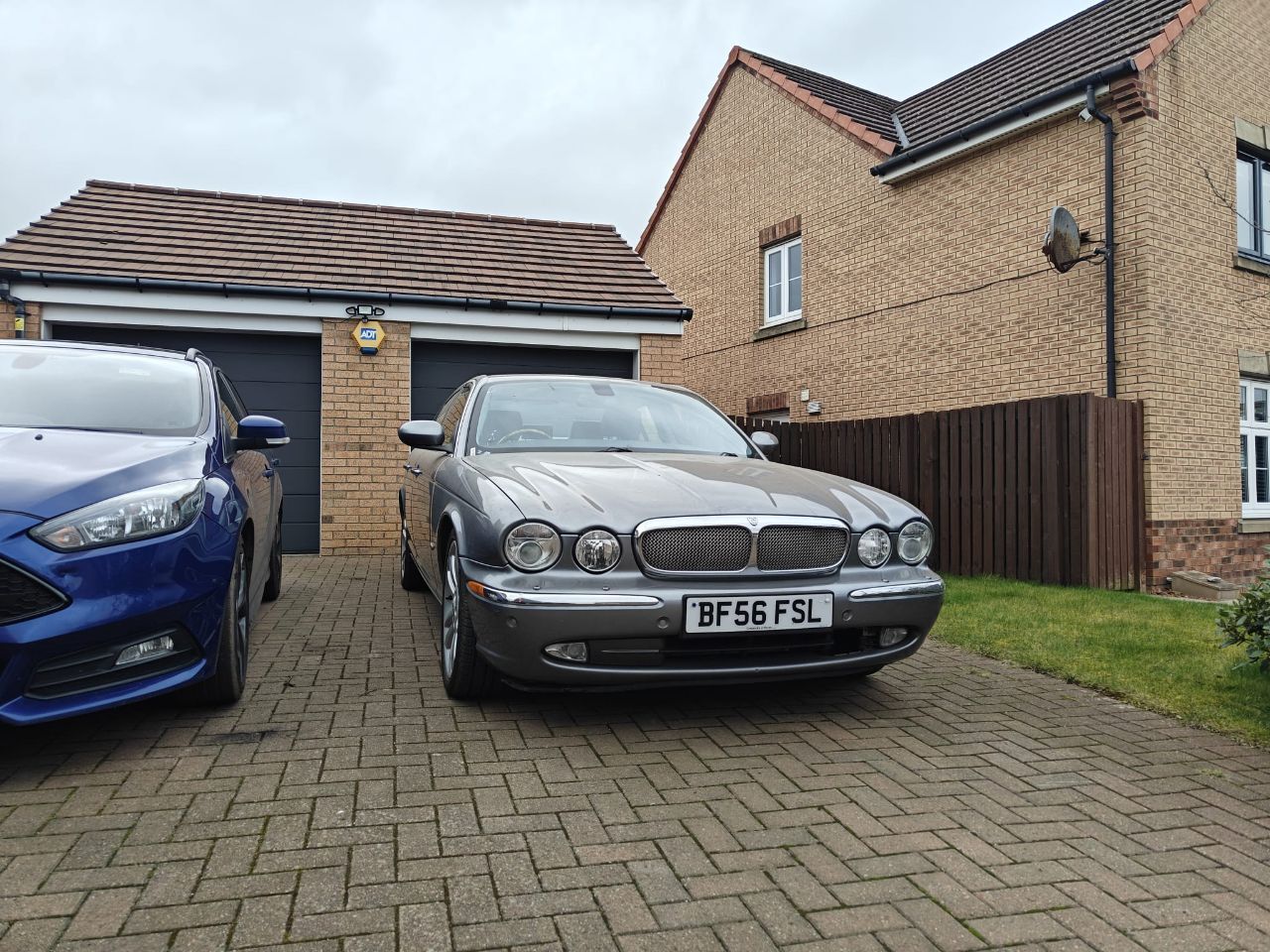

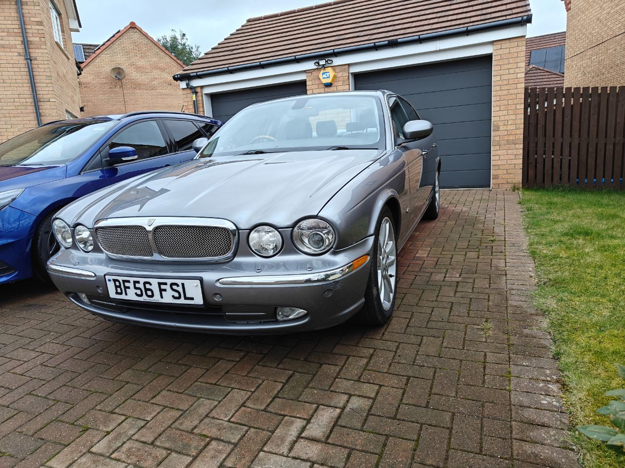

Popular Post dome Posted March 11 Popular Post Posted March 11 To understand the thread title click here. A week off a year since I bought the same thing but in German flavour. This time I didn't go looking for a Jag, in fact I had been sniffing about Peugeot 107s, 3008s and generally anything local, cheap and broken with the potential to give me a a wee project(Yes, I know I have other projects, who are you, my wife?) to fettle and sell on. Mission creep set in and on Sunday I went to look at a barn find RX8 that was actually in a barn. Owned by the lads uncle who had passed away he had been tasked with selling it after it had sat for a long time. Here's the view I was greeted with as I entered the barn. There may* be a slight spoiler alert in this pic. The chap definitely had a bit of a thing for cars though with stuff ranging from an MGB to a Bentley Continental GT via several JLR products, some of which even worked. Much chat about his collection eventually led me to look underneath the RX8 (crusty, surprisingly), politely decline it and then talk Jag. Here it is Despite having sat for months it fired straight up and idled happily with no warning lights. The only thing I noticed was a slightly noisy power steering pump. It's a 3 litre petrol Sovereign and the guy bought blind it for commuting assuming it was a diesel and not realizing it was a petrol. Now at this point we were just chatting shit about cars and while that may sound like bullshit the newer X351 Diesel he had bought to replace it was sitting outside... And remember the Bentley Continental and various other things sitting about. It was crazy enough to be true... The MOT on this had lapsed and a non working horn had stopped plans for getting it in for a test. The undertray bolts had all seized and prevented him getting access and with too many other cars it had just sat in the naughty corner. We can all guess what happened next... Ready for collection And after an uneventful 20 mile trip down the motorway it was home. It needs a bloody good clean, the horn fixed and then sent in for an MOT to see what the results are. I have the book pack but no service history annoyingly, I may try and see if Jaguar have any records of it. It looks like it has been loved at some point in the past though. I've had no time to do anything but stick the battery on to boil and check the tyre pressures. Stay tuned! Westbay, The Moog, BritChod and 52 others 51 4

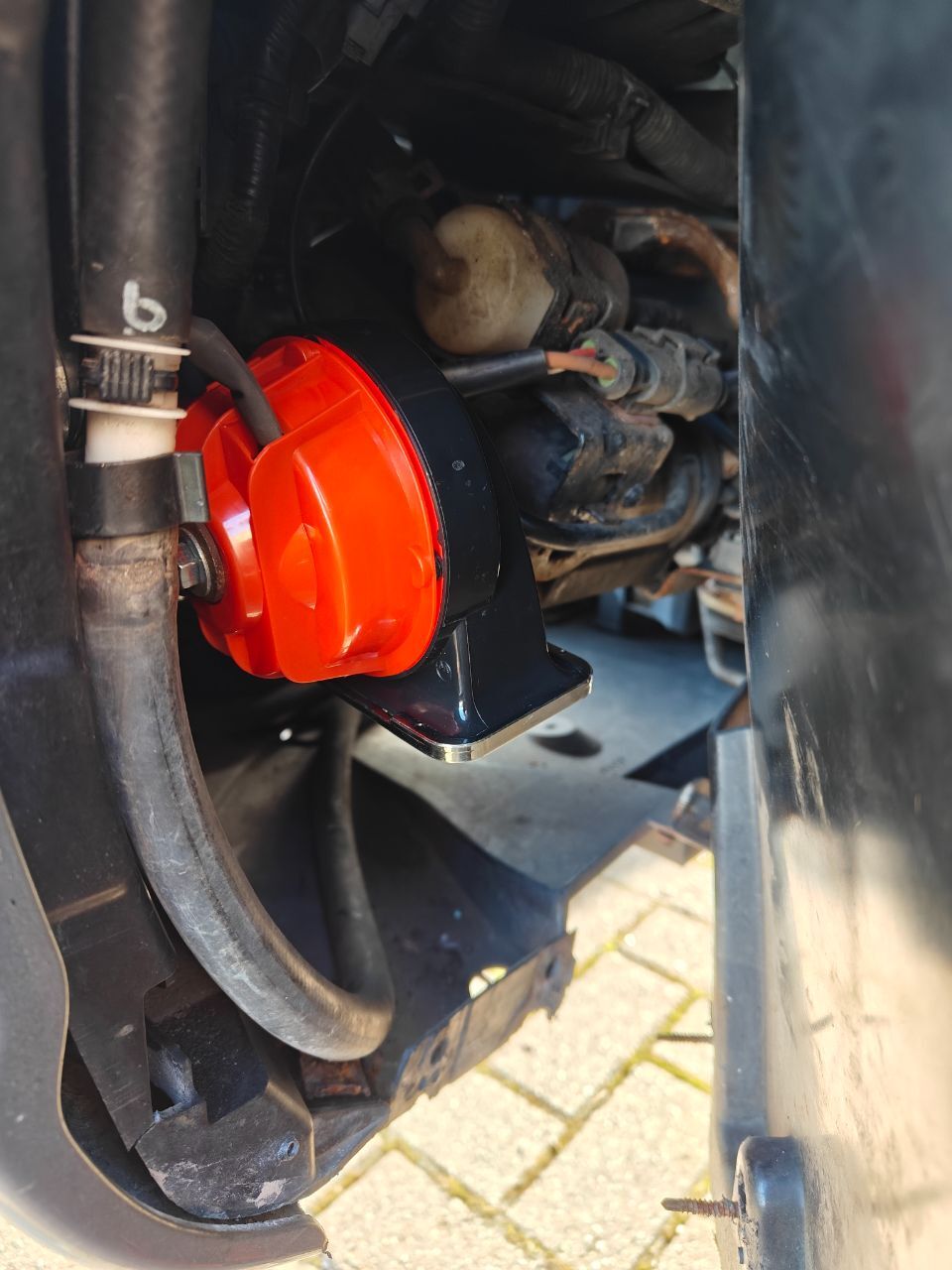

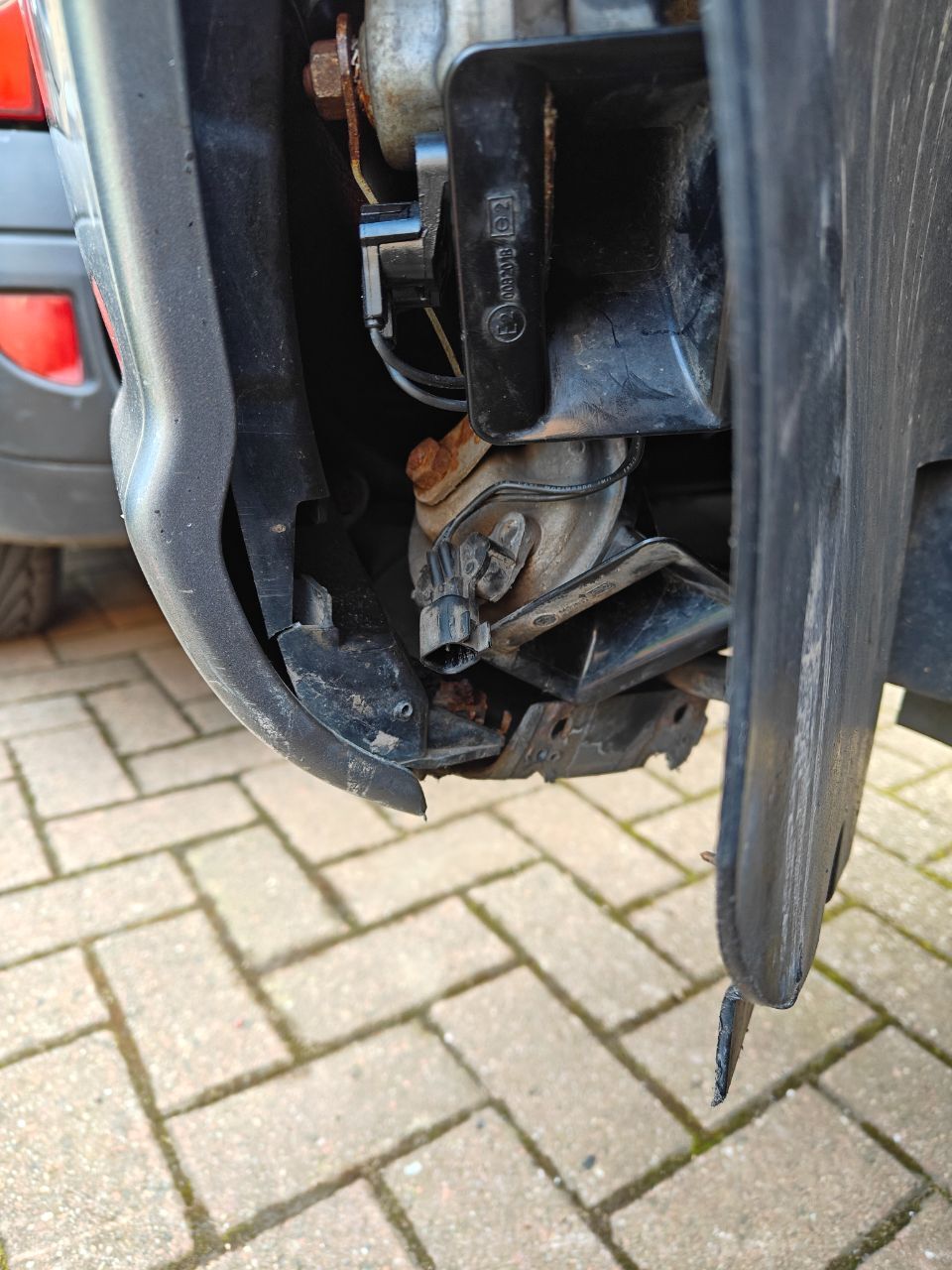

dome Posted March 11 Author Posted March 11 I set off today to see if the horn problem was as simple as it seemed. Turned out it was Old horn, in front of the passenger side arch. Interestingly he had been trying to get in to the drivers side arch, I suspect from reading US forum threads where the driver sits on the wrong side... Old horns tested as dead so a trip to Halfords later and... And now... https://youtube.com/shorts/B8c2xXlCrpc?si=GlmMEKXtAIyjet3o Sorted. I then gave it a quick clean. MOT booked for Monday, will get it hoovered out before then and check it over but plan is to do no more til the man from the ministry has given it a prod. Lord Sterling, mercedade, N Dentressangle and 29 others 32
N Dentressangle Posted March 11 Posted March 11 Looks great, and no-one's stuck a nasty leaper on the bonnet either! dome and chaseracer 1 1
Lord Sterling Posted March 11 Posted March 11 Very nice. 3.0 petrol too, sl the 6-pot. I suspect you have the same engine and dare I say, the same spec as my S-Type? I have the SatNav screen and push-button handbrake. BF-indicates it was first reg'd in Birmingham. dome 1
dome Posted March 11 Author Posted March 11 54 minutes ago, Lord Sterling said: Very nice. 3.0 petrol too, sl the 6-pot. I suspect you have the same engine and dare I say, the same spec as my S-Type? I have the SatNav screen and push-button handbrake BF-indicates it was first reg'd in Birmingham. Yep, it's the same 3 litre Duratec as my old S type too. And yeah, it does have the touch screen and push button handbrake(which hopefully works 😳). All pretty standard Sovereign stuff I think? The display feels a bit dated but no more so than my 2006 730d Lord Sterling 1
Spiny Norman Posted March 12 Posted March 12 Nice. The V8 is probably more fun but the 6 pot is all you need in a Superleggera ally Jaaag. GLWTMOT. dome 1

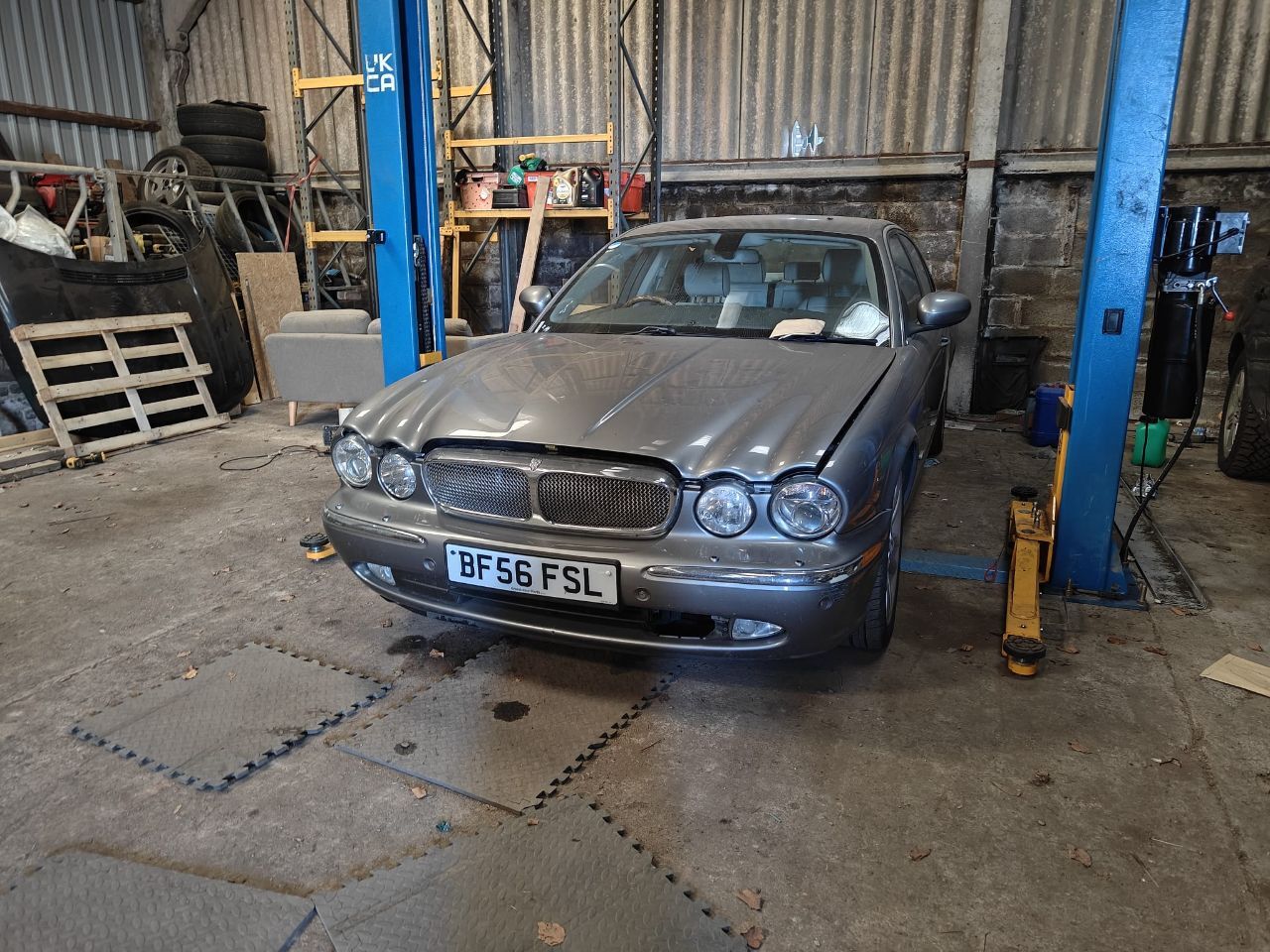

dome Posted March 12 Author Posted March 12 5 minutes ago, cort16 said: Aloominum It's nice when using the trolley jack that the car goes up at the same speed as the sills. I'm not used to this on a Jag PicantoJon, cort1977, Spiny Norman and 12 others 2 13

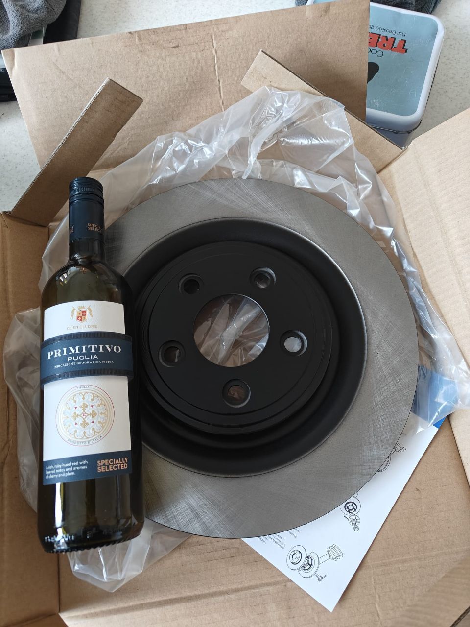

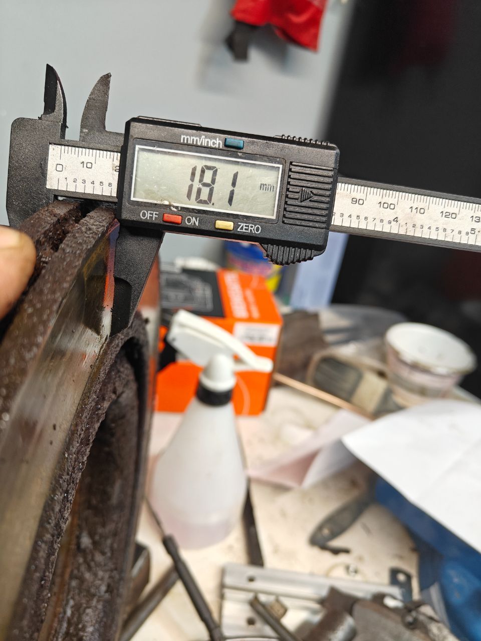

dome Posted March 13 Author Posted March 13 Discs and pads for the rear arrived today. NAPA branded so not the best but hopefully not the worst. £44 for a set of 326mm discs and pads is ridiculous-I guess they are shared with a load of other cars? Bottle of wine for scale. Was not influential in the car purchase, honest. Will fit them after the MOT as everything seems to work back there for now, there's just a fair old lip on the discs. Also if it's a really bad fail I can send them back😶 yes oui si, Dave_Q, Split_Pin and 1 other 3 1
robt100 Posted March 13 Posted March 13 £44 is a bargain, and as far as I know, early XJRs dont share their discs with anything, and possibly the calipers are only shared with the Ferrari 360 (or so Ive been told). I need to change mine at some point, been looking at M-Tec stuff though first I need to get the soft pedal fixed, reckon ive got air in the ABS pump system causing it. Sounds like youre making decent progress though! dome 1

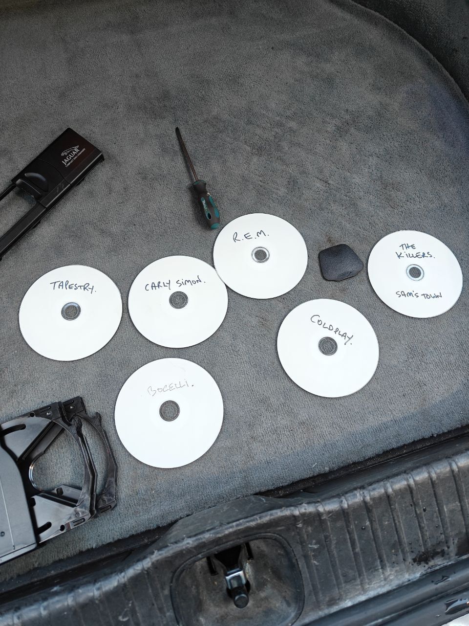

dome Posted March 15 Author Posted March 15 The car that keeps on giving. The bounty from cleaning the interior Kit Kat is still in date 👌 And the cd changer didn't want to play anything or eject the cartridge. I persuaded it by taking the faceplate off and finagling it and it now seems to work. The Coldplay CD is in the bin along with the vape and I'd love to say I kept the Bocelli one too but that'd be a lie. djim, flat4alfa, lesapandre and 5 others 2 4 2

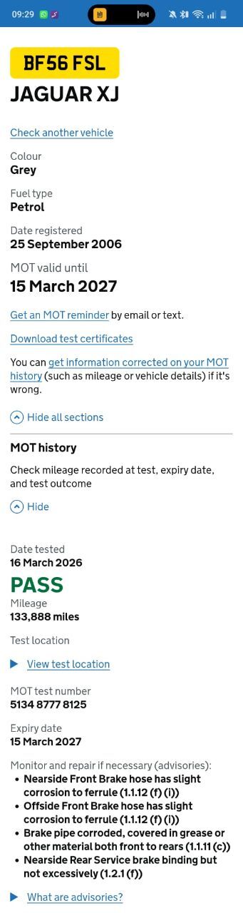

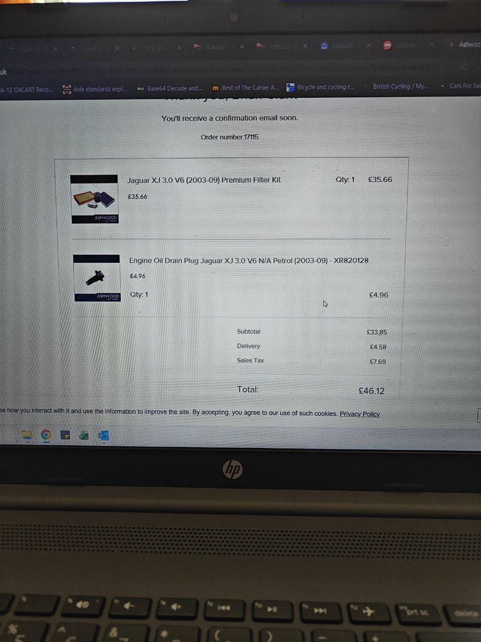

dome Posted March 16 Author Posted March 16 I dropped it off this morning and got a phone call about 20 minutes ago... Whew! I kinda hoped it'd be OK as the history is good and it drove well. Will clean up the brake lines, change the rear discs and pads and give it a service. Order placed for service bits from Ashwood Jaguar, they promise it'll be decent quality parts like Mahle, Bosch etc so we'll see... Marina door handles, mk2_craig, Pieman and 21 others 17 7
robt100 Posted March 16 Posted March 16 Not sure about on the 6 (though id assume its the same) but on the XJR I know all the front hardlines are NLA, and have a lot of bends/curves. Might be worth finding a friendly/skilled garage who are happy to make new ones when needed. Think the rear set are still availble from Jag for about £50. dome 1

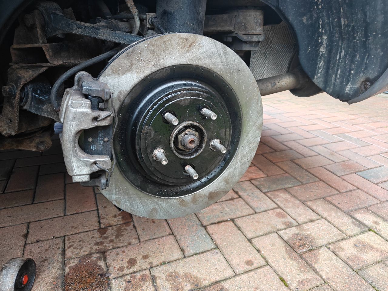

dome Posted March 16 Author Posted March 16 I finished work early so went out and changed the rear discs and pads. Wasn't too bad although one caliper (funnily enough the one with the advisory) was tight to wind back. I think a new one might be needed at some point but will see how it goes. Back together and pumped the brake multiple times, then pulled on the electric handbrake and it sorted itself out with no errors and a strong feeling handbrake. Old discs were fucked. Minimum thickness should be 18mm and new they're 20mm. I couldn't measure these properly because of the lip but I'd say they were around 16mm. Funnily enough the vibration I'd noticed on the way home has gone 🫣 cbowditch, DVee8, Low ontime and 9 others 12
