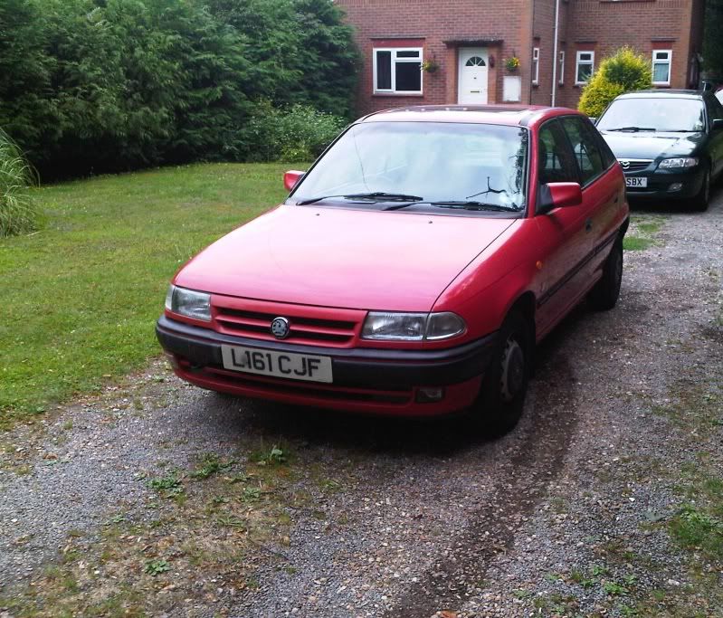

greengartside Posted August 1, 2010 Posted August 1, 2010 There is such a thing as having no luck. All this weekend I have been let down and f**ked up by people. First it was the Saxo and 'that' Astra. I sucessfully sold the Ka this morning and that's off to Essex with her new owner, so it was finally time to put the 1.8 Fiesta into action. Off I trot to the garage to fill up with jungle juice, 20 quid of Esso's finest. Pull out of the garage and the fuel pump says bye-bye no amount of cranking would make her fire so a hastily-arranged tow home was in order. So now I'm carless (or carlos for the Spanish viewers) - 'that' Astra seemed a bit more of a necessity. So I bought it. And here she is, in all her shite glory. Flame Pink FTW! Does this qualify for being shite enough? It's a 1.8 16v Cesaro so it's got a few toys with it, which is nice. The idle is not good, it screams it's bollox off at 2k RPM unless I unplug the electrical plug to the ICV. Does that mean the ICV is knackered? I have noticed the temp gauge barely goes past cold which could mean thermo sensor??? Clutch is ok, doesn't seem to slip - just really high. Full year's motty and tax until end of August. ...mine for £350. Not bad I think. Now pressed into immediate use as I have work in the morning. Fingers crossed it's a good'un. Seems to be that way.
red5 Posted August 1, 2010 Posted August 1, 2010 More likely the thermostat I suspect. Does it have the small black ICV? If so just unscrew it and clean it - pref with carb cleaner/equivalent. Looks like the wheels are off a plod spec motor !
greengartside Posted August 1, 2010 Author Posted August 1, 2010 I'm not sure, it's got the long silver ICV which I have took off and cleaned up. Was gunky and it's had a replacement gasket but was airtight. Will check thermostat though cheers Wheels are off a Combo van! The guy who had it swapped them for the original alloys off the Astra
red5 Posted August 1, 2010 Posted August 1, 2010 Ah ok, the Bosch type. Does it have a 'x' on the end plate?. And clean it, then soak the inside in clean brake fluid, then wash it out again. if it's still random after that it really is tatered !

greengartside Posted August 2, 2010 Author Posted August 2, 2010 Just thought I'd give everyone a quick update on the Astrashite... ...I have fixed the dodgy temp gauge, was the little gauge sender unit - new one for £8 sees the gauge point between 90 and 100 when hot and a smidge over 90 when driving. Clutch issue has been sorted too. I adjusted it! Luckily it's a manual screw-adjustment on the gearbox end so I just screwed it out until the clutch pedal matched the height of the brake pedal and now it feels 100% better to drive. It drives wonderfully, no nasty clonks or rattles from anywhere - just that bloody idle speed thing to sort out. I'm going to buy* another ICV from the scrappys and see if that cures it, will change the little paper gasket that sits between the ICV and throttle body too while I'm at it. *steal. Oh and I would like to change the awful CAR 200 tape player that's in it, so am on the lookout for a decent CD player to LISTEN 2 MA DUBSTEP REEL LOUD INIT N ANNOY DE PPL OF STH NRFLK.
Station Posted August 2, 2010 Posted August 2, 2010 You could have an air leak if it's idling badly. Check the black hose that goes from the inlet to the brake servo, it should have a 'nub' on the middle with another 'straw' pipe going into the bulkhead - this goes to the 'air recirculation' button on the dashboard (the flaps are powered by vacuum from inlet). These break off and cause idle problems. Just listen out for wheezes/whistling when you rev. Use carb cleaner on your ICV anyway, cap both ends with fingers and slush it around, do it until no black comes out, and then spray some lube in there.
