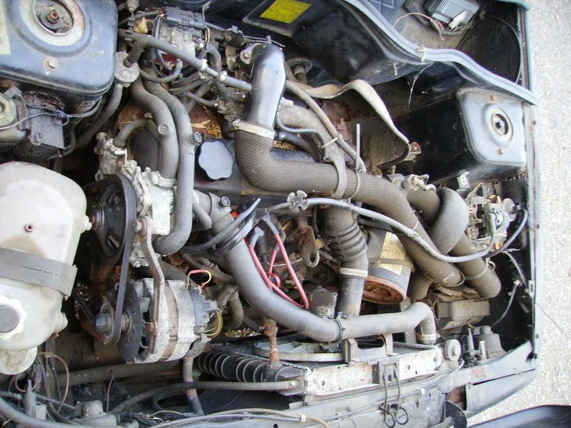

Well it now goes - no idea what was wrong with it. I fiddled and faddled all day yesterday and couldn't get the pissing thing to go, and I veentually got cheesed off with it, put the jump leads across from the Mondeo,and sat there with the choke full out and accelerator to the floor cranking it and cranking it and eventually it fired up - on two cylinders - and then gradually worked its way up to three and eventually four. It's still leaking fuel like an arse from a rusty fuel line under the car, but at least it's alive now. It very narrowly avoided having a match chucked in its tank at one stage, but hopefully it'll be all uphill from here...
Blimey....Is it supposed to look like that under the bonnet? :shock:
What're Your plans for it Wuvvum? Is it M.O.Table? :?:
I hope You get it on the road, but if it SHOULD end up being a lost cause, I can think of a good home for those alloys! :wink:
  Baz said:
Blimey....Is it supposed to look like that under the bonnet? :shock: What're Your plans for it Wuvvum? Is it M.O.Table? :?:
I think it's supposed to look like that. It all looks fairly standard factory issue stuff under there. Apparently it's had the boost turned up a bit and a couple of other minor mods, but nothing drastic. I think it's MoTable - it'll probably need a bit of welding on the sills, and a couple of tyres, but it's had a lot of work done to it before it came off the road (new brake discs etc) so it shouldn't be too bad. I've got all the lights working now apart from the front fogs, but they're not an MoT point anyway. Central locking and electric windows work, and the trip computer seems to do something, but I have no idea how to work it. One of the biggest arses is that it's going to need a pair of wiper blades - they seem to be a different shape to standard ones so my usual pound shop jobbies won't fit, and the wiper arm itself is too fat to take the clip from a standard wiper blade. Is your 11 the same? I suspect an expensive set of unique-fit Bosch blades from Halfords might be the only way to go. Oh, and I've got to find a way of fixing the fuel leak - the Leak Fix putty I bought has slowed it down but because it's being pumped through under pressure it's still finding a way through the gaps. I suspect I'll have to hacksaw out the damaged section and replace it with a length of rubber fuel line. Oh yeah, and the radiator fan is seized so needs freeing off or replacing. And then maybe, FINALLY, I'll be able to drive the pissing thing down the road...
Is that a 5 Turbo engine in there? It looks great, worth persisting with.
yeh - that is pretty fooking nice, be great to surprise a few saxo drivers with it..
Mega! I want one! I'm quite fancying buying another R9 / R11 after seeing this, and quietly kicking myself for selling my R11 Electronic with fully talking bits so cheap!
Great car! Look after it.Much prefer the R9 to the R11, not so keen on the R11 front end but appreciate the R11 double headlights are necessary on the R9 Turbo to give it a more impressive look.Infact I prefer the R9 to the 11 from all angles.What you've got there is technically the successor to my 14 - shame there was no R14 turbo though! :o
