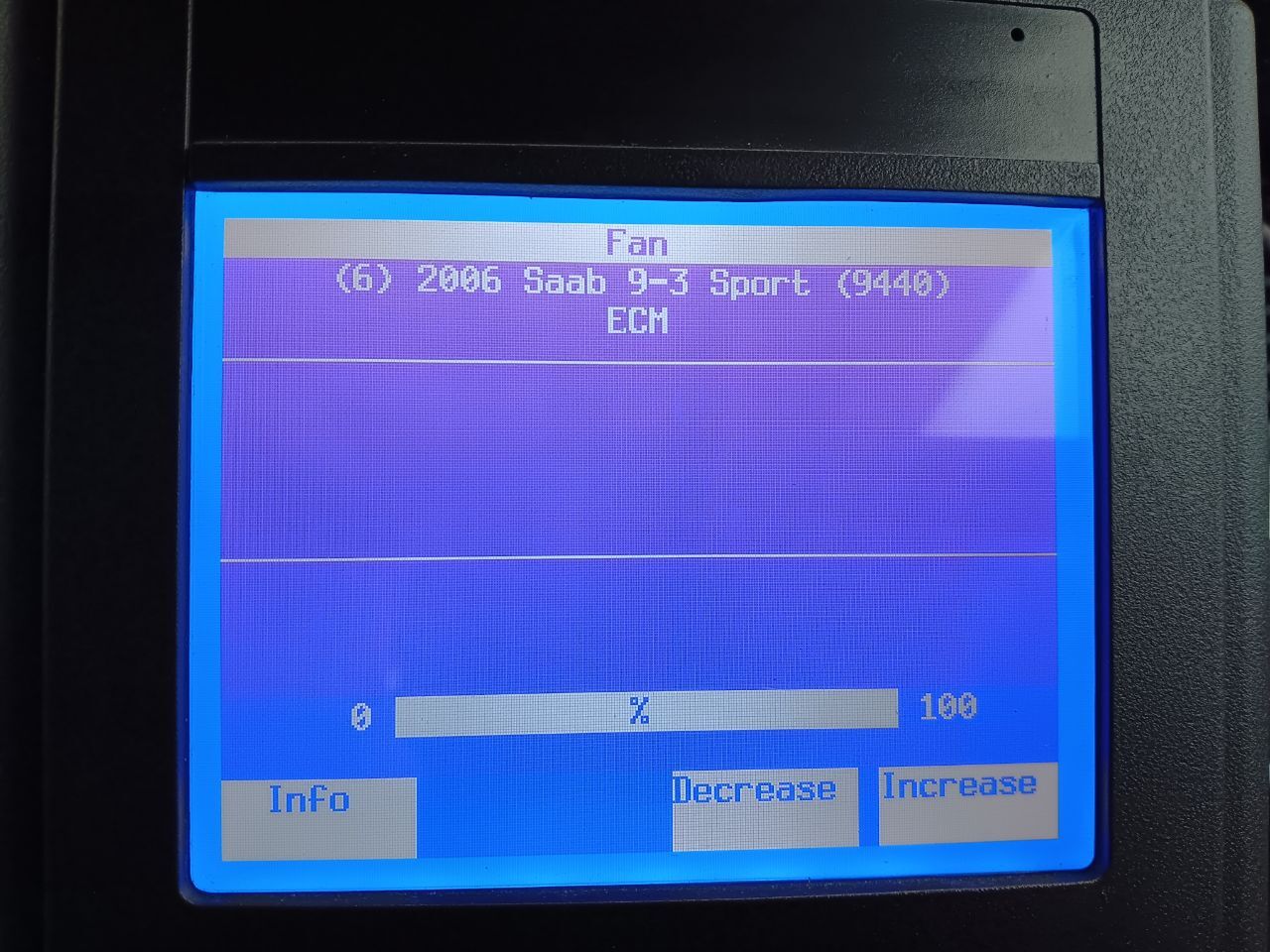

I had another go on the Tech2 today. No codes for the roof, great*. I still think its the tonneau cover.
Anyway, this code came back after clearing it last time:
I tested them and it appears to have 2 speeds.
Fan seems to work OK then, not sure what the code is about.
Intermittent code for a open circuit would suggest more likely a wiring or connector break rather than a fan unit fault. If no EML and intermittent, I'd probably monitor and repair only when persistent.
I'll need to look on WIS for the wiring diagram and go from there.  Given its age and GM heritage* I'm fairly certain this one will work via a module rather than a switch and if these die the fan roars away all the time, so that's something.
Yeah a quick Google suggests it goes through a combined relay module. Some online have had theirs fail. Given this age GM, it's probably cracked solder joints in the module or something like that.
Looks like someone has uploaded the WIS online too. Handy.
https://saabwisonline.com/9-3-9440/2007/2-engine/4-cyl-petrol-e85/cooling-system/wiring-diagram/radiator-fan-system-b207-two-fans
