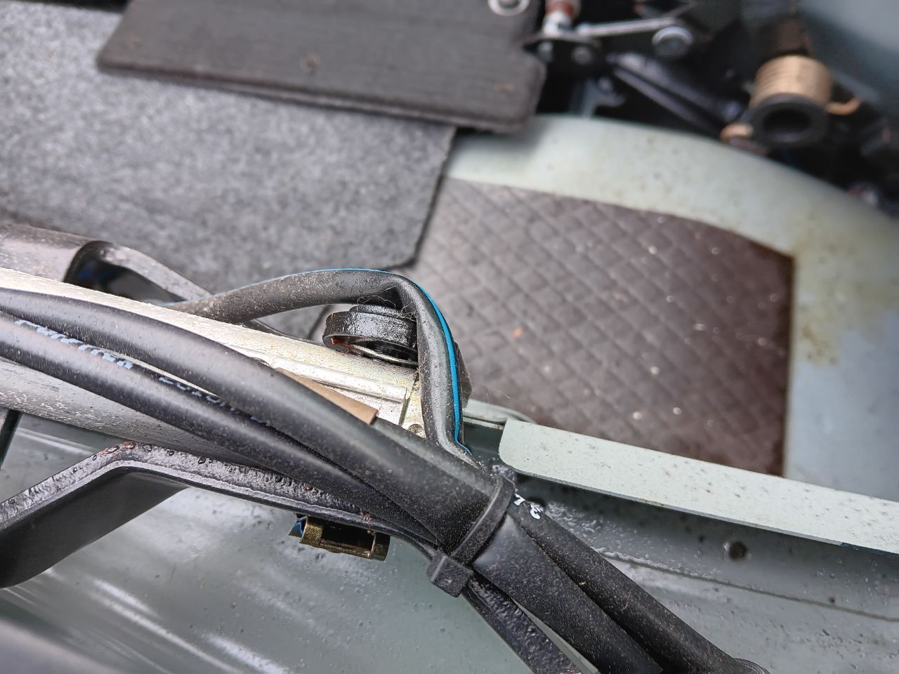

Took a look at the fan wiring, very short route and simple. All looks fine except I cant inspect a part of it that sits on top of the chassis leg as there's no room to see underneath the loom there. Can't think why that bit would move anyway. Fan loom uses the rear ground, all looks spotless.

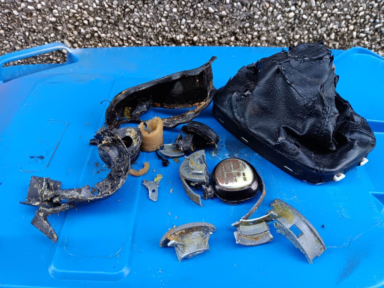

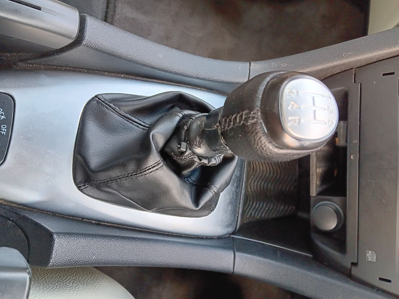

I was tired of the tatty gear gaiter on the 93 so changed it out. Of course, it came out perfectly easily and wasn't* made almost entirely of aluminium.
After an initial inability to get gears because I put something back the wrong way around we were all good to go.

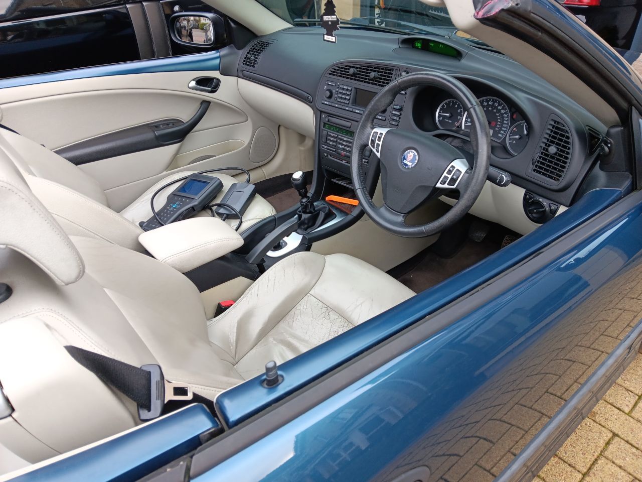

I found a reset procedure for the roof on Tech 2 which involved opening it manually but leaving the deck lid fully open. I then used Tech 2 to close it again and hey presto Ive only bloody got a working roof now!! I actually think I could have closed the roof just with the button but its fixed, for free!

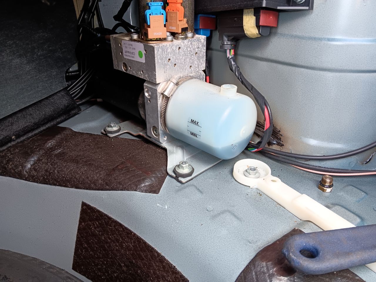

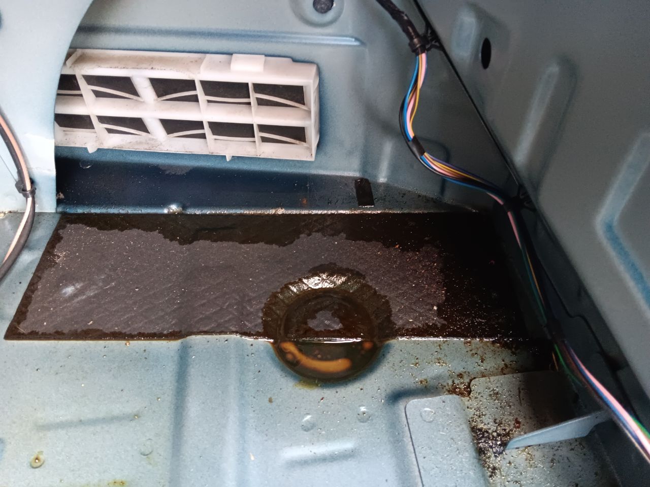

Got a new roof ram from Ron Saab Leeds (go to guy as well as Bill at Saabits) and set about replacing.
Old one was a doddle to take off:
2 lines, a sensor and 2 clips.
Boot was awash with CHF!

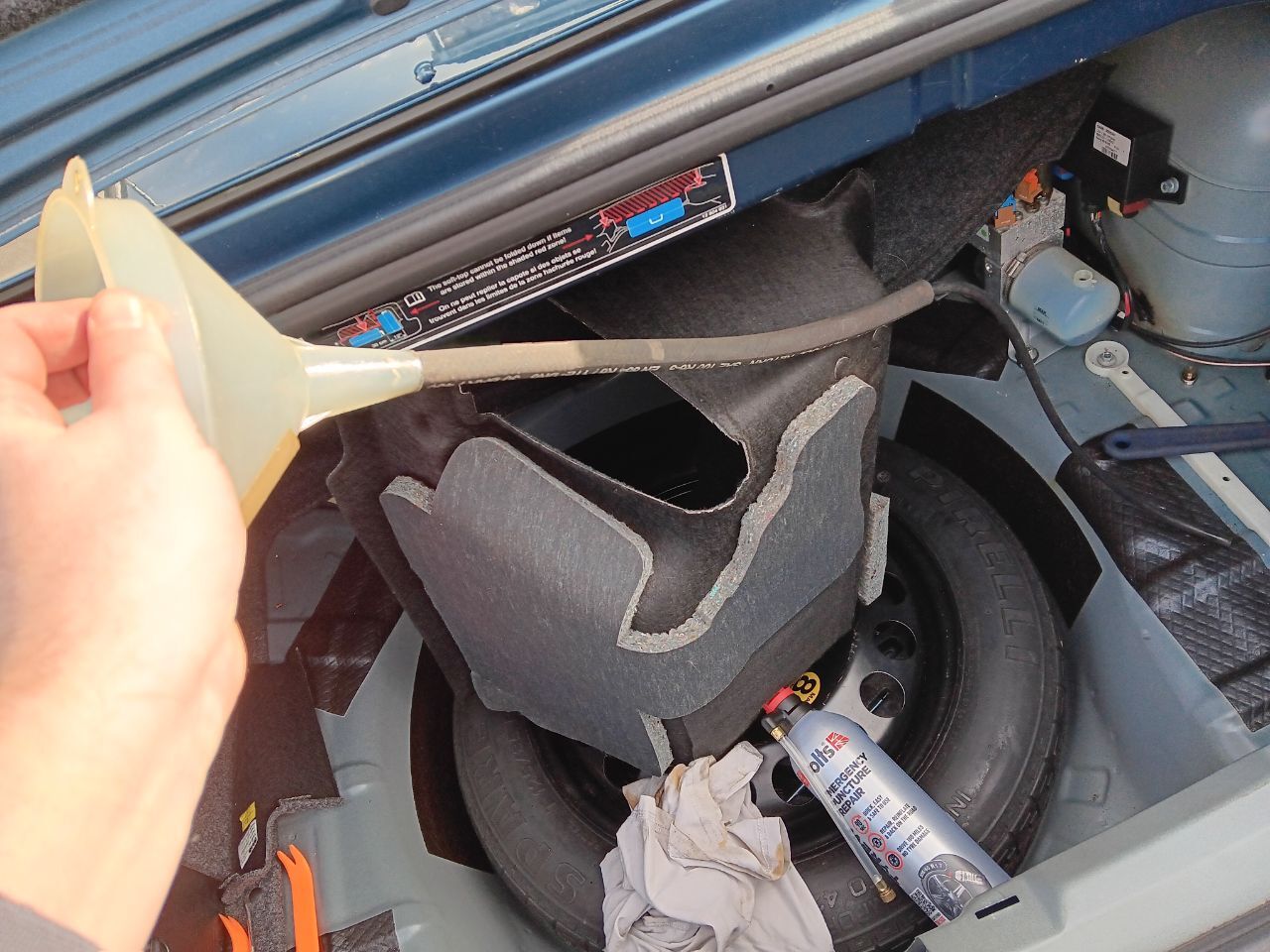

Level was expectedly low:20260307_150806.jpg.19e6261a22e9b30297efbbc0de2e13f3.jpg
Topped up using an adapted funnel and some hose.20260307_150824.jpg.5fae58bcf222c17ce5e53ad97bc4f00f.jpg
Test and OK, hopefully no more leaks for now!
Bonus rust proofing of the boot floor too!

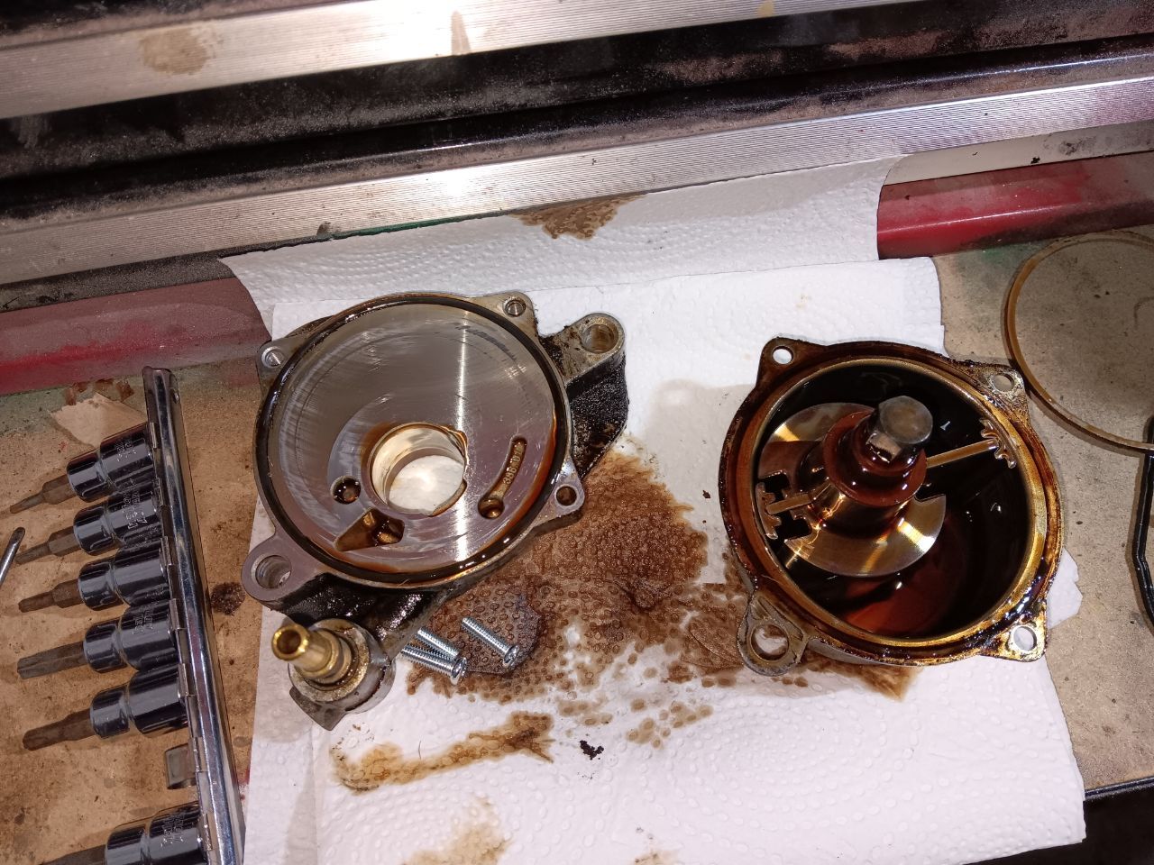

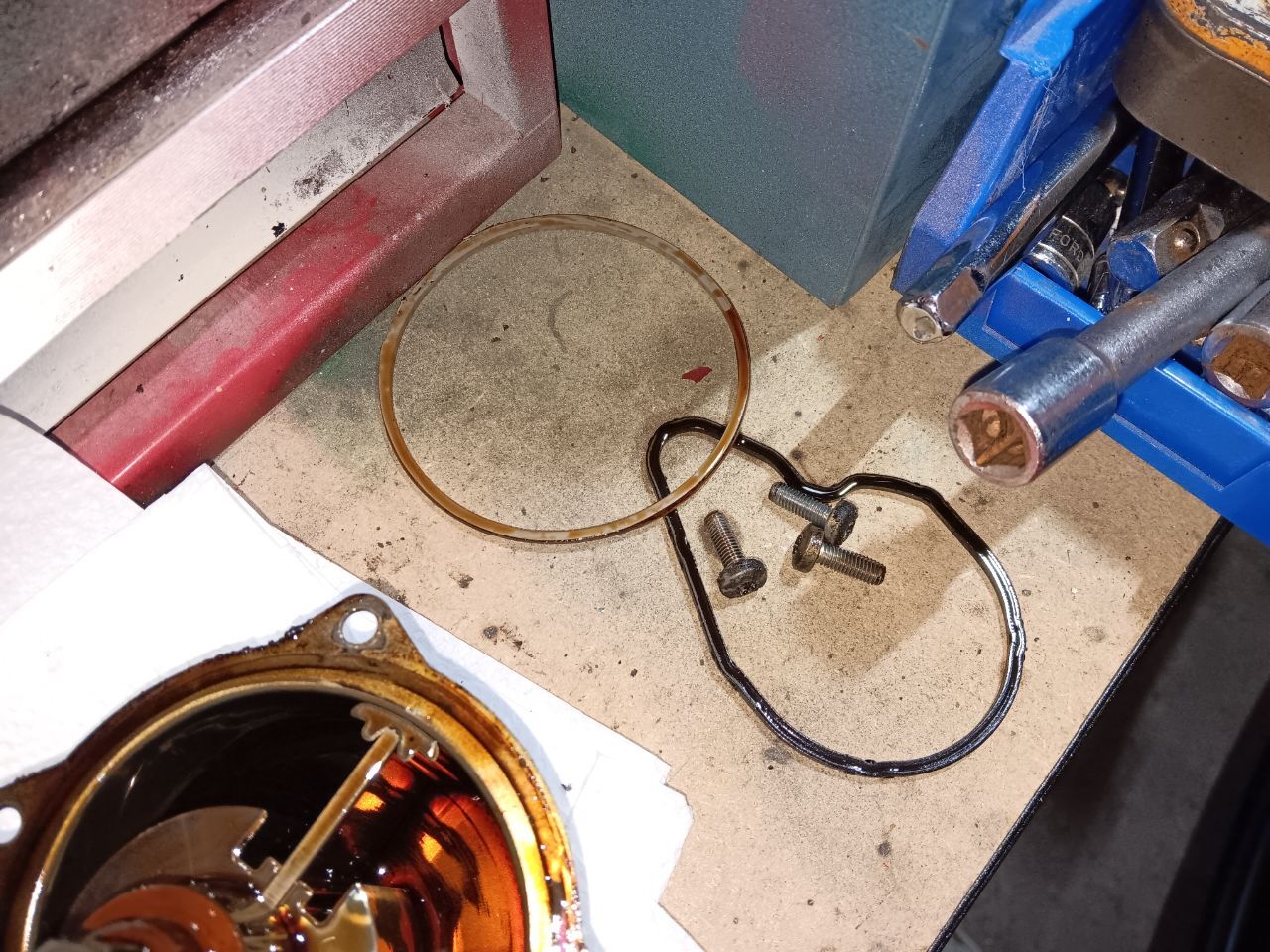

I wanted to Noobtune the current 9-3 however Karl that does them is on holiday just now.

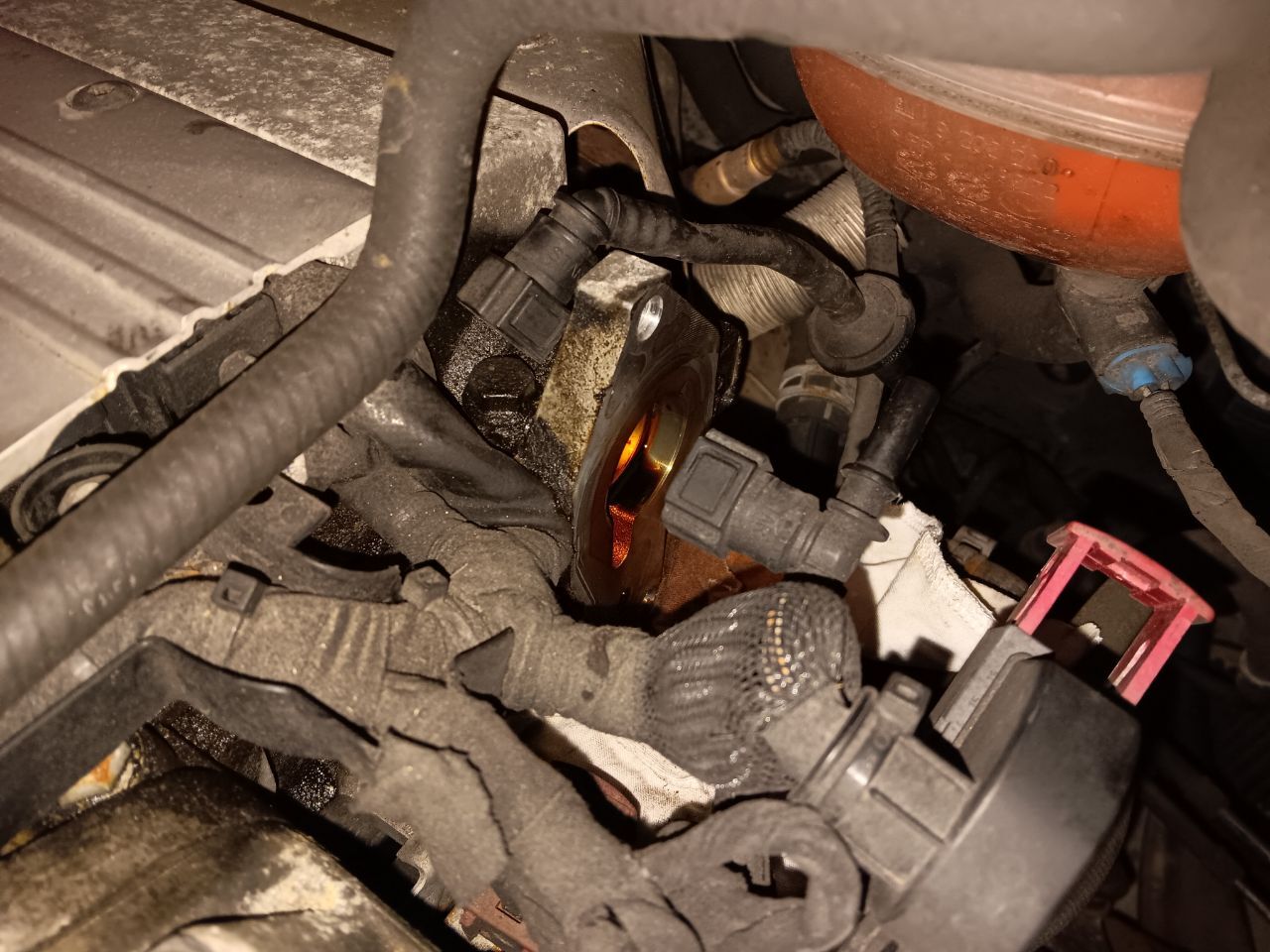

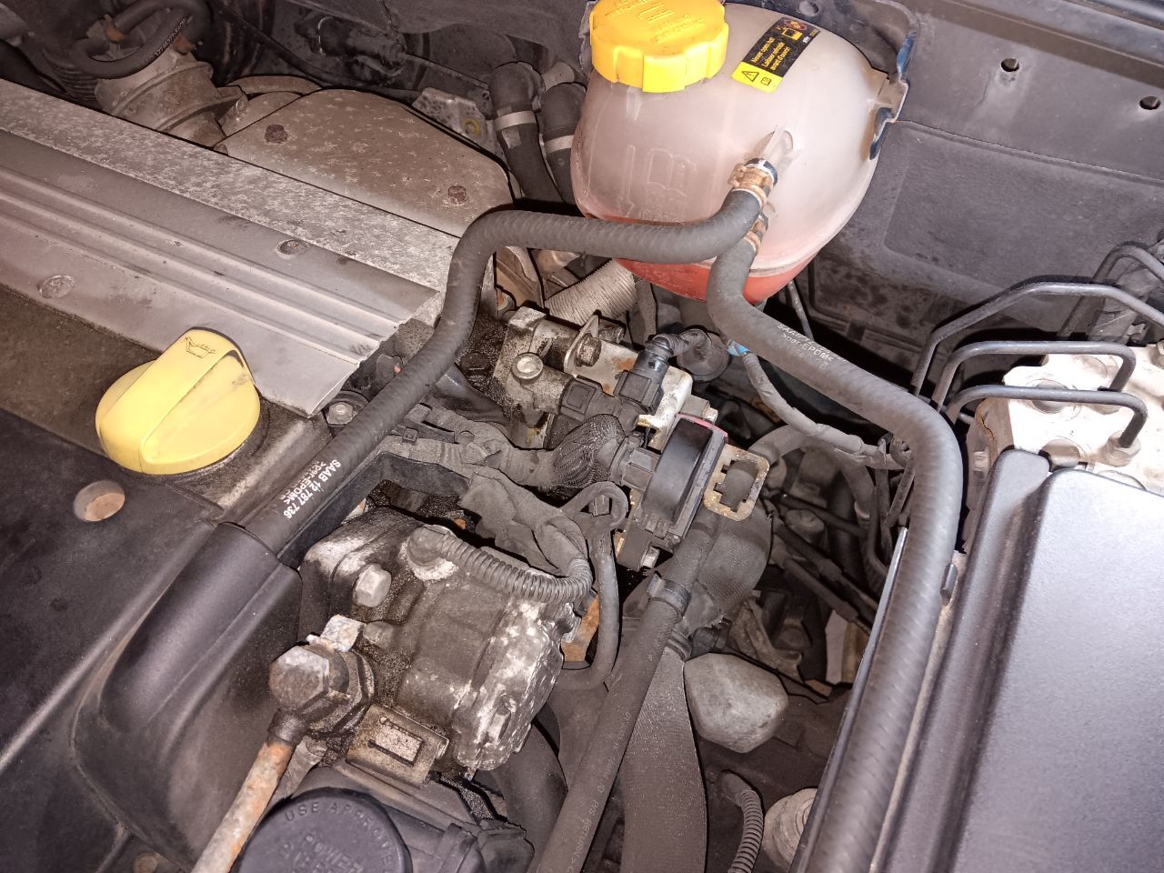

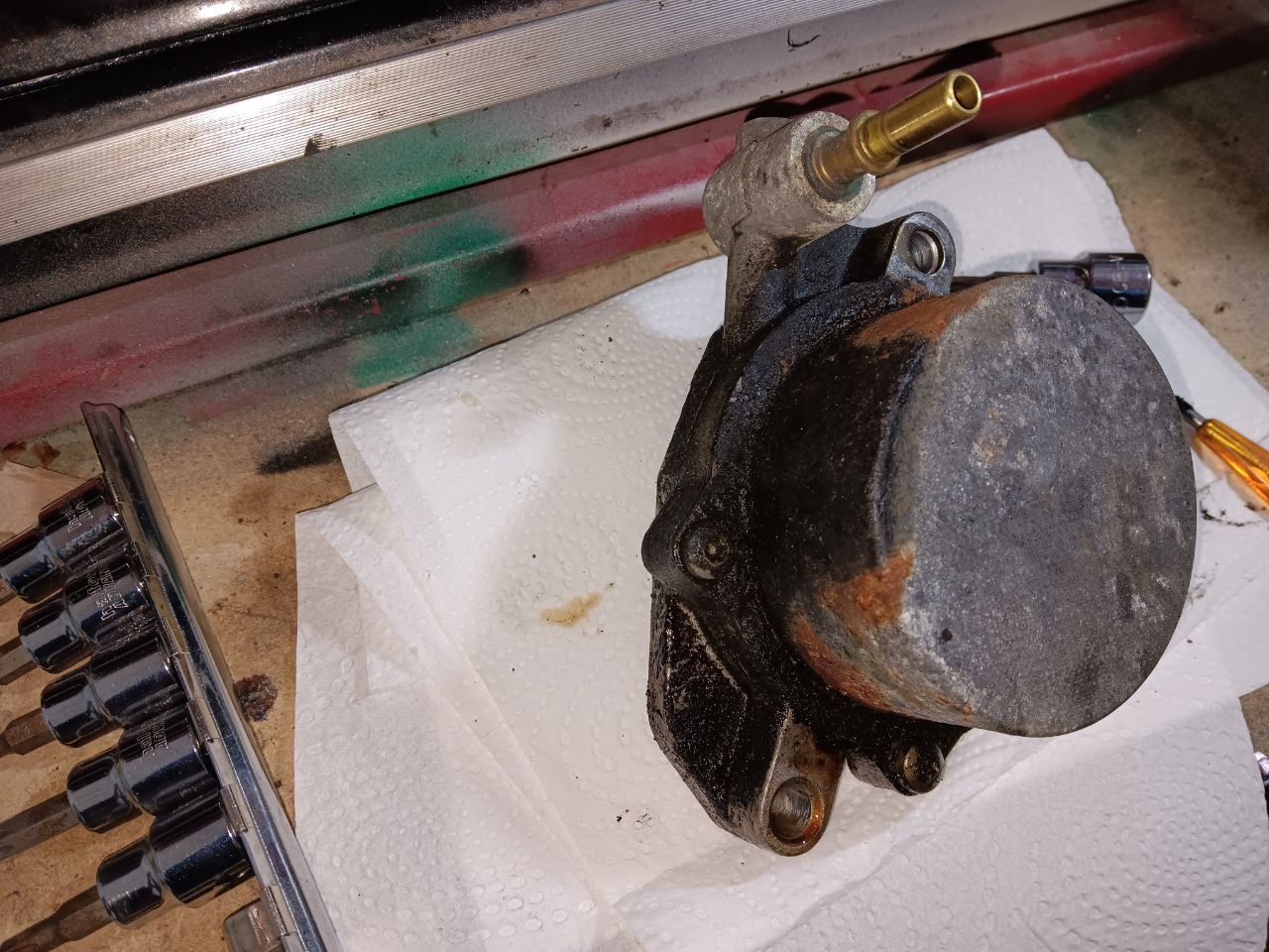

One thing that these remaps do is blow the already brittle vacuum pump seals so I replaced these tonight. I think this is the 3rd one of these I've done.
Lived here on the end of the camshaft:
These bits off.
The box on the left is the deionisation module, basically one half of what the old DI cassette did.
Off, its been leaking for a few years:
Now here, in 2 halves.
Both seals, the one between the pump and head and the internal seal were brick hard.
New Philips screws were supplied to hold the pump together but they were the wrong pitch. The originals were fine so they were reused.
All back together.
