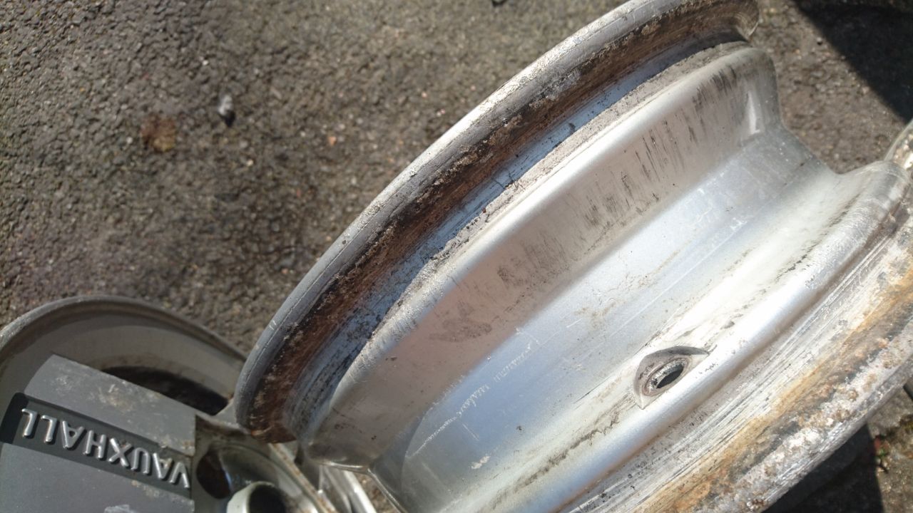

2020 - Alloy wheels:
My memory is clearly worse than I thought. As if it was just as easy as buying some wheels and tyres, then fitting them and suddenly the van looked great? Here's what the wheels looked like when I bought them. So scabby and dented I was sure I had wasted my money:
They did come back from the wheel specialist looking perfect, but as if that was the end of the story? I had the sticky track tyres fitted, and put the front pair on only to find the clearance to the brake caliper disturbingly tight! It's easy to assume that the Combo B is simply a Corsa at the front, but Vauxhall obviously upgraded the brakes for the van. To this day I have to make sure the wheel weights are not in a certain spot otherwise they hit the caliper!
The rear axle assembly is allegedly unchanged from the Astramax, which explains the slightly wider track, and weirdly deep stub axles. Even the drums are bigger than the Corsa version. Reassuring for braking performance, but not a straight fit for wheels. Here is a lovely picture of someone else's van in much better condition than mine! (I thought I was obsessed!)
The problem with the little alloy wheels was the centre caps - all part of the look. I eventually made them work by buying 3mm wheel spacers, removing the bearing caps, and filing down the clips on the inside of the wheel centre caps. Yet another bodge!

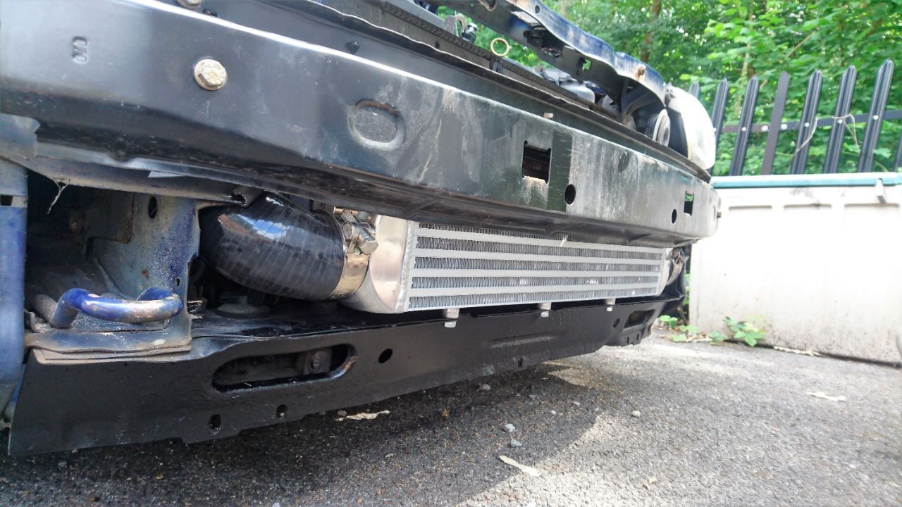

I guess you'll all like this next bit as performance upgrades seem to get everyone more excited than painting wheels.

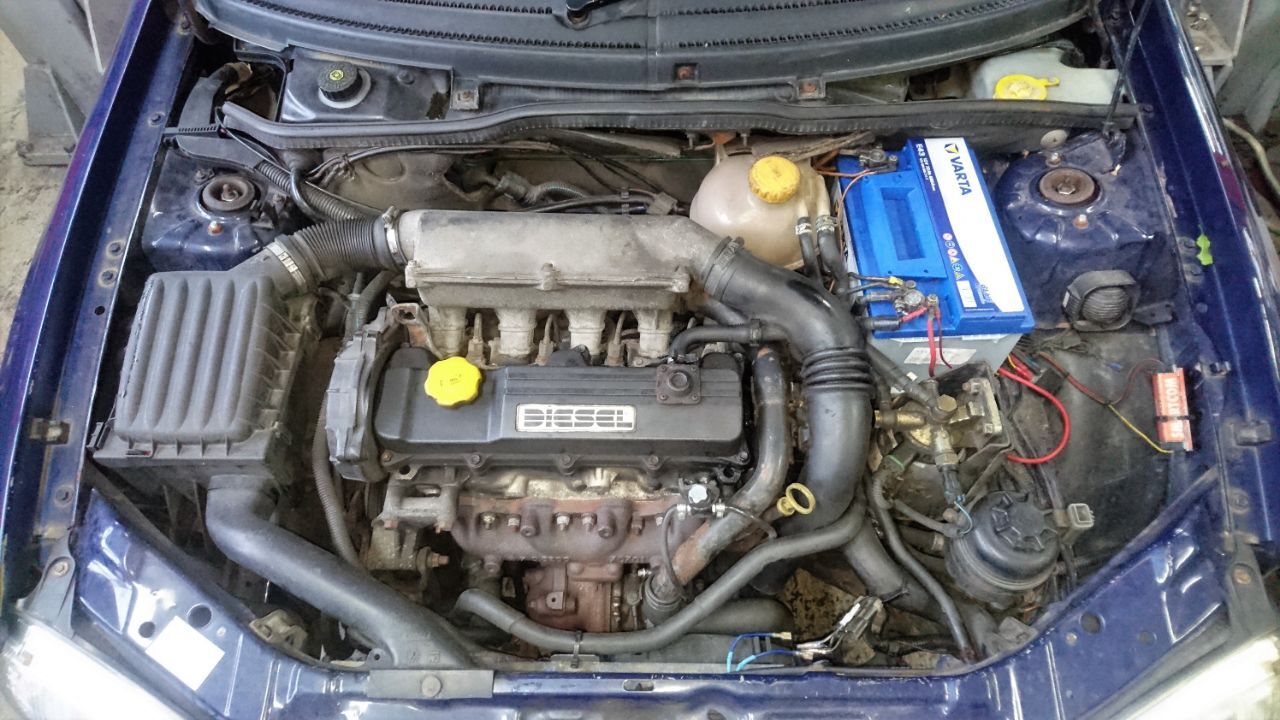

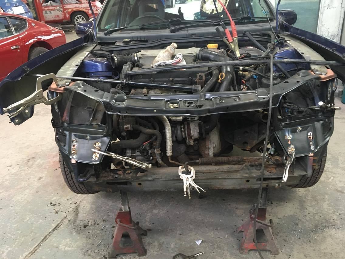

Obviously in my quest for finding out how much power this engine could make, I wanted more, and so read about intercooling. I think I a lot of people interpret it as "makes your engine cooler", or even "makes your intake temperatures cooler", but what it really does is reduce the the air temperature after being supercharged by the turbo, so that the air is more dense before entering the engine. This allows the engine to burn more fuel proportionally, and so you make more power. More power means more combustion temperature, and therefore higher exhaust temperatures, which feeds back through the turbo, and probably heats up that intake temperature again. So the net result is the same engine temperatures, or possibly higher due to extra power. There's also the chance of increased turbo lag because of the longer intake path and feedback loop, and even a drop in turbo pressure as the air expands inside the intercooler. Therefore it's important to carefully match the intercooler size to the turbo size and engine power. So I duly bought the biggest one I could find, took off the front bumper and crash bar and attempted to work out if it would fit:

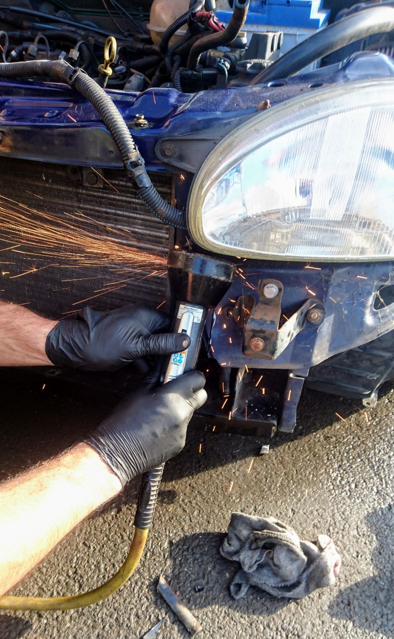

There were some clearance issues! So I did some proper measuring, and bought this one instead:
Still some challenges to face in routing the pipes around the water radiator, but nothing an angle grinder can't solve. Now for some highly scientific drawings and a list of parts needed:
The whole air intake routing layout needed to be changed. Vauxhall designed the engine bay so that all the engines would accept the same airbox, in front of the right wing. On the turbo diesel though, this meant routing uncharged air over the top of the intake manifold, into the turbo, and then charged air back up almost the same route to enter the manifold:
Most people who have intercooled this engine change the manifold for the N/A version which just has one simple big inlet.
There was no way I was confident enough to install this myself though, so I asked my tame mechanic up the road, and he agreed to help me after business hours for very good mates' rates. We get on well. He's into rock, metal, and real ale too so conversation flows, and he accepts payment in both cash and beer. The first session went reasonably well but it wasn't done, so I carefully drove it home with several open pipes hanging off the engine, no air filter, and no front bumper (I lived literally at the other end of the road from the garage). All good and excited for the next day. We even managed to fit the impact bar with no modifications, but a few superfluous bits of bodywork were removed.

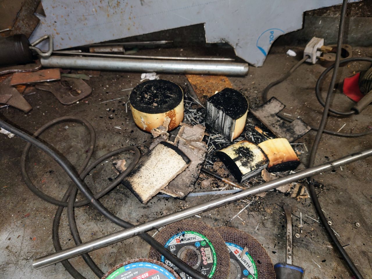

Completing the Intercooler - disaster strikes!
So the next day I started up the van ready to drive back up the road to the mechanic, left the driveway, but abruptly the engine coughed, stumbled, made a horrible noise and then stalled. My immediate thought was that one of the open inlet pipes had inhaled a loose stone from the driveway, and bent a valve and probably many other things. I didn't dare start it again, but persuaded my mechanic  to bring some of his tools down to mine to investigate. We couldn't see any foreign objects, so he proceeded to take the head off in under an hour. Hmm, nothing looks broken.
We came to the conclusion that any foreign objects must have fallen out during disassembly, or that a valve had become stuck due to the huge amounts of carbon deposits around the valve seat:
So I had no choice but to leave the head with him for a full top-end rebuild, at whatever cost (but still mates' rates + beer), and an unknown amount of time with it off the road. Still, I had my 944 to drive to work. Here's the head back from a light skim looking cleaner than any diesel ever has a right to:
At this point I would love to say we were out of the woods, but I managed to order the wrong head gasket and timing belt kit for this engine. The trouble is, although there are obvious differences between the 1.5 and 1.7 versions of this engine, my example is from the final model year, so Vauxhall managed to make the 1.7 timing belt tensioner fit the 1.5 engine. I therefore had to order a 1.7 timing belt kit, but a 1.5 head gasket. The wrong head gasket was just different enough to allow fresh oil to piss out everywhere after putting the head back on, so off it came again to wait another few days for the correct one. This is the wrong one:
The factory even skimped on the cam cover in the final model year, which the turbo diesels should proudly display TURBO on top, whereas mine just plainly showed DIESEL (duh, what else?). A quick eBay purchase solved that. This gives extra HP surely?
We found a better use for this part of the engine whilst working on other parts:
Finally, everything else was button up, and the air intake properly connected to a new pod filter (not because they're better, but because there was no way the factory air box could be used now)

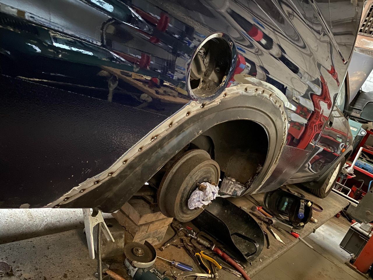

The garage let me put the van on the ramp and attack it with a grinder and toffee wheel. These are the horrors I found:
49948631_2157442637649578_381346993705844736_n.jpg.339bd31440a9a0dbc537d4c3e9a65e08.jpg
49820747_383028635781453_2003572389266325504_n.jpg.e7535ec51dcf32cb2321ba31440bb770.jpg

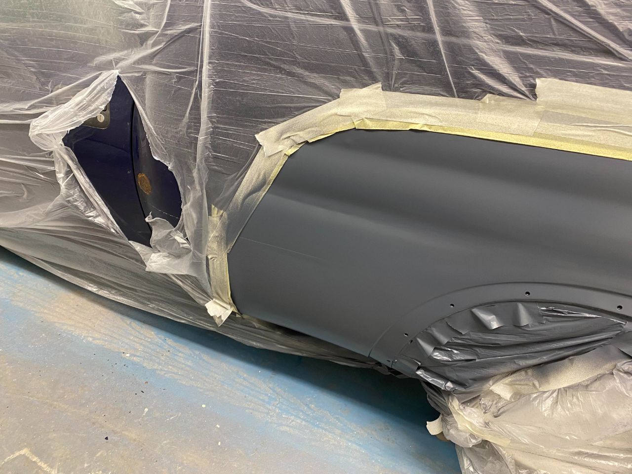

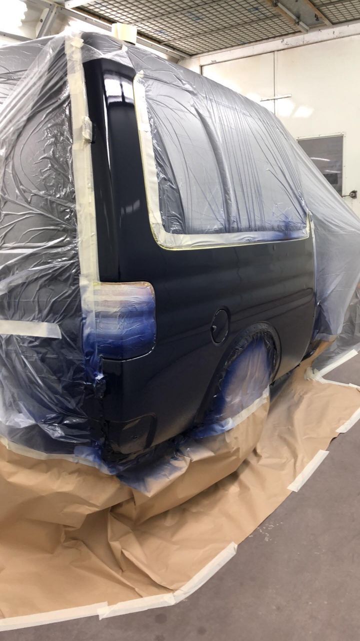

This was as far as my bodywork skills went, so knowing the wallet was going to hurt again, I let the garage do a professional repair on both sides:

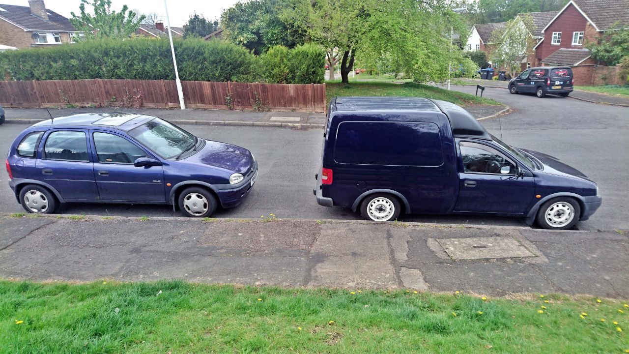

I'm sure we all know the stories that start with "I was browsing eBay one evening, and I saw this cheap car".
For all the time I had owned this van, I envied the plush options that the Corsa received that was denied from the van owners. Luxuries such as: carpet on the floor instead of a rubber mat, sound insulation under the bonnet, a courtesy light in the glovebox, a leather steering wheel, air conditioning (with the petrol engine and CDX trim), and heated seats (but I solved that earlier with Calibra leather seats). So I wondered if I could upgrade to some of these luxuries by buying parts from a scrap dealer. But by 2017, the Corsa B had been out of production for 7 years, and the Combo B for 6 years, so scrap dealers were not that interested. It was also around this time that I completely abandoned calling Vauxhall dealerships for spares. I knew the answer: "NLS - no longer serviceable".  Although at the NEC Classic Motor Show I had been tipped off about an excellent New-Old-Stock parts hoarder called Vauxhall Green Parts. He clears out dealerships from stock that's running low and keeps them in a centralised place for the needy!
Then there was the annoying challenge of replacing flimsy bits of plastic trim that nobody ever seemed to sell even used on eBay. So I considered buying a complete car. One day a dark purple Corsa B 1.5TD GLS appeared just north of London for £250.  I did the sensible thing and bought a one way train ticket, and drove it home. My rationale was that it was a good deal on an entire car's worth of parts. What actually happened was that I thought it was such a plucky little car, with nice compliant suspension and an insulated interior, that I drove it around for 2 years as my first "normal" car with back seats and everything! I even passed my advanced driving course in it, and lent it to my Mum whenever she also needed a "normal" car. At the time she was living on a roaming canal boat with her partner, and their only road vehicles were his van, and their motorbike.
I even named it, as the number plate had the letters EDY in it. So Edy received the free engine mods I had learnt from the van, I upgraded the sound system, and did absolutely no other maintenance to it in the 2 years of ownership. Here's a blurry view from the back seat (probably after a few beers, with my Mum driving) (The beers were were for me, not Mum)

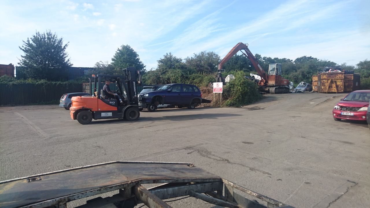

Sadly it was then off the scrapers, where a fork lift crudely skewered it's forks through the perfect windscreen, and dumped the remains of the car on top of another, to be made into bean tins. Still, they paid me £45 for it.

Really lovely intercooler installation there.  You should be proud of that 🫡
Thanks. Yes I'm very pleased that it fits behind all the factory bodywork considering the vehicle wasn't made to take it. I'm not a fan of the "massive rectangle cut out of the bumper" look.

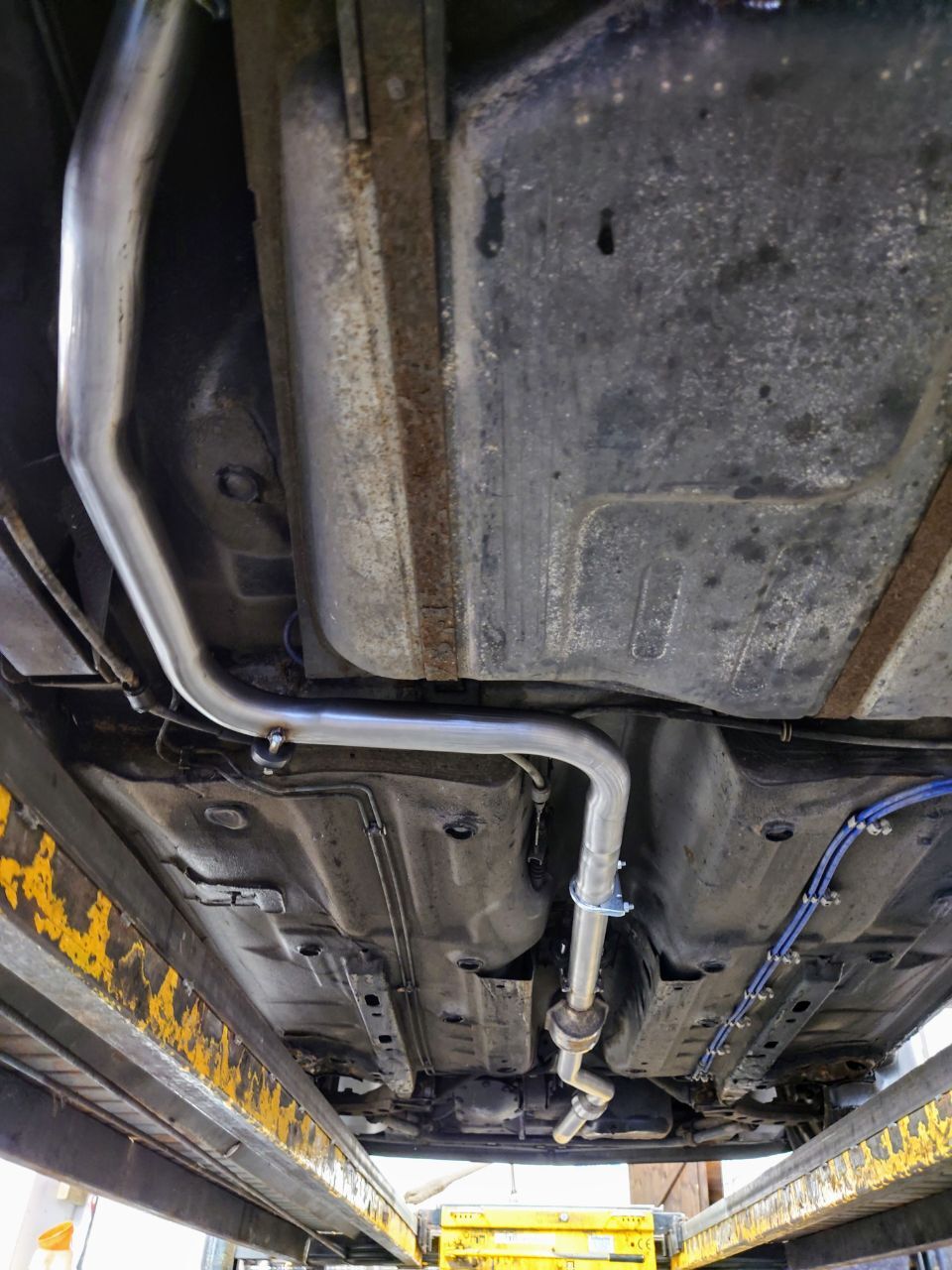

Found some Gaz coilovers on eBay, better than the no-brand ones I bought as an experiment just to see if I liked it lowered. They came without helper springs, bump stops,  or top mounts, all of which I ordered from Gaz, but by the time I had a functioning safe set, I probably should have just bought them new!

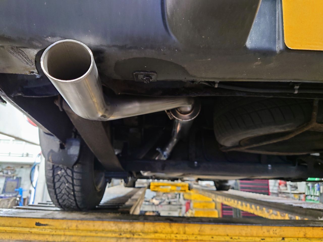

The middle exhaust section fell apart, so I bought a new one from something silly like £25.

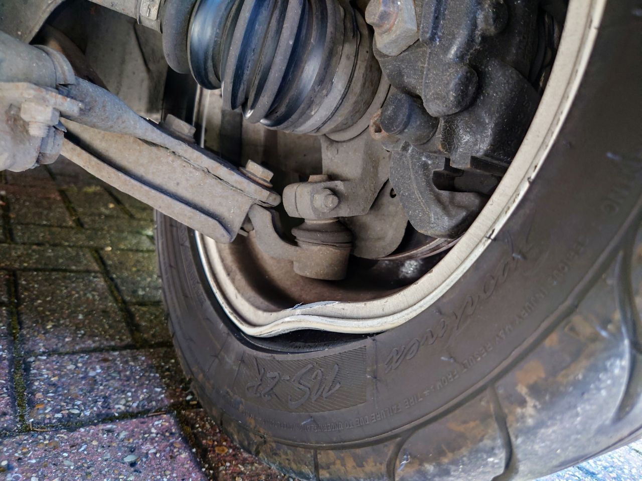

I'm sure most people will remember how awful the UK roads degraded around this time, possibly due to neglect throughout Covid, and then a bad mixture of extreme weather conditions. Well I quickly discovered what a liability it is driving a lowered vehicle on small alloy wheels, and stiff sidewall track tyres. On a road near to home, I hit a pothole, hard, and immediately heard a rhythmic knocking which turned out to be a dent inside the wheel hitting the brake calliper! Amazingly it was still holding air pressure! A friendly family let me use their driveway to fit the spare wheel.
The next day I went back in full vigilante mode to photograph and measure the offending hole. I even took a can of spray paint and drew a massive warning triangle on the road. Oddly enough I've since discovered this is the quickest way to get a pothole repaired, as the council would sooner remove evidence of vandalism than any other damage.
To fix the wheel, I took it to a local engineering company run by old school grumpy gits who are very good at their job. He normally turns around wheel repairs within a day or two, and for £40 I had it back, round and true! A bit of rattle can over the repair was enough

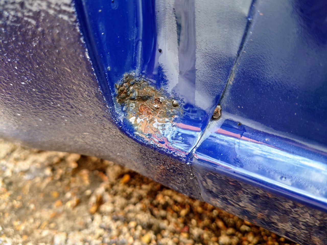

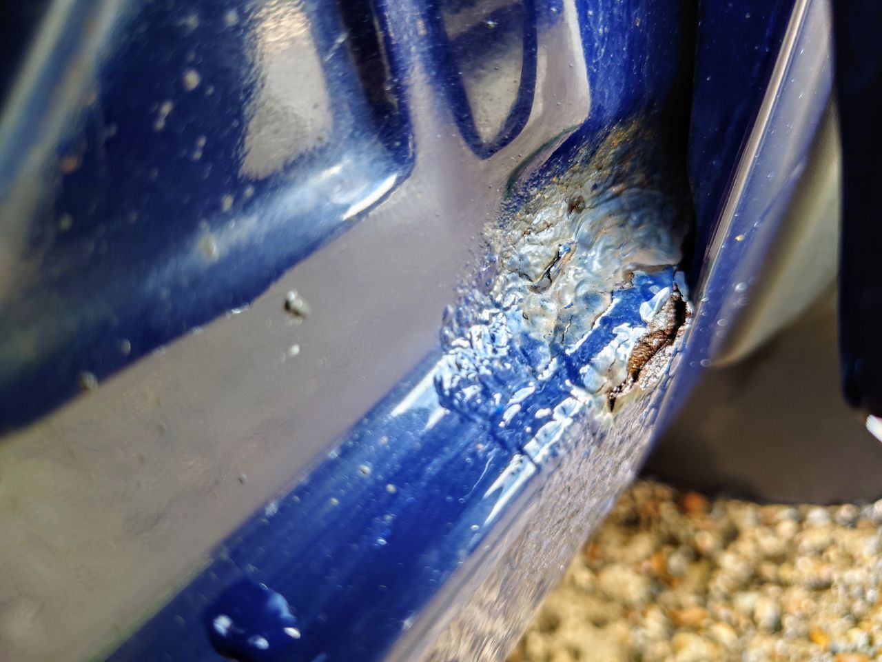

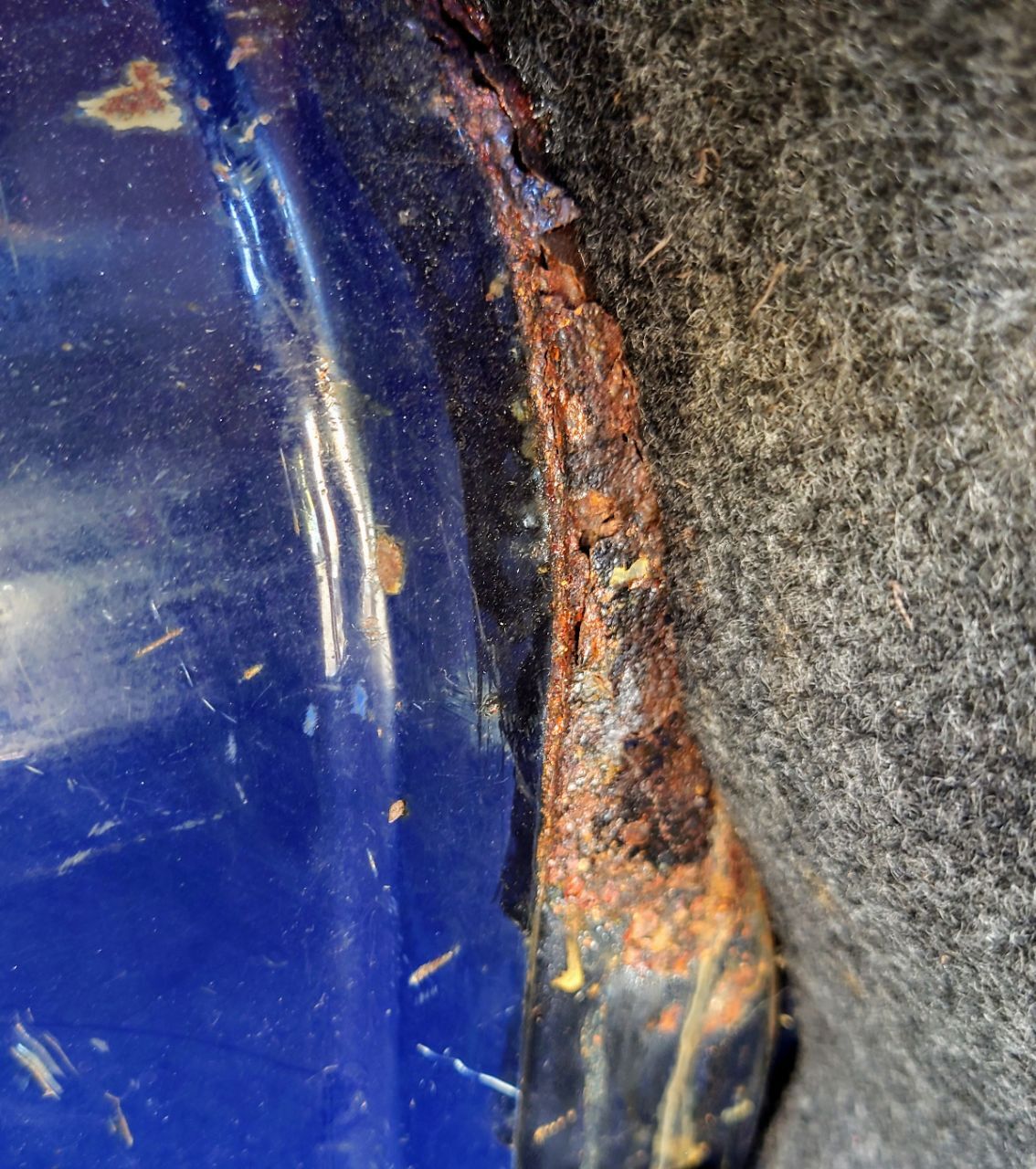

Still 2022 - rust and pulleys
Here's some photos of rust that I noticed, documented and tried to ignore. I did add rubber pads on the tops and bottoms of the doors so that the corners don't keep smashing in to the bodywork every time they are closed (what a stupid design!), and treated the offending areas with Hammerite Kurust. The other areas would come back to fight me next year

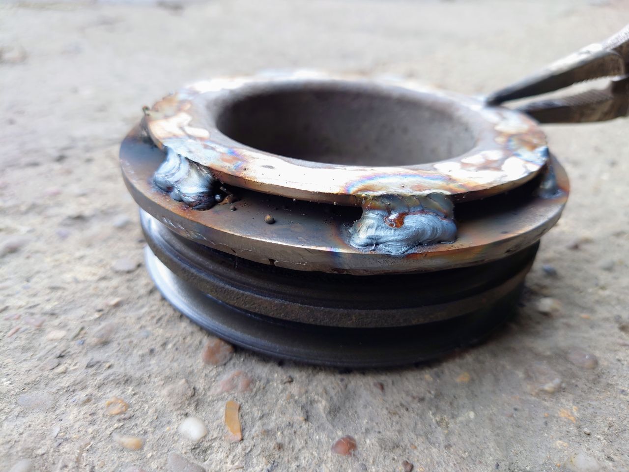

Next, an identified rattling from the engine turned out to be the crankshaft pulley trying to self disassemble. The design of this part includes a rubber centre to help dampen the inherent lumpy vibrations from the high compression diesel engine. In typical Vauxhall fashion though, they didn't expect the vehicle to last this long, so the metal has outlived the rubber, and become two separate parts. Somehow, this was still driving the belts when under tension, but not without some odd noises.
I removed the rubber, and had my local garage weld up the two halves. Several people on a Facebook group told me the vibrations would destroy the crankshaft, engine mounts, or all sorts of other disasters.  I've done 15,000 miles since with no apparent engine destruction, and besides, I can't buy a new one!

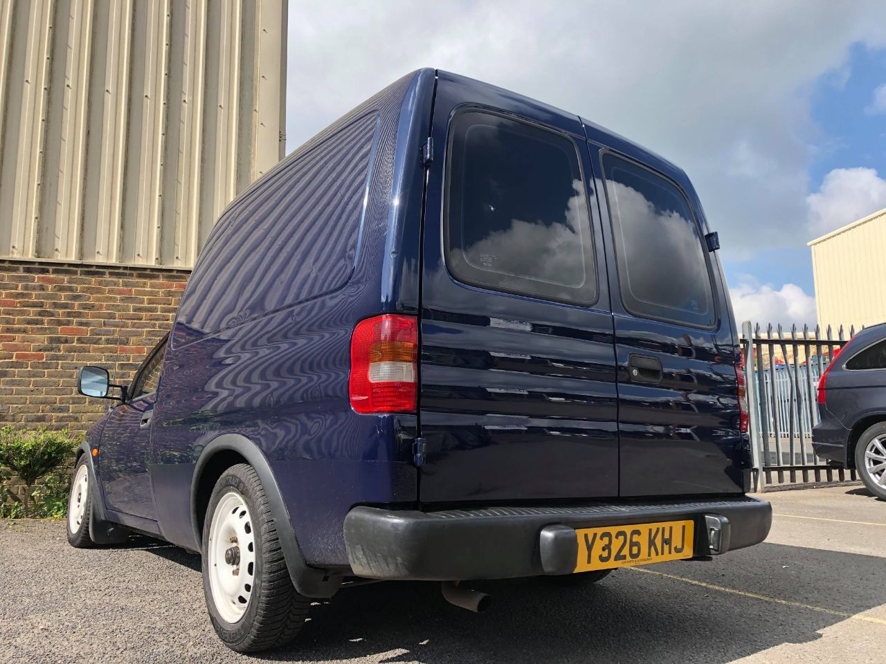

2020 - finding rear doors without rust
Of course, I'm out of sequence with this story again. The van came into my ownership with a heavy duty Masterlock circular padlock thing with two crude brackets bolted through the rear doors. The original lock had clearly been jimmied open. I replaced the handle and lock barrel with the set from my old white van. It didn't matter that the key didn't fit because it has central locking, and I have a remote button for alarm and locks too. During the respray in 2014, the garage fitting blind coach bolts into the holes as a neat but easier alternative to welding up the holes (they offered me a choice). Despite this, the doors had started to rust around the coach bolts, the bottom edges where the seals conveniently trap water, and around the windows.
So I created an eBay search, and two years later a pair of scruffy but sold doors turned up.
Replacementdoorsacquired(1).jpg.94c7b037c651f3735d91930c01e412fb.jpg Replacementdoorsacquired(2).jpg.5bfc86bf7be83da9d78637e3acdb5fd9.jpg
Then I just had to pay my favourite bodyshop to remove the glass, tint them (I've always preferred tinted rear windows on a van for security), remove all the hardware, tidy up the metal surfaces, and paint them inside and out. Oops, that was expensive.
