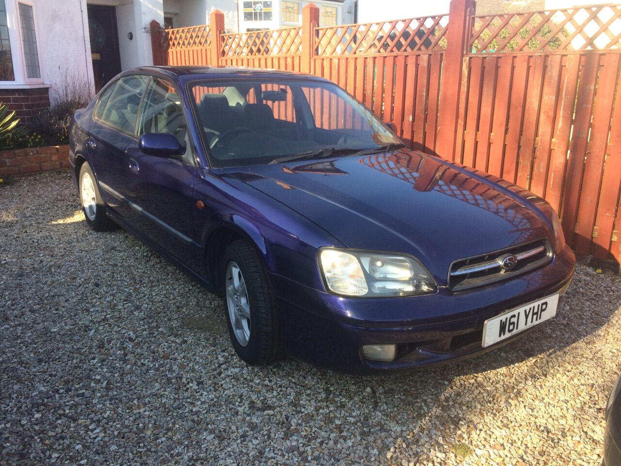

Meant to write this the other day.
This is the first time I’ve bought the “same car” twice. Like I’ve had multiple Toyotas, Hondas, Peugeots, but I’ve never had the same model more than once.
Where I used to work a guy asked me if I wanted to buy his Subaru Legacy. And I immediately said no because I didn’t have the money it needed. He said he didn’t want the money because it was costing him money keeping it in the lock up. He didn’t care what I did with it but he thought he’d offer it to me. So I said yeah. I gave him a £35 bottle of whiskey for it.
No air con, nothing in the way of mod cons actually. Didn’t start or run right and had been dry stored for years. Checked it through and put it in for an MOT and I drove it. Same 2.0 litre engine as the current one.
Problem was the clutch was super heavy and it aggravated my Achilles in my ankle. An old boxing injury that I don’t think has healed right but it is what it is. Twice in 6 months it happened and I couldn’t drive it.
At the time I was heavy in to Paddy the Corolla. The wife put her foot down about it saying I can’t have two project cars at the same time, one had to go. Stuck it on Facebook for £500 and sold it to a lad in Derby. I did tell him the cam belt needed doing and the kit was in the boot. I don’t think he bothered and I think it’s been scrapped since.
My Legacy now though drives so much better than the original one. It feels like it has more power and handles nicer. But yeah, thought I’d mention this one.
Now I’m off on eBay looking for the obligatory Haynes manual!
