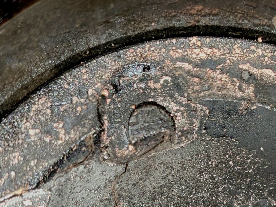

Head is off, and we may have found our suspect.
Here's the head:
Nothing awful at first glance, but what are those light witness marks on the inlet valve of #3? Let's have a closer look:
The camera shows them as brown, but they're actually silver, where something has hit the valve.
Hmm. OK, what about the pistons?
You'd like a better look at #3, huh?
Fair enough:
I have no idea what that is.
What are your thoughts? Have we found the problem?

Unless my eyesight is playing up, ( highly likely) that looks like the imprint of a nut?
Which begs the question, where's it come from, and where's it gone? 🤔
Shim on #3 inlet has also seen better days:
Certainly seems so, and not a small one! A 1/2" for a carb fitting would be my guess.
Looks that way to me too.
No idea how that would have got in there - I haven't done any work on that area, and the airbox is held on with SU type sleeve nuts similar to the ones on a Mini air cleaner.
It does seem most likely to be the source of the noise though.
Question is what to do now...
Depends.
The photo almost looks like it's a raised section, like the nut has been pummelled into the surface of the piston. In that case you'd probably need a new piston. You could potentially grind the lump out, but I'd be worried about the remains making a bid for freedom if they come un-stuck...
If it's an impression in the top of the piston but the nut itself is nowhere to be seen than it is probably heritage damage. The engine has swallowed a nut, somebody has gone in and retrieved it, and then put the engine back together. I doubt it'd manage to find it's own way out past the exhaust valve.
In that case I'd probably just leave it as is -  It wouldn't be making noise unless a raised section was actively hitting something.
  • Agree 1
Can't really see on the photo, but how's the bore?

Looks more like a washer than a nut to me.
Try picking around its edges.
Is the item raised above the block deck at TDC?
Look at the mark on the cylinder head beside the spark plug hole, is there any roughness there?
What was the big-end bearing like on that cylinder?
Well spotted - it's quite possible, but hard to tell until the piston's removed and cleaned up.

I agree, it's ingested something.
Piston looks cracked, you will need to remove to inspect more closely.
I suspect the new pistons will be expensive, if the bore is ok and there isn't actually a crack and the damage is localised to the top of the piston I would be tempted to 'reprofile' it with a file to smooth out the damage - you may be lucky but I suspect that the damage will be so significant the piston will be beyond redemption. If so I'd try for a good s/h piston or maybe another s/h engine to salvage the pistons out of.
You will probably find when you take the pistons out some of the rings are badly worn or broken; might as well fit new rings regards when you're this far in.
If you do end up fitting one piston you should really weigh the other pistons to ensure the 'new' one is fairly close in terms of weight to the others.
It looks like the nut has been partially melted and smashed into the piston to me.

Piston extracted:
Cleaned the crown up, which actually looks OK:
Ingested a washer, by the looks of it.
No obvious play in the gudgeon pin. Not really sure what to do now.
