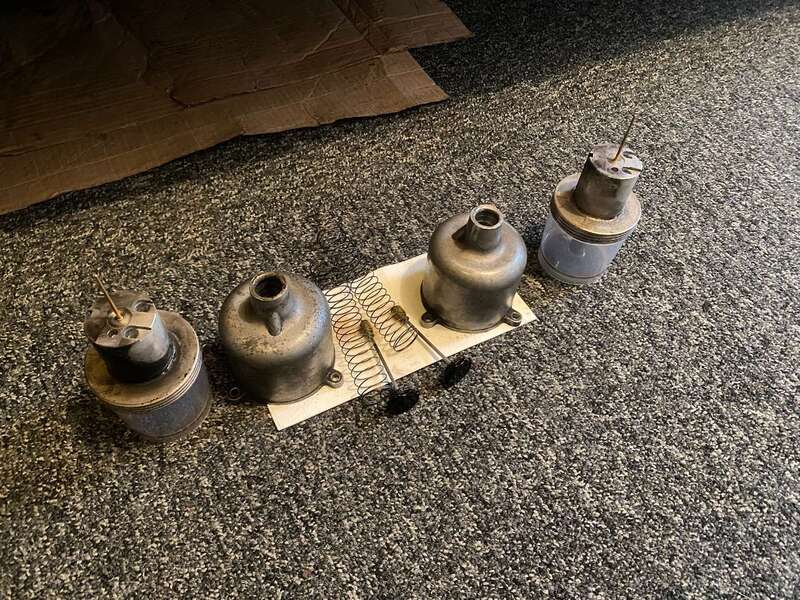

Mr Pastry Posted January 25 Posted January 25 Do both pistons move freely up and down the dashpots with the dampers removed? If not, slacken the 3 screws at the base of the dashpot, wiggle it a bit and try again, as they do not always align perfectly if they have been apart. Peter C 1
Peter C Posted January 25 Author Posted January 25 26 minutes ago, Mr Pastry said: Do both pistons move freely up and down the dashpots with the dampers removed? If not, slacken the 3 screws at the base of the dashpot, wiggle it a bit and try again, as they do not always align perfectly if they have been apart. Both pistons do move freely with the dampers removed. A chap on a Facebook MG group just said the same about loosening the dashpot screws. 👍

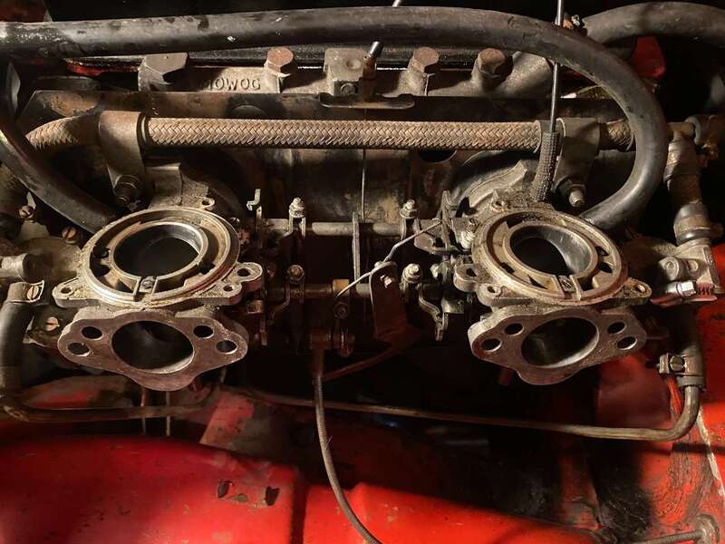

Peter C Posted January 26 Author Posted January 26 I had another go at sorting the carburettors today. I started by removing both dashpots and pistons. I gave everything a good clean. I checked both needles and dampers for straightness, all looked good. With both carburettors reinstated and re-filled with engine oil (as recommended by people on the internet), the piston in the rear carburettor still needed significantly more effort to lift compared with the front carburettor. I drained the oil from both carburettors and filled both with 3-in-1 oil (as recommended by other people on the internet). With everything reinstated again, both dampers provided almost zero resistance. I decided to mix some engine oil with 3-in-1 oil. I poured the correct quantities of my concoction into both carburettors, checked the movement of the pistons and they seemed fine, both needing about the same amount of effort to lift. I fired up the engine. It idled beautifully but wouldn't rev. On the basis that I could do no more with the carburettors, I had another look at the ignition system. When I bought a job lot of parts from Moss Europe a couple of months ago, amongst other bits I bought a spare condenser and points, which I've kept in the little toolkit in the boot, for emergencies. I decided to replace the condenser and points with the spares. Unfortunately, the spare parts were also made by Intermotor. Replacing the condenser and points is fiddly but I got them done in about 20 minutes. I fired up the engine and not only did it idle properly, it also revved without any stuttering. Now, either the previously fitted condenser and points were defective (as suggested by some good folk here) or I did something wrong when I fitted them last week. Considering that they can only be fitted one way and I've set the points gap to 0.38mm, the same as before, I can't see how I could have done anything wrong. Who cares, problem solved. More soon. Vantman, IronStar, Westbay and 15 others 15 3
