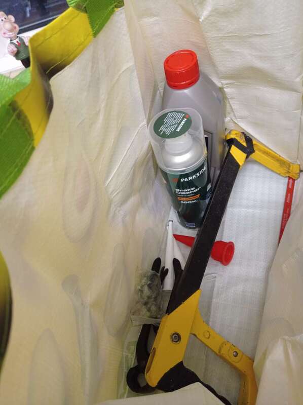

All my 'just in case he hasn't one/it's broken m8'..tools for the morning.
Also gifting him my Getz [suitable...] OF, no longer required 👍

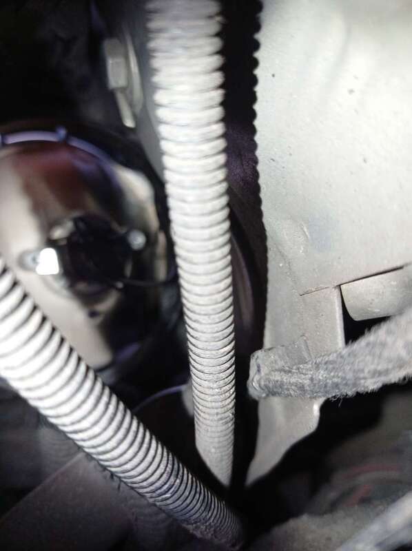

JOB DONE ✔️👍
*hardly a drop dripped!! 😁
Arrived 07:30... Out 08:00 🚀

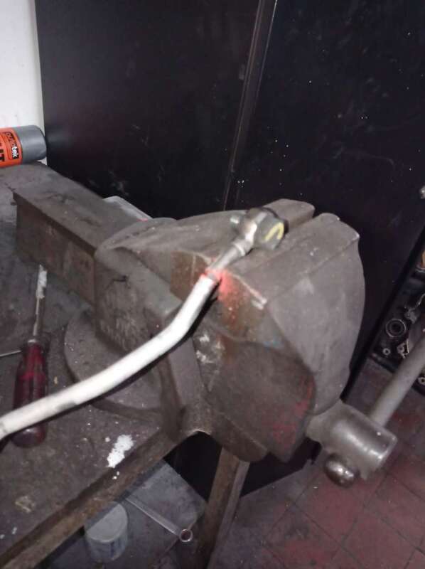

10mm c/h pipe slotted straight into 3/8" GM hose + hose clips.
Banjo terminals/cooler/radiator fittings cut off & crushed + refitted (in case rad does leak in future) to seal heat exchanger 👍
Astra J style tranny cooler peeking through lower grille.... Ideal 😎
My mechanic is a top bomber and took my instructions to fit exactly as predicted.... Well chuffed, all round!

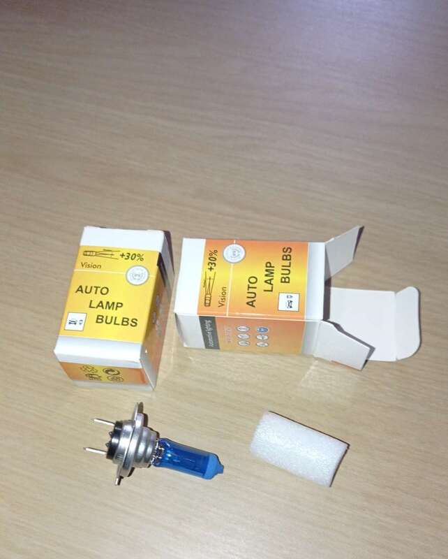

*do headlamps 1st 🤣
A.B.S.O.L.U.T.E          B.A.$.T.A.R.D
Don't even think about it!!
*headlights done

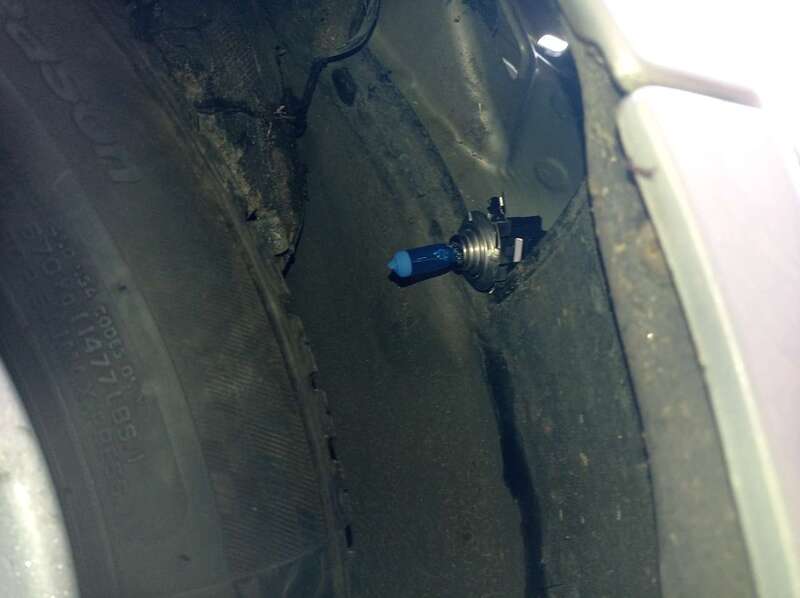

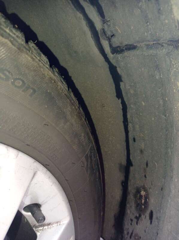

Oh.... You wanna know, eh 😐
One.. It's a tiny access hatch [big hands]
Two.. The bulb holder cables [... on this car] aren't long enough to remove the holder out of the access hatch 🤬
Three.. The bulb holder 'poinggs' OUT easy enough >>> the 🤬🤬 won't 'oinkk' back in!
The clip in wings, on the tin holder, locate behind the head of a screw (wedging under half the head) but seems to have a smidge of up-kink to ensure firm [...no laughing] grip 🤬
The first was a FKK ON @ 15 mins ✔️
The next was a 45 minute tirade of all the gods known oaths + almost an ambulance called for my wrist 😮
The 'tin wing' would ABSOLUTELY not go under that screw head.... Lateral thinking proposed loosening screw a smidge (star head) or needle nose pliers to crush the wing in!!!
* This is managed through a small hole in arch liner * 🤬🤬
Pliers it was.... Sorted 😉
Piccies... ??
