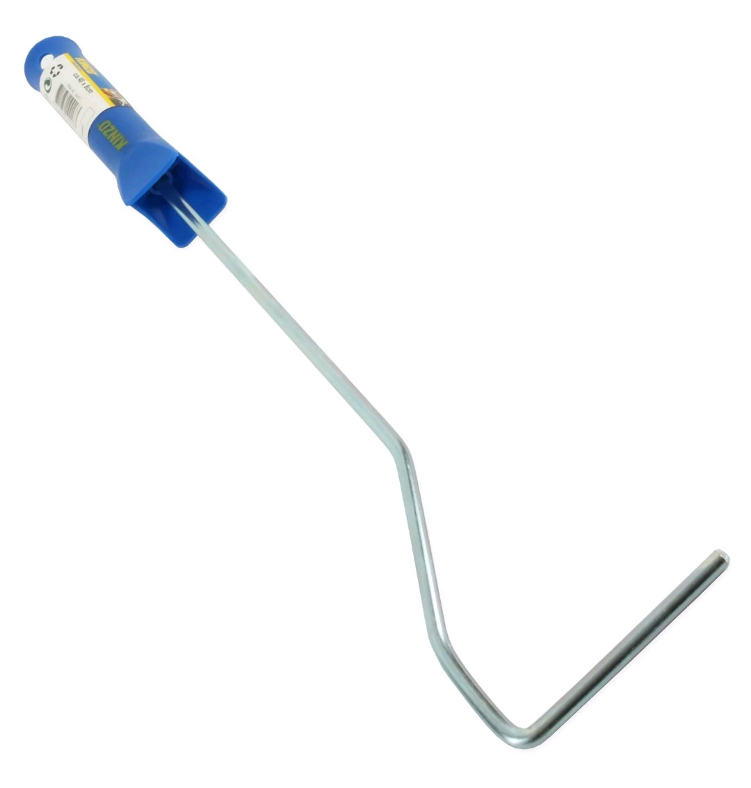

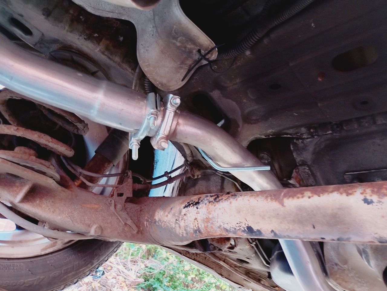

First order of business was = reform hanger (spot flame FTW) + jack handle. Nice 👍
...... unfortunately, my centre hanger bracket is M.I.A. so *very temps = I have a hooked rod, taking the weight.
A quick shoot up the lift, @Kevs, and some bending of rod + a clamp will return rigidity/support of the length 😁

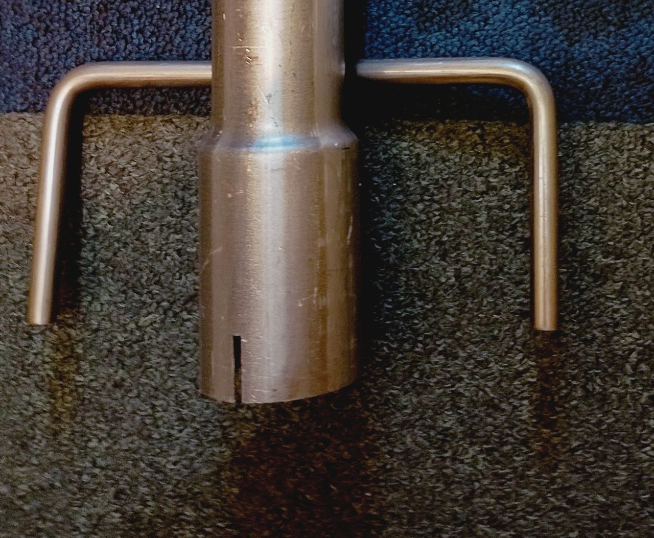

The *temporary hook (supporting the centre section) was very evident... at certain revs... sending a boom through the shell. Annoying!!
Knowing we need this sort of thing...
.... I plunged into my "I know I put one away in there 🤔" box >>> lo and behold
I will straighten the rod/remove handle.
I will kink two 90° bends, about an inch apart at halfway, making an open Z ....
I will notch the throat of the 2" U clamp so the rod will be gripped firmly to the Ex pipe and creating two straight out arms which I shall turn again 90° to loop through the mounting rubber bobbins 👍😉
Need another dry spell (Kev is very busy)
Right! .... Just need to get the 90° ends bent 🛠️👍

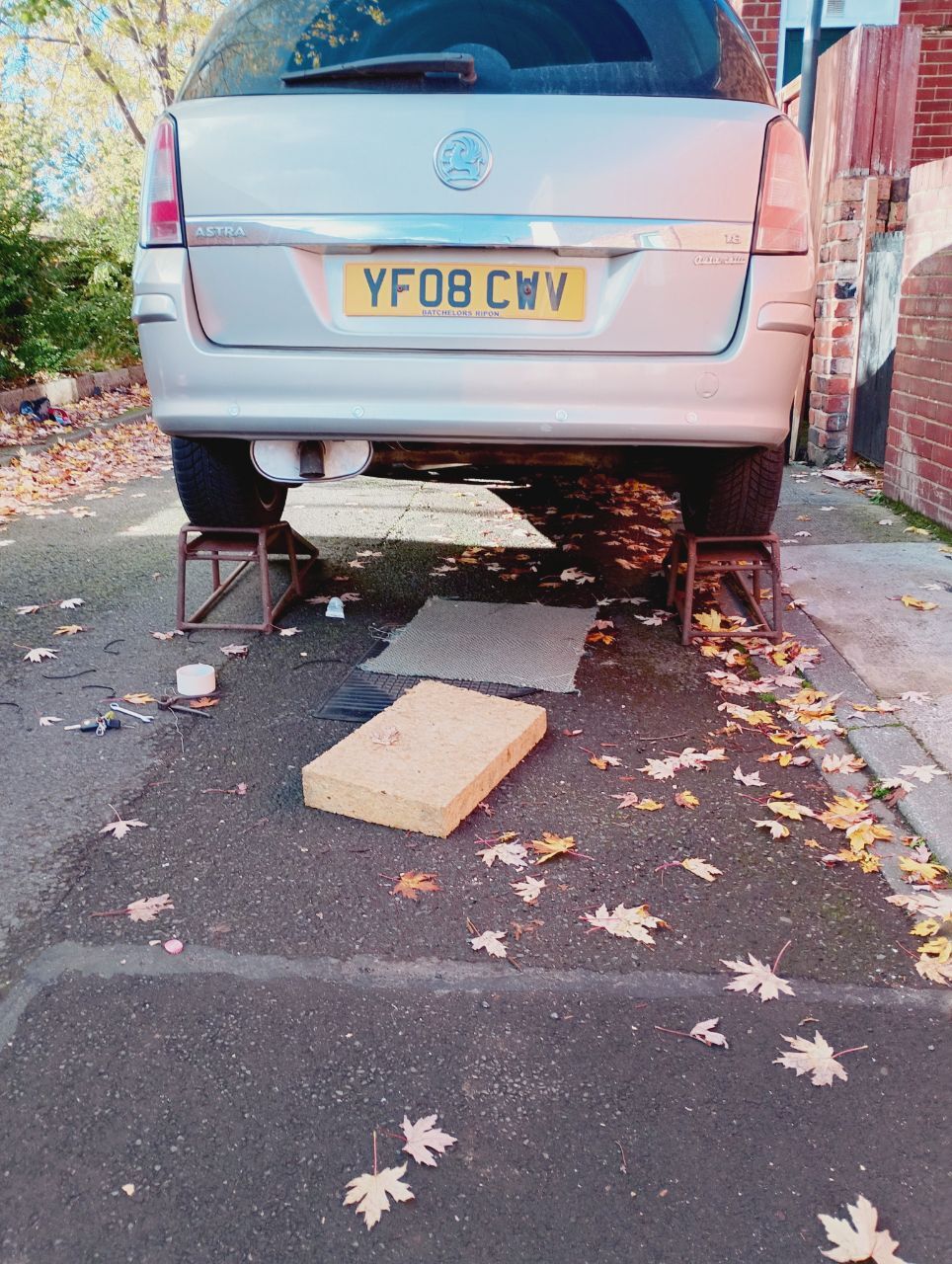

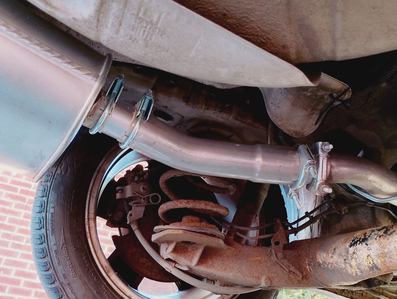

This is what is going on.....
...... Like it's no bovva for a lardy OAP to shimmey under the car & do spannerry + cranky things @arms length 🫤.
Just enough bovva, FFS!
Lovely clearance over the axle 👍
All the exhaust is now aligned, clamped, fully rubber suspended and (come December) MOT passable 🛠️✔️
F.F.S.!!
All the exhaust fully rejigged + suspended ✔️

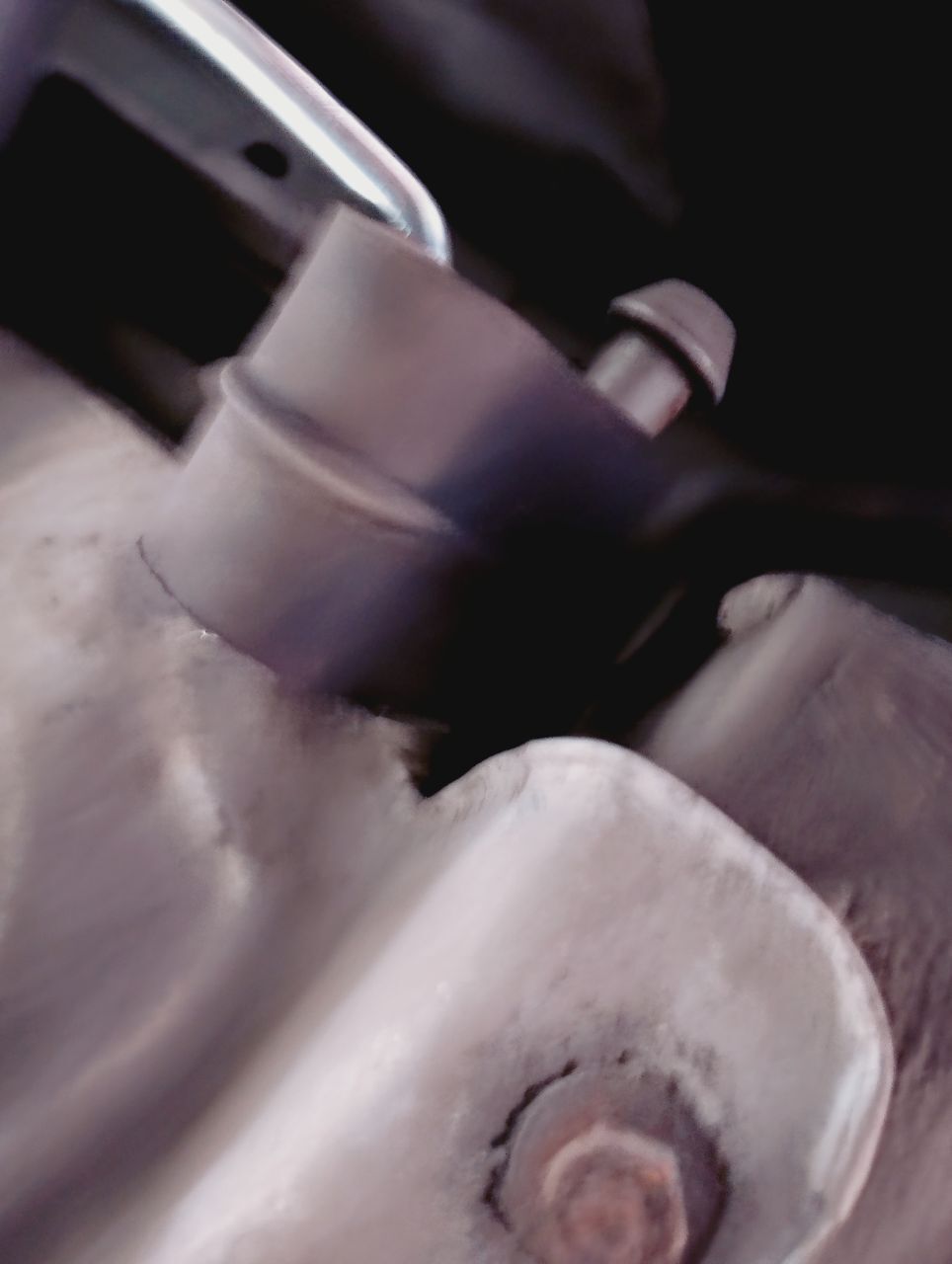

Brrrrrtatttatt >> from under the gear selector 🤬
Clue = intermittent in normal forward but solid brr when held in Reverse 🤔
Up ramps (... front this time) and squirm under...
Yark on pipe, looks ok.... Bangs pipe with fist 'clack'.. again several times 'clack, clack...'
It turns out that the car body horn & exhaust horn [for the rubber bobbins] n/s are the same height >> the exhaust isn't exactly central so the horns are contacting (.. with engine movement, in reverse!!)
I gave the two parts a massive yark, with the jemmy, and a bit of creaking has left the two parts well apart....
IF the ffn noise comes back I'll sort with a rubber bung jammed in 🙄.
Silence pervades.....

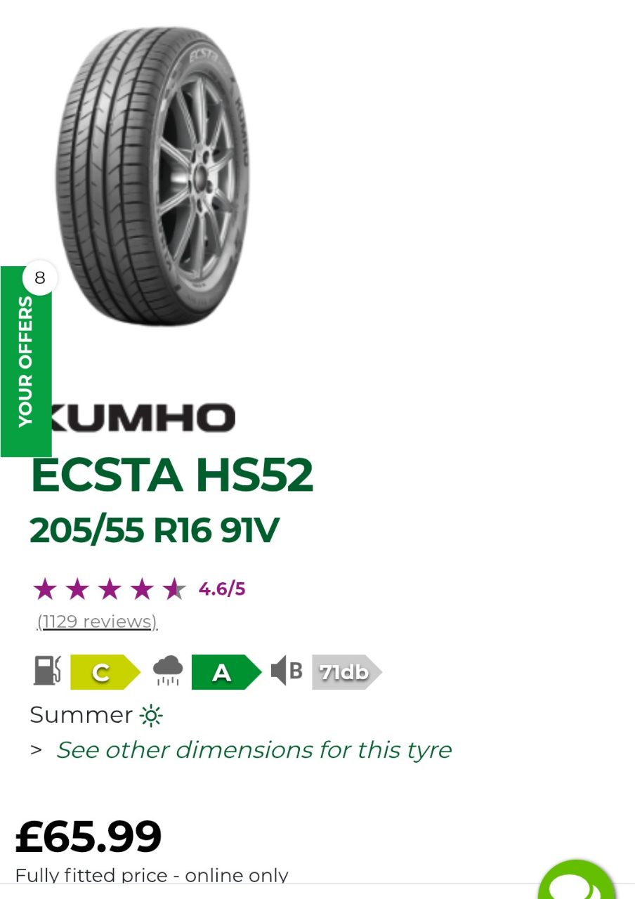

MOT early Jan. I'll pop it in about Dec 10th....
4 hoops I reckon due >>
ATS is my goto branch, down the High st.
Any reports, I've run Kumho in the past and were not too loud 😵‍💫
Given the miles you're doing, I'd be getting premium, dude
  • Agree 1
I’ve run with Kumho’s off and on for years for me and Mrs Wire’s cars, never had an issue, tough and durable. Their winter tyres are especially good.

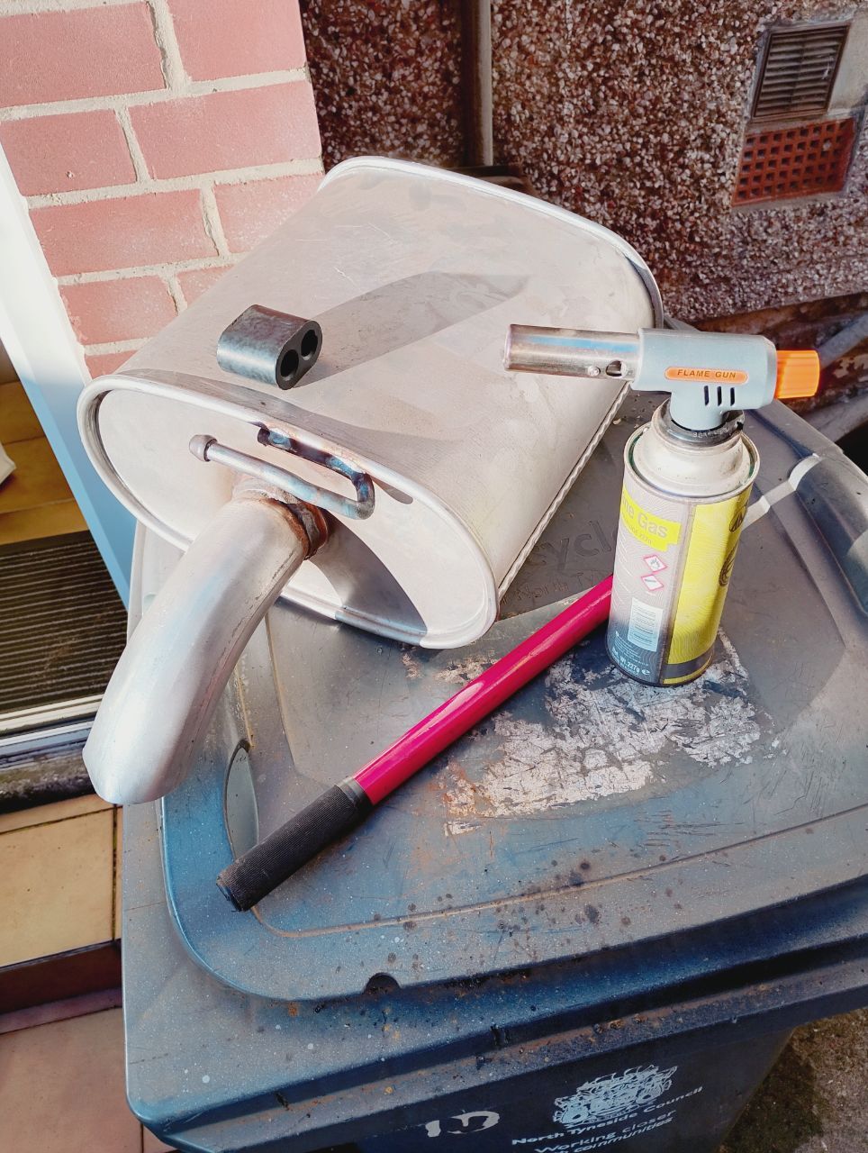

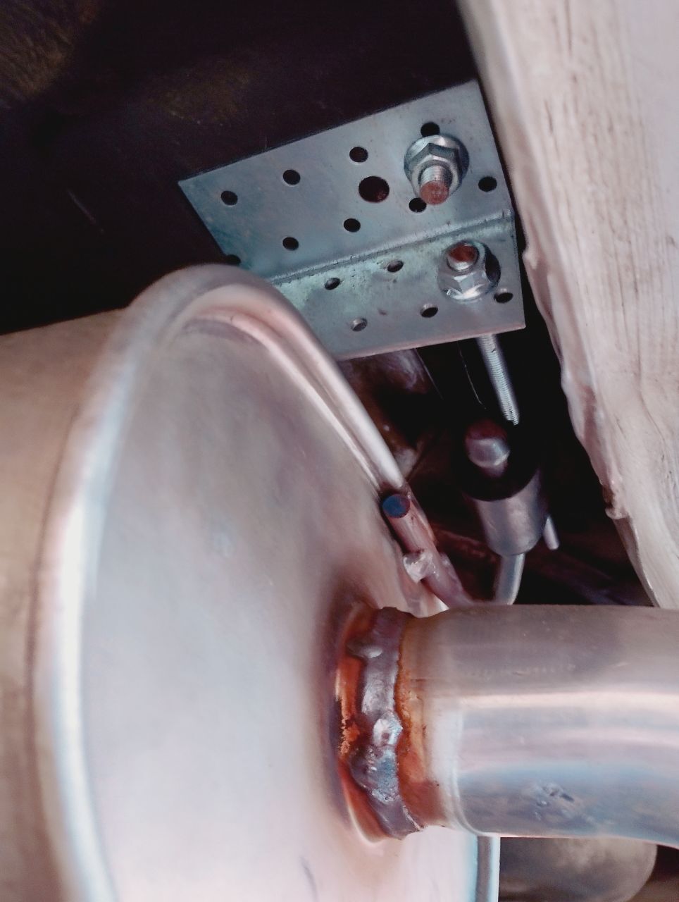

Because my soopa doopa poopa pipe is freshly installed and supported fully....
.... I have a *nice problem 😱
The rubber binocular shape hoop, supporting the back box isn't under sufficient load = the back box hanger arm had worked out of position (showing the box a smidge lower than it should be)
I will buzz some tywraps onto the hanger.... Leaving them with a bit of tail on and that will prevent it walking off.
Fits well neat 🛠️👍

Not So Quick...... 🫤
From ffinn about under here this morning, I discovered the issue with the back box is ACTUALLY... 🙄...
.... Though I have weighed well onto the 13mil nuts >> it's not quite crushing the pipe flange = the back box can snake about/shift on the mount 🤬
I will get a new 60mil u-clamp & re lash on the ex sealer and have another go.....

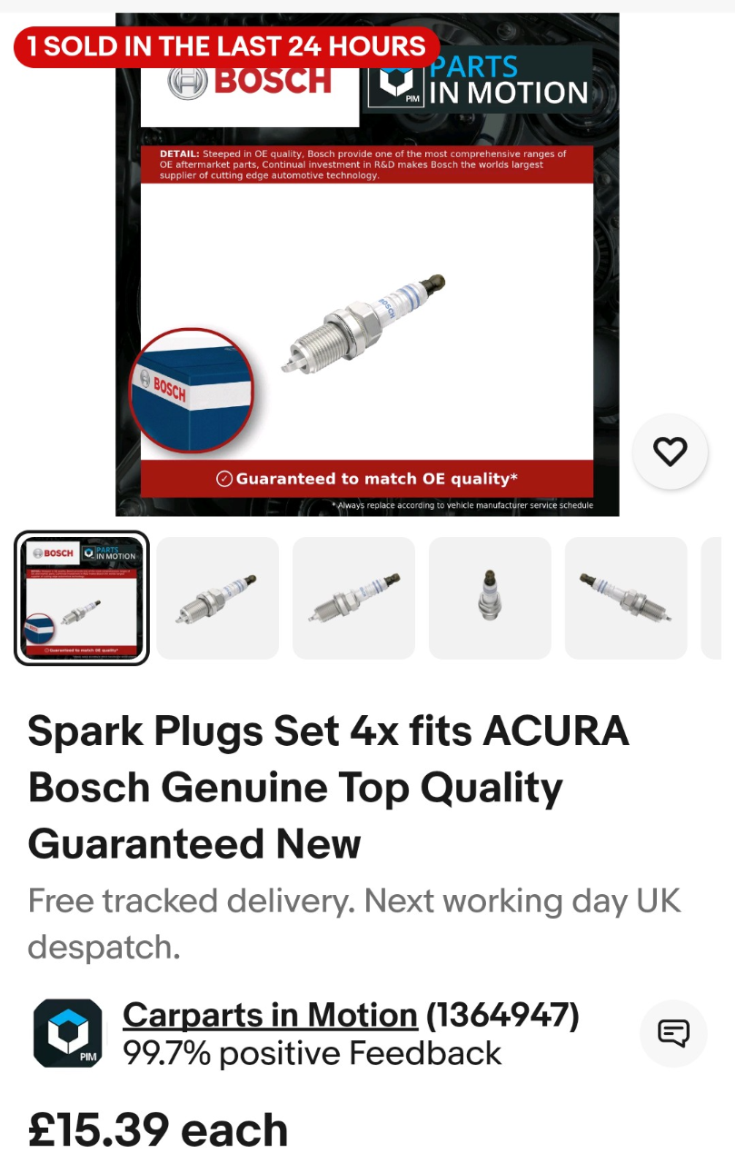

Plugs suit Z18XER.... 😉👍
