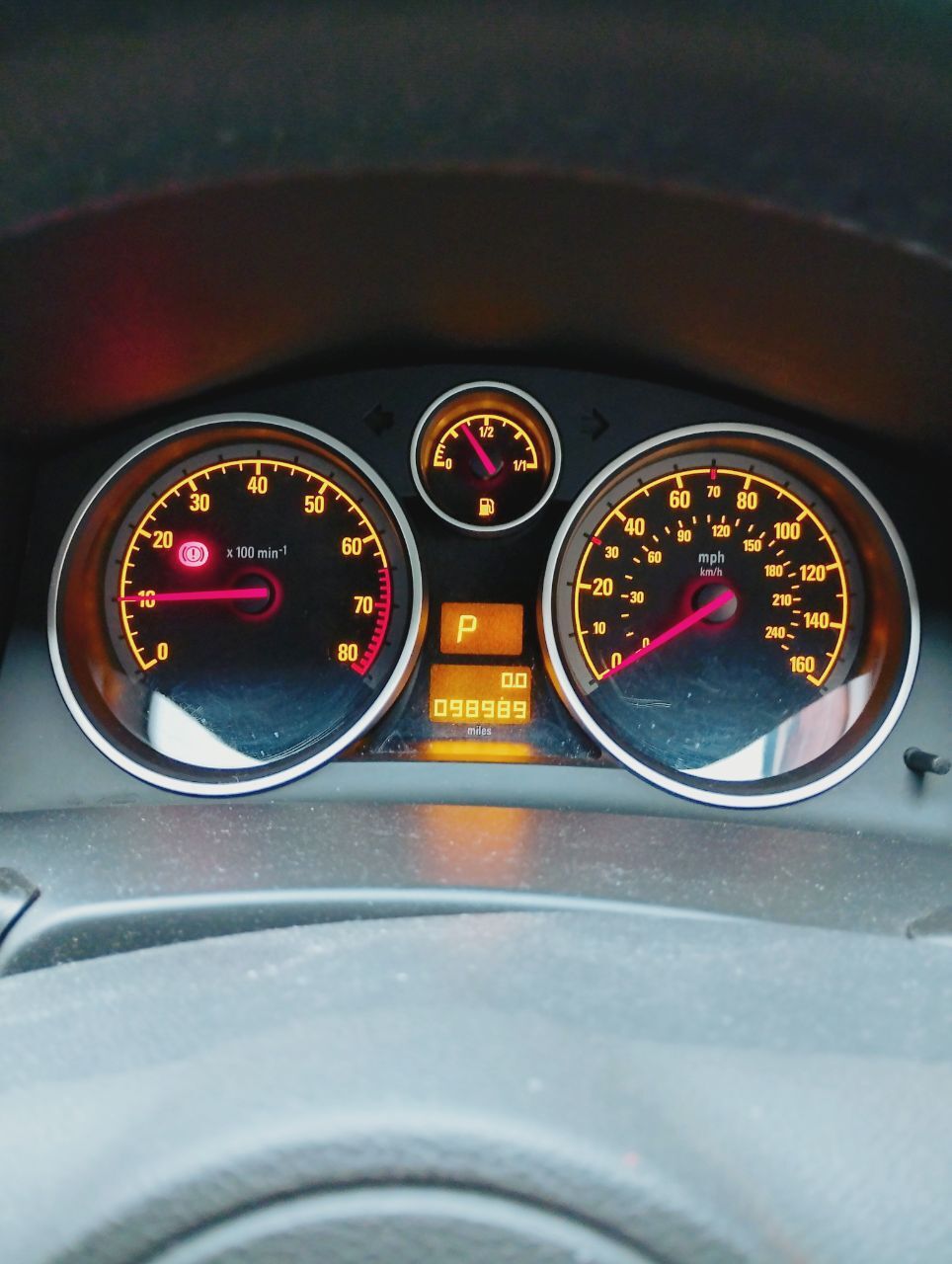

Oil + filter, Air filter & 4 Plugs @97,097m.

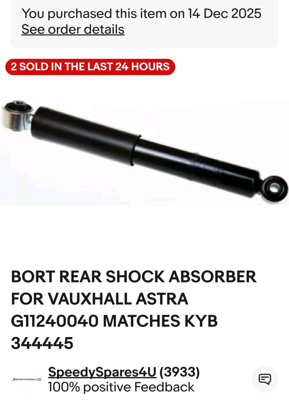

FleeBay rummage drawer 😮👍
£40, pair del.

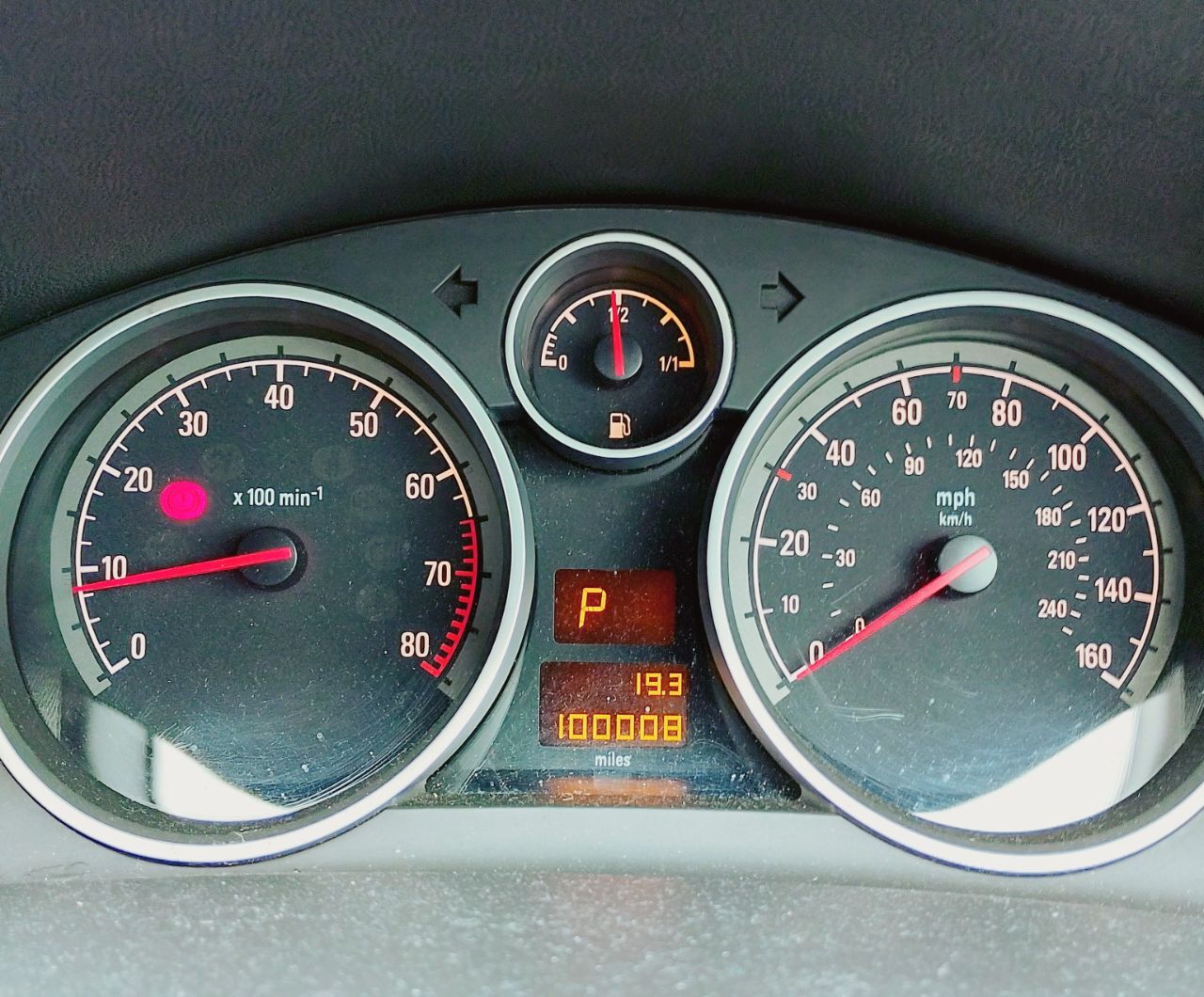

...... Heading for 100k.
Why not 😋

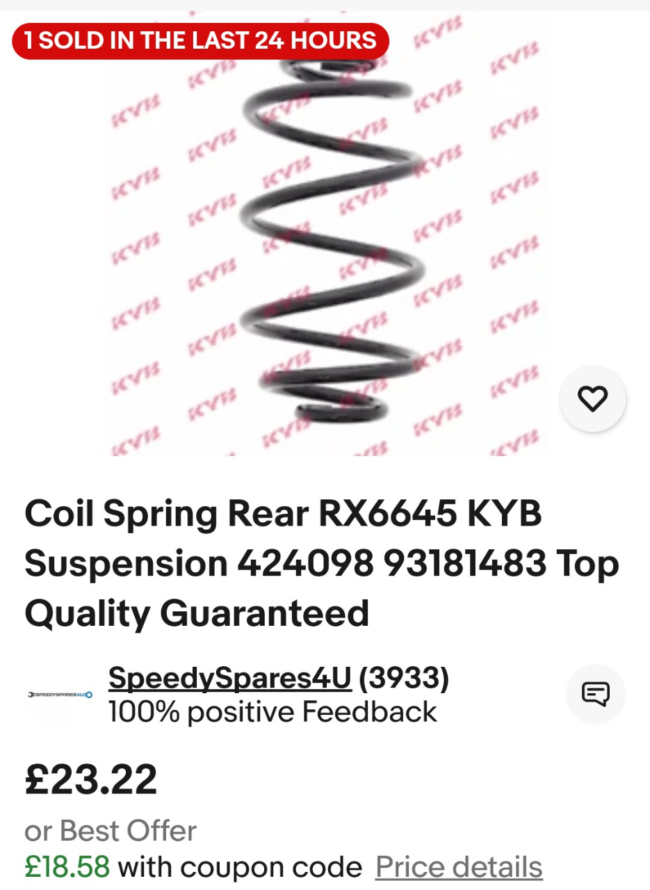

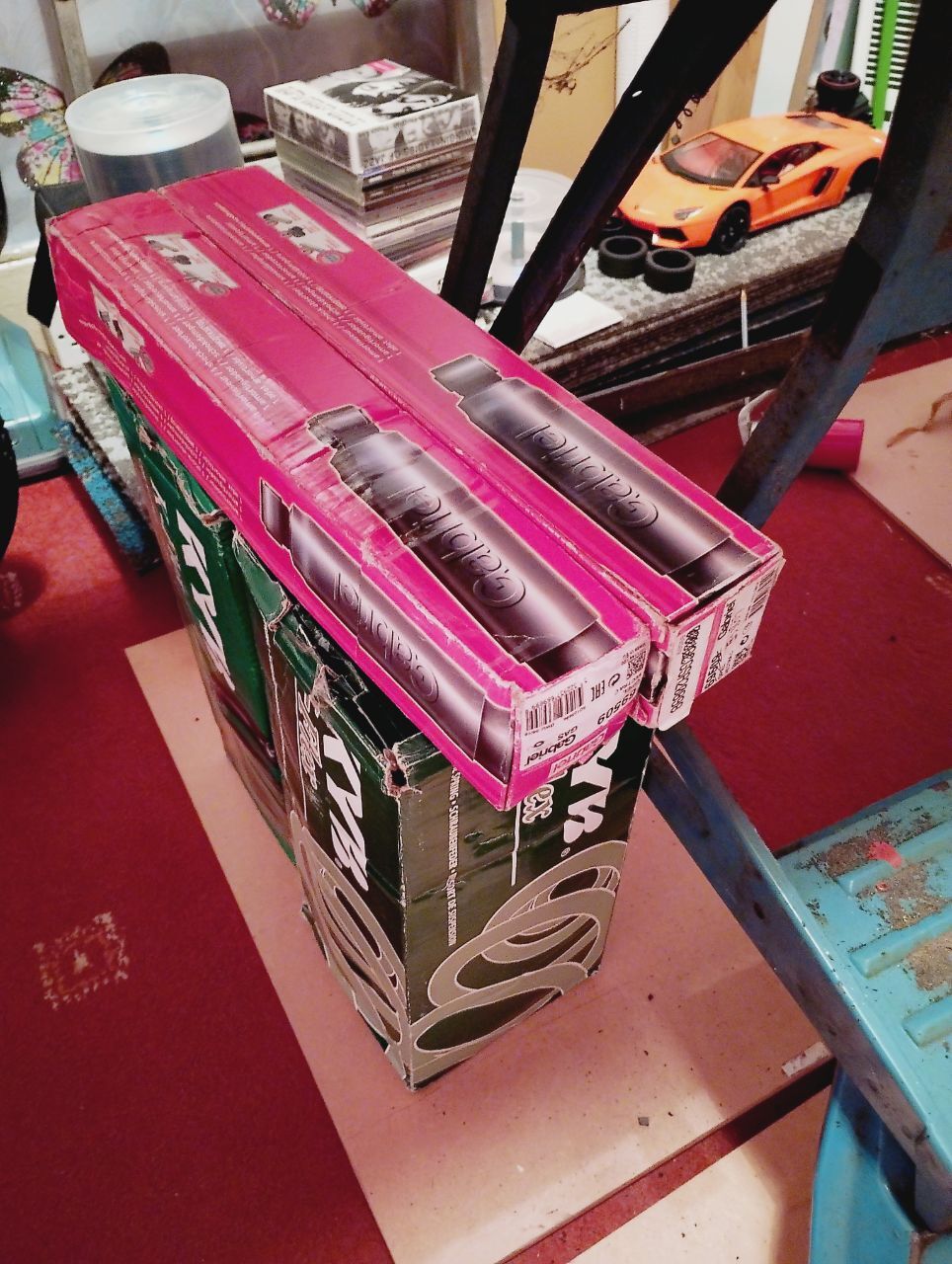

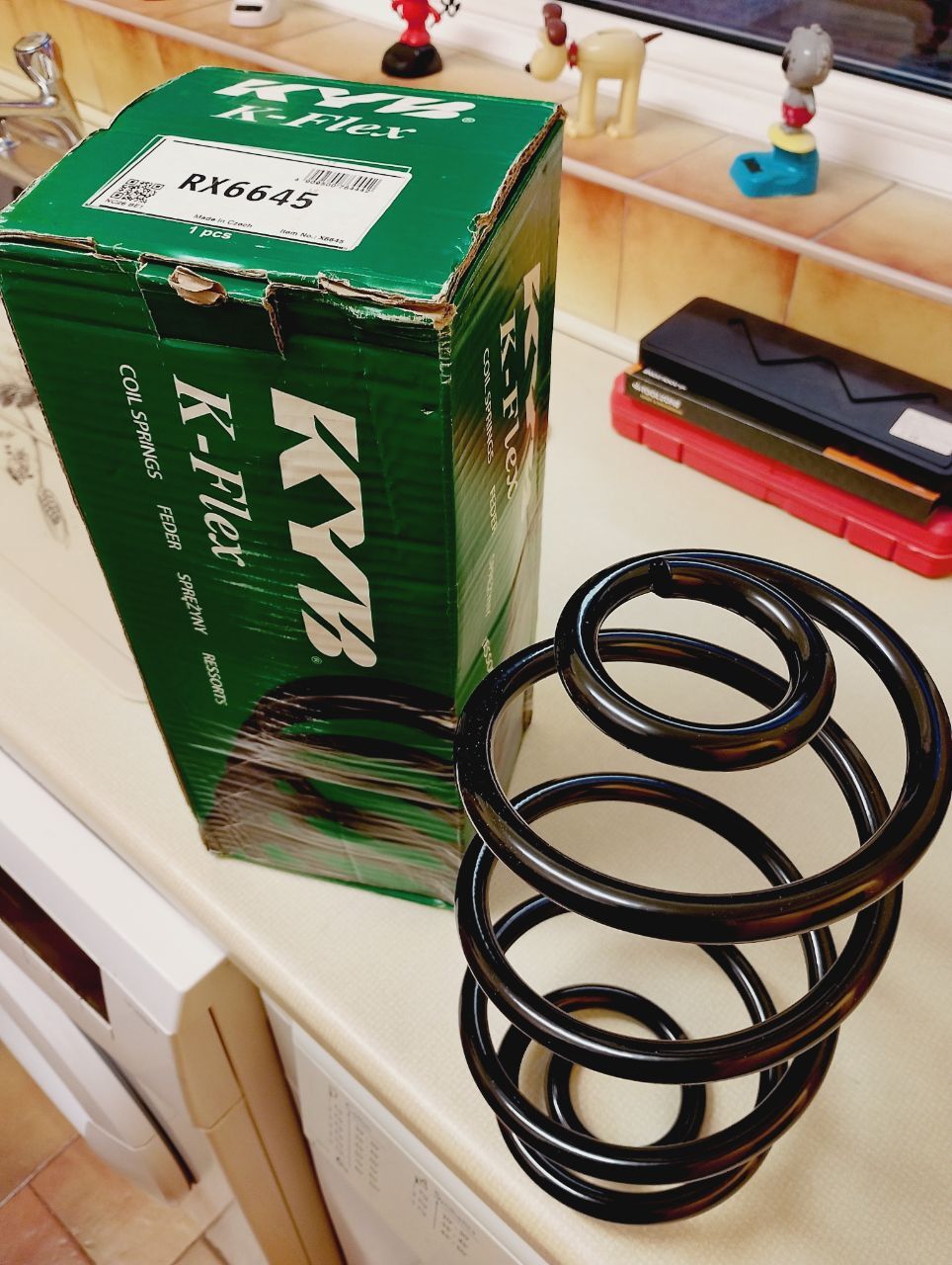

Hmmmm....... KYB come out of the *same factory (mebbies 🫣)
We Will See...
Hold the front page..... 🙄

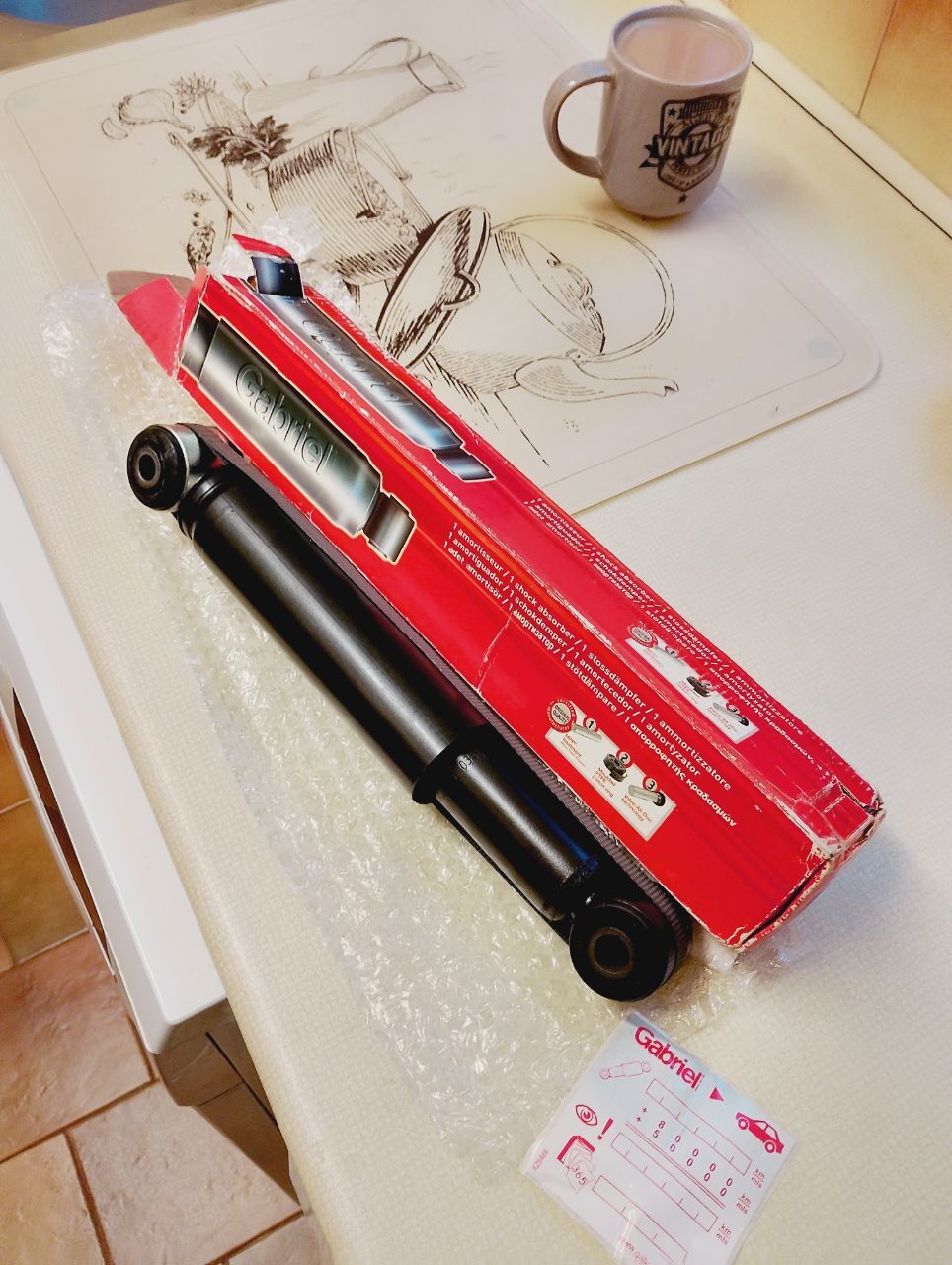

Supplier of dampers said 'sorry, problems with dampers' = offered refund. OK by me....

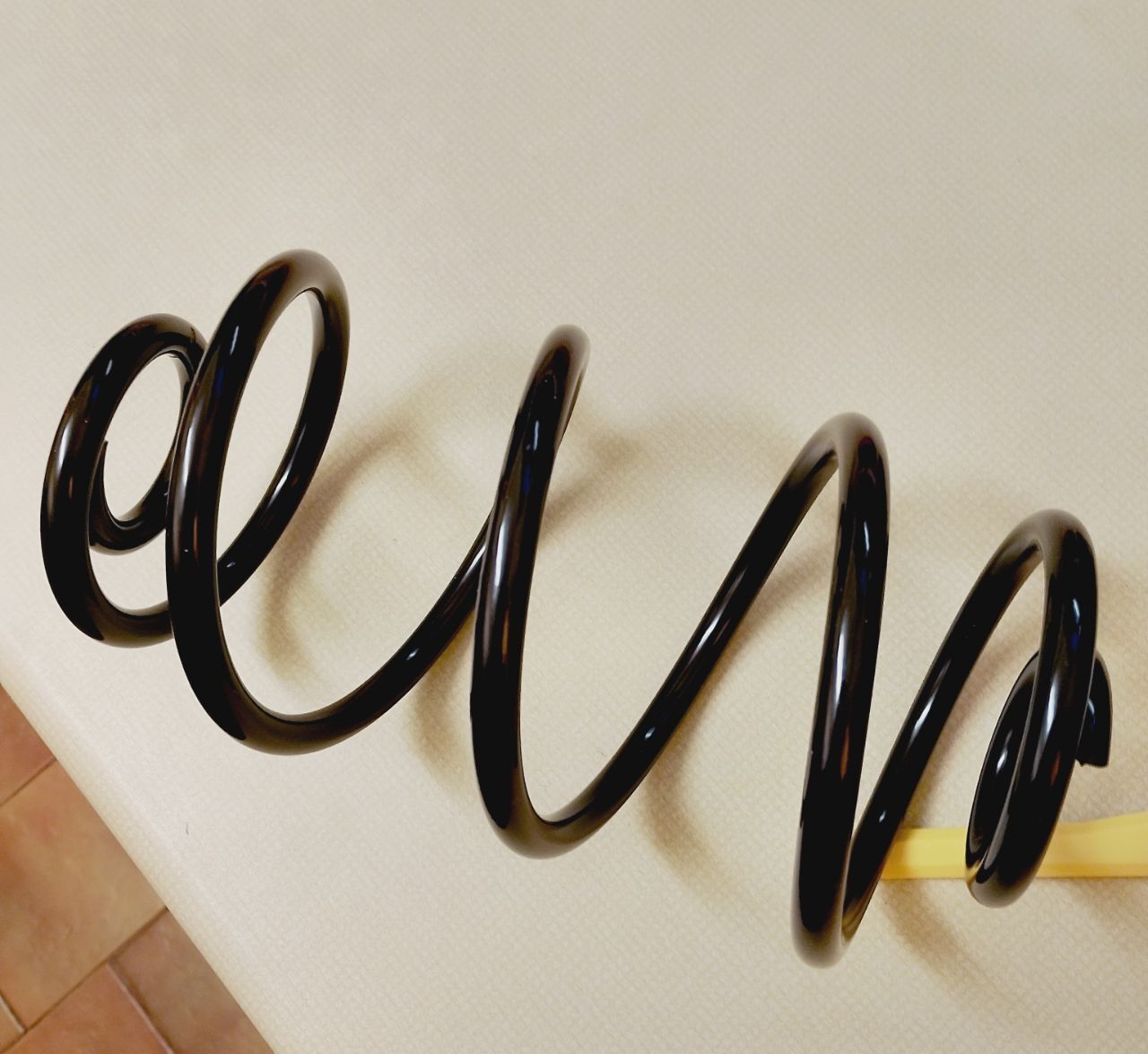

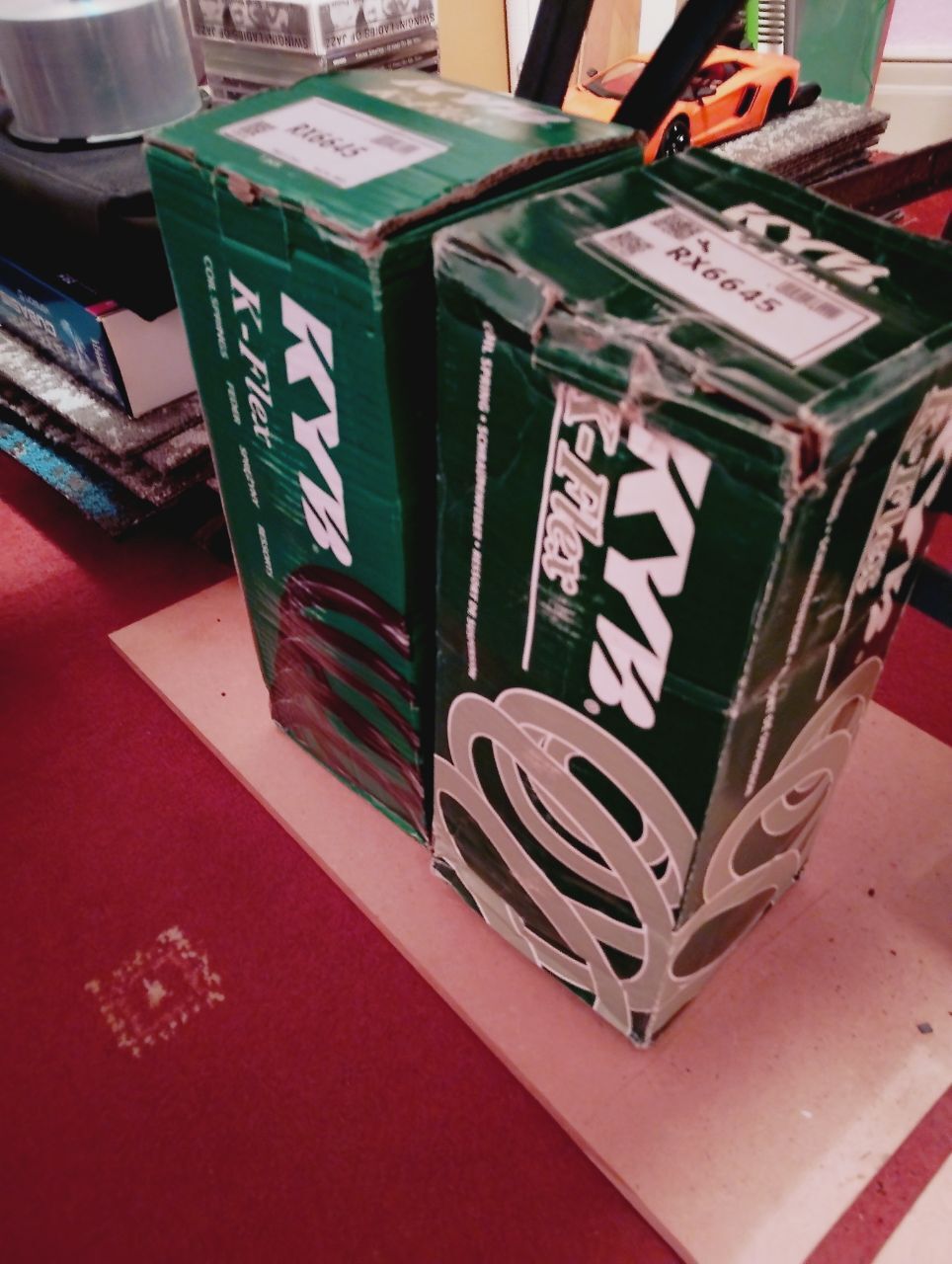

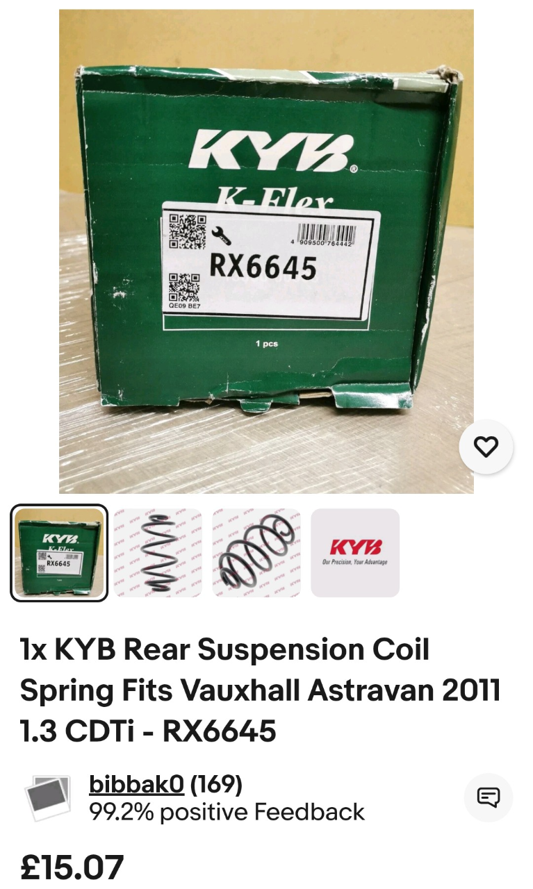

Picked up a couple of these 'old stock/tatty box' for the same price.....
These are Astra H Estate spec ✔️
Ha! I have an *interesting slew of Delivery options 🫣
Two springs [from different people] Post Office
One damper [different person] Post Office
One damper [different again] by Evri.
Santa's little helpers are gonna love it.....
We Will See 🙄
Ooooh..... So Smooooth 😋
1 down... 3 to go!
Twice the lurve...... 🥰
1/2 way to Happiness..... 😮

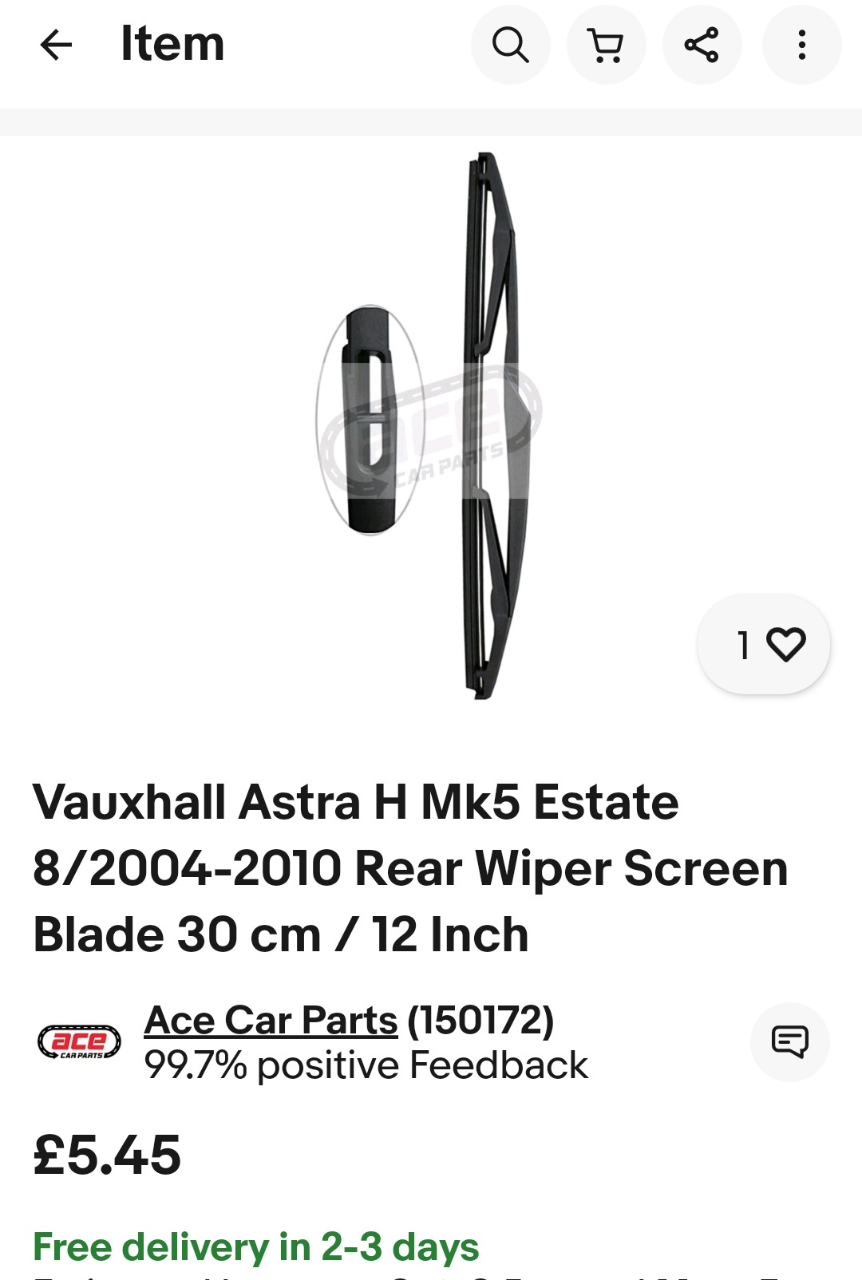

My rear wiper (new when I got it = 17m) has been declining in de-smearability for some while...
With all the $hite coming up the back, even on constant, the view is 'vaseline - ish' 🫤
Personally, super soft rubber blades seem to wear out quickly but do a good job / over these vynil blades which are crap for years 🫣
We Will See [... mebbies 🤣]
Blade now fitted.... the old one shows the edge to be mildly deformed, through the nature of parking with the rubber pressed one side to glass.

Just num8ers.....
JogginnOn... 😎
