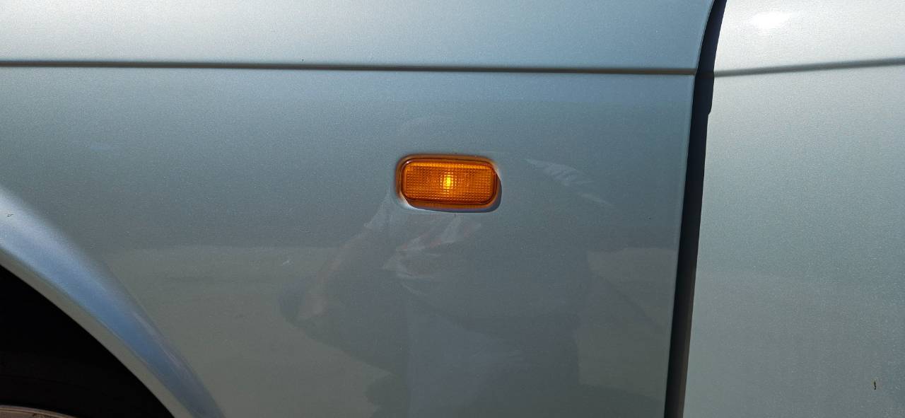

More lights. Driver's side turn signal repeater wasn't working and that was annoying me.
Turns out the wire they used had turned to powder.
Tore all that out and refitted with new. The car would originally have had a blanking plate in the hole.
However, it doesn't, so it now works.
Phil
