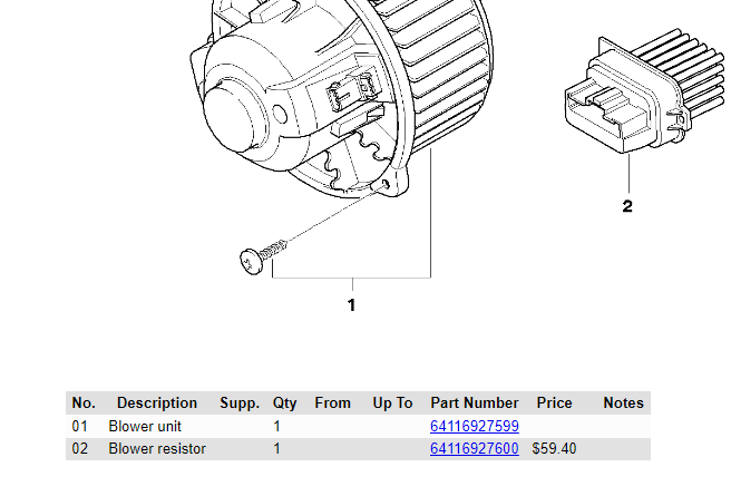

beko1987 Posted April 19, 2024 Posted April 19, 2024 I vote for neatly extending some wires out of the casing and refitting that then a short length of slack and some neat connections back to the rest of the loom, either crimps to test then solder or find a fancy suitable plug?
Cookiesouwest Posted April 19, 2024 Posted April 19, 2024 12 minutes ago, SiC said: No I haven't but I suspect it'll be hundreds of pounds. I did see a forum post from last year that said the resistor pack was NLA and factory back ordering since 2019. Maybe one of those things that they only make when enough orders come in? Either way, I don't really want to spend hundreds on this if I don't have to. Otherwise I'll be in money wise at more than buying a bigger engined nice one 🙃 Still need to buy a cheap laptop to run dodgy software and reflash that airbag module so it behaves properly on the network. I'm upgrading my think pad as its slow AF. Might be ok for your purposes though. When my newer one arrives next week from Markeh, you can have it. Specs are as pic SiC 1
riek Posted April 19, 2024 Posted April 19, 2024 Cotswold BMW do a discount for members of various BMW forums, m3cutters etc. you don't have to be active as a member either, I've only ever posted in the Cotswold section SiC 1
cort16 Posted April 19, 2024 Posted April 19, 2024 1 hour ago, SiC said: No I haven't but I suspect it'll be hundreds of pounds. I did see a forum post from last year that said the resistor pack was NLA and factory back ordering since 2019. Maybe one of those things that they only make when enough orders come in? Either way, I don't really want to spend hundreds on this if I don't have to. Otherwise I'll be in money wise at more than buying a bigger engined nice one 🙃 Still need to buy a cheap laptop to run dodgy software and reflash that airbag module so it behaves properly on the network. I've found with BMW the small things you think will be cheap like nuts and bolts and expensive but parts you think will be expensive are fairly prices. Real oem has it has $60 so I imagine it'll be the same in £'s from BMW in the UK. SiC 1
