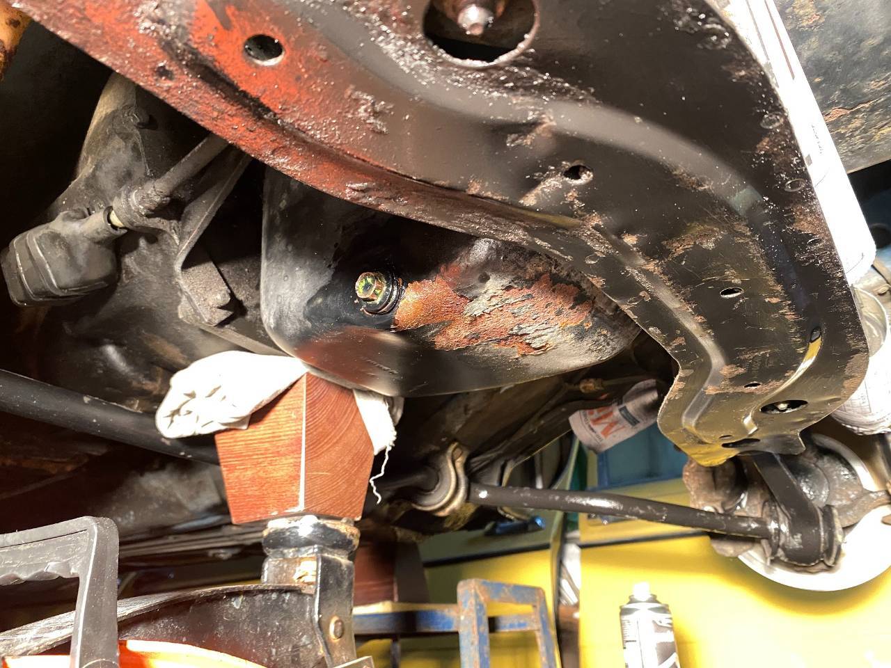

Peter C Posted March 23, 2024 Author Posted March 23, 2024 Another day off (Saturday), another day spent tinkering with the Sierra. I had a look under the car and noted a patch of engine oil on the workshop floor. The sump plug was leaking. When I drained the old engine oil a few weeks ago, I noted there wasn't a copper washer on the sump plug so I, foolishly, put the sump plug back in without fitting one. Rather than draining all the engine oil, my wife kindly volunteered* to hold a rag against the drain plug whilst I quickly put a copper washer on the sump plug and screwed it back in place. I only lost a little engine oil in the process. Hopefully problem solved. Next, I prepared and undersealed the front suspension components for that factory fresh look. I am pleased with the result. I had lunch in the workshop. My arms and jumper were soaked with paraffin and I was not allowed to eat with the normal people in the house. The engine sump was filthy. And corroded. I lifted the sump up and away from the crossmember by jacking up the transmission. Access was adequate, I managed to scrape off the rusty bits and clean up the good coatings. I painted the rusty and exposed parts of the sump with a high temperature black gloss paint. Whilst there, I also gave the steering rack a scrub. Much better. Finally for today, I rubbed down the rusty areas under the bonnet and painted them with Rust Oleum paint. I will dab some blue aerosol paint over the patches tomorrow. I also cleaned the old overspray from the two rubber seals. The plan for tomorrow is to finish off the decoration work under the bonnet, get the car back on its wheels and push it out of the workshop, where I can see better and touch up a couple of little chips and marks that are difficult to spot indoors. With the Sierra outside, I will be giving my workshop a deep clean. Dannyk, danthecapriman, Wibble and 22 others 25

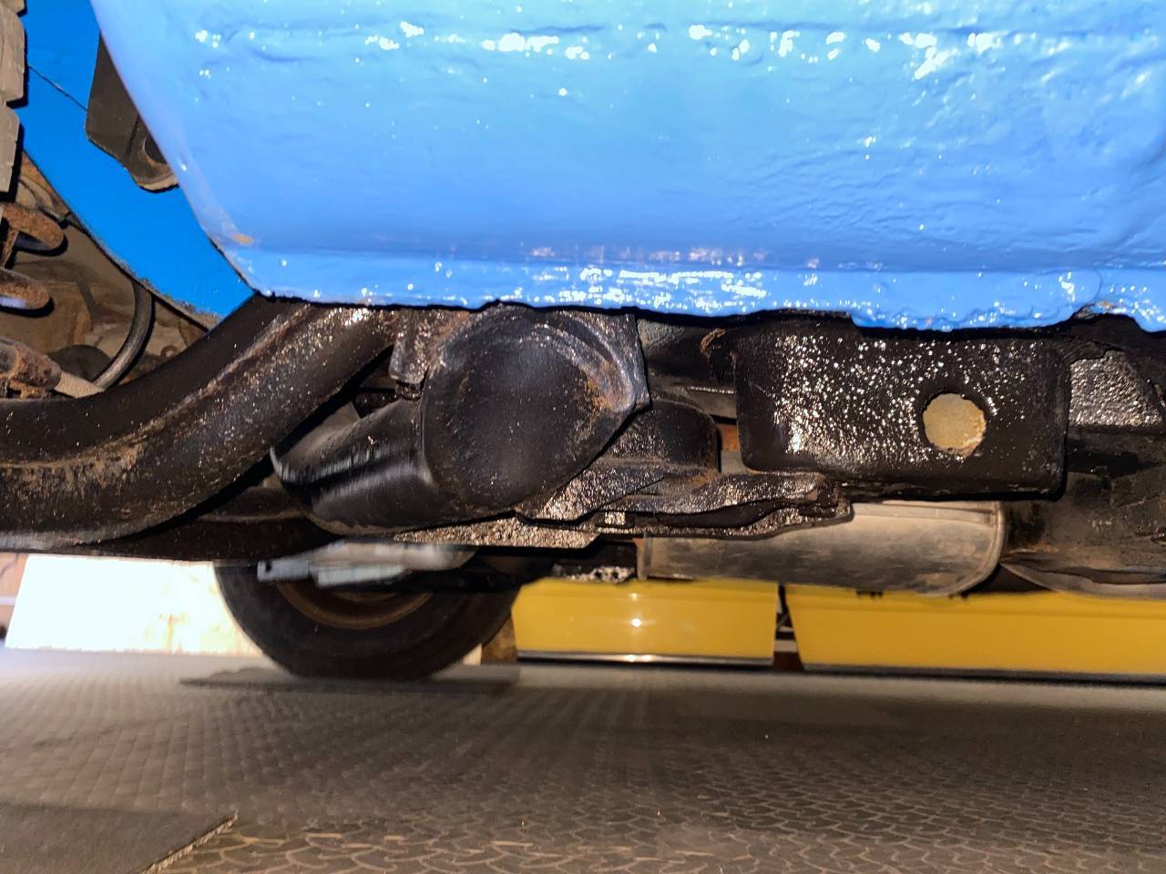

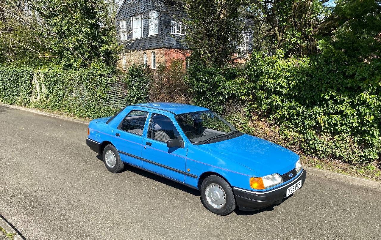

Popular Post Peter C Posted March 24, 2024 Author Popular Post Posted March 24, 2024 I've been looking forward to this day for the past two months. Once the Sierra was back on its wheels, I undersealed the jacking points that were concealed by axle stands / ramps. The other side is the same. It was time to pull the Sierra out of the workshop. As the underseal was still fresh and the car isn't taxed, I only drove the Sierra to the end of the road and back to outside my house to take photos. At this stage, I recommend that you rewind to page 4 of this thread and remind yourself what the Sierra looked like on the 30th January, the day it arrived from Northern Ireland. I am pleased with the results and I'll let the photos do the talking. Please note that I haven't washed or detailed the bodywork and trim yet, hopefully I will get a chance to do that next weekend. The bonnet, roof and boot lid look much better in sunlight than they do under a LED lamp. Yes, if you look closely and at the right angle, you can see the fine scratches but overall, the paint looks great. Remember how the four corners looked? The tarpaulin that the Sierra was stored under rubbed the blue paint off down to primer / bare / rusty metal. My masking off and dabbing of blue paint has worked well. Up close, you can see the touching up but I am pleased with my low cost solution. The sills and inner sides of the rear wheel arches look much better too. The boot lid and rear valance now gleam. I left the engine to idle for about 15 minutes and it ran well, nice and quiet, with no smoke. The temperature gauge reached half way quickly (and stayed there) but the coolant level was still low. The idle speed is a little too fast, I need to work out which screw needs a tweak. With the Sierra outside, it took me two hours to clean the workshop. EVERY surface was covered with a layer of black overspray dust, which spread when I was painting the bumpers. Got there in the end. I put the Sierra back in for another week, until it can be taxed and driven from the 1st April. The 1st April is a Monday. According to the forecast, the weather should be dry. Let's hope so. Jim Bergerac, beko1987, timolloyd and 54 others 57
