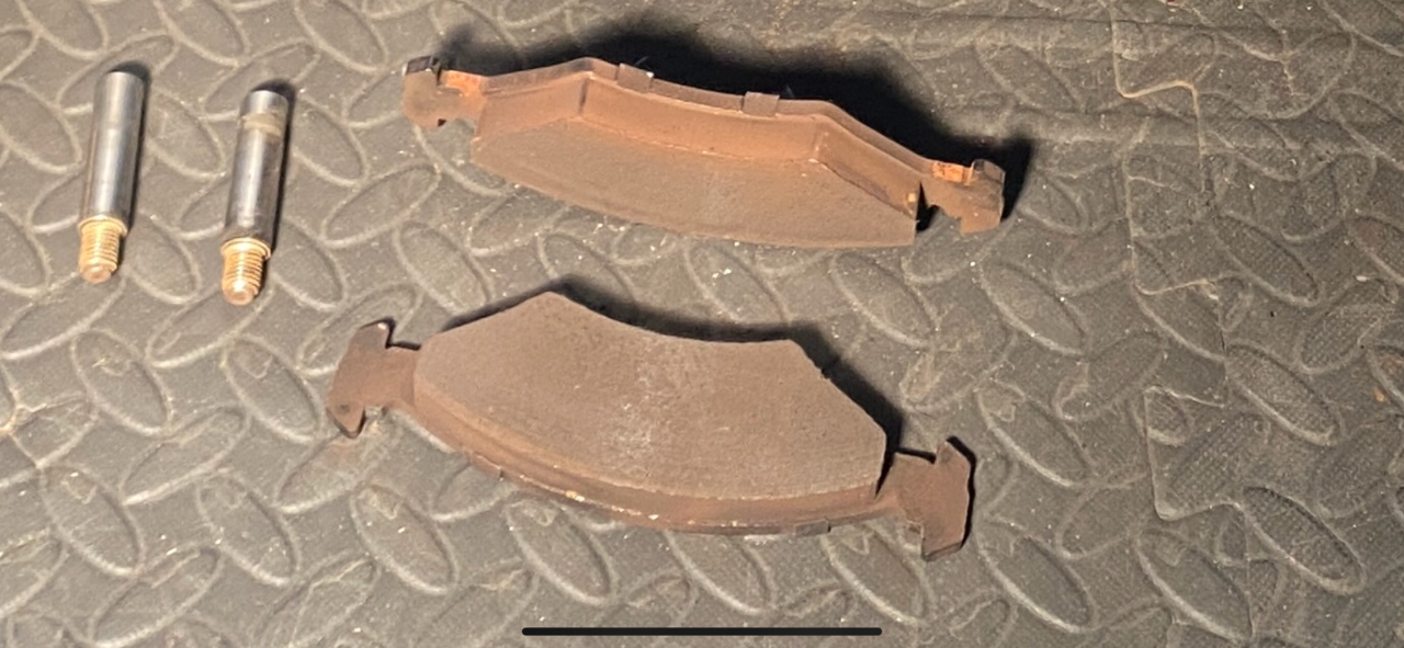

MVX11V Posted October 28, 2025 Posted October 28, 2025 Well, I just recently had my first ever glazed pads and hardening of the pad material causing extreme and uncontrollable brake judder. Discs were within, tolerances, better than the new ones I replaced them with. Peter C 1

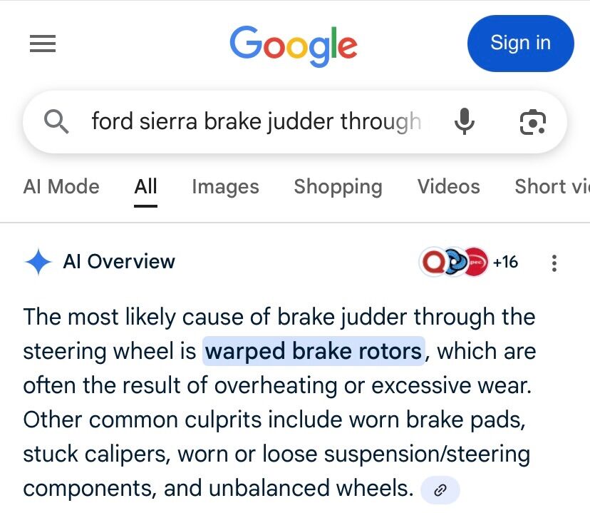

vtec-e Posted October 28, 2025 Posted October 28, 2025 I think you've got a warped disk, probably on the old rusty caliper side. I recently had a warped disk on the back of the Ix20, and could feel it when braking. If new disks are cheap and easily available, I would replace them first and see if that helps the juddering. danthecapriman, AnnoyingPentium, Peter C and 1 other 1 3

Peter C Posted October 28, 2025 Author Posted October 28, 2025 6 minutes ago, Wibble said: New pads too, I hope. My pads have plenty of meat on them and I propose to give them a little rub down prior to fitting.
