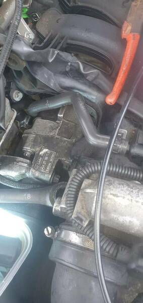

wesacosa Posted December 17, 2023 Author Posted December 17, 2023 Managed to find some time to take a look at the rough idle/MILF light issue. It was suspect by previous owner @Volksyto be the infamous $12 hose (crank breather hose) buried under the air filter housing air filter housing was a bit of a pig to get off. Something was catching at the back which I couldn't see for ages. Buying a set of remote hose clip pliers did at least make it a one man job and not two. Whilst disconnecting the ecu hose I did notice some small drops of oil. There is a well known issue of VCT leaks causing oil to travel down the harness into various parts of the electrical control circuit so will given them a clean and fit the blocker harness to prevent further oil potentially causing damage The vac hose is absolutely mullered. Seems MB used too soft a rubber compound and it just breaks down with heat. This one is totally fucked unfortunately the end onto the block has broken down so much its bunged the hole so some careful cleaning is required Was hoping to have it done this afternoon but lost 45 mins as butter fingers t**t dropped his phone down into the bowls of the engine bay whilst using it as a torch CaptainBoom, rob88h, Volksy and 4 others 7

wesacosa Posted December 19, 2023 Author Posted December 19, 2023 well this is turning into one of the most unpleasant jobs I've had to do. Lost all tinkering time yesterday because you just can't get enough purchase on the pipe to slip it over the spigot on the block you can only get hands around it to push downward but not twist and wiggle it on. With long nose pliers your hands get in the way as the pipe is bendy and zig zag shape. So had to order some long handle needle pliers which only arrived today managed to get it on reasonably quickly after work but the jubilee is another story. You just can't wiggle the back side down. That said, fucking knob head dropped his phone down the bowels of the engine bay for a second time and wedged it even better this time so any last bit of daylight was spent lying on a wet road with cars whistling inches from my head trying to retrieve it I have to say the access on this pipe is worse than anything I saw on the XM. Volksy, Pat Earrings, Back_For_More and 2 others 1 4
SiC Posted December 19, 2023 Posted December 19, 2023 Bit late now but silicon spray is excellent in making rubber slippy enough to just slide on without too much of a fight. wesacosa and chaseracer 2
wesacosa Posted December 19, 2023 Author Posted December 19, 2023 7 minutes ago, SiC said: Bit late now but silicon spray is excellent in making rubber slippy enough to just slide on without too much of a fight. I had tried that, and heating it in boiling water. It was just too squishy to push over the spigot with the angle you push with your hands. The silicone spray and the long handled pliers made light work of it though..I will try swapping the jubilee for a thinner one tomorrow and use some more silicone or red rubber grease and see if it will pop on
wesacosa Posted December 20, 2023 Author Posted December 20, 2023 well one step forward, two back got the clamp on pretty easy this morning, amazing what a difference daylight and dry weather makes however the airbox is the most pathetic miserable lazy excuse for engineering I think I have seen a bit of a challenge You have to push the back plastic hose onto a soft rubber bellows but you can't see most of it never mind get your hands or tools around it so of course it just squashes the bellows and doesn't seat properly will try again tomorrow but its so frustrating that a 1 hour job is turning into a massive epic due to just simple bad packaging design CGSB and rob88h 2
Rust Collector Posted December 20, 2023 Posted December 20, 2023 I've joked about it in my thread but I find a dab of KY jelly on hose barbs/slip joints etc. makes these things just slide together when before they were snagging. I keep some in the garage for wanking reassembly purposes. HillmanImp, rob88h, Stanky and 4 others 7
wesacosa Posted December 20, 2023 Author Posted December 20, 2023 Ha ,yeah I did use silicone spray but the problem is you can't see if you are lined up correctly or if you are pushing on the bellows. You have to manipulate the back part of the airbox passed a load of other bits at a funny angle and then kind of drop it down and back at the same time. It will likely slip over easily if its lined up properly but you just can't tell what you are doing.. When the airbox is dropping down you can see maybe 100 deg of the circumference but once its almost in postion for the last drop you can see maybe 50 or 60 deg and the rest is obscured from view. Its really a bloody stupid design rob88h and Rust Collector 2

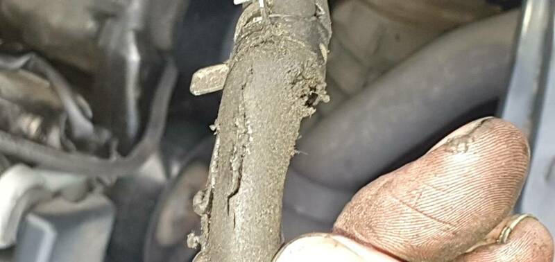

wesacosa Posted December 22, 2023 Author Posted December 22, 2023 one step forward, two back again today think I got the air filter box on properly. I say think because as per the previous post you cant actually see or feel the whole circumference of the pipe. what the absolute fuck were Mercedes thinking however in the process of getting it into position I have snapped the connector for the brake servo vac hose HillmanImp, Rust Collector, N Dentressangle and 1 other 4
N Dentressangle Posted December 22, 2023 Posted December 22, 2023 A really good clean and a few winds of very sticky tape will sort that out. New one is only £10 or so if you can be bothered. Rust Collector and wesacosa 2
wesacosa Posted December 22, 2023 Author Posted December 22, 2023 21 minutes ago, N Dentressangle said: A really good clean and a few winds of very sticky tape will sort that out. New one is only £10 or so if you can be bothered. is that from the dealer? I couldn't find a replacement part with a quick Google search just second hand ones
N Dentressangle Posted December 22, 2023 Posted December 22, 2023 No idea, sorry - the one I was looking at is for a Sprinter, but looks v similar to yours. Need a part nr really, and I can't see an equivalent to RealOEM for MB. wesacosa 1
wesacosa Posted December 22, 2023 Author Posted December 22, 2023 20 minutes ago, N Dentressangle said: No idea, sorry - the one I was looking at is for a Sprinter, but looks v similar to yours. Need a part nr really, and I can't see an equivalent to RealOEM for MB. there doesn't seem to be a part number, only the one printed on the hose which looks to be the generic number for the hose as it appears on other hoses
SiC Posted December 22, 2023 Posted December 22, 2023 I think I'd glue and tape that back together too myself. Then if possible when fitted, stick a zip tie around the whole thing when mounted. CGSB and wesacosa 1 1

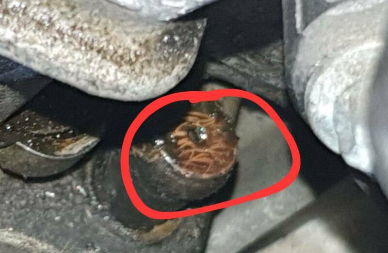

wesacosa Posted December 22, 2023 Author Posted December 22, 2023 one step forward, two back (a familiar tale) bodged the pipe back on and started up engine but noticed coolant pooling under headed tank. this plastic pipe has somehow shared off but so close to the tank I cant just push the rubber hose up closer I had hoped this car would be a low maintenance winter beater whilst I tried to get my mojo back and sort out the rest of the fleet but its proving to be a bit of a pain in the arse as nice as it is to drive I'm starting to feel one step away from being done with it, although that's probably just my bad mood talking. It does now look like I'm going to be car-less for the festive period though as can't imagine im going to be able to source and fit a replacement header in a hurry
N Dentressangle Posted December 22, 2023 Posted December 22, 2023 Something like a small piece of microbore central heating pipe tapped in there, plus maybe a bit of JBWeld? It shouldn't run at massive pressures, so might work OK. Stanky 1
Stanky Posted December 22, 2023 Posted December 22, 2023 1 minute ago, N Dentressangle said: Something like a small piece of microbore central heating pipe tapped in there, plus maybe a bit of JBWeld? It shouldn't run at massive pressures, so might work OK. Yeah +1 to this. Measure the inner bore and then gently push a short section of metal pipe into the two split plastic pipes to join them as an inner sleeve? Or if you could find a metal threaded pipe joiner you might be able to wind it into the two parts of the plastic extruded pipe to join them that way?
SiC Posted December 22, 2023 Posted December 22, 2023 Part of the problem is that plastic goes brittle with age and these cars are past their original design life (probably double really!). The other part is that plastic goes more brittle with cold. So winter working on a 90s/00s era car is a careful balance of getting a job done quickly when you're cold and being awfully careful to not snap the many plastic parts in the engine bay! N Dentressangle 1
