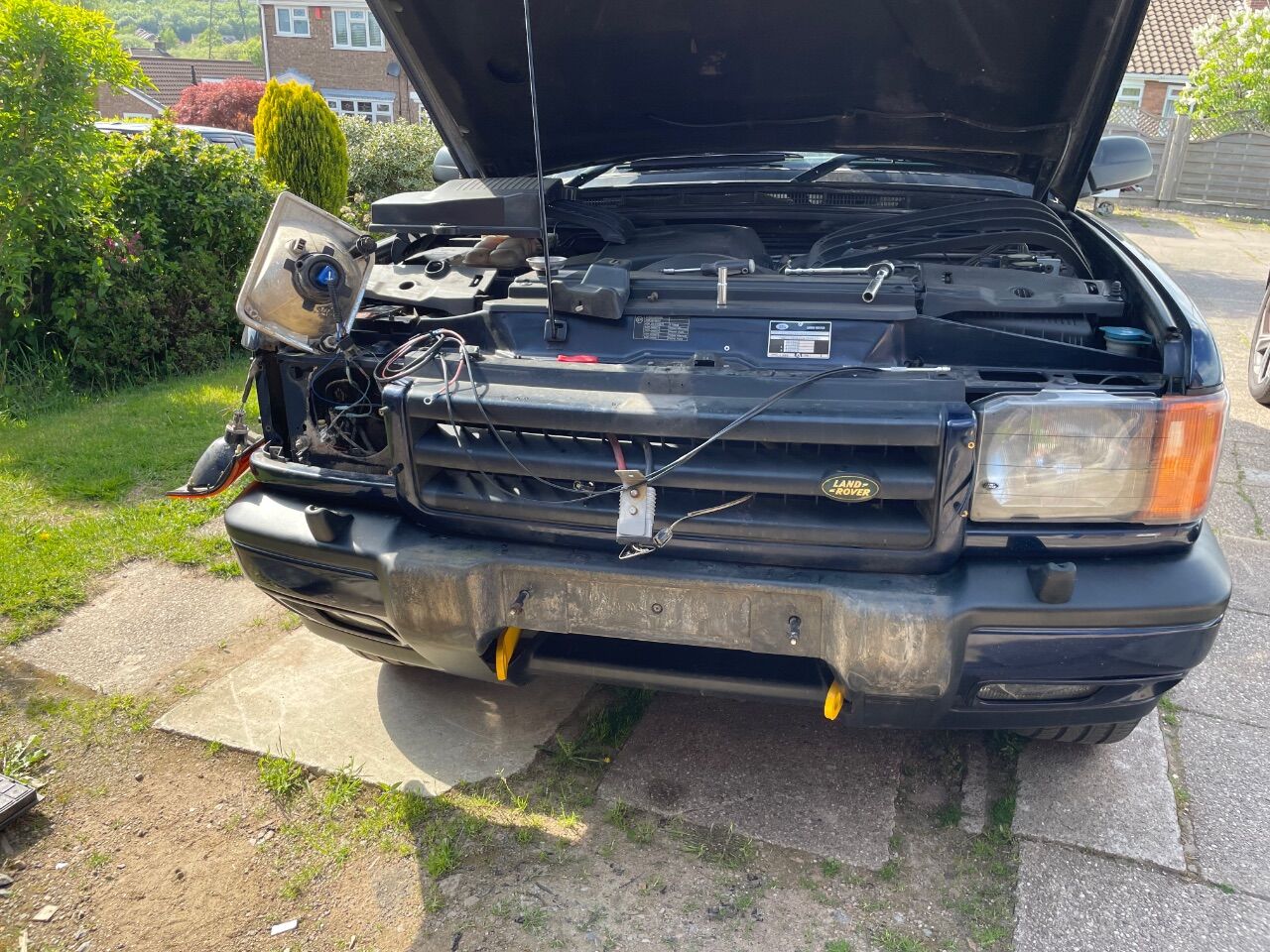

I bought some new headlight bulbs in an attempt to blind oncoming traffic*.
osram night breaker 200+++++s.
It has been noted that the previous bulbs are a different colour between dip and high beam. Which was weird. On removing the old bulbs, they appear to be “Alite 150%+++” bulbs! Ahhh. Lol.
got the drivers side in, what a faff. But just check out that difference!!
not much is there? Maybe a little. We will see when I go to work tomorrow.

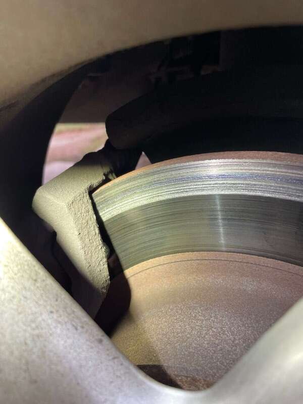

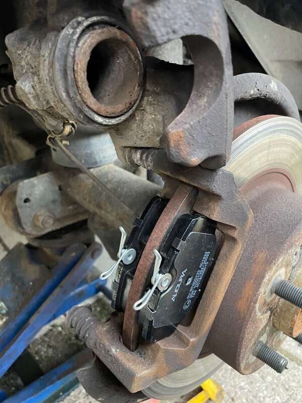

Happy new year etc etc. discovery has been battling though the winter without a hitch until Sunday afternoon. I had a meeting down In Birmingham and on my return noticed a grumbling at low speed braking. Turned out to be shot pads.
Definitely something amiss
on a Sunday afternoon the only sensible option is to go to euro car parts for £15 pads. I needed this back on the road for Monday morning without fail.

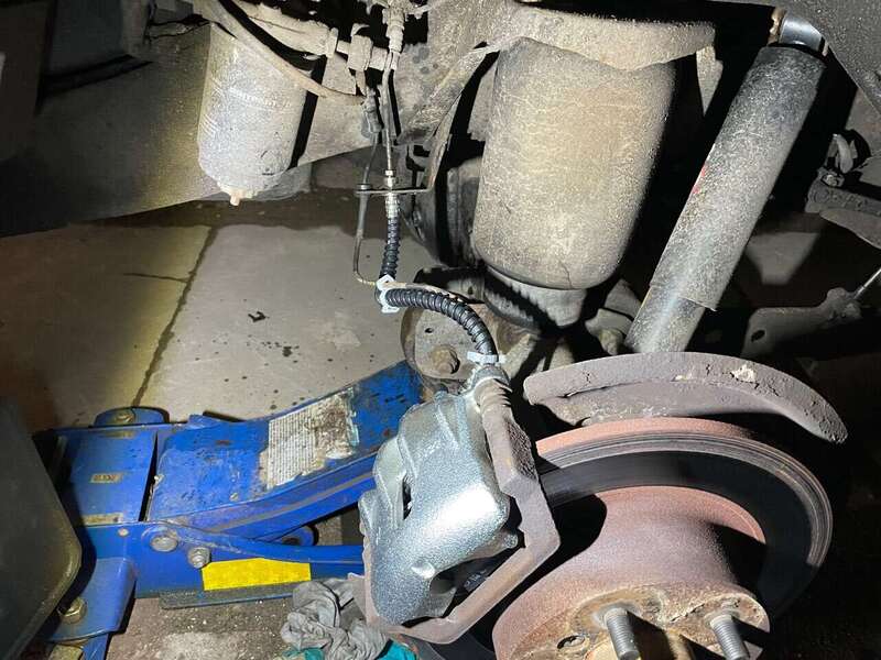

Monday afternoon after work I picked my lad up from nursery, on arrival I could smell burning brakes. Great. Caliper or hose has failed, no smell or hot brake on Sunday though?
ordered new caliper and hose Monday evening and got the wife to collect them today.
the brake pipe came apart without fail. Infact, dead easy.
new hose and caliper fitted. Wife got back from nursery at 5pm and it was bled up by 10 past. Easiest caliper/hose replacement ever.

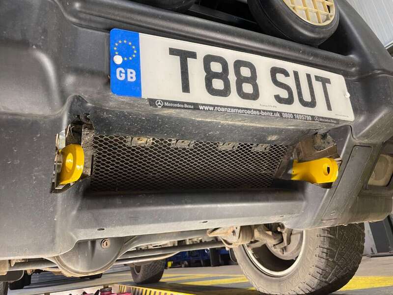

A few jobs done today.
the D2 is notorious for not having any decent towing points. You can buy these bolt on tow points that bolt directly to the chassis. Some cutting is required.
and copper grease added for durability.
they were painted in 2 pack yellow for visibility reasons.

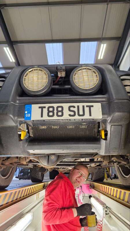

I had been after some new spot lights for the front end. I particularly wanted truck spots with a 5w side light to compliment the original side lights. I got a pair of SIM 9inch spots from a chap that comes to my work for MOTs. top fella.
fitting them turned out to be a huge job as the bolts are not accessible without removing the nudge bar. Which the bolts were seized into the captive nuts…. So it got ripped off.
a new relay loom was fitted to activate off the main beam feed, instead of the original switch inside.
the new lamps were fitted to the nudge bar, and bolts covered in copper grease.
then the bar refitted with some longer bolts straight through.
quick test, all working.
100w bulbs were fitted to the lamps. Max wattage for the lamps and relay.
and the number plate fitted to the protruding bolt threads. Perfect.
