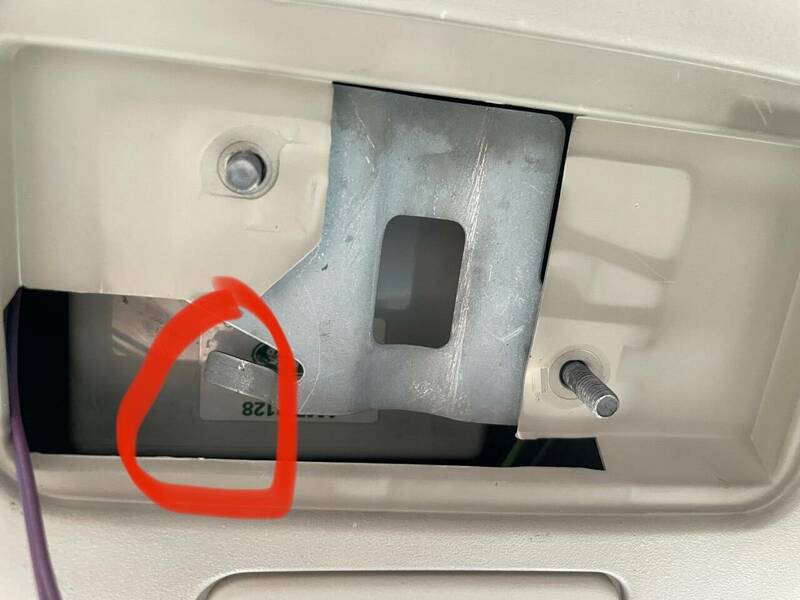

Interior lights: normally* it is the earth that is switched by the wee button thingy in the door jam so +12v at the light fitting all ofthe time.
** Landrover may be weird and different because OLLI.
Yes, but I’m sure there should be a wire attached to this, as I can’t find one. There is no earth otherwise.
3 minutes ago, EyesWeldedShut said:
Gets my vote too. Just make up another earth wire if you can't be arsed fishing for it.
That light is the same as the Disco 1 and is simple. The P38 style ones (pic further down that thread) have a little circuit board on the back which gets fried by the leaky sunroof.
10 hours ago, EyesWeldedShut said:
That one has a satnav unit in place, which I’ve never seen before. Different plug. But I’m still coming to the conclusion that the earth lead is missing.

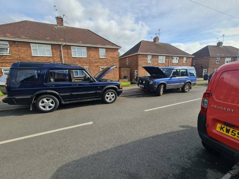

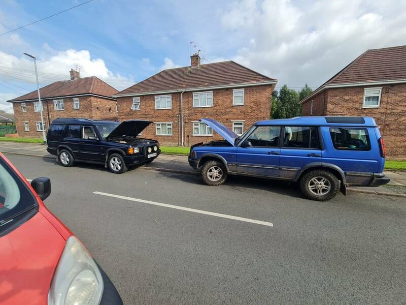

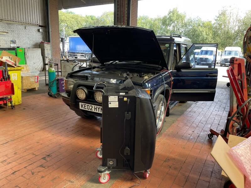

A few jobs to do today.
first. Just needs regas m9

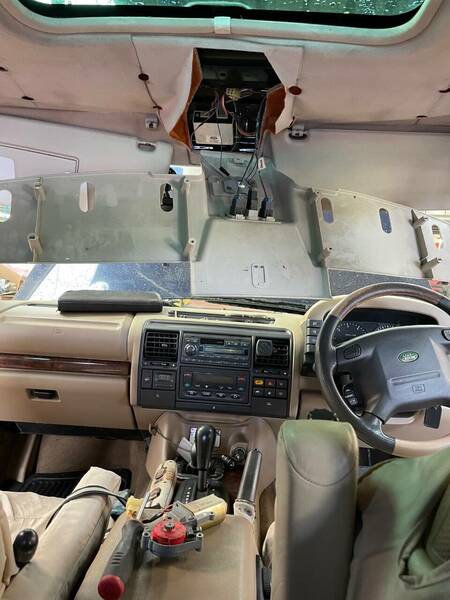

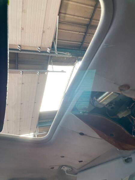

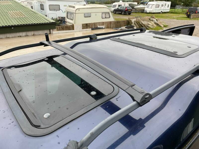

While the A/Cs are doing A/C things, I’m removing the motors from the sunroofs and swapping them over
Front sunroof now opens. Yay. Need a motor now.

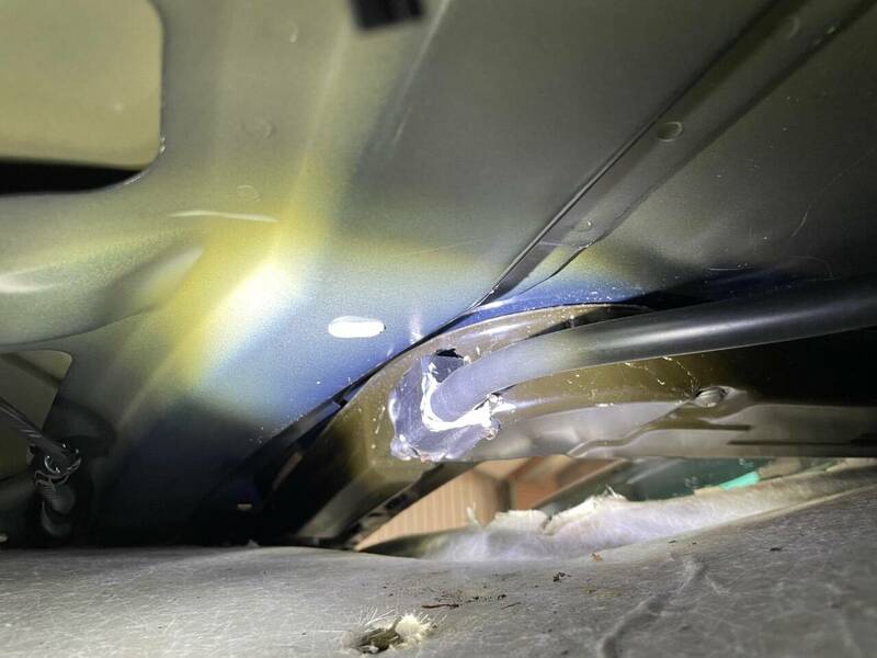

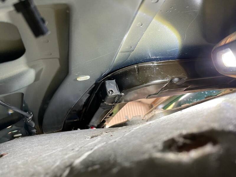

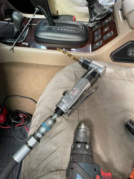

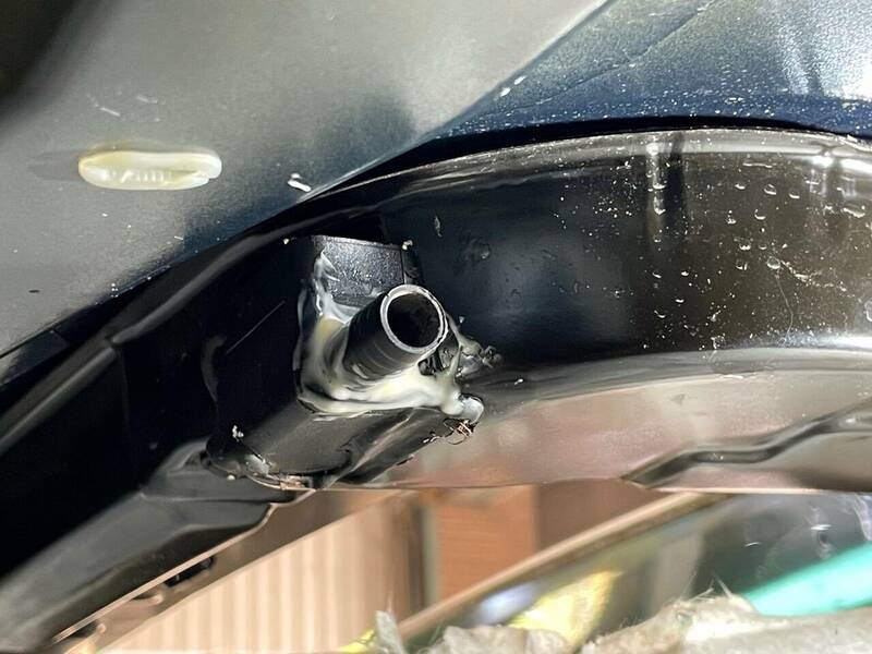

The drain is hard to get to so dropped the lining a bit. Snapped the end off, bugger.

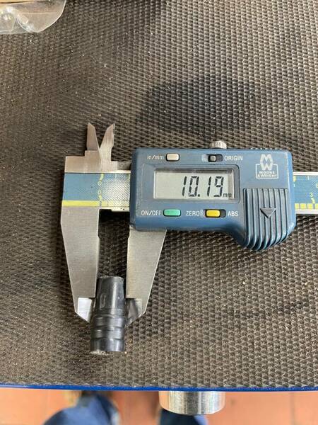

measured the piece that broke off and drilled the hole out.
this is glue. Stonnnnnnnnnnng stuff.
temp fix
So far so good.
tested the sunroof drain.
works. Awesome. Headlining is now goosed though.

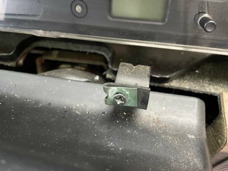

and then there’s this. Why is this loose? Ahhh, no screw. Fucking idiots.
A/C now A/Cs icy cold air! Lovely.

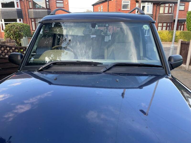

I also rearranged the wipers, as they had been fitted wonky. One up, one down. Now looking much straighter.

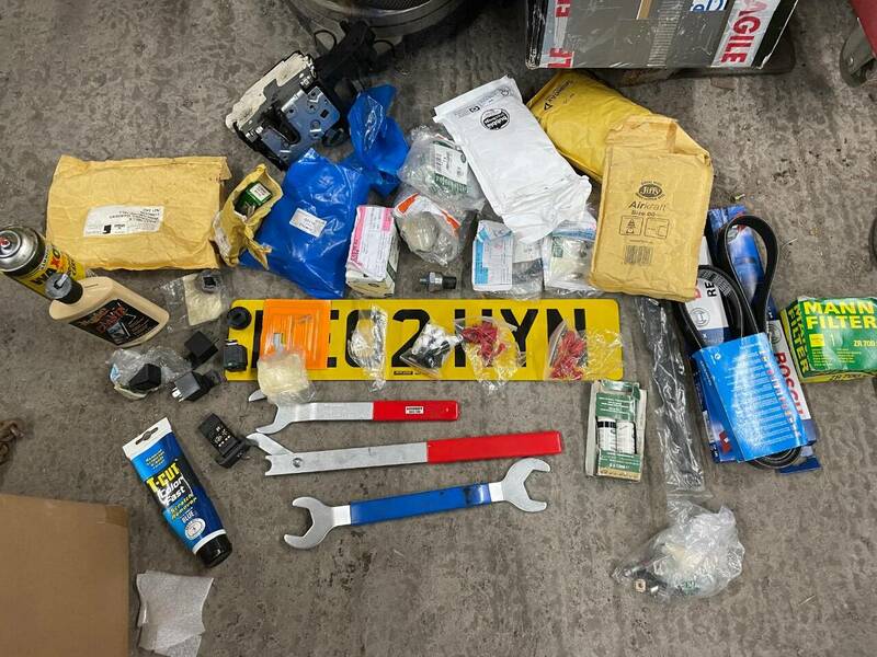

I found these in the boot, neatly tucked into a proper carry case
winner. Set of nice roof bars will come in handy!
and the contents of the box?
lots of bulbs, trim clips, switches, spare belt, belt tools, 2x rear number plates for trailers, more bulbs….

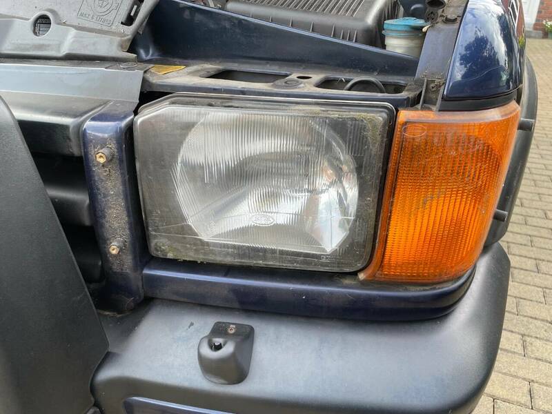

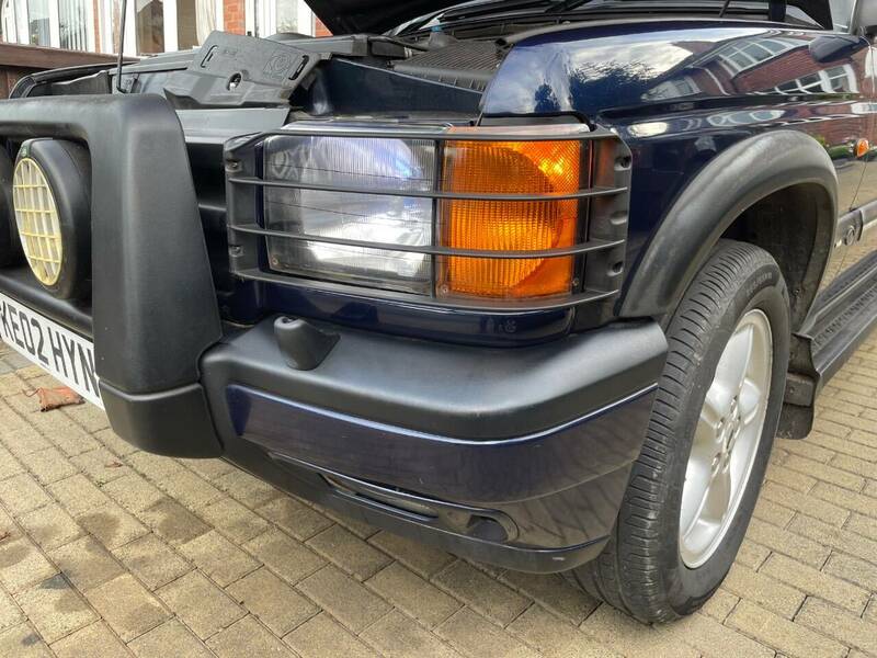

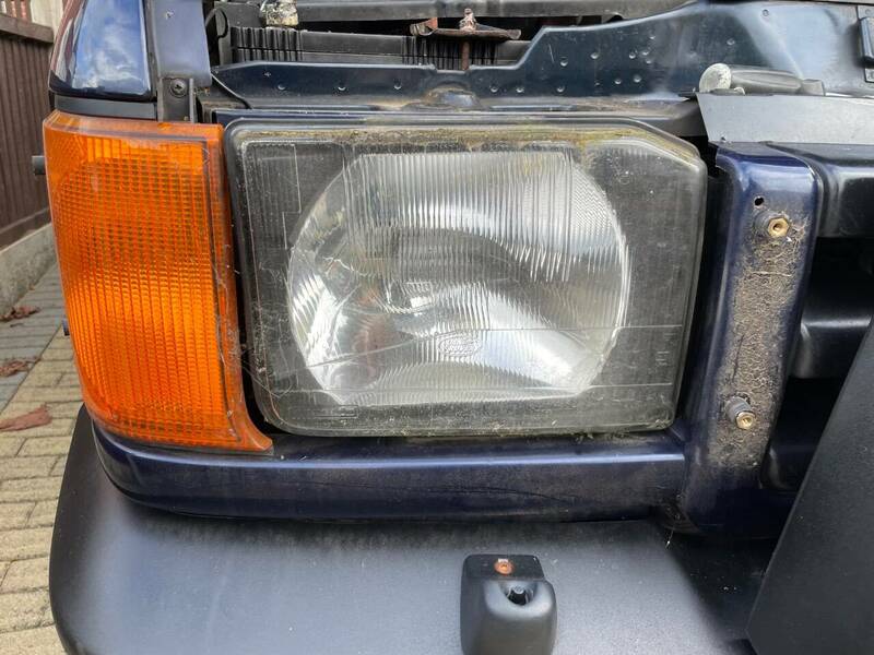

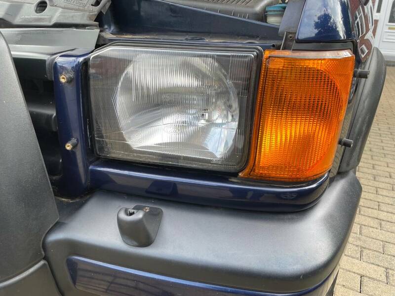

took it to my dads and washed it. Seams to be covered in a “detailing wax” which is disgusting

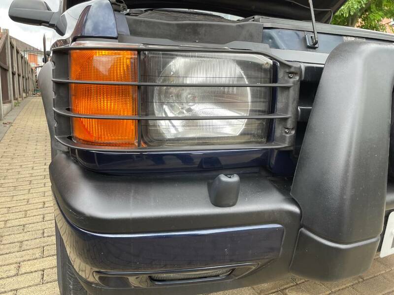

then took it home and took the headlight guards off to clean those up
yuk
that’s better
Nearside clean, offside not clean.
happy with that
then the right
yup happy now.

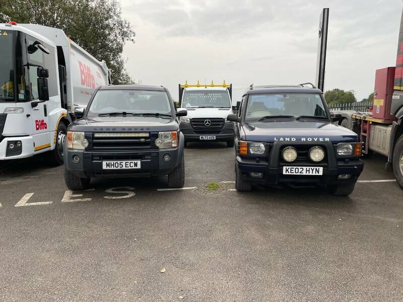

Suttys (ex)fleet at work. The D3 was replaced by the Allroad, which is (funnily enough) parked directly behind me)

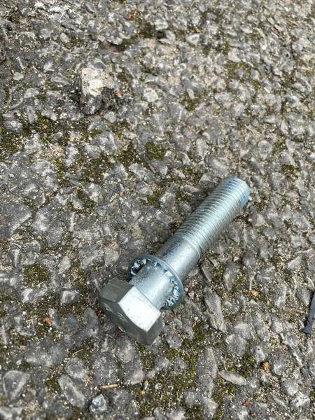

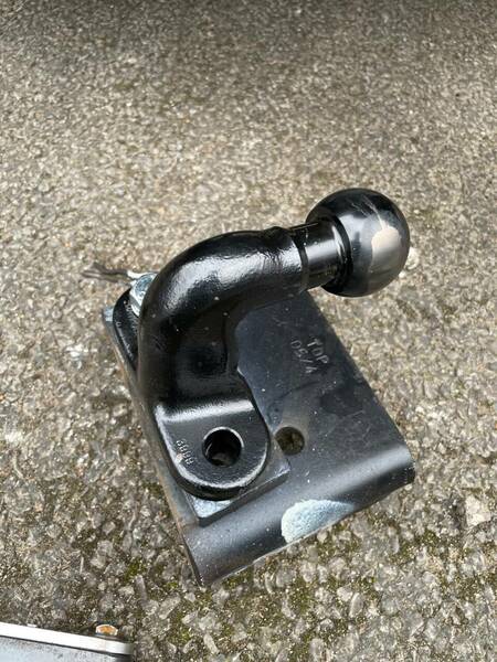

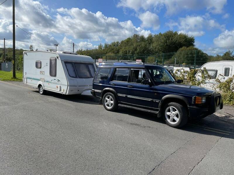

Have access to caravan this weekend. So need to exchange tow ball for correct height alko version.
glad I did. Original tow ball held on with 2.7 stainless steel bolts. Yikes. Can tell it’s never towed owt heavy
some nice new 8.8s going on.
Put my big girls pants on and borrowed the in-laws caravan for our anniversary (which is today).
it’s only a baby van.
I don’t normally suffer from anxiety but heading up the m6-m62 to York made breathing difficult. But we made it!
she definitely needs some torque releasing from low down. But alas it has done the job without fail. Oxygen entering lungs betterer now.

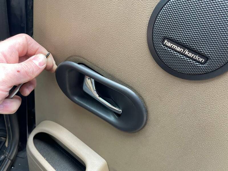

New seat base ordered along with a refurbished* sunroof motor and a centre interior lamp.

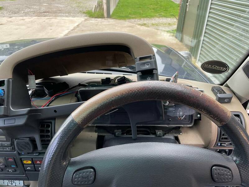

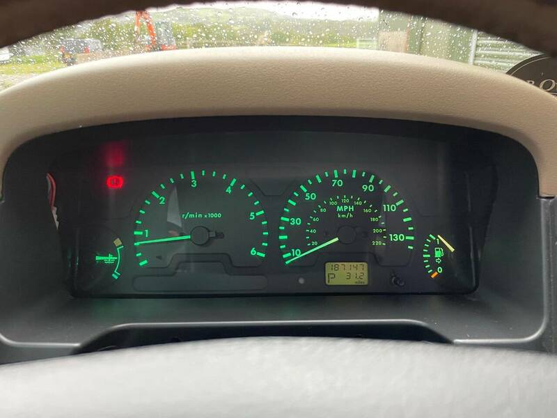

The interior light stopped working, again. This time, the contacts on the bulb weren’t contactin very well. Some sand paper sorted that out.
Far right dash bulb was dim.
the binicle came off easy, IMG_8028.thumb.jpeg.eb96624b6dafeaac594bb6f0e5d2f537.jpeg
ahh that’ll be why. Someone’s raunched at it and snapped the screw holes out.
but one 5w capless bulb later and we have equal amount of light.

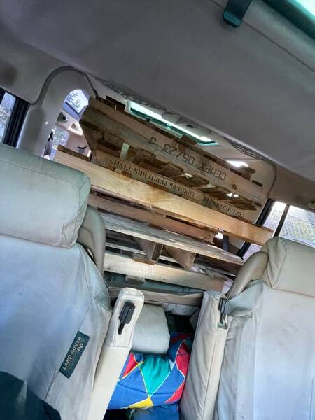

pallets galore
38 minutes ago, sutty2006 said:
Couldn’t do this with the Audi!
pallets galore
Welsh kindling!
