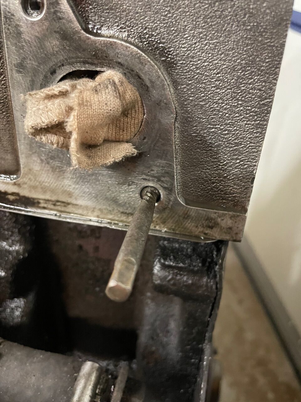

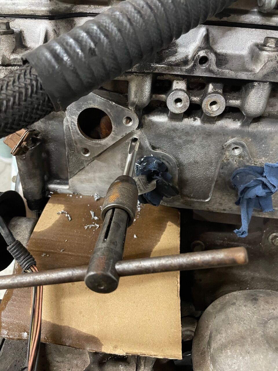

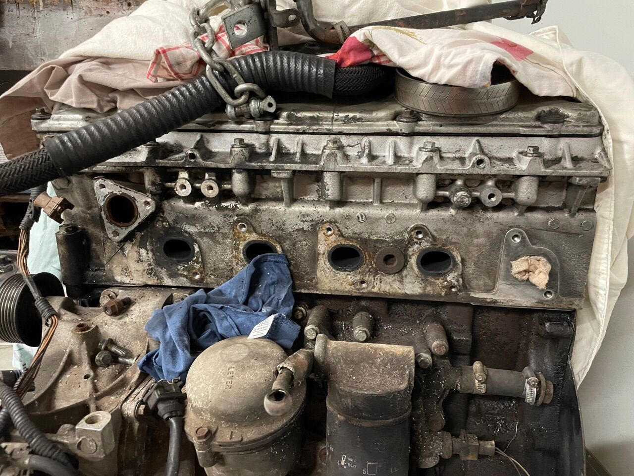

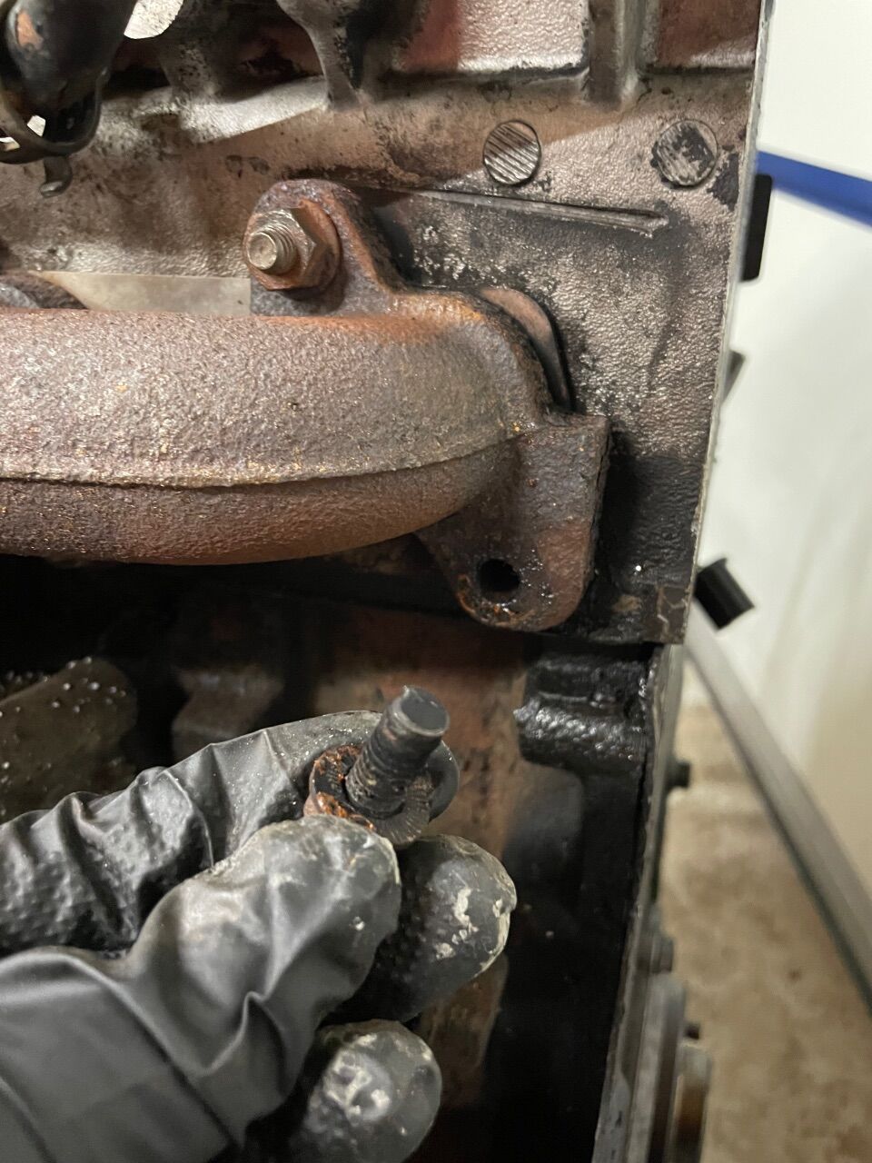

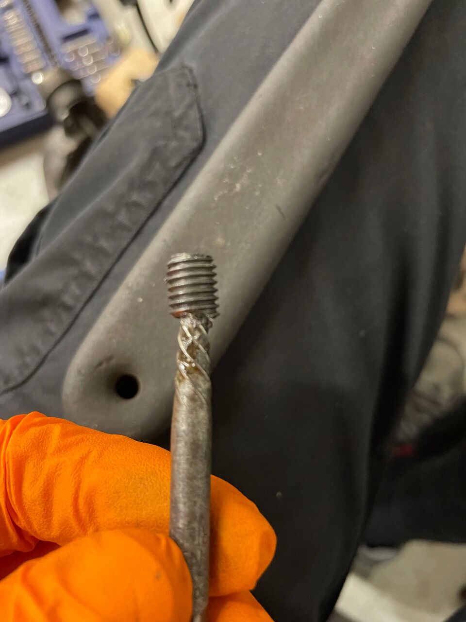

using this and some Deblock penetrating oil the remaining studs have been evacuatedĀ
Ā
Ā
boom
Ā
top one fought a little harder but gave up like the French navy.Ā
Ā
Ā

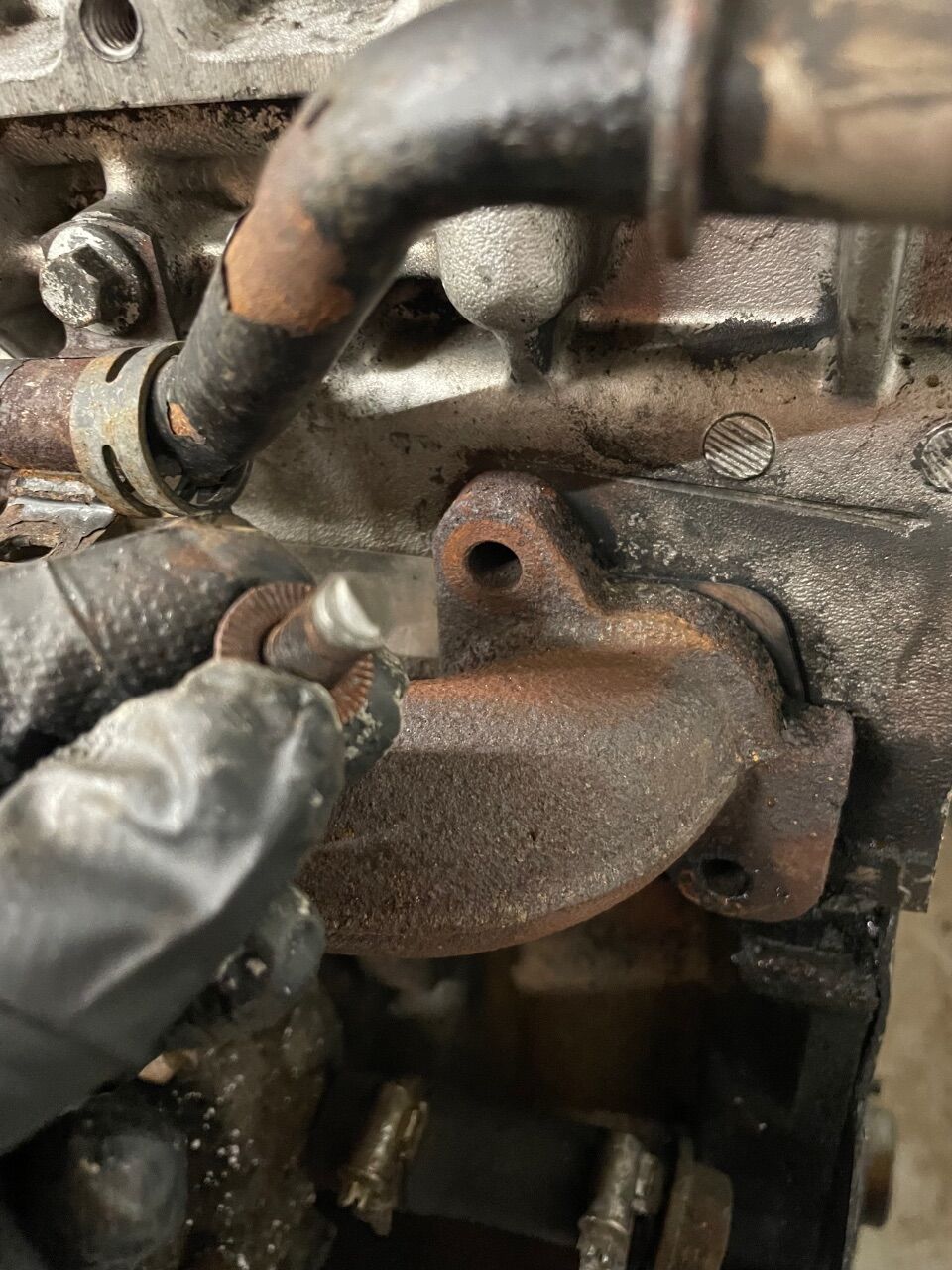

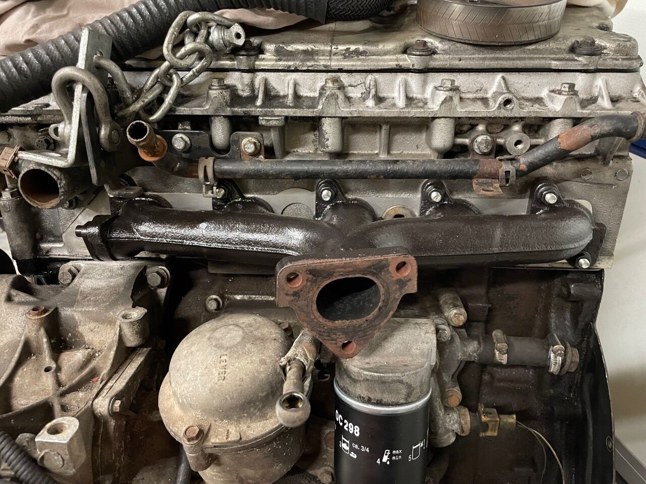

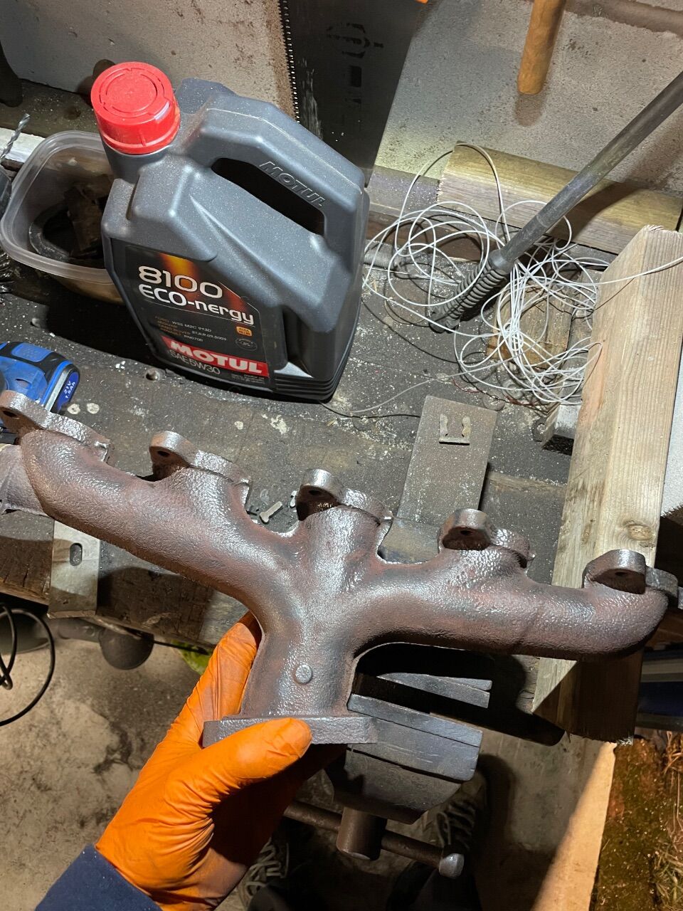

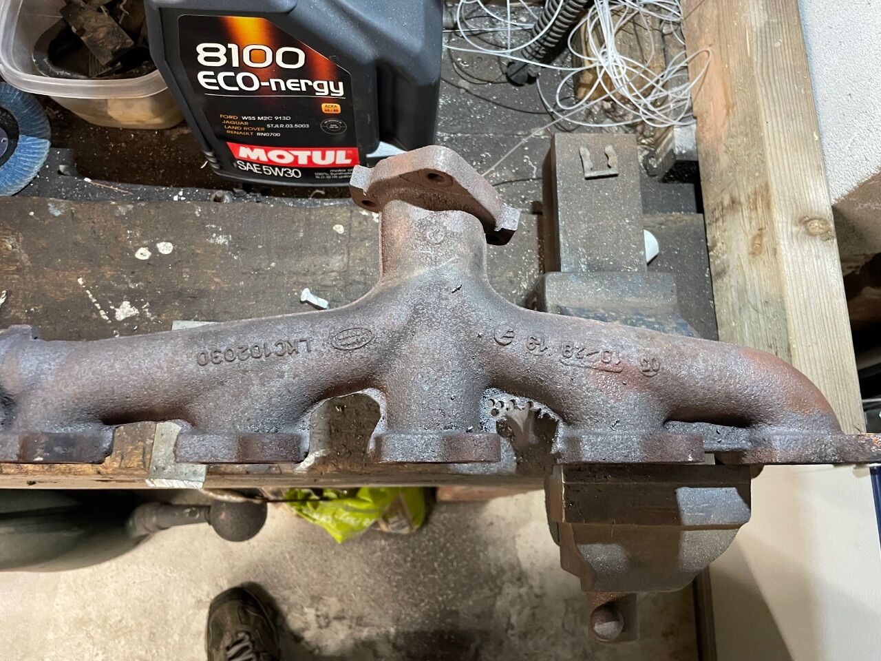

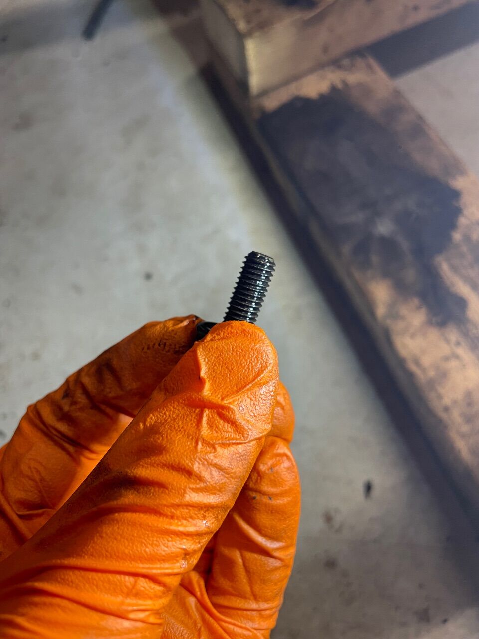

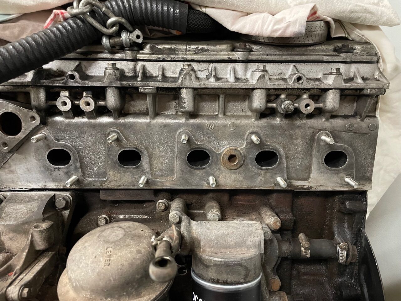

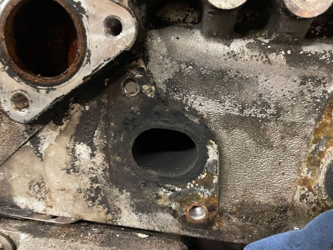

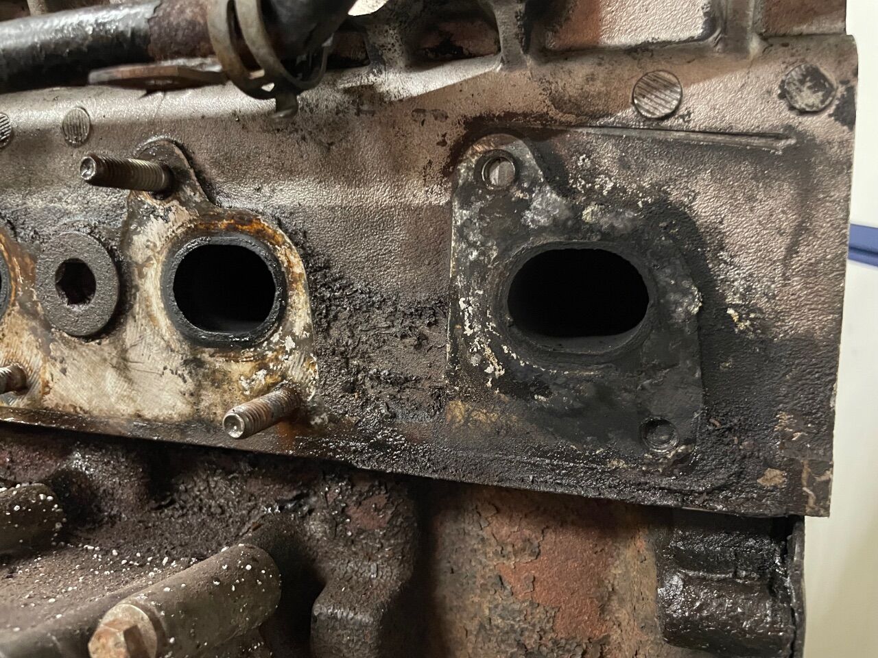

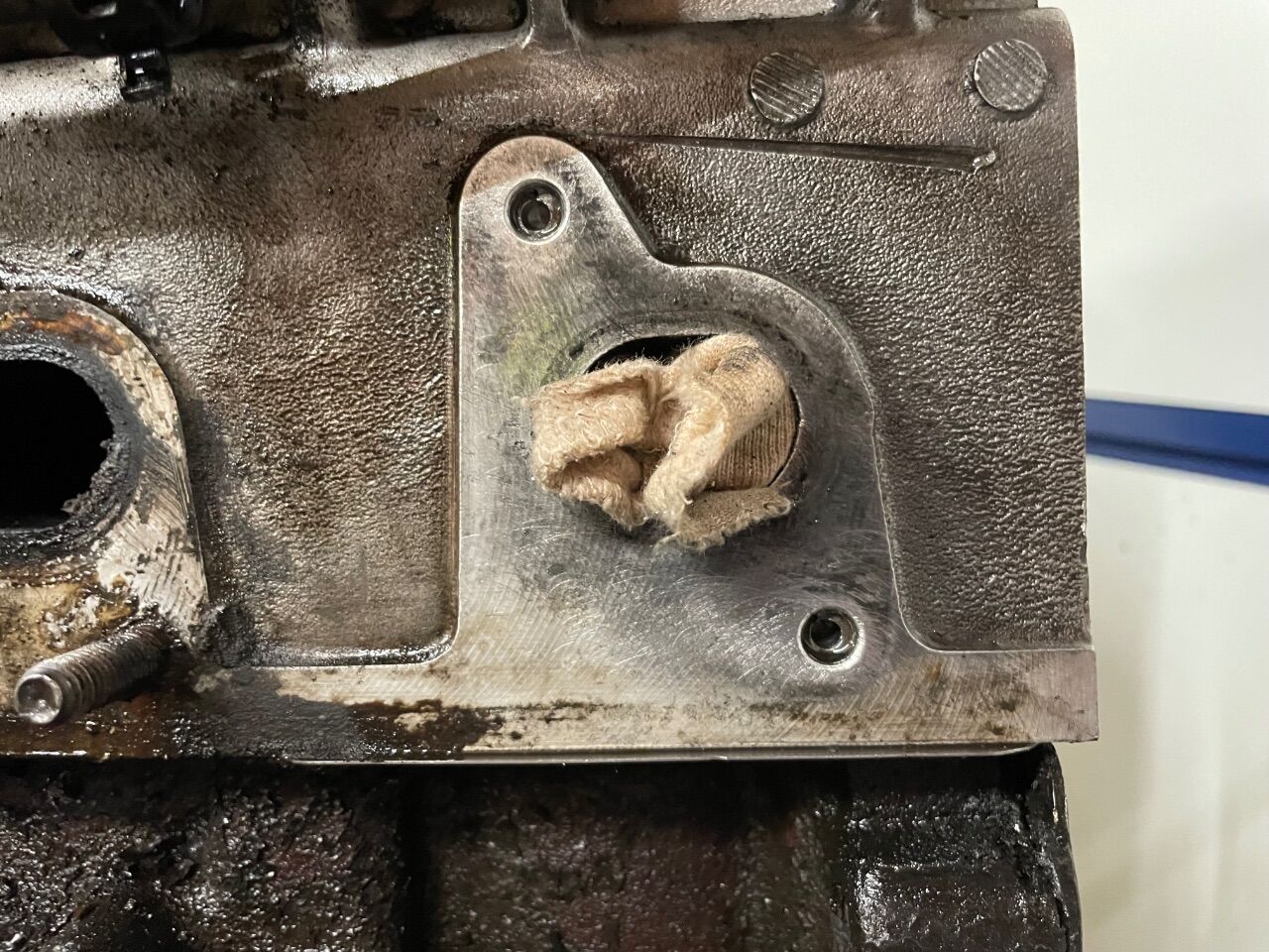

with the studs out, I can press on with the manifold. These fuckers warp like a politicians morals on polling day, and because they are webbed, they snap the studs off. So the webbing gets removed.Ā
Ā
Ā
all done. Took less than 30 minutes. I’ll be dropping this off with my mate for skimming this week.Ā

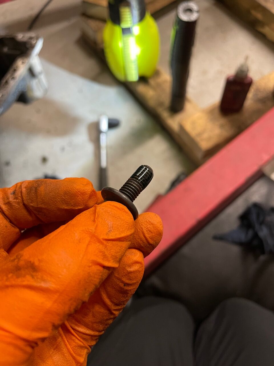

You sir are an incredibly brave man, using easyouts on manifold studs!
Hat duly doffed šŸ™
Should say everyone I know who've tried that trick has  ended up with a broken easyout in a broken stud...🄺
2 out in a row without snapping the easi out is mega. Put the lotto on, your luck is in
This is an old set of easy outs, I much prefer them as I have the snap on set at work. Needless to say I’ve snapped a few of them snap on versions before but these ones are superb šŸ‘Œ
Good job I bought 10 new studs.

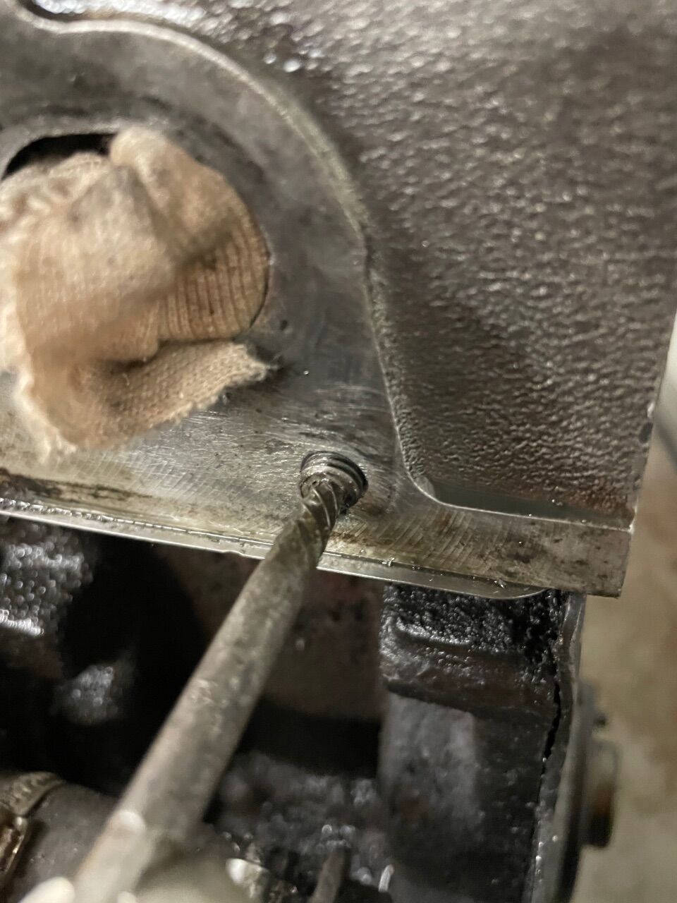

cylinder 1 top bolt has snapped too
Ā
Ā
yay. Left my easy outs in the breakdown van. Will have to get that out tomorrow night!Ā
Ā

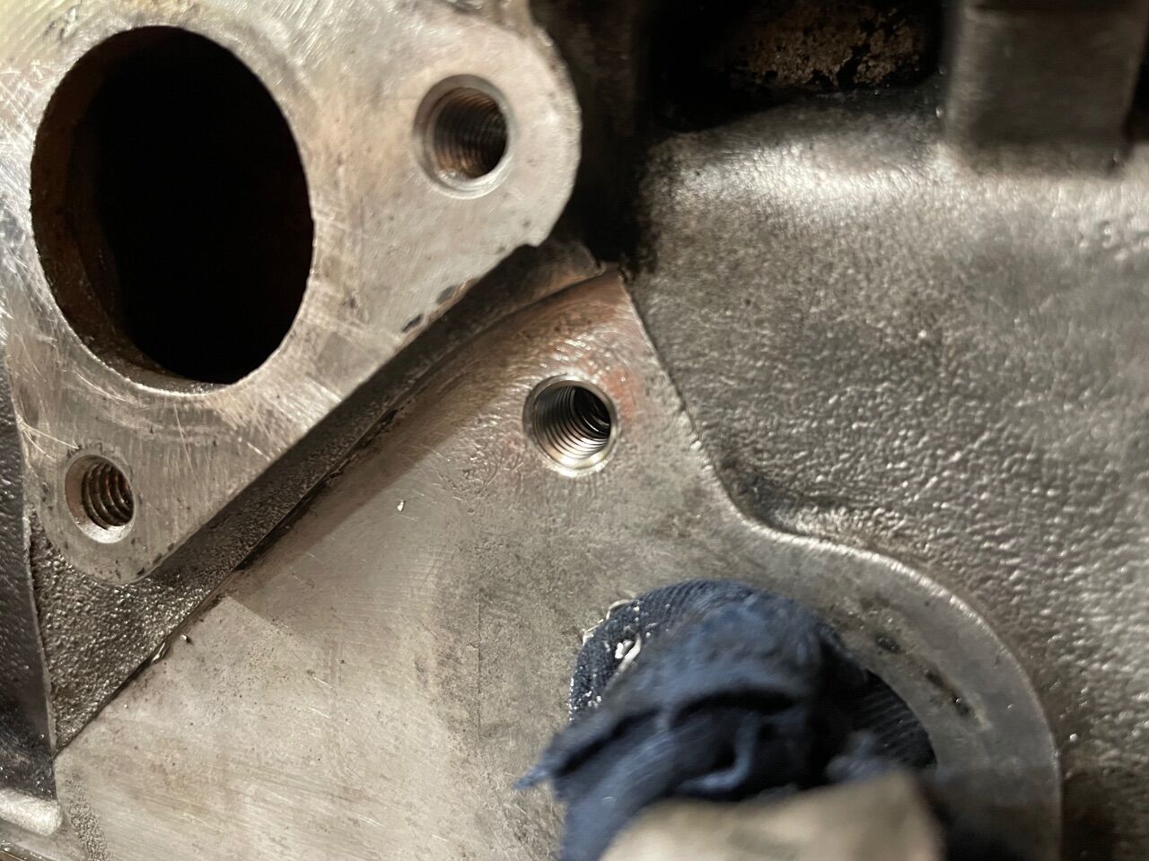

And now the fun bit:
Getting the drill to stay in the hard stud, and not wander off into the soft ališŸ˜•
Good luck šŸ¤ž

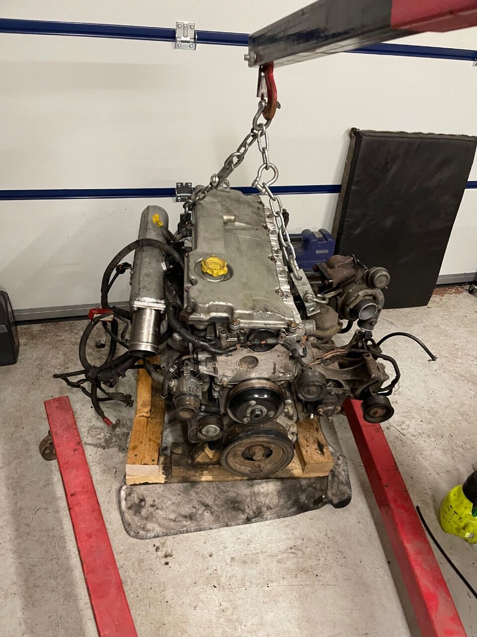

I’ve been back to the garage. They haven’t pulled it to bits, but are adamant I’d be wasting money if I get them to pull the sump off. Which is probably right. So we are working on when this spare engine is ready to go, they’ll pull it into the workshop and swap it over. Heavy duty torque converter will go in at the same time.Ā

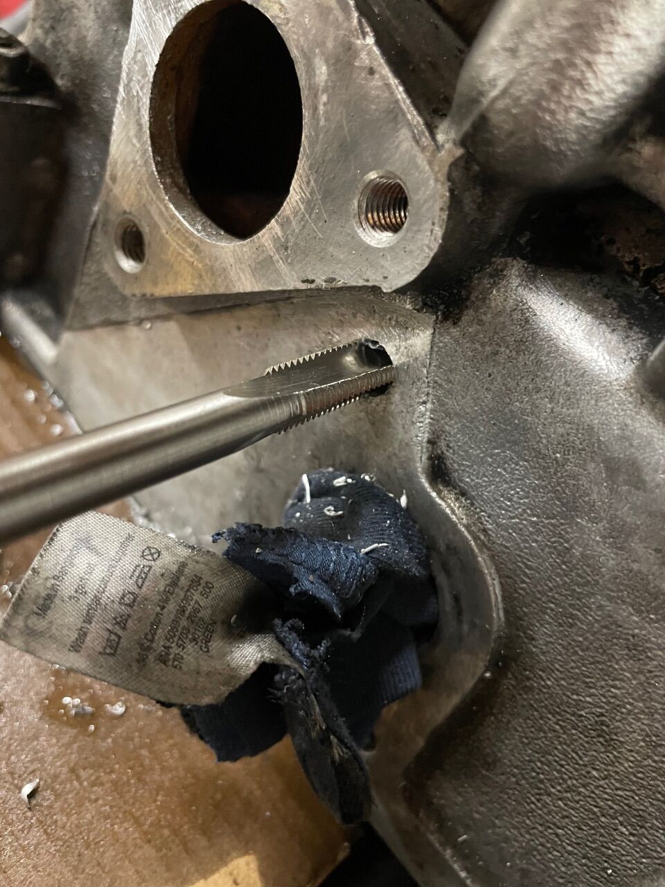

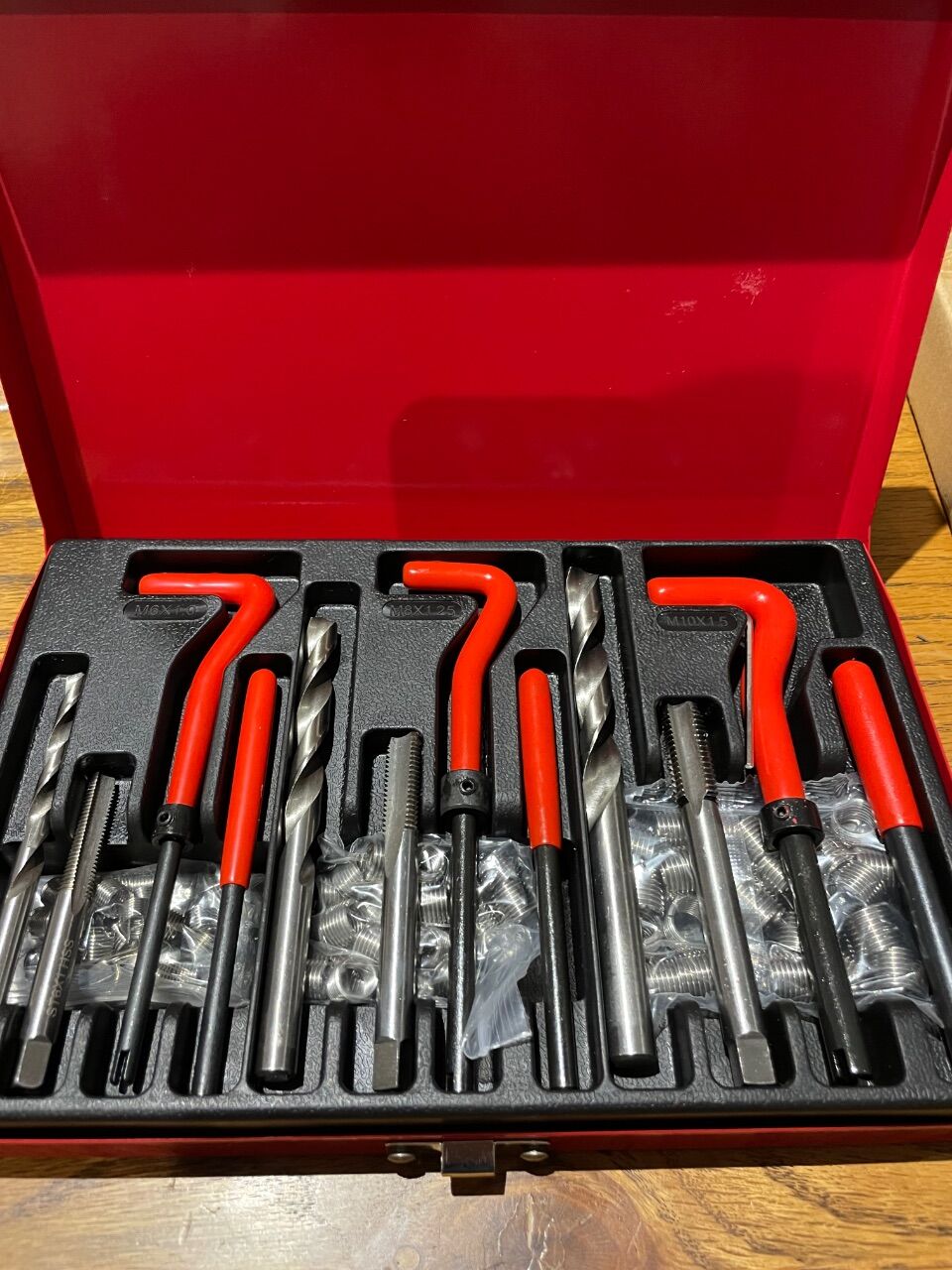

I genuinely hate drilling into ally heads. So I measured all the holes and put some tape on my drill bits to not drill too deep. Hopefully I haven’t.Ā
Ā
Ā
tap tap!
Ā
Ā
in ya go fella
Ā
studs in
Ā
fannymold on

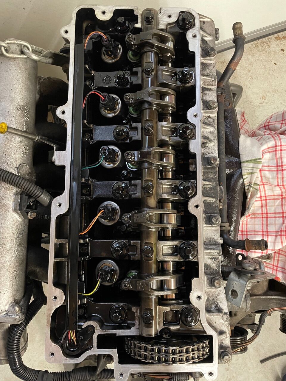

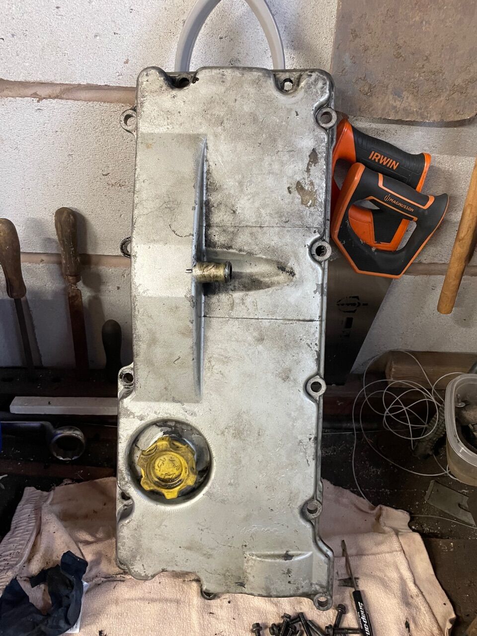

Not much achieved today. Removed the rocker cover to inspect its gussets and trinkets. They’re there. Great. Taken note of the injector codes and will be refitting with a new rocker cover but need to order new bolt seals first.Ā

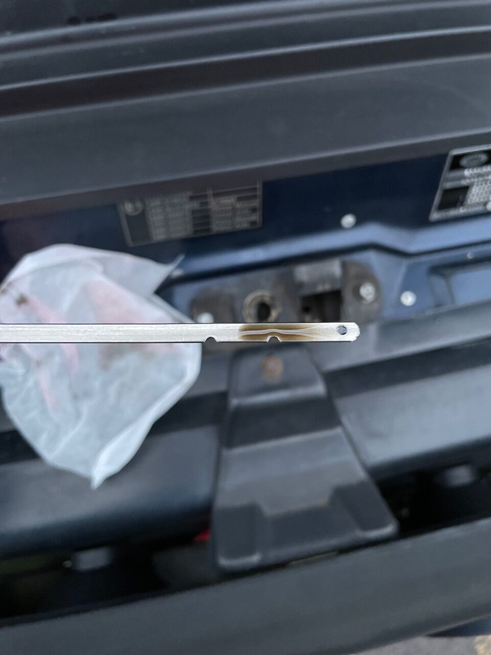

Shame the clean oil didn’t help, as I read more….
What happened? Ā Oil pump failure?
Oils been changed every 5000 miles, but yeah, it’s weird really as the last discovery I had (2.7 tdv6) had very regular oil changes and spun a main bearing totalling itself. I’m going to find out what happened to it, but it will only come to light once i get that engine home.Ā

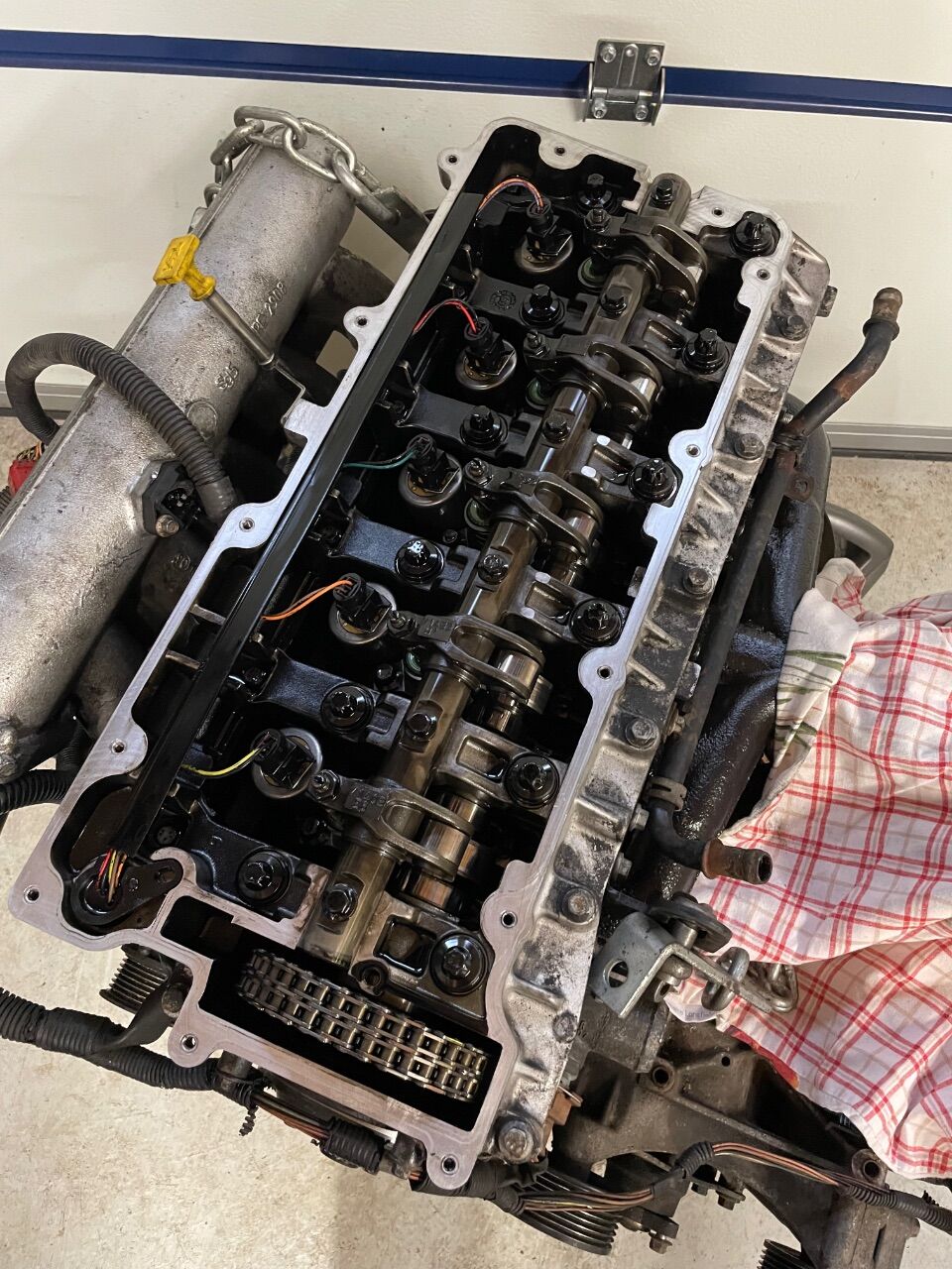

More work done today.Ā
Ā

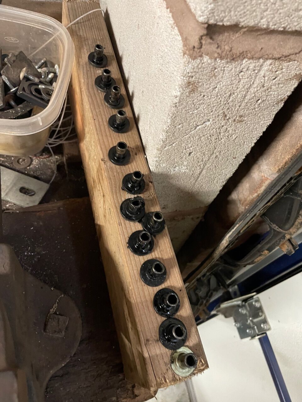

All 13 rocker bolt seals replaced as the originals were shot or missing.Ā

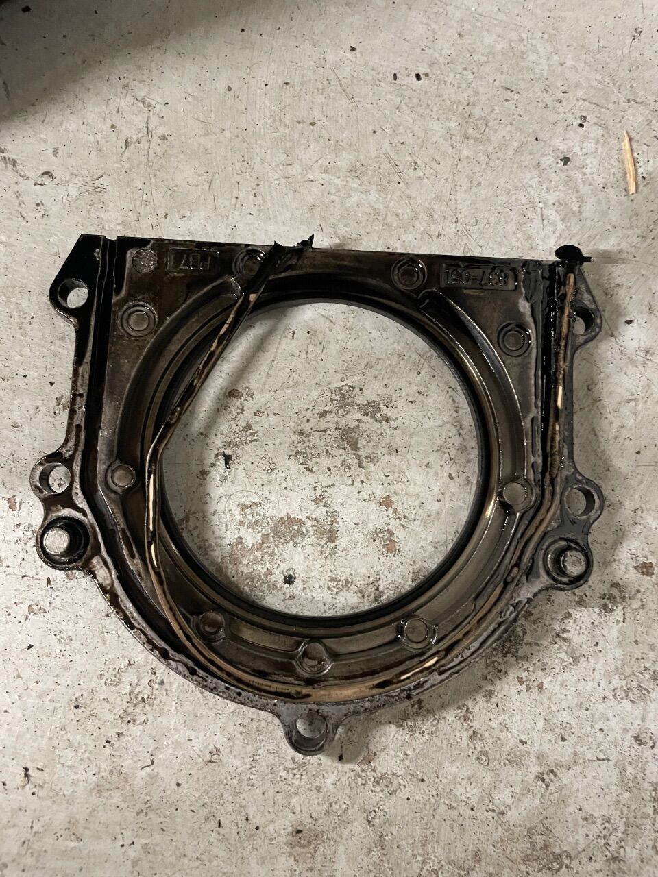

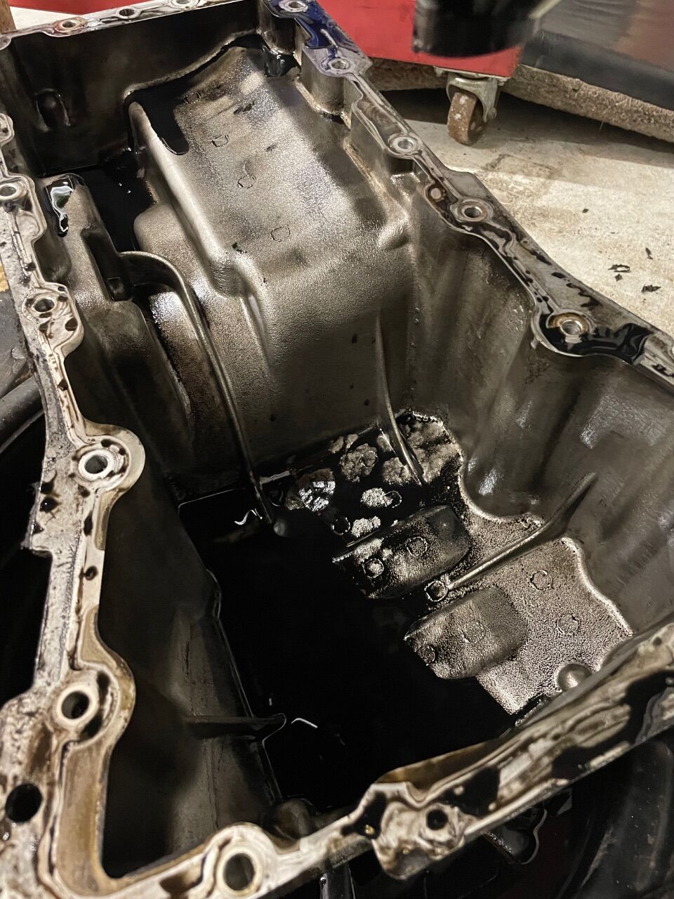

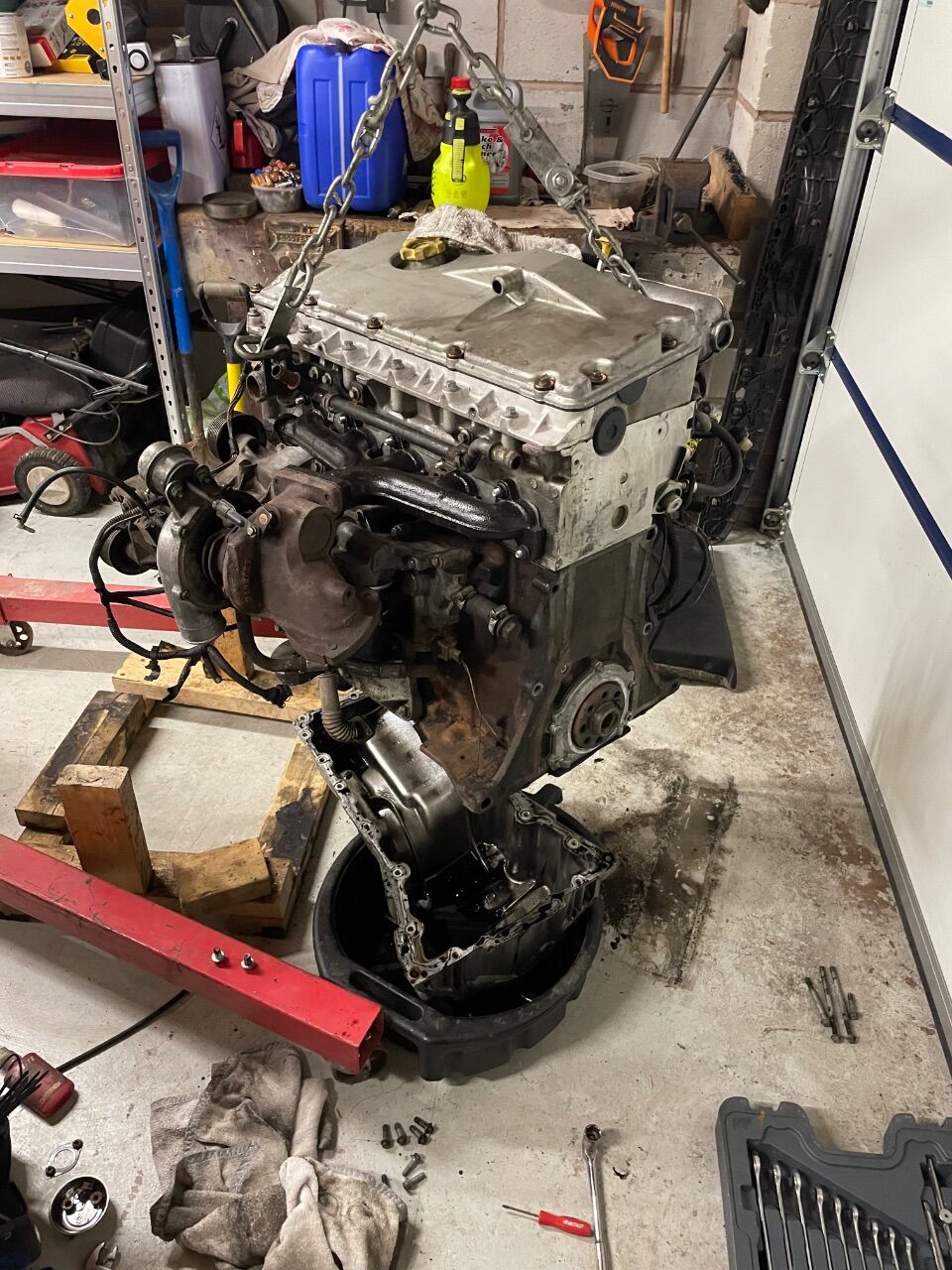

now up in the air. Sump off. Jobs to do while sump off - 1 new seal. 2 new rear main seal. 3 check oil pump bolt and reseal. 4 clean and refit sump.Ā
Ā
Ā
rear main was due I thinkĀ
Ā
Sump doesn’t look too bad, not sludgy which is what I feared.Ā
Ā
Ā

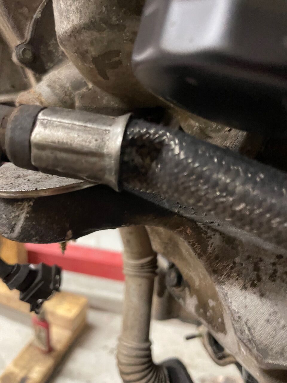

jobs left to do after, turbo return pipe is kinked and the inlet air sensor is smashed. I’ll pull these off the replacement engine. I’m not spending anymore on this. If this engine turns out to be nackered I’m going to bridge the lot.Ā

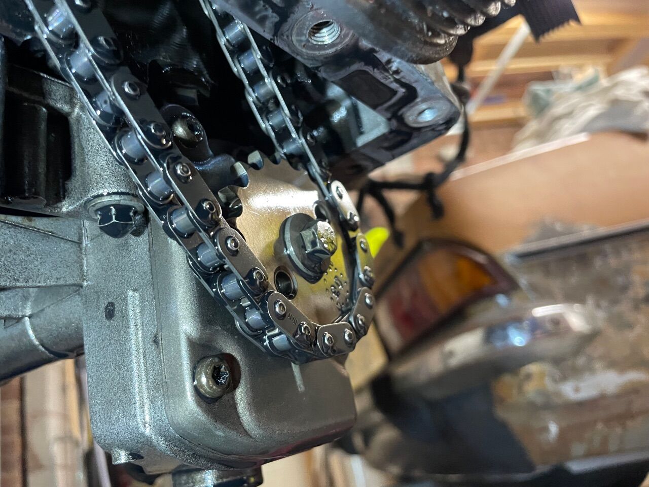

Oil pump retaining bolt.Ā
Ā
Ā
let’s take it out and see if it’s been loc-tited in place.Ā
Ā
noĀ
Ā
Ā
dry as a bone
Ā
Ā
better fix thatĀ
Ā
torqued to 26nm or something like that.Ā

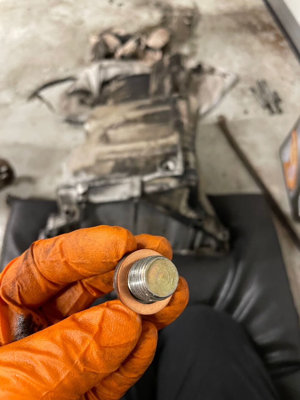

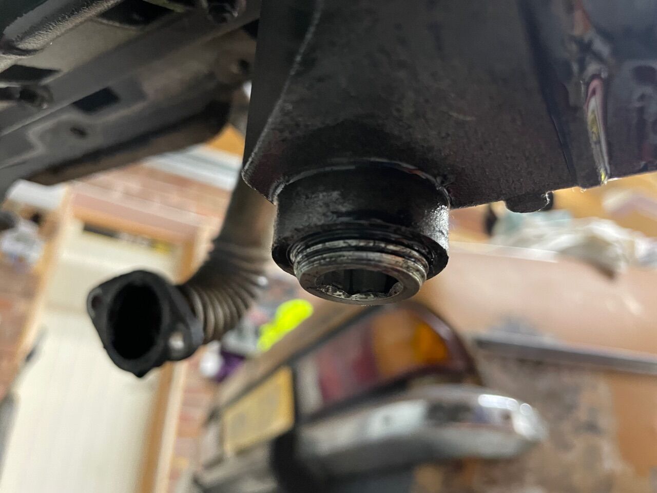

sump plug was leaking and had silicone round it. No copper washer fitted. New now on.Ā

turbo drain pipe fucked.
how the fuck was this engine even running? I mean, so many fucked parts and I payed top whack for this. Engine owes me close to a grand now.Ā
