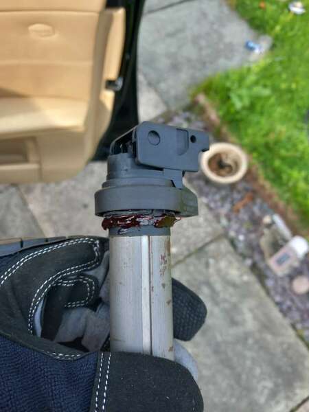

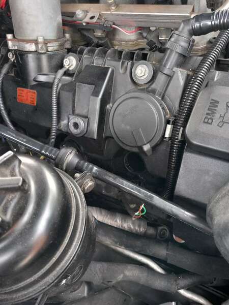

Bren Posted August 30, 2023 Posted August 30, 2023 As my car never sold I thought I would spend some money on new plugs - my suspicions they had never been changed were confirmed when I pulled one last week. £70 lighter a set of bosch were obtained and I cracked on. Remember when Marlon Brando said " the horror - the horror" when his cork was popped in Apocalypse now? He was actually half way through changing a set of N62 plugs. To do the offside you need to move the header tank aside to give yourself more room. The plugs themselves are quite deep and you will need various extensions and a UJ. The coils came out after a struggle - various pry bars were needed to get them going. Due to depth at which the plugs sit you need to push them into a piece of rubber pipe ( I used fuel injection hose ) and wind them in until they start. You then pull the pipe free and use a socket to tighten. I put some red rubber grease around the boot. Some recommend dialectric grease in the coil but I doubt any moisture or corrosion could exist as the engine gets really hot. The plug being wound in. Cavcraft, RayMK, SiC and 3 others 6
Bren Posted August 30, 2023 Author Posted August 30, 2023 The rear was enough to have you reaching for the valium - I had to move the bracket for the aircon pipes and wiggle the coil underneath to get it out. My 5" extension was too long and I had to borrow a 3" one. Some posts on internet suggest moving the engine for better access. The nearside was a bit easier - move airbox for more access. Agiain all was ok until I got to the rear one - The plug is underneath the trunking from the DME - coil came out after a fight. New plug and it was all back together. As of yet I haven't tried the car - if there are any problems I will be leaving my shoes on the beach and doing a Reggie Perrin. It's one of those jobs nobody wants to do - access on a 6/7/X5 may well be better. Over two days it took me around five hours. My hands are mangled I am lucky I didnt lose a couple of finger nails. I can only assume whoever signed this off at BMW had been bin bagged by his missus the night before. Fingers crossed it starts. 320touring, CreepingJesus, w00dy and 5 others 7 1
