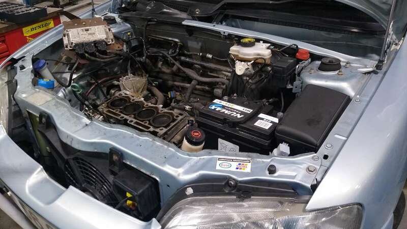

red5 Posted February 24, 2023 Posted February 24, 2023 Exhibit A. 45k. Parked up sometime in 2007. Mot'd Nov 2022. New ditchfinders. New back box. Oil change. Used until valves jammed open. Glued basically. Aston Martin, loserone, JMotor and 1 other 4
red5 Posted February 24, 2023 Author Posted February 24, 2023 JMotor, Amelia, LightBulbFun and 5 others 8
red5 Posted February 24, 2023 Author Posted February 24, 2023 Sort of shown- Valves stripped, cleaned and seated. Not shown. New gaskets, new headbolts. New belt to go on after it starts and runs... Ah. Aston Martin and Matty 2
red5 Posted February 24, 2023 Author Posted February 24, 2023 So it's back together and timed up. Cranks, no clattering. No start. Slight cough once. Let's check the fuel (after rechecking valve timing, clearances and plugs. Yeah. No. theshadow, Matty, BorniteIdentity and 1 other 4

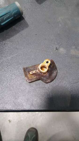

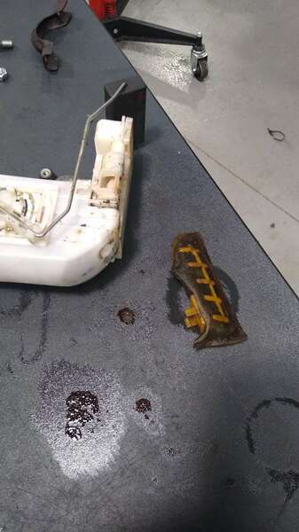

red5 Posted February 24, 2023 Author Posted February 24, 2023 Fuel pressure drops after a second or so. Fuel filter removed-still the same. Out she comes then. theshadow and Andyrew 2

red5 Posted February 24, 2023 Author Posted February 24, 2023 Lovely. Doesn't smell anything like petrol.
Andyrew Posted February 24, 2023 Posted February 24, 2023 Fuck a duck thats bad. Assuming the Fuel gummed up the valves? red5 1
Fumbler Posted February 24, 2023 Posted February 24, 2023 1 minute ago, Andyrew said: Fuck a duck thats bad. Assuming the Fuel gummed up the valves? I think so, if this is the contents of the tank. It looks like teak oil. red5 and garethj 2
catsinthewelder Posted February 24, 2023 Posted February 24, 2023 Is that the jelly that apparently forms if old engine oil is used as fuel in a car that has previously run on veg?
cobblers Posted February 24, 2023 Posted February 24, 2023 31 minutes ago, catsinthewelder said: Is that the jelly that apparently forms if old engine oil is used as fuel in a car that has previously run on veg? sort of but this is a petrol
red5 Posted February 25, 2023 Author Posted February 25, 2023 That's the dregs of the tank (pumped out) mixed with 20 litres of finest E10. So, yeah, it's fucking fucked, mate. Let this be a lesson to always fill it. Always run it. Except I suspect the previous owner had pegged it. mk2_craig 1
