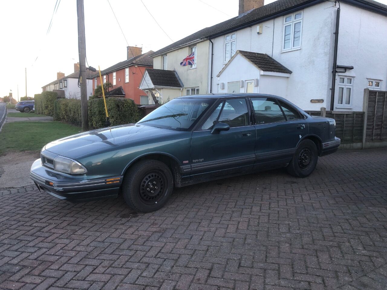

different nuts, painted rims and dog dish style hubcaps - Job done!!!!
are Vauxhall 5 stud wheels from a Carlton or such the right fit????ย
5x115
Back home, sans hubcaps.ย

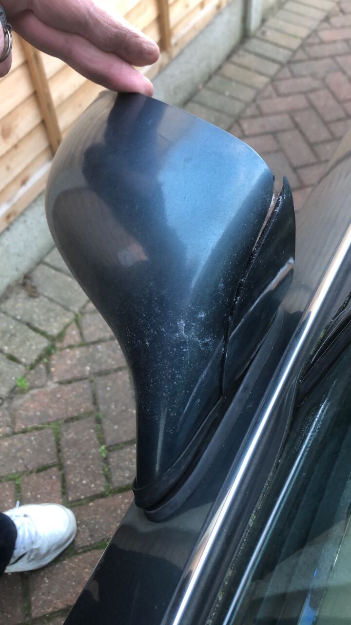

Car does need a passenger mirror cover.ย

You can buy an entire mirror assembly for around 20 quid on Rockauto. Can't get cheaper than that!
Thanks a lot !!ย
I wouldnโ€™t have gone to look there, expecting a double digit probing of my wallet or (W)recktum.ย
ย
I was expecting a remote search for one in the USA, an interesting price of too much or pennies and a ton of shipping ย ย

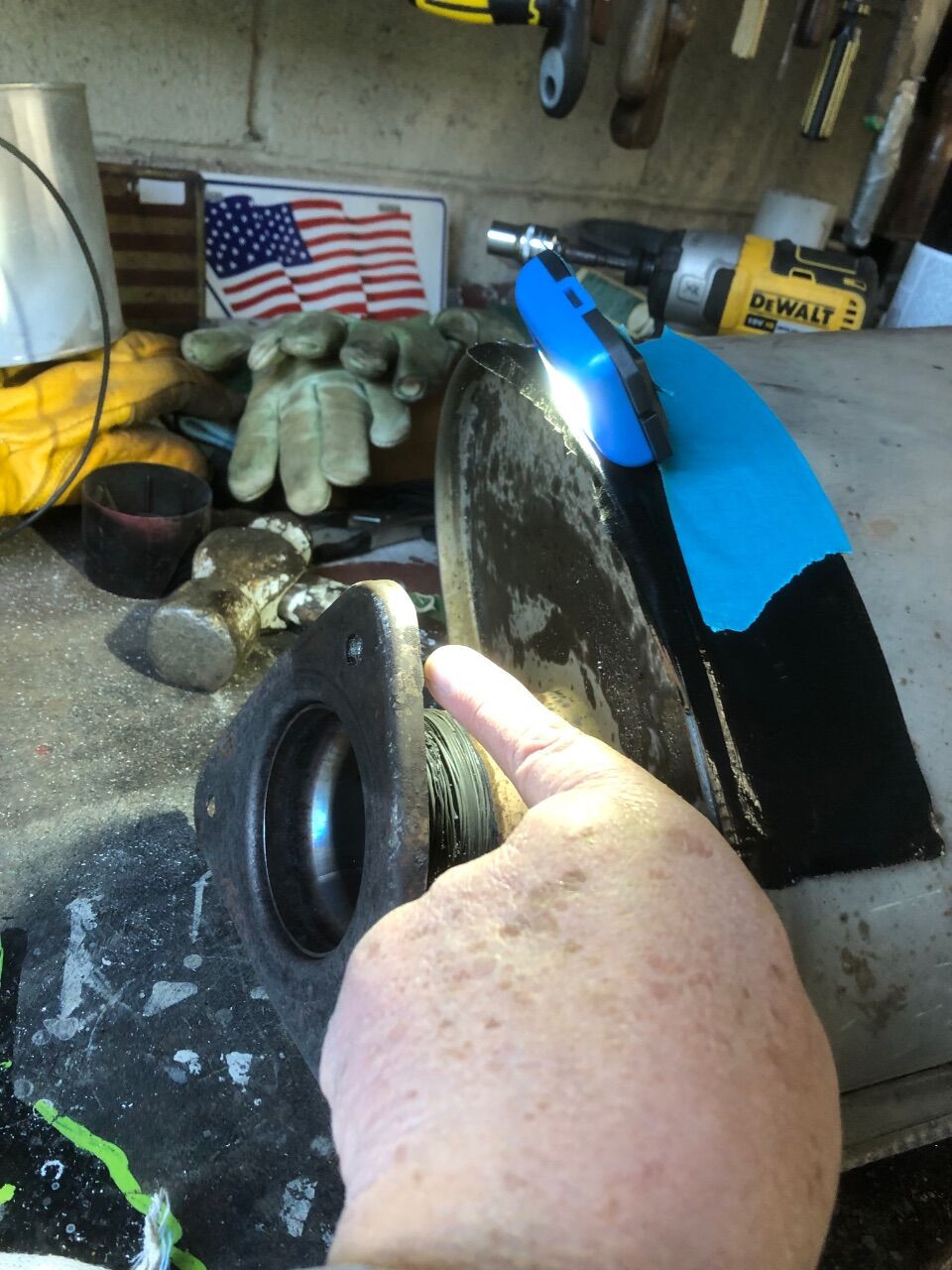

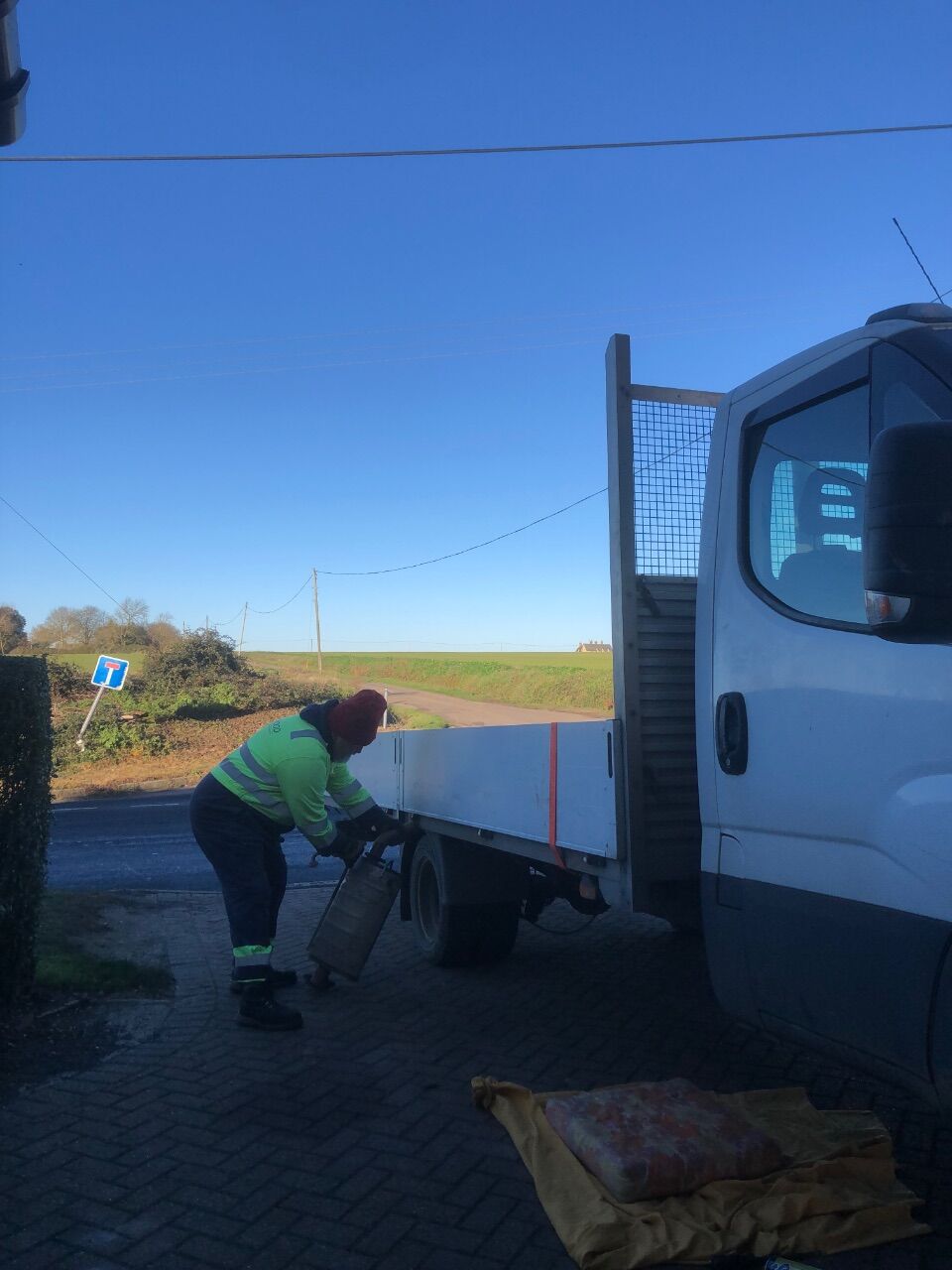

11.30 my young neighbour Lucas calls me in a panic. The silencer on his Iveco truck had broken off just after the catalytic converter. Can I please help, he needs the truck for work.ย
ย
So I told him I was not for hire (he offered me ยฃ200to repair it) but I would take a look and help him, like I did with John and his daughters car recently.ย
ย
So I turned the telly off, moved my car over the street and fetched some ramps for him to drive up onto.ย
ย
Perfectly timed.ย
ย
Truck up the ramp, took a look and realised that the silencer would have to come off.ย
ย
He left to go buy baby food etc and I carried on. Removed the silencer and inspected it.ย
ย
BUGGER !!!!ย
ย
Broken off high tensile bolts tucked behind the folds of the flange.ย
ย
Garage job thenโ€ฆโ€ฆ..
ย
My garage that is.ย
ย
Tried to get to these welds with two different angle grinders to cut back the welds on the bolt heads. Lack of space to get in. Fail.
ย
ย So cutting fluid, 9mm TiN drill bit, bit completely rounded and farked by 2mm depth .
ย
Head scratchingโ€ฆโ€ฆ.
ย
Compressor on, die grinder, tungsten carbide cutter and a lot of patience, prayer and blind grinding.ย
Eventually unseated the three welded heads.ย
ย
Found some mild steel nuts, bolts, spring washers and reassembled it all.ย
ย
During the time of fighting this thing, we realised again that manufacturers donโ€™t want to see you repair things. Buy a complete silencer to replace it.ย
ย
Fortunately, idiots like me exist who will crawl around in the cold for four hours to save a bunch of money.ย
ย
Lucas was pretty pleased.ย
ย
Result.ย
