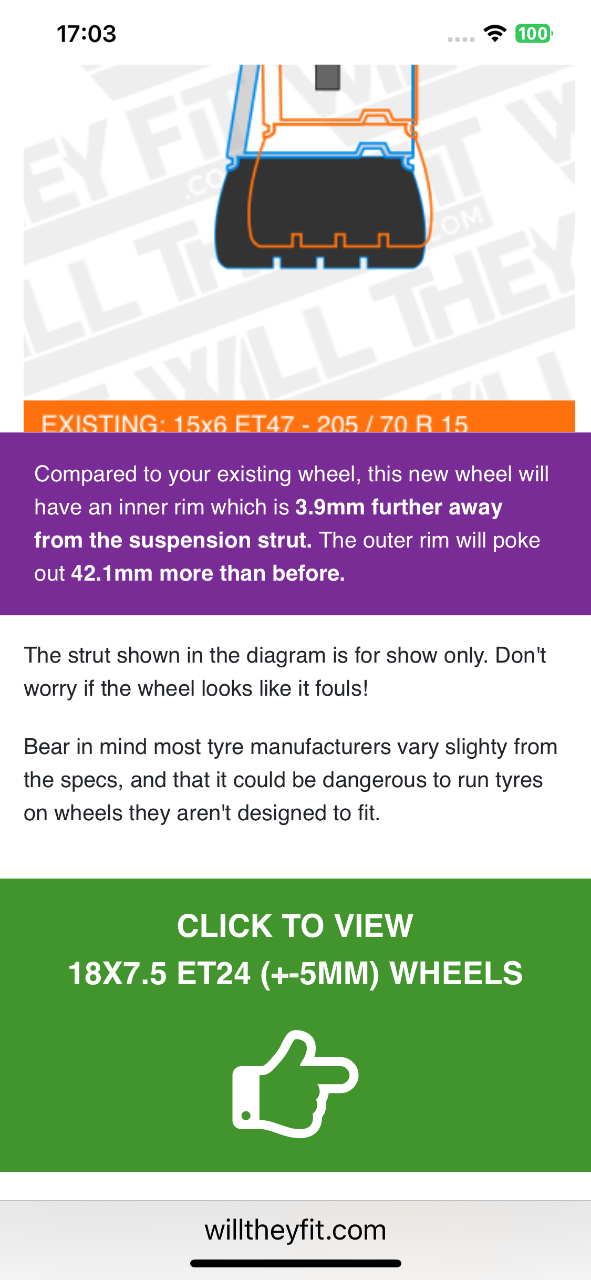

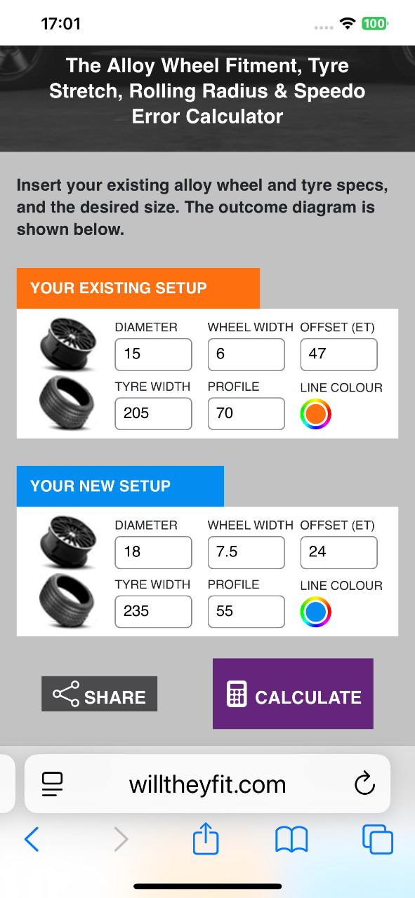

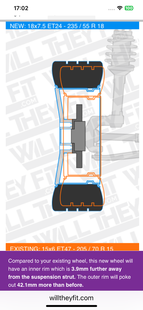

grizz Posted January 9 Author Posted January 9 I have just used this calculator @93fxdl Glenn posted before. https://www.willtheyfit.com/ Coming to this conclusion. I believe the Dodge wheels will fit successfully. Just need to figure the lug nuts out that will hold these onto my hubs. .

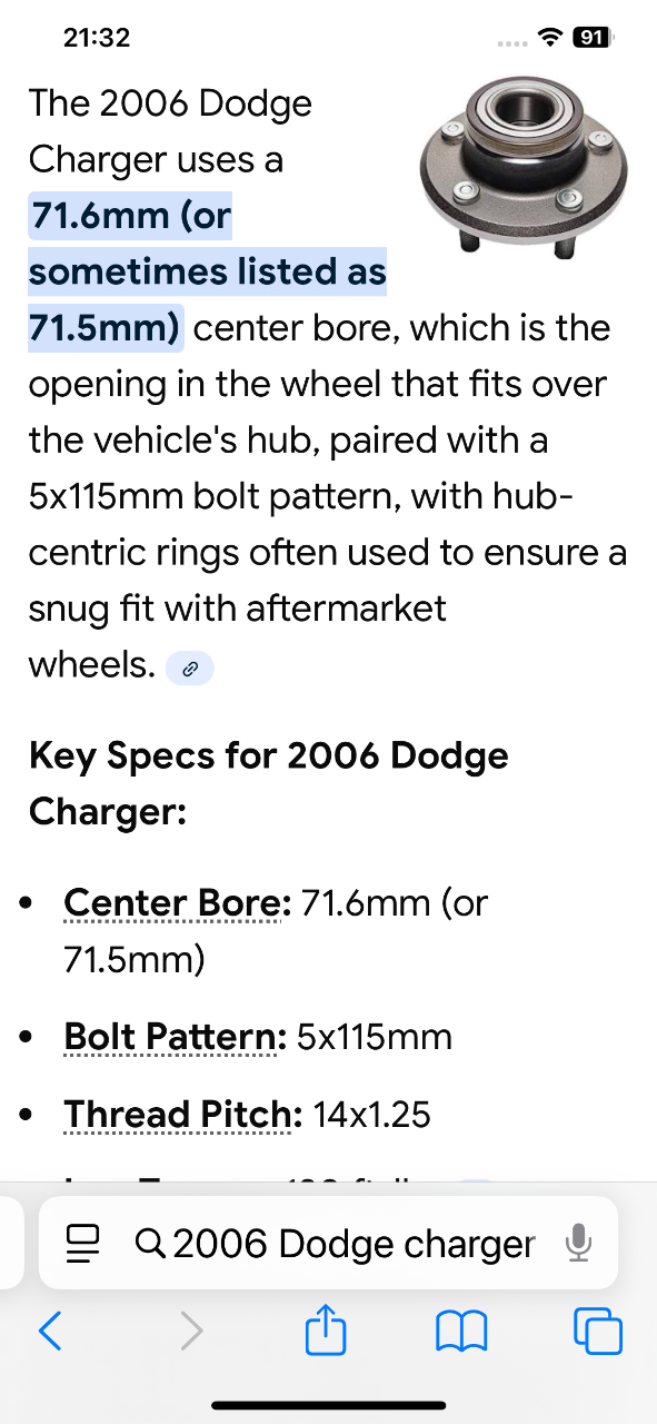

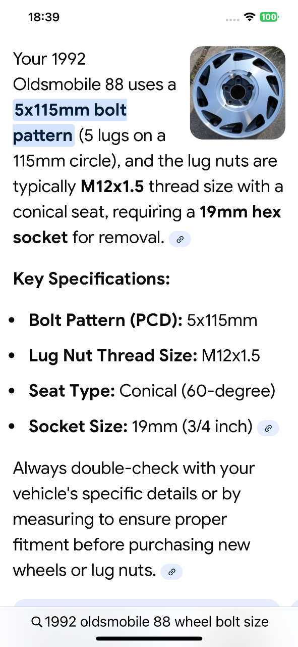

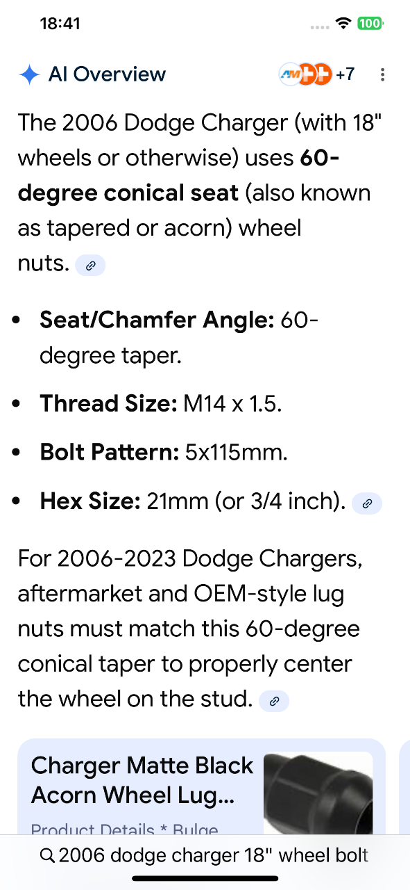

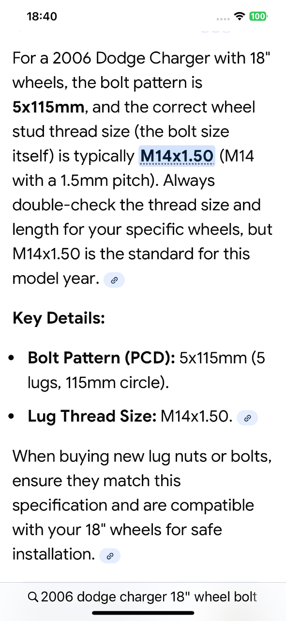

grizz Posted January 9 Author Posted January 9 These…… CB seems good PCD is the same 5x115 As per chart above. The bolt dimensions differ. Dodge M14 x 1.5 Olds M12 x 1.5 So I just need my (well, the wheels) nuts to be M12 with an appropriate chamfer to accommodate the Dodge alloys. A bit more research shows this…… Looks like the lug nuts are interchangeable. I could be wrong.
ruffgeezer Posted January 9 Posted January 9 You'll probably want a sleeved wheel nut to take the M14 hole in the new wheels down to the m12 stud on your car. Something like this:- https://www.rallydesign.co.uk/product_info.php?products_id=4663&srsltid=AfmBOoru8kfg4g7fmo0XSjpMQKczOfxWly9jEXuuvWdugprzDHEquTVq grizz 1

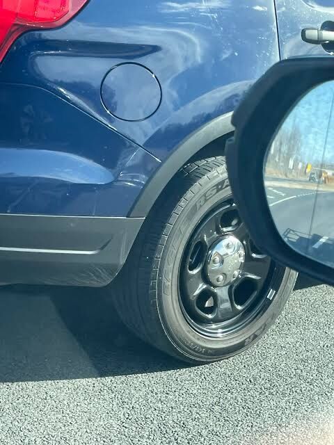

grizz Posted January 10 Author Posted January 10 12 hours ago, ruffgeezer said: You'll probably want a sleeved wheel nut to take the M14 hole in the new wheels down to the m12 stud on your car. Something like this:- https://www.rallydesign.co.uk/product_info.php?products_id=4663&srsltid=AfmBOoru8kfg4g7fmo0XSjpMQKczOfxWly9jEXuuvWdugprzDHEquTVq And in the meantime…….. Balti ? Vindaloo ?? Police car ??
Westbay Posted January 10 Posted January 10 12 hours ago, ruffgeezer said: You'll probably want a sleeved wheel nut to take the M14 hole in the new wheels down to the m12 stud on your car. Something like this:- https://www.rallydesign.co.uk/product_info.php?products_id=4663&srsltid=AfmBOoru8kfg4g7fmo0XSjpMQKczOfxWly9jEXuuvWdugprzDHEquTVq If you use this method it is essential that the correct spigot rings are used to centre the wheels on the hubs as you will not be using the conical taper to centre the wheels ... There is also some discussion in regard to checking the tightness of the wheel nuts more often as there is a much, much smaller area of contact than that provided by conical nuts ... (not a real problem in motorsport applications) The safest route would be re stud to M14x1.5 and buy correct conical taper nuts (but, your steel wheels would not fit then ...), probably cheaper to source something with a)correct fitting(s) or b) source something that can be fitted using adapters ... grizz 1

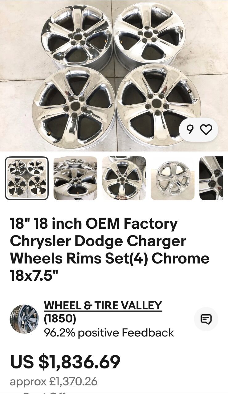

MrBig Posted January 10 Posted January 10 Those wheels are a bargain! Do you know what the O/D you need for spigot rings? I've got a couple of sets in the garage I'm unlikely to use. grizz 1
grizz Posted January 10 Author Posted January 10 39 minutes ago, MrBig said: Those wheels are a bargain! Do you know what the O/D you need for spigot rings? I've got a couple of sets in the garage I'm unlikely to use. There you go….. Dimensions. Actually not a lot…… Not sure if it can be plugged

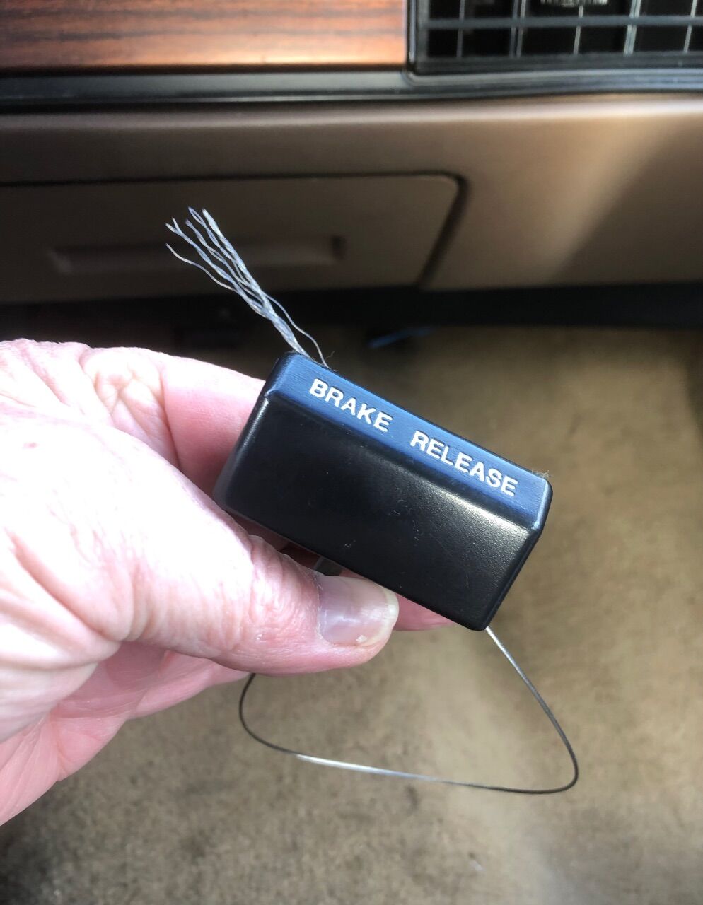

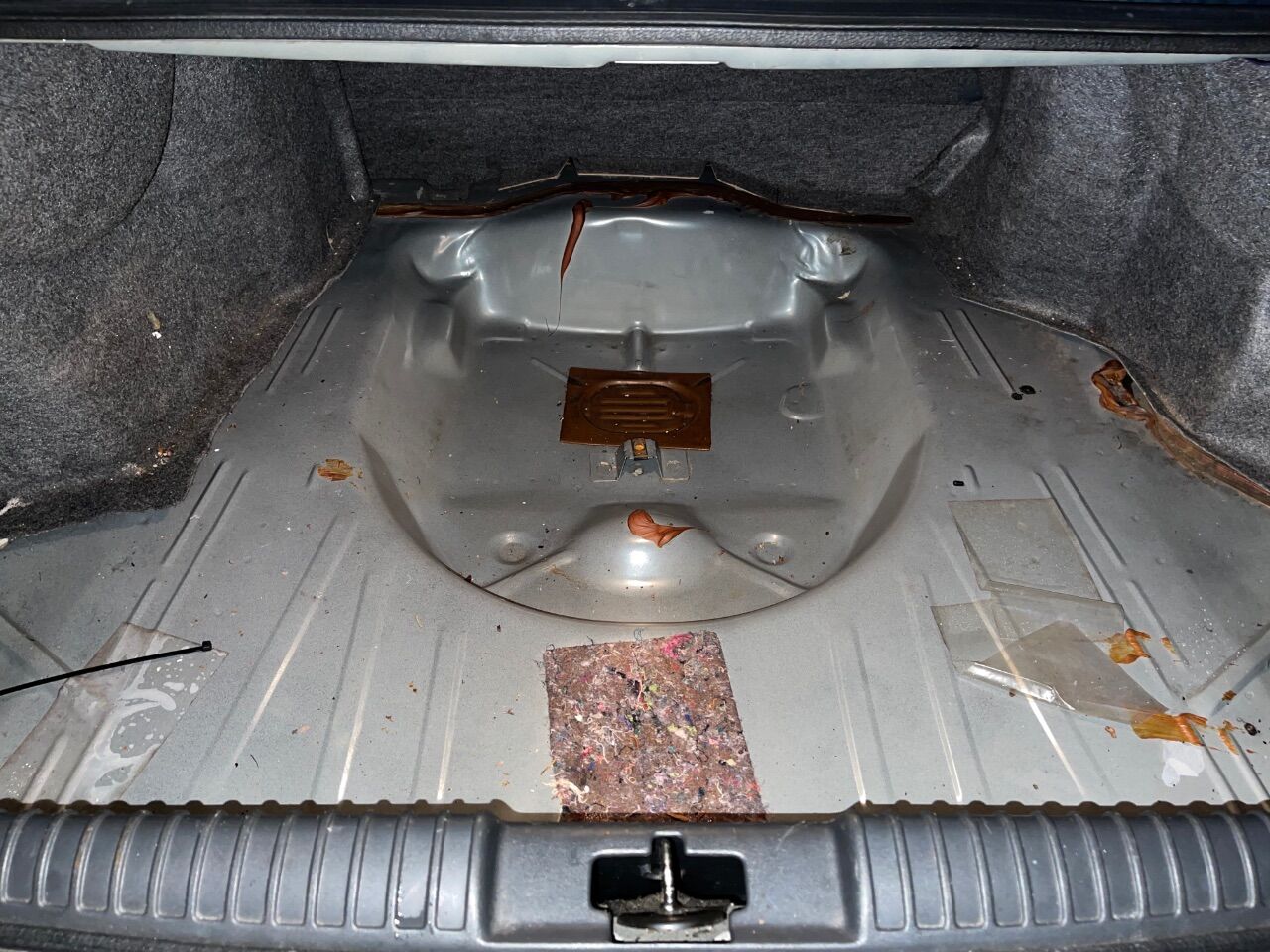

grizz Posted January 12 Author Posted January 12 Still discovering little things about the car. Addressing others I find Buying gifts for it. Thinking . Bought the car a gift too. Looks kitch as a third world minibus taxi steering wheel E-Brake/handbrake cable snapped before I bought it note the cool solution contrasted against my flip flops. Need to obviously find a replacement or repair it Got the trunk stripped out including underfelt. Scrubbed the trunk carpet with some Ammonia based gel. .

Westbay Posted January 13 Posted January 13 Parking Brake Cable ... https://www.rockauto.com/en/catalog/oldsmobile,1992,88,3.8l+v6,1215391,brake+&+wheel+hub,parking+brake+cable,1696 £4.05 +... grizz 1
grizz Posted January 13 Author Posted January 13 1 hour ago, Westbay said: Parking Brake Cable ... https://www.rockauto.com/en/catalog/oldsmobile,1992,88,3.8l+v6,1215391,brake+&+wheel+hub,parking+brake+cable,1696 £4.05 +... Thank you Mr Q Now just need to figure out how to order the right thing. . Westbay 1

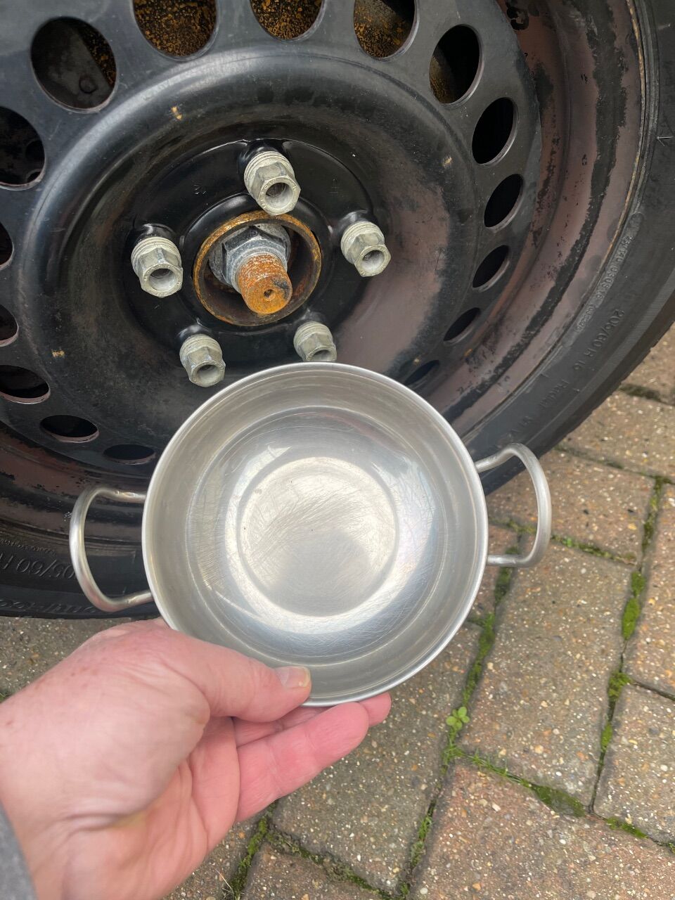

grizz Posted January 13 Author Posted January 13 Went shopping today. Bought some cheap stuff for the Oldsmobile. Two floor mats. Light beige. Cabin spray. Bubblegum flavoured. 4 mixing bowls….. police cruiser look Three laser cut letters….. lace painting. So, the bowls cut down to create a police cruiser look, painted silver. Remember the lace roof and lowrider influences ? I bought these three letters today. Tell me what they are going to be for? , MrBig, 93fxdl and Sigmund Fraud 3

Westbay Posted January 14 Posted January 14 If your exsisting wheel trims are crap why not cut them down to get the same l👀k as in pic three .... 🤔 😇 grizz 1
grizz Posted January 14 Author Posted January 14 1 hour ago, Westbay said: If your exsisting wheel trims are crap why not cut them down to get the same l👀k as in pic three .... 🤔 😇 Because when you come to collect the car, you WILL be asking me if I have the original wheel trims. Westbay 1
