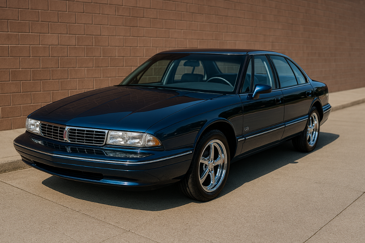

grizz Posted January 16 Author Posted January 16 1 hour ago, Westbay said: Thanks. Maybe more this direction.
grizz Posted January 17 Author Posted January 17 @Westbay This is actually very nice. eddyramrod and Westbay 1 1

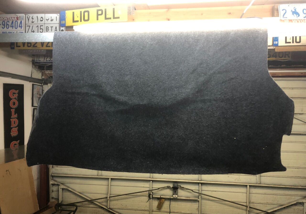

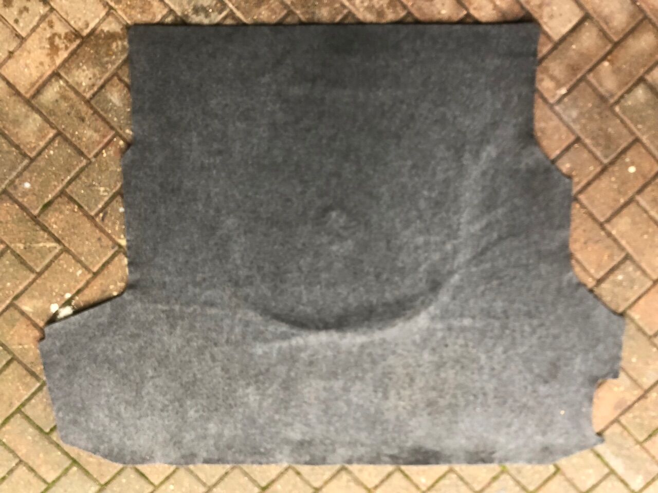

grizz Posted January 19 Author Posted January 19 Those little jobs nobody else does. Done a few jobs Watch this 3 min. . Westbay, Schaefft, Joey spud and 1 other 4

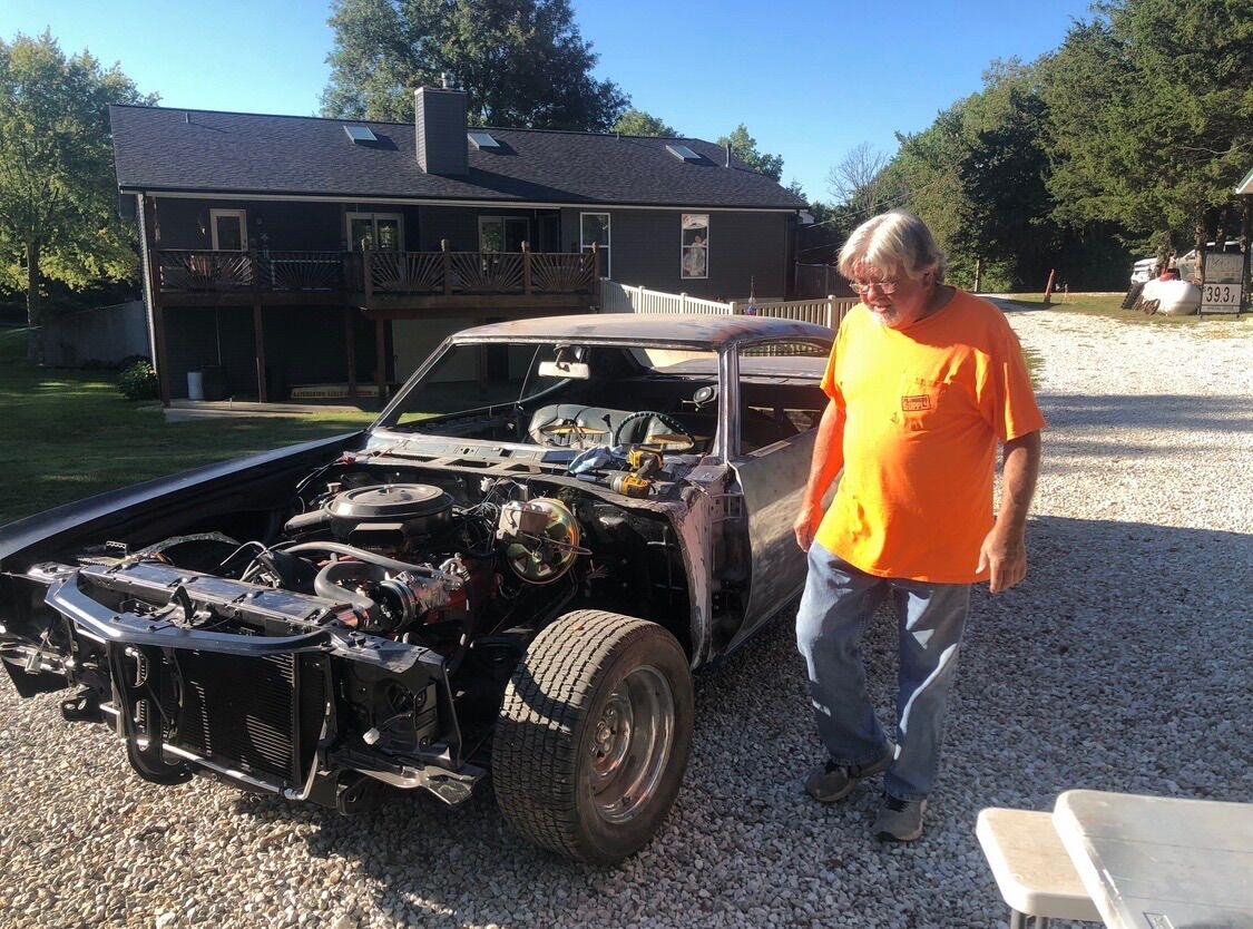

grizz Posted January 19 Author Posted January 19 I do love a bit of before and after. Dennis’ Chevelle. Westbay, GlenAnderson, Essex V6 and 3 others 6
Westbay Posted January 20 Posted January 20 Now , that I could get excited about! 😍 very nice, well done Dennis !

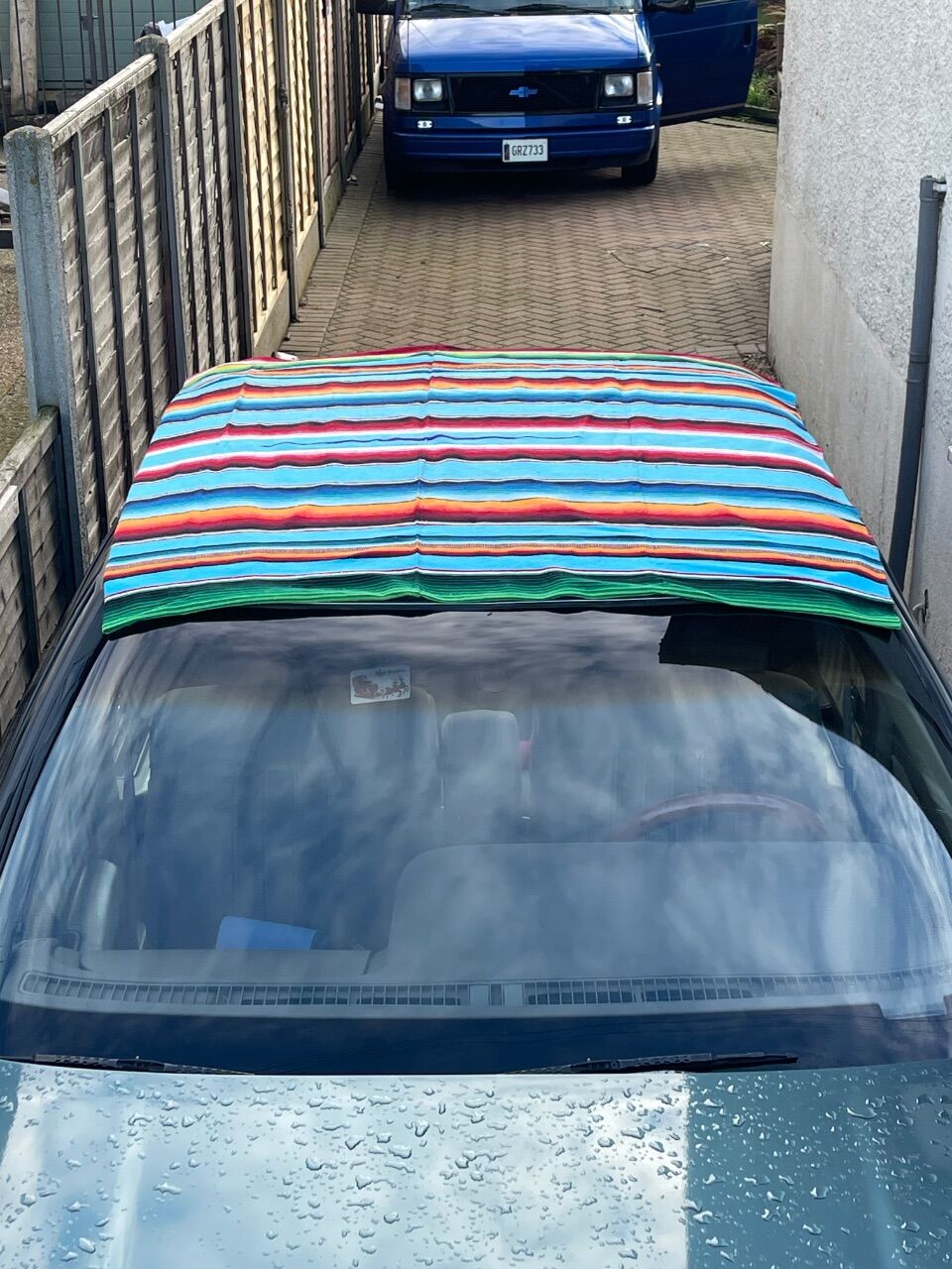

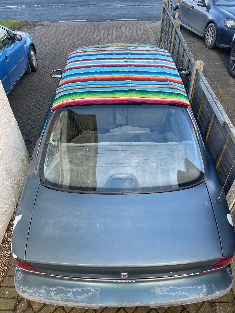

grizz Posted January 20 Author Posted January 20 Small jobs continue. Have you seen the roof lining yet?? Picture below. Yup….. looks like a prolapsed, you know 😳 So the suggestion from Dennis in St Louis is to use a specific sequence to remove the whole inner roof shell and then stripping and cleaning it thoroughly, followed by contact adhesive, on fresh lining and the shell. PROBLEM lies in not being able to find any foam backed roof lining material here in the UK of the right width of 1400mm minimum in fudge or beige So I started to investigate alternatives. I once did a Mazda Miata/MX5 hard top roof liner in Skulls and Roses for Nicola. It came out really good. So I thought about what else was out there, then remembered that also have random stuff stashed indoors (as you do) Mexican or Serape blankets come in so many different colours and designs. I chose the less busy design to drape over the roof, just to get an idea. If applied well and tidy it could work. .
Schaefft Posted January 20 Posted January 20 That could work although there must be a supplier for a suitable headliner material in beige. Wasn't @dollywobbler's Fairmont headliner about the same size? grizz 1
Westbay Posted January 20 Posted January 20 https://www.fabricuk.com/86-car-headlinings 182cm wide.... grizz and Joey spud 1 1

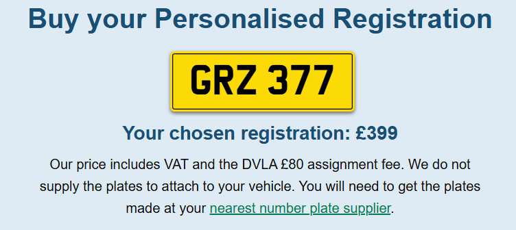

MrBig Posted January 20 Posted January 20 Just browsing number plates this morning and spotted this: Buy Now Joey spud and grizz 1 1
grizz Posted January 20 Author Posted January 20 2 minutes ago, MrBig said: Just browsing number plates this morning and spotted this: Buy Now Crowdfund or donate…… I am waiting That plate on the car is probably about 35% of the cars cost. Find something a lot cheaper and interesting to put on it. MrBig 1
grizz Posted January 20 Author Posted January 20 18 minutes ago, Schaefft said: That could work although there must be a supplier for a suitable headliner material in beige. Wasn't @dollywobbler's Fairmont headliner about the same size? I am not great at extended searches. But………, 14 minutes ago, Westbay said: https://www.fabricuk.com/86-car-headlinings 182cm wide.... Thanks Tony. SNAP !! Fil found this one as well. https://www.fabricuk.com/fabrics/511-extra-wide-vehicle-headlining-fabric-2mm-foam-backed-4-way-stretch.html £17.00 per meter plus shipping. So £34.00 to start off, plus decent glue. Westbay 1
eddyramrod Posted January 20 Posted January 20 @grizz I'm not sure if you were here when I had my last Cadillac, but I used a double-bed mattress topper from Dunelm. It'll be somewhere in here... grizz 1
grizz Posted January 20 Author Posted January 20 16 minutes ago, eddyramrod said: @grizz I'm not sure if you were here when I had my last Cadillac, but I used a double-bed mattress topper from Dunelm. It'll be somewhere in here... Hi mate I don’t get what you’re saying about the double bed ?
eddyramrod Posted January 20 Posted January 20 I bought a quilted mattress topper; double was just the right size for my 1973 Cadillac. As a cheap fix, it worked well enough, although sewing it into place was a pain in the back. And neck. And shoulders..... grizz 1

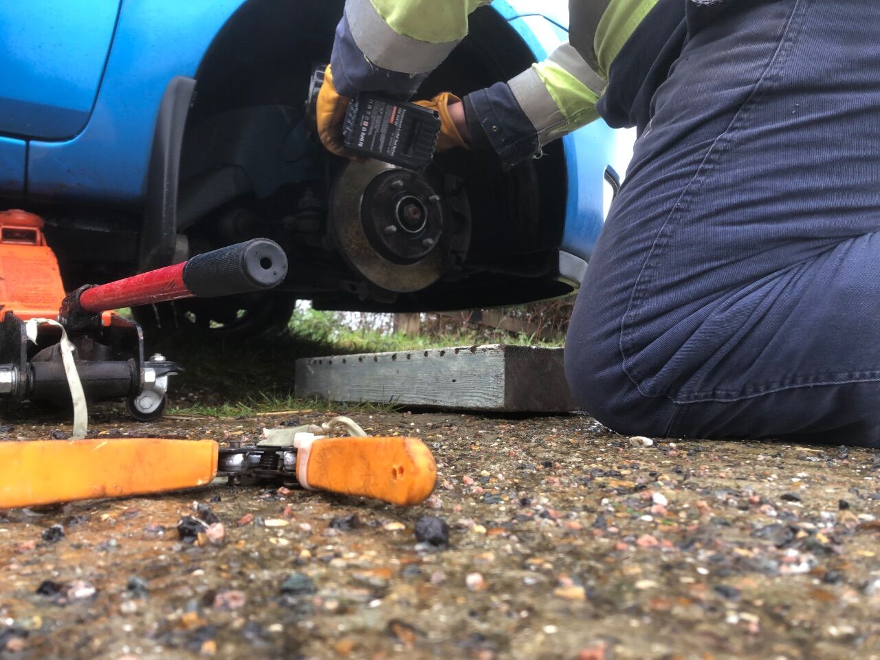

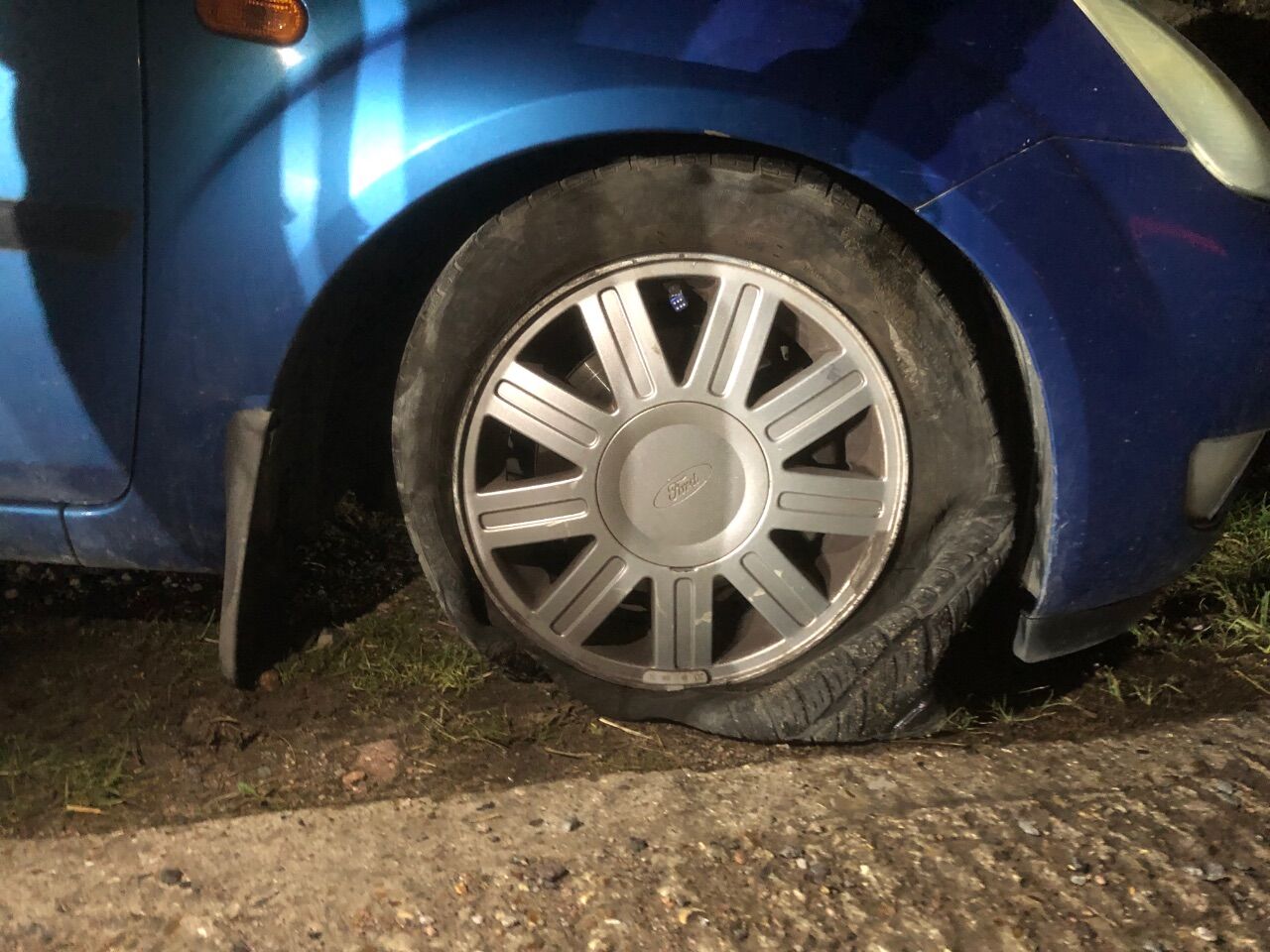

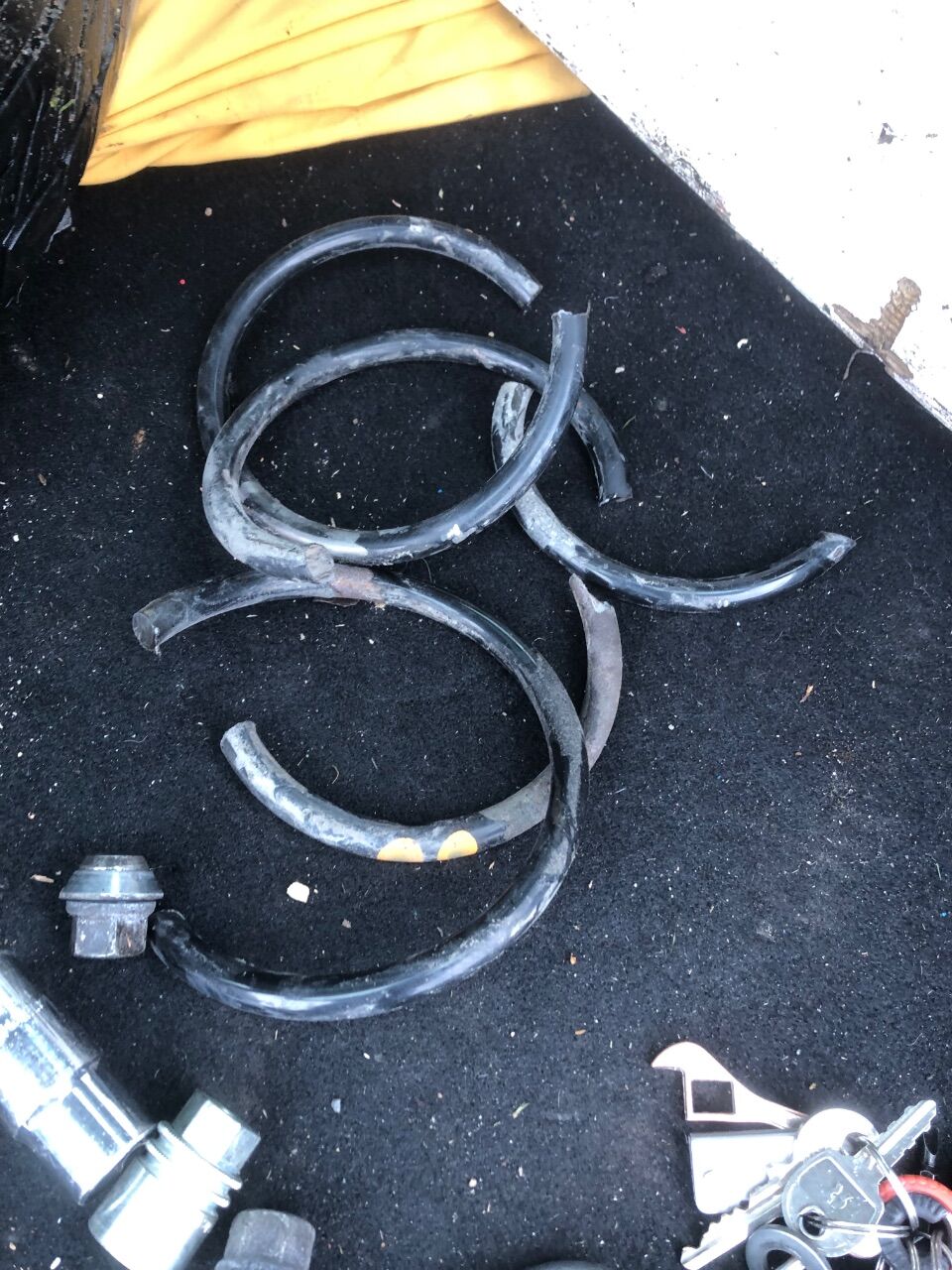

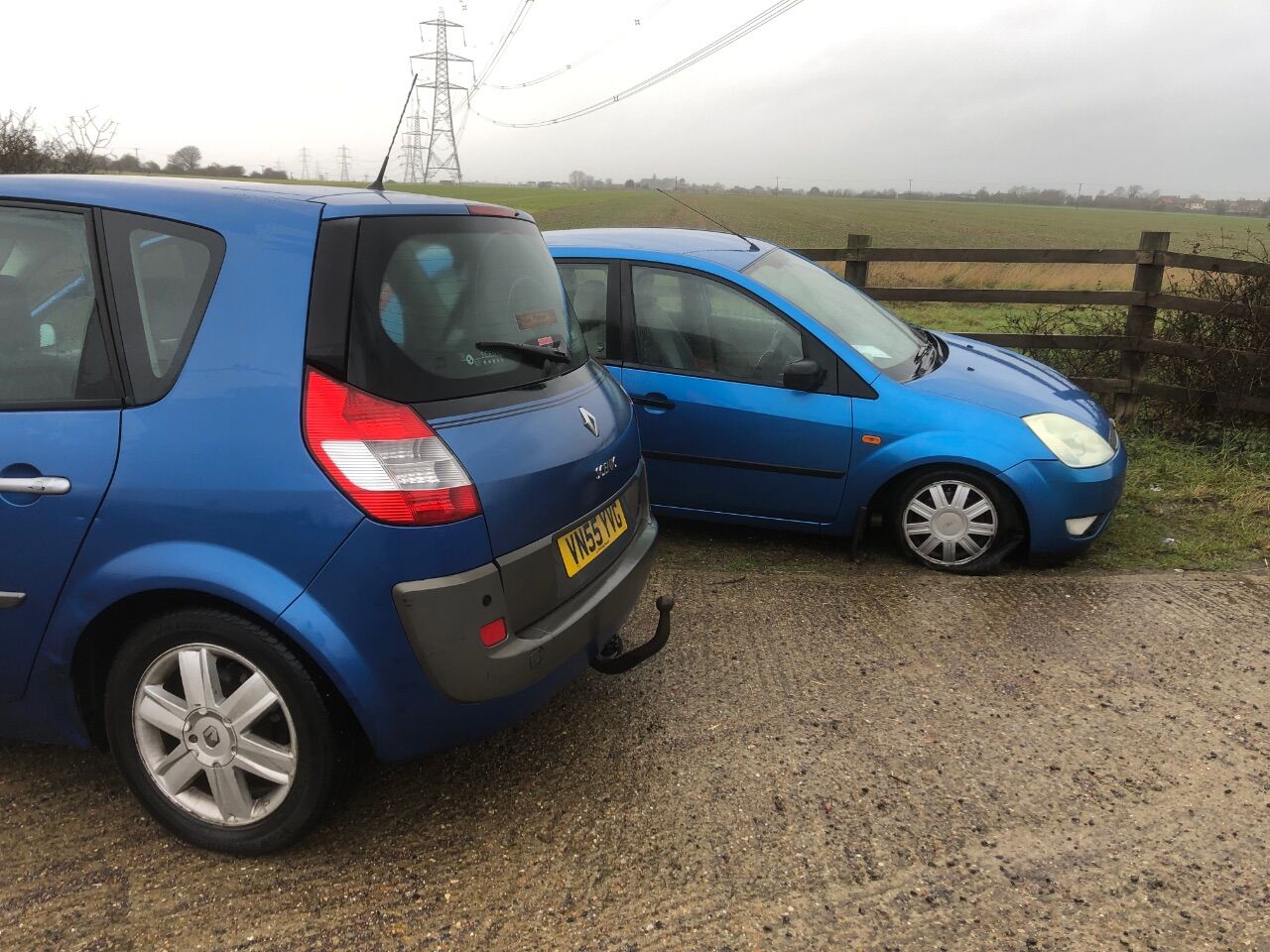

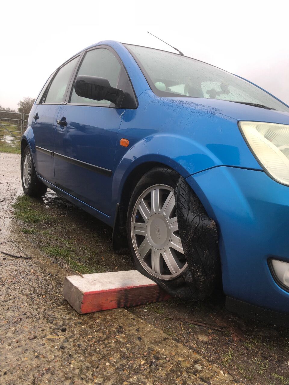

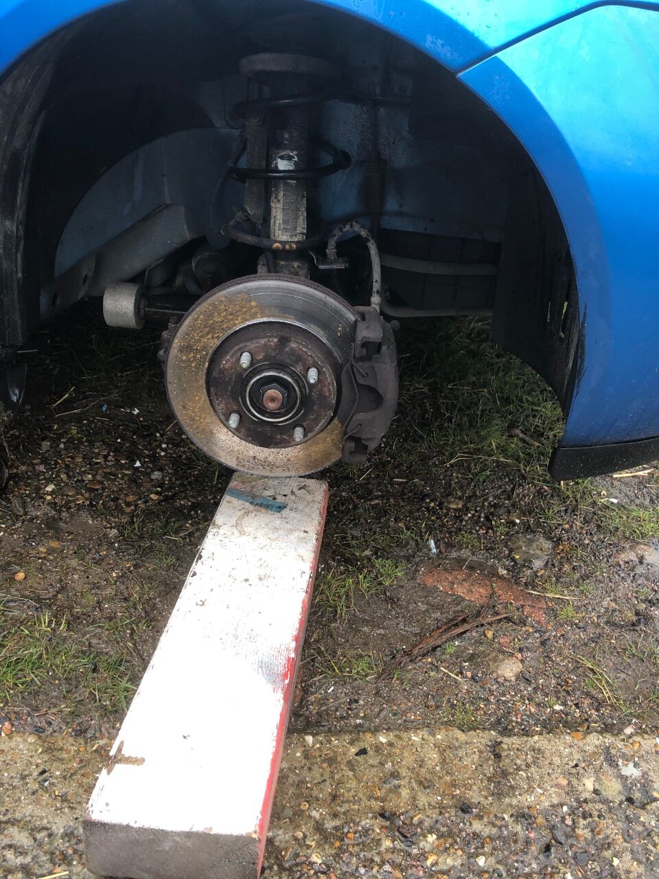

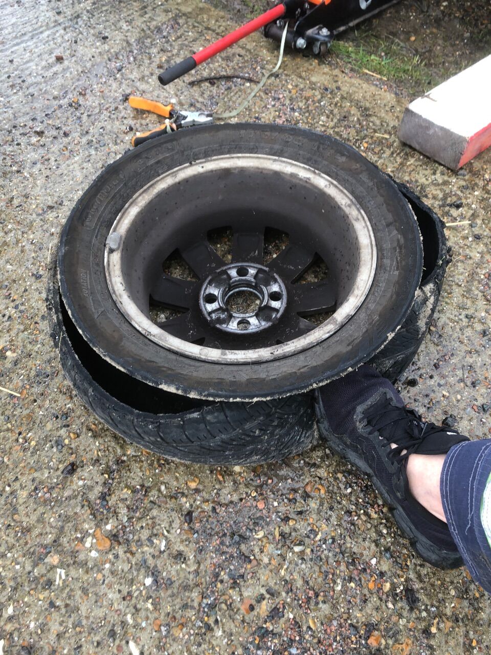

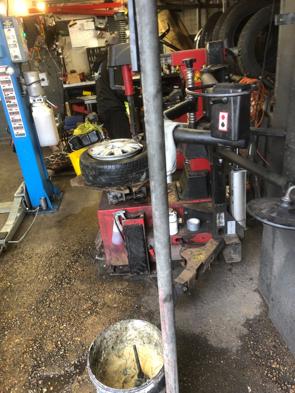

grizz Posted January 21 Author Posted January 21 Last night 5.15 Pedro texted. Car undriveable. So I went to look and found tyre shredded, front spring broken. So we came home after I moved the car way out of the way and lefta notefor any potential farmer or electric maintenance guy. Losds of advice from various quarters had me, trolley jack and cordless grinder headed out this morning after speaking to Cliff the local mechanic. Got to the stricken car Reversed it up onto a block of wood Trolkey jack in Alloy wheel off Cordless Grinder out 4 cuts Spare wheel on. Drove to Cliffs Automotive 4 miles at 30-40 mph Car dropped off for replacement of spring. Pedro said to just get it done. Which suited me with this chest infection that seems set on staying around. Mate PaulY also offered to come supervise on Saturday for replacing. But Pedro goes to site twice a day, so I am happy not doing the 7 mile each way ferry till Saturday. Just going to head out and get a part worn tyre fitted to replace the destroyed one. Then home to sit and feel sorry for myself 😉 . 93fxdl, lesapandre, Westbay and 2 others 4 1

grizz Posted January 21 Author Posted January 21 30 minutes ago, 93fxdl said: Above and beyond seems to be your minimum status Ttfn glenn We are not worthy Thank you. Life is good. Karma? An incredible mistress. She will kick or kiss your butt. Choice is always mine. £30.00 Part worn fitted, balanced. 30 miles a day, @40mph max Dont zoom. 93fxdl and Joey spud 2
