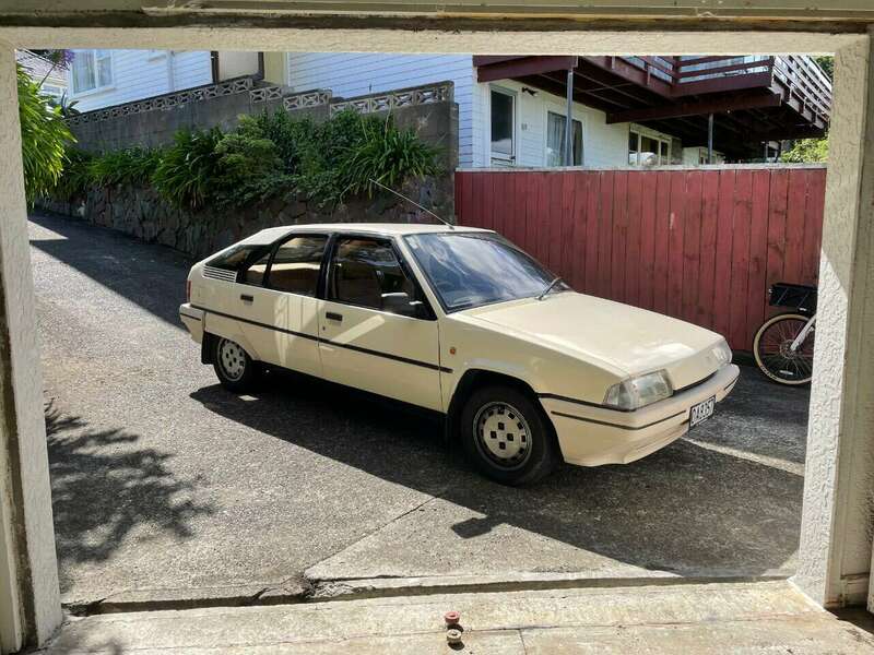

GagaStan Posted August 21, 2022 Author Posted August 21, 2022 11 minutes ago, hairnet said: I’d be looking for about 50 of those, here or there… And I think I should keep my mouth shut about the brits for a bit 😅
dollywobbler Posted August 21, 2022 Posted August 21, 2022 HOLY MOLY! I have never seen such beige/brown wonder on a mk2 BX. Stunning. GagaStan 1
GagaStan Posted August 21, 2022 Author Posted August 21, 2022 1 minute ago, dollywobbler said: HOLY MOLY! That’s what I thought when I saw the thing in real life! Even the window tint is brown. It’s amazing to behold And the pez auto adds a whole new level of creaminess to the equation, of course…
ETCHY Posted August 21, 2022 Posted August 21, 2022 That BX is bloody mega. It's given me a boner, ( & at my age that's an event !) Tenmil Socket, GagaStan and mitsisigma01 3
STUNO Posted August 22, 2022 Posted August 22, 2022 That makes me want a third BX , it's bloody lovely. GagaStan 1
GagaStan Posted August 22, 2022 Author Posted August 22, 2022 11 minutes ago, STUNO said: third BX Funnily though this is my third too! The first was a bit of a basket case, the second marginally better - but this one seems to have been actually maintained. Thank goodness.

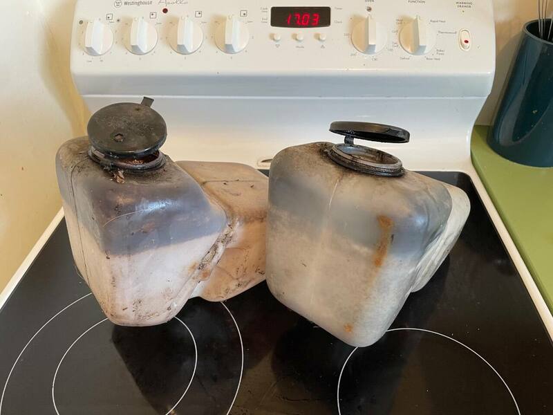

GagaStan Posted August 24, 2022 Author Posted August 24, 2022 This afternoon’s job: tackling the manky washer bottles. How manky, you say? so so mucky. The front washer tubing was completely clogged, and I don’t think the rear one had been used in quite some time. Will pick up some gravel to shake about in them tomorrow, they’ll need some mechanical agitation to get rid of all that crap. We’ll see if I can get the original front tube unclogged for some saucy cleaning action soon… grogee 1

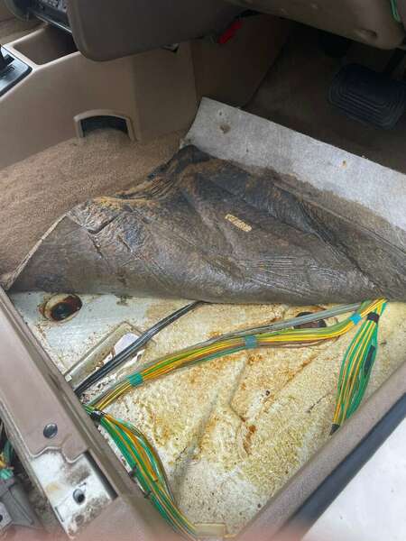

GagaStan Posted November 20, 2022 Author Posted November 20, 2022 Spent the afternoon trying to sop up the LHM that had soaked into the drivers carpet, from the leaking doseur. The underlay was the worst - it was completely saturated, and the LHM had done a good job dissolving some of the tarry black adhesive. Resulting in a delightful brown oil to try and remove. YUM With a combination of a wet vac, sugar soap solution, and a handful of old bath towels, I managed to get most of it out - or at least enough that my shoes won’t get stained driving it anymore. Mrs6C and Lacquer Peel 2
GagaStan Posted November 20, 2022 Author Posted November 20, 2022 Carpet is by no means pristine, but it’s somewhat presentable now. It looks like some pink coolant might’ve leaked from the heater tap in the past… Think I’ll be ordering some custom floor mats soon. at least the outside is still quite pretty! Dyslexic Viking, Lacquer Peel, Mrs6C and 7 others 10

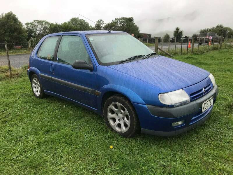

Essex V6 Posted November 25, 2022 Posted November 25, 2022 Welcome to the Citroen Club NZ Chapter! GagaStan, stuboy, JMotor and 1 other 4
GagaStan Posted November 25, 2022 Author Posted November 25, 2022 8 hours ago, Essex V6 said: Welcome to the Citroen Club NZ Chapter! It’s great to be here!! Trying to think on some of the great NZ/French crossovers… rainbow warrior maybe? 🫣 also that saxo looks like it’d be a right hoot. I don’t think I’ve ever seen one in the flesh! Which part of this great land are you in?
Essex V6 Posted November 25, 2022 Posted November 25, 2022 I am in Auckland although had to travel to just outside Christchurch to find my VTS! GagaStan 1

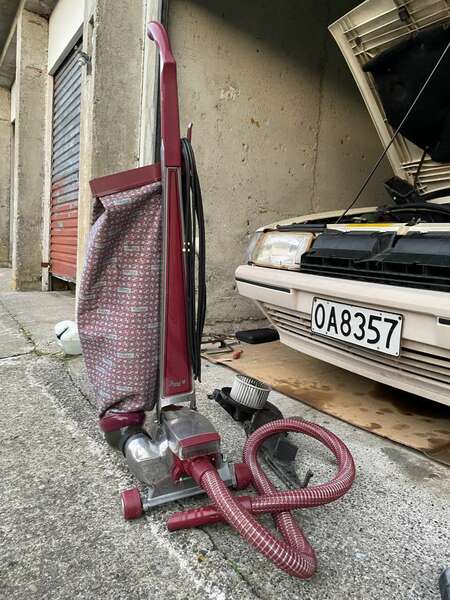

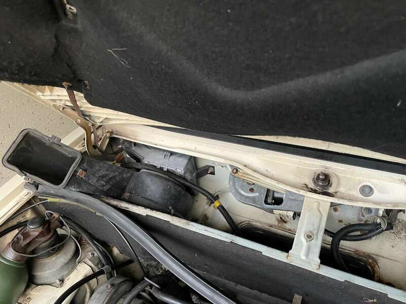

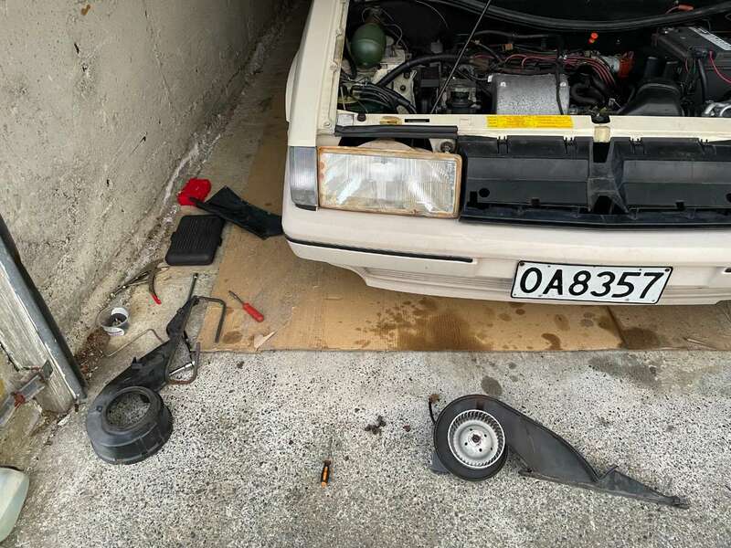

GagaStan Posted June 1, 2023 Author Posted June 1, 2023 The BX has been running absolutely beautifully, apart from some very light clonkage from a drip link (I think??) - she even returned a best ever 36mpg on a run. Nice to know that's possible, given I've only been getting about 25mpg around town 😩 But today, I decided to tackle something that's been annoying me - a consistent chirping from the passenger side blower fan. I had been managing* this by simply unplugging the electrical connector, but this caused the remaining operational blower to blow only half its air into the cabin, and the other half back outside through the other, stationary fan... Less than ideal for demisting purposes. SO, the time came to start disassembly in the bulkhead area. (^spot the terrible job someone did gluing the headlight back together...) With the offending fan out, and the plastic clamshell unclipped, I sprayed plenty of PTFE lube and hey presto, the squeak is gone! With the bulkhead clear, I decided to vacuum out all the built up leaves and detritus. Paging @beko1987 for some hot Kirby action... But what I didn't do, was remember to retrieve a clip that had fallen while I was removing everything. So, with an almighty CRACK it was sucked up, somehow made it through the fan, and up into the vacuum bag. Amazingly, neither the clip nor the vacuum fan were broken in the process! It was easily retrieved from the bag, so all is now ready to be put back together tomorrow. Another tinkering win - now to get someone in to see just how knackered/leaky the A/C is... dollywobbler, cort1977, mk2_craig and 5 others 8
