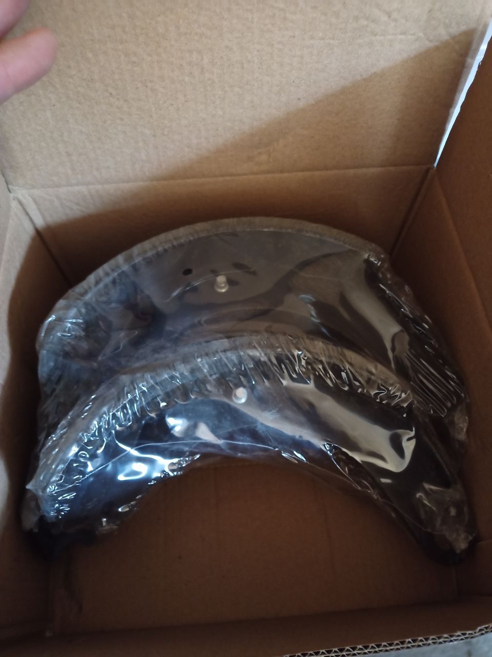

I ran an old beetle which had a long term dribble of oil - the back plate was similar and allowed the oil to fall straight through, although it was messy.
However pads for that were dirt cheap and easy to get, if I had rarer €200 pads I would probably be more careful with them.

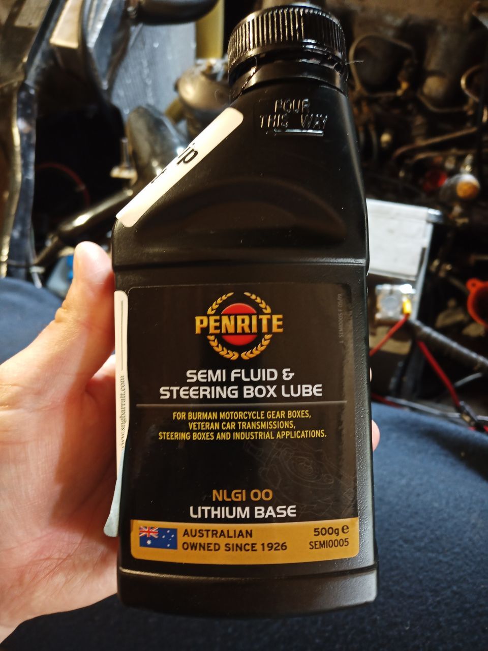

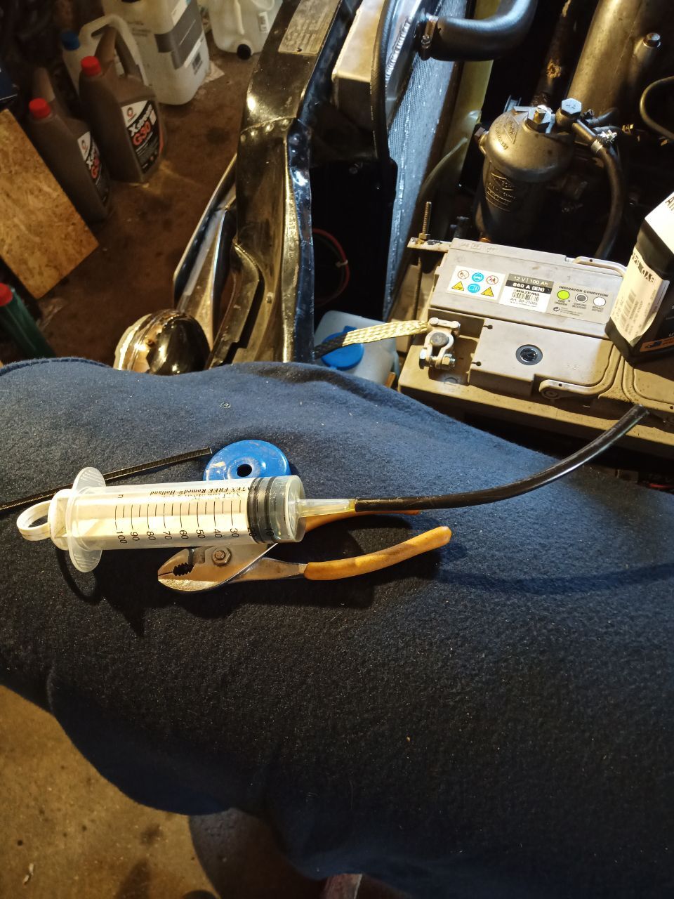

But I've had this delivered, on @Surface Rust recommendation I'm trying this in my leaking steering box.
But first I had to get the oil out of the steering box and there is no drain screw so I had to suck the oil out with this below which worked great.
Then the next challenge is getting this Penrite product into the steering box, which is not exactly easy as it is not exactly very fluid and the filling hole is small. But by working it in with a screwdriver I got a good amount in but I'm struggling to get more in so I think I need to let it sit for a day or two so it can slowly run out inside the steering box. So will try to fill in more later.
You could heat the oil by placing the bottle in a pan of hot water DV, might make it flow easier.
That's a good idea, I've tried a little carefully with a hairdryer but I can try this too.
I can't remember how I got mine in, probably left the bottle in the sun and might have used a metal syringe thing I have, looks a bit like this:
Try working the steering back and forth if you can,  maybe jack the front up so you don't have a heart attack!

I have finally managed to fill the steering box with the Penrite steering box lube, filling it with a funnel was pretty hopeless so I tried the syringe thing I used to suck out the oil and it actually worked to fill it with that. So then this is done.

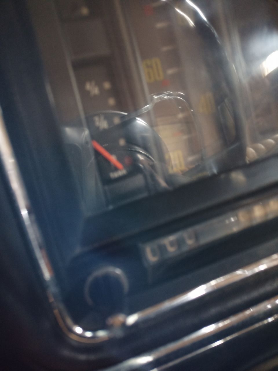

And the fuel sender gasket finally appeared.
And it fit, so with the fuel sender now installed it was time to see if the old fuel sender worked with this new fuel tank as it is really only for the smaller tank that was in the car.
With ignition off.
With the ignition on and about 20 liters in the tank, it rises a little, but not enough so the fuel light is on.
So a new tank level sensor is needed to get an accurate measurement but this can wait a little.
