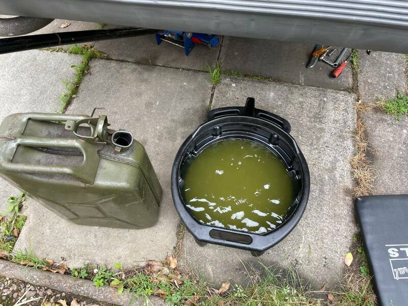

Mmmmmm is that Mountain Dew? First load out. Currently refilling it again
  • Like 6
Annnnd some more out after taking the return pipe off. Not far off 20 litres. Probably a gallon still left in but I’ll drain that out when the pumps re connected. CDE7E2CF-C252-4283-9DAD-29BB61FF6FE4.thumb.png.cbfa68ca79d64c4468af895a7b3590e9.png

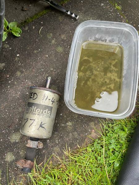

This was what came out of the fuel filter.
4618F718-2A05-4B27-B55E-E8A2C7F3CF4A.thumb.jpeg.30405639911fc2fecea8741d9f8ce517.jpeg98BCD31D-0063-46D7-9DC9-990EE87FD9F8.thumb.jpeg.c22350e8ddf94e5089b05f24a2b32b1b.jpeg
looking forward to POSSIBLY cranking it over with fresh fuel in it tomorrow. Watch this space.

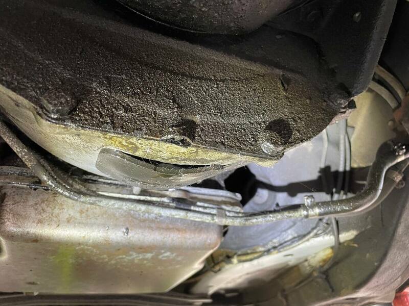

but today I got the front end up on stands to clean transmission oil leak off, to find out where it’s coming from.
im hoping it’s the two small pipes on the right. But I’m not going to hold my breath. It really needs a fluid change.

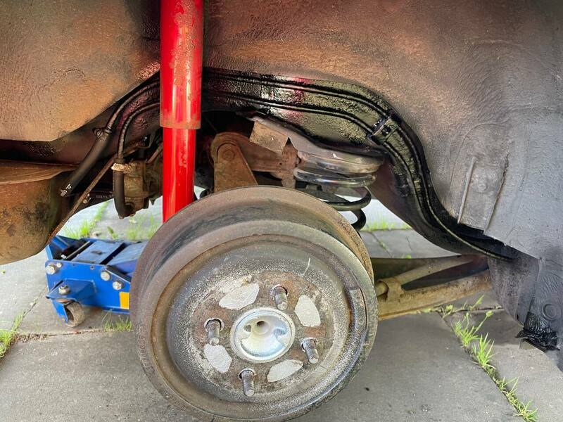

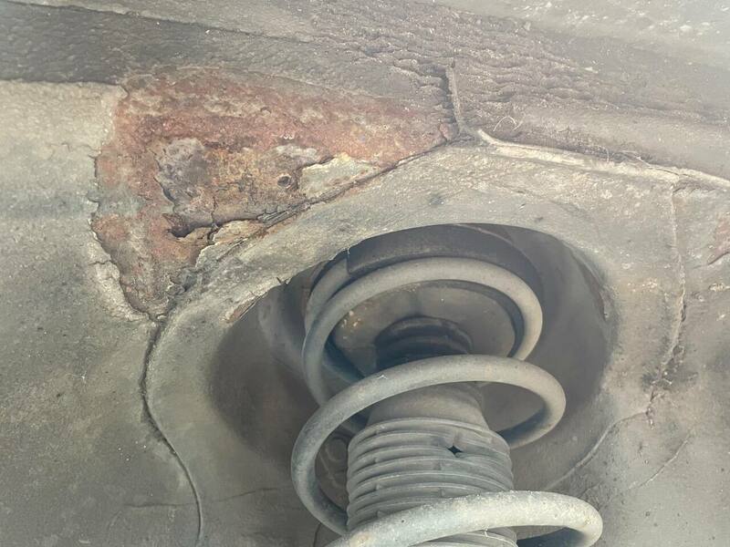

while it’s up, I’ll address these inner arches
Left side
right side
that is the only rust I can find on it. The rest is in really good condition
So the transmission oil leak hasn’t come back. I’ve had the engine running as well.  There’s plenty of oil in it, but I think for what it’s worth I’m going to change it anyway. Then if it needs a new pipe or a gasket it can have another change or top up.

I noticed a fresh patch of oil under it the other day. So this morning I slid under to investigate. It’s coming from the speedo cable. How odd! I’m sure these have an O ring, but can’t remember. I’ll pull it off tomorrow to further the investigation.
I have a sneaky feeling that this oil leak has been present for some years before it was laid up.. possibly. Due to how shiny the chassis rail is next to where it’s dripping. I’ll need to put some stone chip and waxoil there before winter.

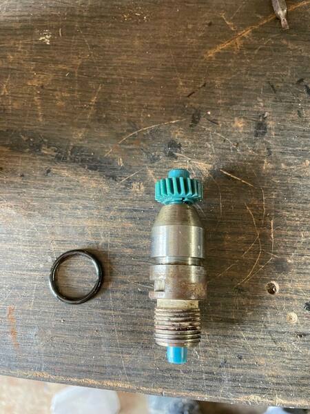

so I took the speedo drive gear out, it felt a little loose in the back of the gearbox. I’ve replaced the o ring, cleaned it and refitted
new o ring on
refitted the cable and drained the manky dark auto fluid out. Bought a 5 litre tub of it yesterday so that I can drain and refill the box a few times.

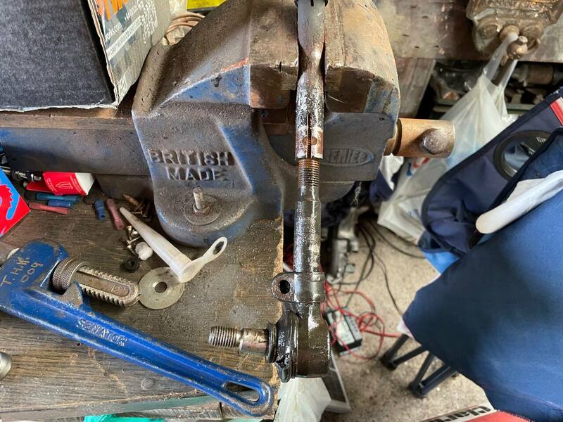

also replaced the nearside front outer track rod end. These have two each side because they are steering box setup with an idler on the passenger side. It was seized solid, so the whole thing came off and into the vice.
measure it up
swear at it for 20 minutes
and eventually came free.

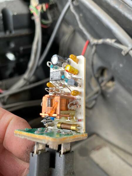

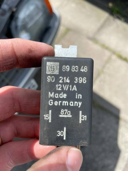

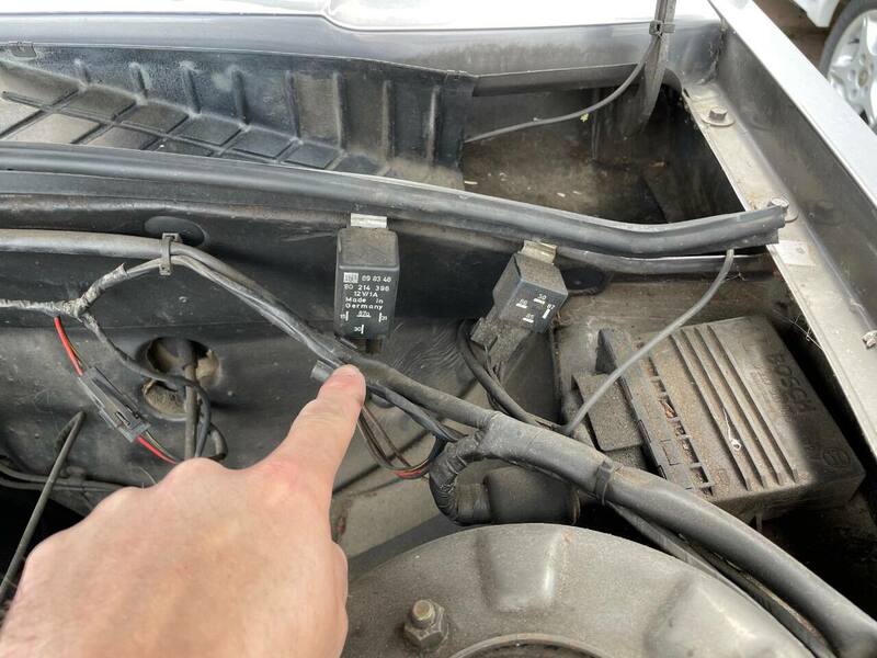

Well the damn thing won’t start now. Turns over but won’t fire, not even trying. Don’t think I’ve got spark. With ignition on, I have this relay attached to the bulkhead slowly clicking away. No idea what it does or why it’s effecting it. Struggling with electronics, don’t have a spare relay either.
  • Sad 1
Maybe has something to do with the auto lock feature?
if I disconnect this plug it stops clicking, but I still get no spark AC1F2B77-BB92-4838-AB3F-4A13EC7380B4.thumb.jpeg.543fe15b51d0f4f1945d2ac0bef13f00.jpeg
  • sutty2006 changed the title to 1986 Vauxhall Carlton CDi, RUNNING (NOT ANYMORE)
I don’t remember this relay in place on the manual 2.2i that I restored some years ago. Possibly the auto transmission cut out relay? So it can’t be started in gear? It’s currently in park…..
I'd expect a neutral safety switch to interrupt the starter circuit rather than ignition.
Back to basics.  Check if you've got power to the positive of the coil with the ignition on, then if so see if you've got a ground that switches on and off when cranking on the other terminal of the coil.
If either of those things are missing, chase it from there.
Guessing this has some form of electronic ignition rather than points in the distributor?
Yes it’s all electronic. I’ll have to bring my decent multimeter back from work on Thursday so I can have a crack at it again. Check the basics like you said.
Even just a 12V test lamp will do just fine for proving the above, doesn't need to be anything fancy.
I’ve got power to the coil, but I’ve no power when cranking.
This random relay has 12v to it. But nothing when cranking. When you stop cranking, 87a gets power briefly before cutting out. I have taken the relay to an electrician to be checked over.
also currently looking for a replacement as well.
Intriguing...at a glance I'm assuming that's looking for a threshold voltage before turning something on, or is a timer.  Though why you'd use separate caps, resistors and a amplifier for that rather than just a 555 I don't know.
Do you have a wiring diagram for the car and/or if ignition and starter circuits?  Shouldn't be too difficult to figure out what that relay does with that.
