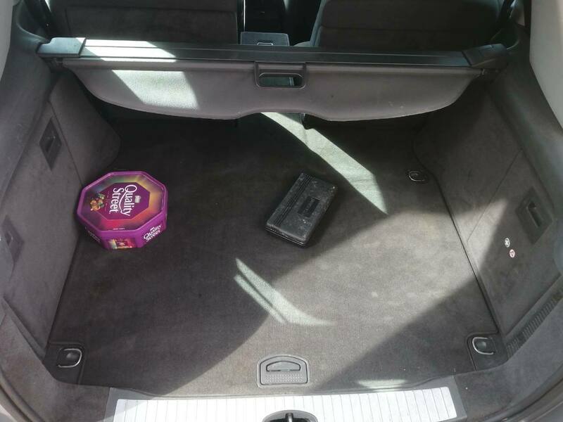

Dobloseven Posted April 14, 2022 Author Posted April 14, 2022 Got the boot open. Crawled inside, removed bung on inside of tailgate. There's a square hole deep inside, that's just right for a 1/4"drive extension for undoing the lock. Didnt have time to do anymore, as going out and away tomorrow for a few days. Good flat loadspace with no lip and over 6ft long. mk2_craig, Lankytim, inconsistant and 2 others 5
Popsicle Posted April 14, 2022 Posted April 14, 2022 Not sure if the boot opening is the same as a Vectra, but assuming it is, the exterior handle for opening is operated by a microswitch underneath the rubber grab handle. Its a little ball bearing that moves to make the contact when you apply pressure to open the boot. These get gunked up and seize up. Remove the rubber handle surround and clean up the ball bearing, there is a hinged strip of metal that presses the ball bearing to activate the switch, this should hopefully help out as its a common problem on Vectra's. Pictures robbed from google. Red bit is the bearing/switch. Dobloseven 1
Dobloseven Posted April 15, 2022 Author Posted April 15, 2022 5 hours ago, Popsicle said: Not sure if the boot opening is the same as a Vectra, but assuming it is, the exterior handle for opening is operated by a microswitch underneath the rubber grab handle. Its a little ball bearing that moves to make the contact when you apply pressure to open the boot. These get gunked up and seize up. Remove the rubber handle surround and clean up the ball bearing, there is a hinged strip of metal that presses the ball bearing to activate the switch, this should hopefully help out as its a common problem on Vectra's. Pictures robbed from google. Red bit is the bearing/switch. Think it's a bit of a Vauxhall thing. Took my cousin out last night,in the Signum, he's well impressed with it. He's got an Astra estate of similar vintage(H?),that has similar issues. I certainly can't feel the microswitch "click", like I can on our other cars. Just need a chance to have go at it. We're away today in the caravan till next week, so the fun's been stopped. Really is a nice old thing. Only issues I've found so far apart from the tailgate are the rear wiper blade which lost its rubber during jetwashing, the tatty drivers seat, the even more tatty gear knob and gaiter, and the passenger door mirror cover with a lump out of it. I've ordered a replacement and bought a can of paint that looks about the right colour from Halfords. The front bumper has some deep gouges as well, so might have a go at them if the match isn't too bad. Other than that, really happy with it. Drives well and really quite lively. Was playing with the vintage sat nav last night. Works well, but it's trapped in 2004! AnnoyingPentium, Popsicle, DVee8 and 2 others 5

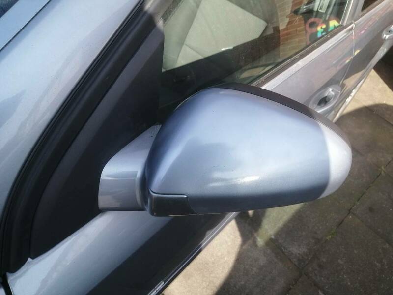

Dobloseven Posted April 21, 2022 Author Posted April 21, 2022 Not feeling that well, so finished early and thought a bit of fresh air might xo me good. Mirror cover and rear wiper blade had arrived, so got cover painted. Reminded me of how good modern rattle cans are. Sadly I'm old enough to remember when a Holts can contained a tiny amount of coloured thinners. That no matter if you shook it till your arms ached, it would run everywhere and react with everything. While it was drying, I fitted the wiper blade. I get really annoyed by rear wiper blades getting forgotten. Last year I rescued a Meriva. Previous owner had let the rear blade disappear and rub a groove in the rear window. Which looked worse because it was privacy glass. A new blade cost under 8 quid, Including two front ones. And post and packing so no need to leave the sofa. Vacuumed it all out, spare wheel well was full of foliage from tip runs. Cleaned the seats and carpets with the VAX Spot Washer we bought for dog "accidents". Look a lot better now, but really needs a replacement drivers seat to be anything other than a "ten footer" as him out of Bangers and Cash would say. Shan't bother with the gear knob and gaiter unless I can find one. Also put some black silicone round the rear bee sting aerial to restick the rubber gasket that came adrift with the jet washing. Son's coming up from Wales at the weekend so will let him have a look. Think the rear seat issue will be a deal breaker, though. Unless one of his child seats will fit on it, he's got a one year old, a three year old and a twelve year old he has shared custody of, from a previous relationship. Oh and the headlights were a bit cloudy, so I gave them a quick T cutting. 9 Dan29, GrumpiusMaximus, Datsuncog and 8 others 11
