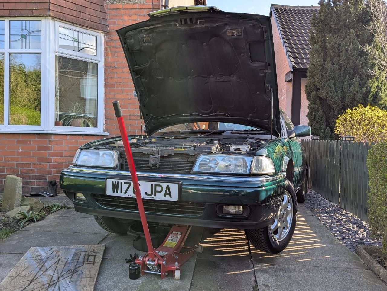

Current work is preparing the engine for the belt and water pump change! 😳

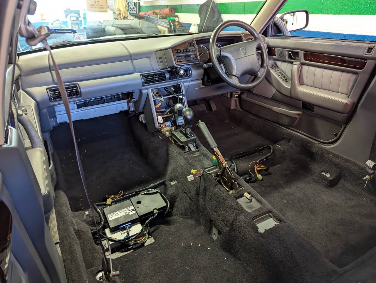

Anyway! Rather than face up to that particular problem, let's tackle Rover 800 nonsesne item No.2 - the interior is full of water. 💦
Water ingress in these can go unnoticed for months and months. First the dense foam under the carpet needs to become completely saturated, so for the actual carpet to be damp to the touch means there's a considerable amount of water in the car, especially when you consider the back of the carpet is a thick plastic membrane! The culprit? The usual sunroof drain stub.
The interior was stripped out about a month ago, and the carpets and insulation are now finally dry;
Next job was to remove the headlining. This was in pretty good condition but after being disturbed the fabric became detached from the fibre board. This will need to be retrimmed. You can see where the water from the sunroof tray has been leaking;
if anyone is interested, sunroofs weigh an actual ton and are no fun to remove. I'm not looking forward to putting it back. There are four drain points, and only the one (o/s/f) was rotten. Here's where it was, after being removed by the Dremel; (bodge to follow)
It's very empty inside!

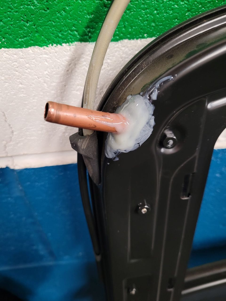

The rotten drain tube on the sunroof tray is repaired. A short length of copper pipe is now bonded in to the cleaned up hole where the old drain was. It even got a coat of black paint to make it look less like a bodge!
Getting the whole sunroof assembly back in the car was hard work... but not as hard as realising they are actually quite finely positioned and it took a lot of work slackening off bolts and moving the whole lot by millimetres, tightening and testing again to find the location where the sunroof had its full range of movement. It'll be a few weeks before it gets a leak test!
