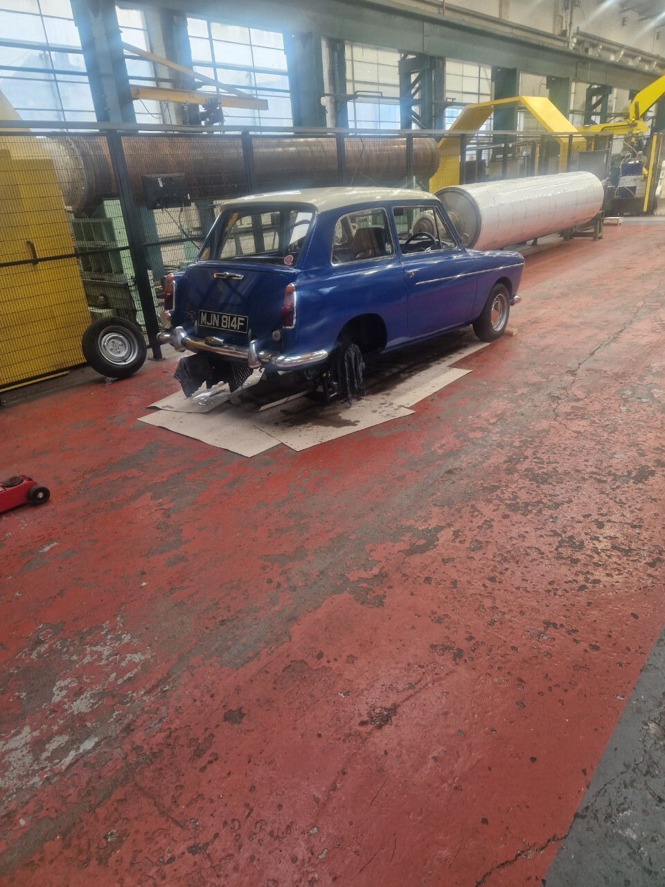

Not technically Austin related. However I'm doing the work and it's my thread so balls to you 🤣

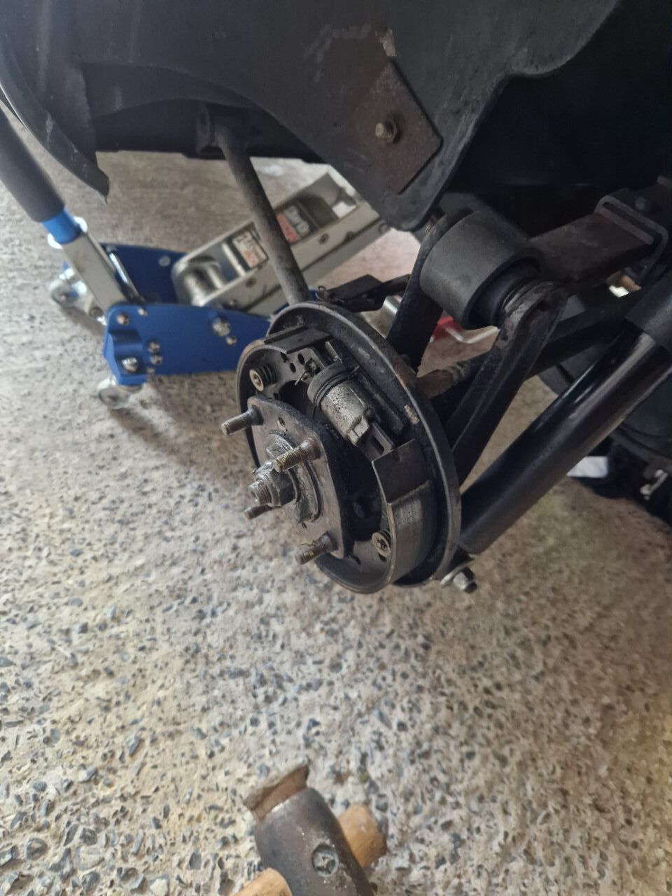

As a family we bought wheels for the Spitfire for my Dads Xmas and birthday present. Well i bought them and everyone else paid me off. However this necessitated new studs all round as the standard length studs are not long enough to accommodate alloy wheels.
Front hubs were easy enough. Hubs off, discs off hubs. Knock the old ones out, press the new ones in in the vice.
The rear ones, well. Recieved wisdom is that Spitfire rear hubs cannot be removed without the correct Churchill puller. Can't even use my hydraulic 3 legs as they distort the hub.
The Old ones can be knocked out in situ, but there isn't enough clearance behind the hub to fish the new ones in as they are longer. So again the received wisdom is to drill a hole in the drum back plate to facilitate this. Which would need to be 16mm! So I arrived armed with step drills, a 16.5mm bit that I'd turned a blacksmiths shank on at work and 2 16mm closed grommets.
So after doing the fronts the back end went up and the drums and shoes came off. Oh, look at that wheel cylinder. I bet with that off we can fish em through there. Fuck drilling holes 🫡
20250419_103025.jpg.d7922525e6bf52724575fbe9c900d5f7.jpg20250419_103013.jpg.1e5a2998dfae96f051d584bb422287a6.jpgWent surprisingly well. Aside from having to draw the new studs in with old nuts and a stack of washers. Bit nerve wracking as UNF but plenty of oil and patience and no damage done.
Worth it though. Bloody told him Revos would look the biz.

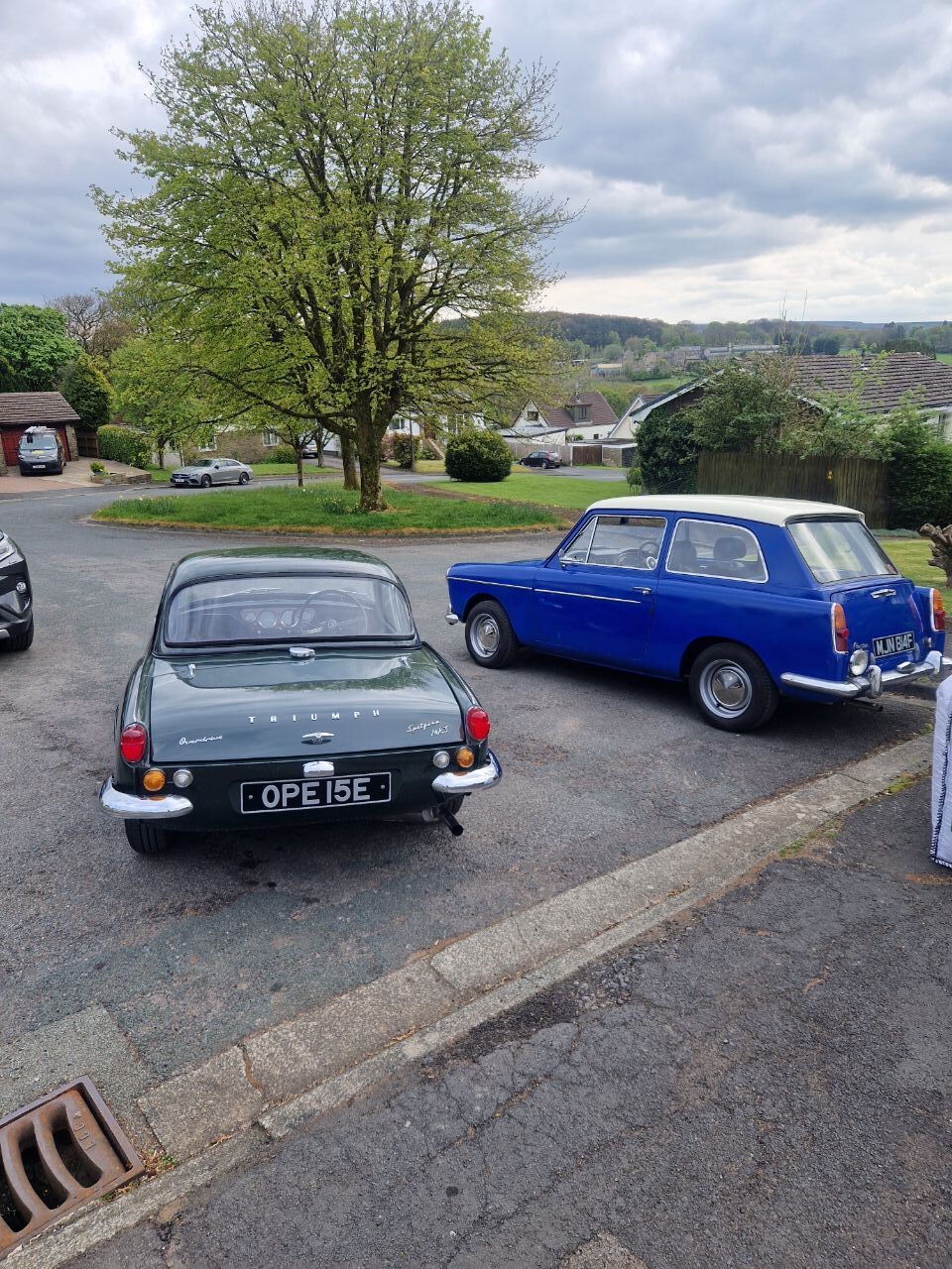

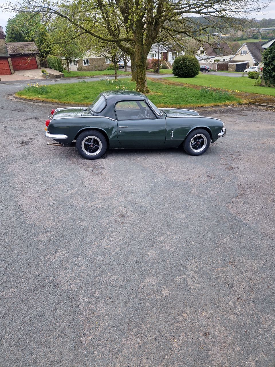

As requested @horriblemercedes.
Managed a quick baz about this aft after I'd been into work and all the jobs were done. Love this little thing still, goes like stink and handles miles better now I've finally grown a pair and wound the adjustable valves in on the front dampers (and put some actual pressure in the tires 🤣). I'd been considering a change after this year to something with more legs. Unfortunatly im about 8 grand shy of where I'd need to be for the dream car (Gilbern Invader mk2). So a good job I'm still getting on with this.

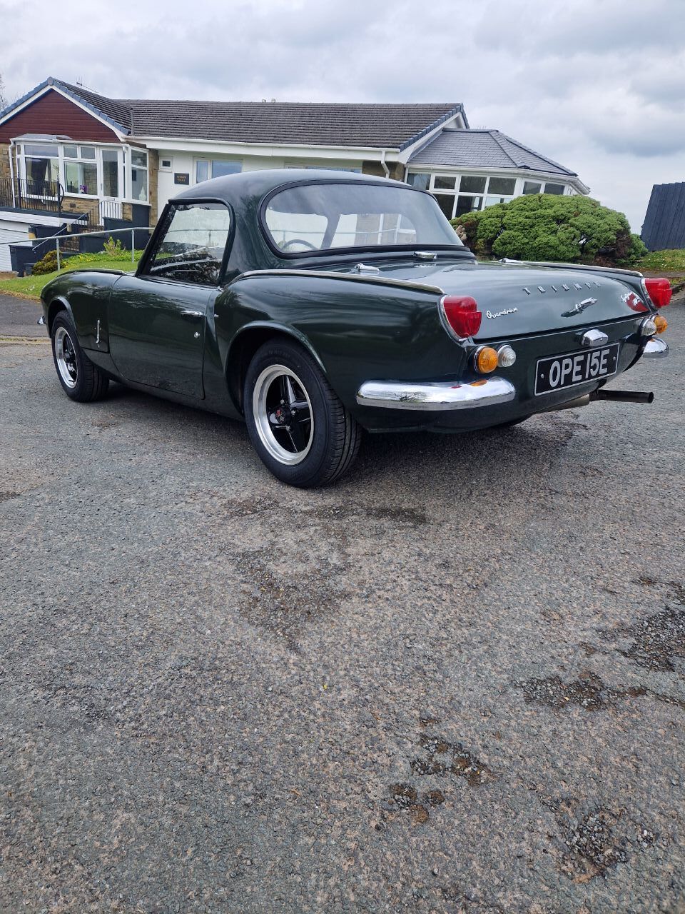

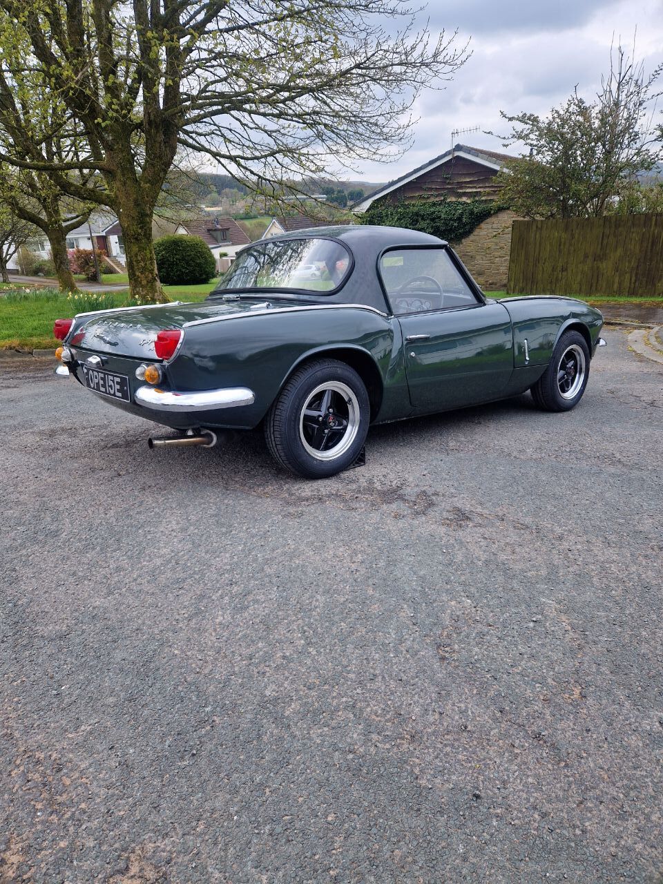

20250420_104421.jpg.bb455af0e8c08904c28c50fcf8b72df0.jpgFinally managed a photo with the Spitfire too. Front trunnions are done. New wheels are on. Hardtop is finished and back on. Now the new rear screen seal is wrong 😑
Never mind. Ive took it back out and Woolies are sending some samples of the right profile in differant sizes. We will get there. One day 🫡
20250425_162512.jpg.f7ff7962b7b5991f56920afc1e50de9b.jpg20250425_160942.jpg.7be764b4dcafadf96f5865c4cfa4184f.jpg
