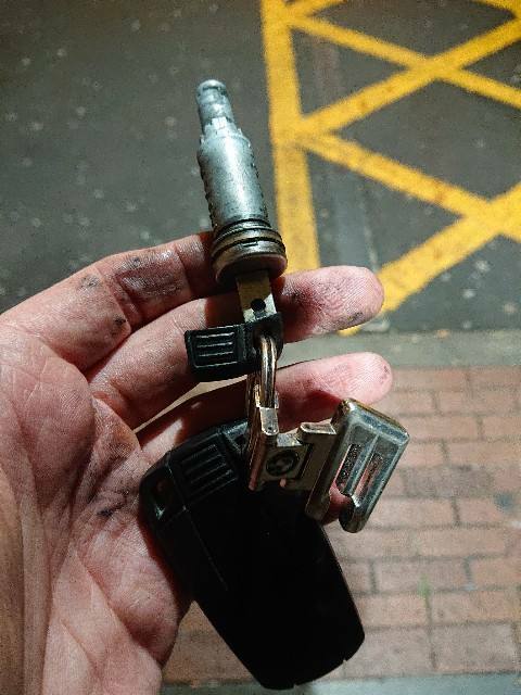

horriblemercedes Posted January 28, 2022 Posted January 28, 2022 Tried to unlock my car at the supermarket and the whole lock came out. Car is still locked. Remote doesn't work. Any ideas?

horriblemercedes Posted January 28, 2022 Author Posted January 28, 2022 5 minutes ago, wuvvum said: Can you shove the barrel back in and try turning it in its hole to see if that unlocks, or does the whole assembly just spin? It just spins unfortunately. Sounded like something broke and fell inside the door
wuvvum Posted January 28, 2022 Posted January 28, 2022 Can you get a finger in the hole (fnarr) and find the lock mechanism and unlock it that way? There's probably a lever to lift or something somewhere in there. horriblemercedes 1
horriblemercedes Posted January 28, 2022 Author Posted January 28, 2022 8 minutes ago, wuvvum said: Can you get a finger in the hole (fnarr) and find the lock mechanism and unlock it that way? There's probably a lever to lift or something somewhere in there. Just a cylinder in there. Nothing that I can manipulate as far as I can see. I guess I'll smash a window!

sdkrc Posted January 28, 2022 Posted January 28, 2022 Balls. If the supermarket sells coat hangers you could try jimmy your way back in through the top of the door or via the lock? Not sure how relevant this is but screwdriver through the empty door lock slot works for this e90 https://youtu.be/yY5mUzPMqaY horriblemercedes 1

horriblemercedes Posted January 28, 2022 Author Posted January 28, 2022 53 minutes ago, sdkrc said: Balls. If the supermarket sells coat hangers you could try jimmy your way back in through the top of the door or via the lock? Not sure how relevant this is but screwdriver through the empty door lock slot works for this e90 https://youtu.be/yY5mUzPMqaY U R A STAR! This worked perfectly. Got a lift home, collected the V5 (in case I was challenged because trying to open a car with a screw driver looks dodgy as anything!), used a screw driver to jimmy it and it opened up. Now I just need to make sure I leave no valuables in it and I'll replace the lock ASAP. Thank you for all thoughts and replies here sdkrc, JJ0063, Fumbler and 2 others 5

horriblemercedes Posted January 28, 2022 Author Posted January 28, 2022 3 hours ago, mk2_craig said: What a fucker!! I had the same thing happen to me on a mk3 Fiesta, Chubb type key. Fuel cap lock though. Culprit was a circlip missing from right at the far end of the barrel. I've done a bit of reading up and it appears this is exactly the fault on this BMW model! mk2_craig 1
horriblemercedes Posted January 28, 2022 Author Posted January 28, 2022 7 minutes ago, riek said: If it's anything like the E46 lock then a rebuild kit for the barrel is quite cheap. Looks like it! I'll get one ordered and get to it
horriblemercedes Posted January 28, 2022 Author Posted January 28, 2022 3 hours ago, wuvvum said: Can you get a finger in the hole (fnarr) and find the lock mechanism and unlock it that way? There's probably a lever to lift or something somewhere in there. It appears that the cylinder operates a micro switch quite deep inside which operates an actuator so I didn't think this would work. I couldn't have managed it without quite a long, broad screw driver but your principle worked perfectly
