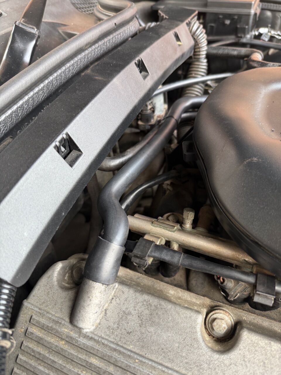

JJ0063 Posted August 21 Author Posted August 21 Hopefully the last piece of the puzzle! Crank case breather pipe had a split in it and looked to be the cause of an intermittent EML. Revs dropped when the brake was pumped so was suggesting a vacuum leak somewhere. Pipe replaced, codes cleared and revs no longer drop. Coprolalia, IronStar, MAF260 and 6 others 9

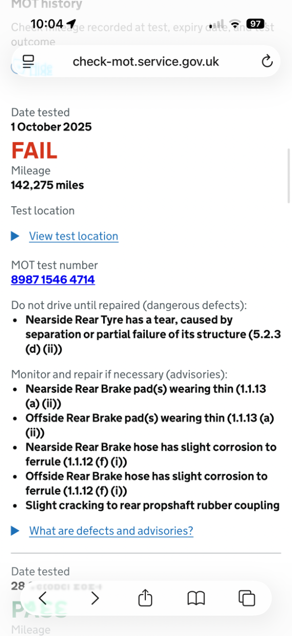

JJ0063 Posted October 1 Author Posted October 1 Dropped this off for its MOT last night. My MOT guy rings me just now and goes “you’ve booked it a day too early to preserve the existing date” then says “shall i still do it today, doesn’t really matter to you does it you’ll sell it in 3 months” He knows me well 😂 Erebus, yes oui si, Matty and 9 others 1 11

JJ0063 Posted October 1 Author Posted October 1 Didn’t think that was terrible until I looked at the price of a tyre, it’s got Pilot Sport 5’s on it, £180+ a corner 😢 Not keen on mismatched tyres but I might have to consider something cheaper! yes oui si 1
JJ0063 Posted October 1 Author Posted October 1 £190 for a matching Pilot Sport 5, or £80 odd on a budget. What shall I do? Feel like I ought to spend the money but I also don’t have loads of spare cash.
stuboy Posted October 1 Posted October 1 20 minutes ago, JJ0063 said: £190 for a matching Pilot Sport 5, or £80 odd on a budget. What shall I do? Feel like I ought to spend the money but I also don’t have loads of spare cash. spend out if keeping..................... budget if outing it soon......... JJ0063 1
Imhotep Posted October 1 Posted October 1 I’d spend on it. It’s coming into winter, it’s RWD, and it’s your daily. Do you really want a cheap tyre on the back? BorniteIdentity, Brigsy, Westbay and 1 other 1 3
BorniteIdentity Posted October 1 Posted October 1 32 minutes ago, JJ0063 said: £190 for a matching Pilot Sport 5, or £80 odd on a budget. What shall I do? Feel like I ought to spend the money but I also don’t have loads of spare cash. Do it nicely. If you're going to sell it, matching tyres tells an awful lot about a car. £110 on a car like this is peanuts. Brigsy, EyesWeldedShut, JJ0063 and 1 other 4
Matty Posted October 1 Posted October 1 46 minutes ago, JJ0063 said: £190 for a matching Pilot Sport 5, or £80 odd on a budget. What shall I do? Feel like I ought to spend the money but I also don’t have loads of spare cash. Surely plenty of choice in between Michelins and Ling Longs JJ. I'm running am all Hankook fleet at the minute. Probs wouldn't have unmatched tires on the same axle mind but then I'm wierd. JJ0063 1
JJ0063 Posted October 1 Author Posted October 1 I think I need to just do it. Stop being tight. mk2_craig 1
JJ0063 Posted October 1 Author Posted October 1 Booked. PS5 4pm tomorrow. Also remembered the seller of the car gave me a new set of rear pads so I’ll fit those at the weekend and clean up the brake hose ends to get rid of those advisories. Popsicle 1
JJ0063 Posted October 2 Author Posted October 2 Done, that’s the most I’ve ever spent on a tyre. He reckons someone had a puncture and driven on it flat as it had a plug and the inside wall was very split. mercedade, Popsicle, mk2_craig and 6 others 9
JJ0063 Posted October 3 Author Posted October 3 Pads done Flexis I’ve wire brushed, painted black then put some spray grease on Hopefully end up with just the prop donut advisory although even that feels harsh, it’s got the tiniest perish to it Matty and mk2_craig 2

JJ0063 Posted October 8 Author Posted October 8 We’re back! Either my paint and grease of the brake lines wasn’t good enough or he didn’t look that far on the retest 😂 JakeT, vtec-e, mk2_craig and 4 others 6 1
