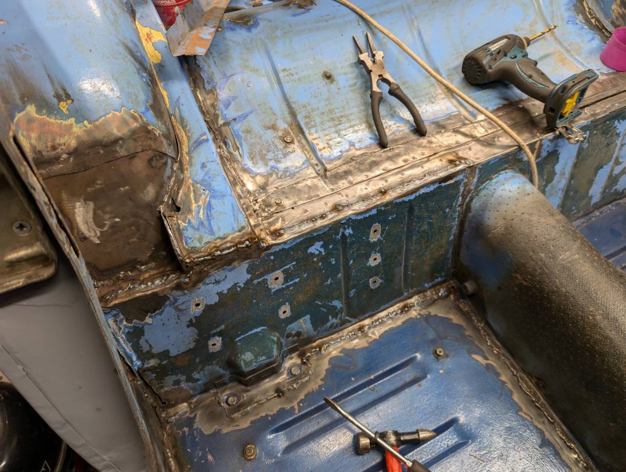

Some grinding for a Friday night. Then welding to fill the holes from grinding. Then more grinding. Rinse and repeat. Finally paint.
This took a good hour and half to get to this stage. Welding is a pretty quick job. It's the prep and post finish that takes the time.

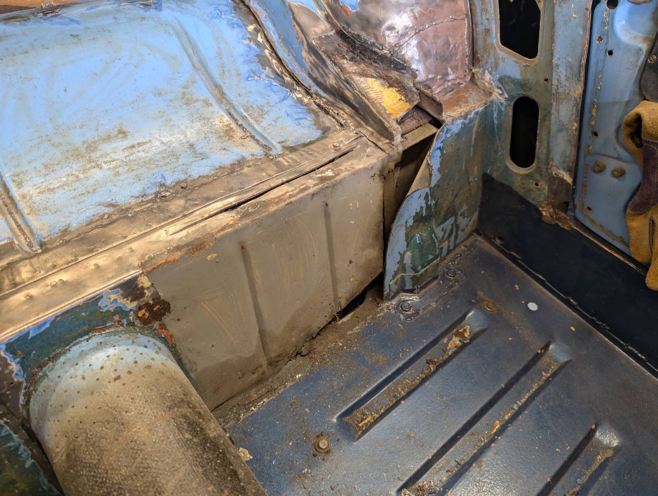

This is the gap I'm talking about that's between the floor and body. Huge gap that's big enough to get a large flat headed screwdriver in with it on the widest side. Probably a good 1cm at the widest. This was originally hidden (badly) with good ol' filler. Still haven't quite managed to clean all that out yet either.
My current thought is to cut the floor on the right hand side (shit welds anyway) and then hope I can bend the floor upwards to close the gap. The other end has a gap but much smaller. Still larger than I'd like but probably only quarter centimetre or so.

How is that gap there? Was it really that bad from the factory, or has some large scale bodging taken place on the floor or body?
Invaluable insight into restoration techniques, this whole thread. Keep it up!
The floor has been replaced previously. Just not very well.

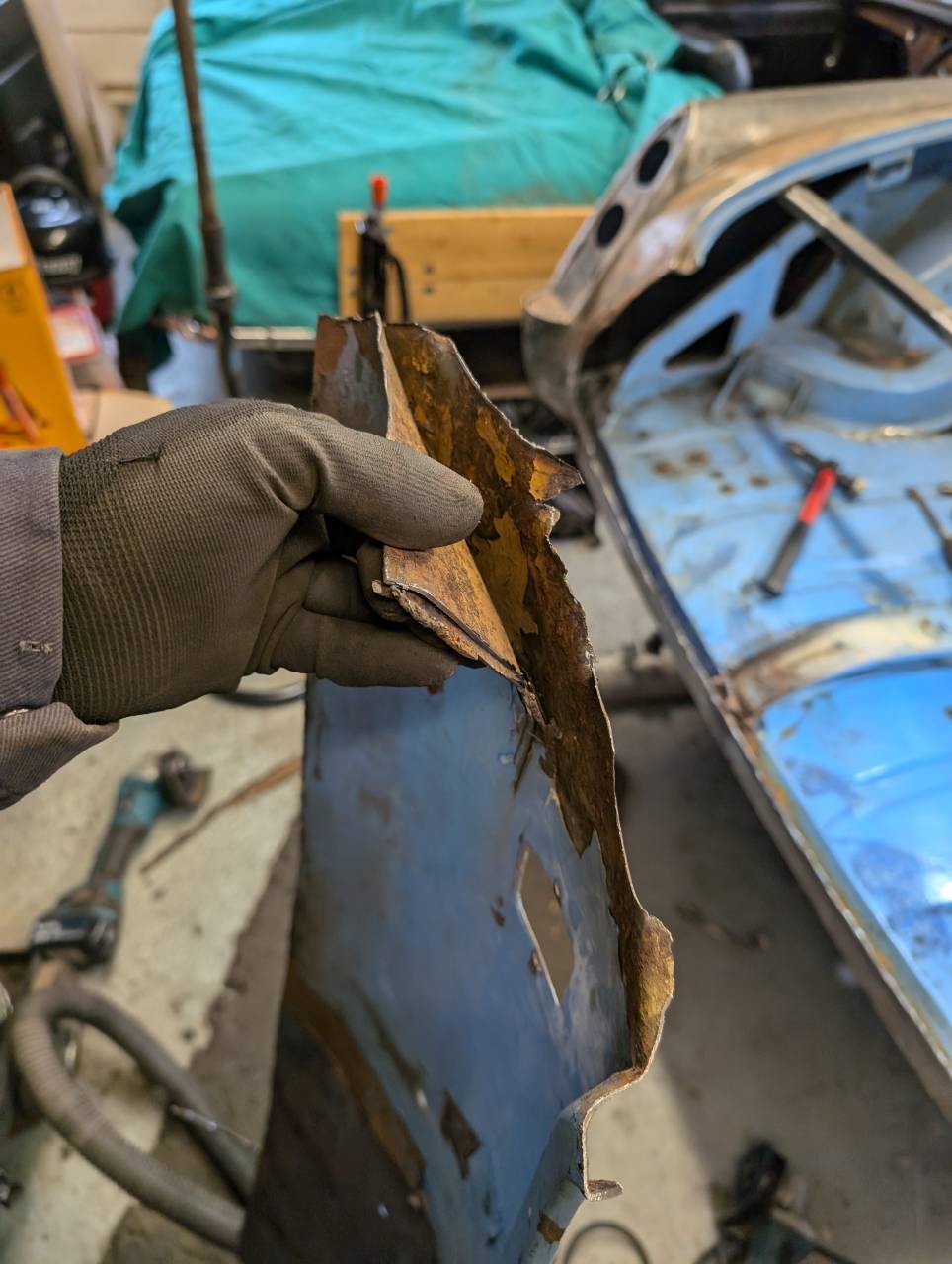

I'm running a bit short of metal so I'm reusing cut off old bits. This was the front footwell side panel. Nice thick metal and in the middle it's in good condition.
Cut out and fit into place.

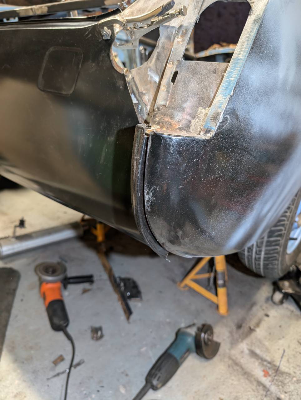

Lined the outer panel up again as this will be the next job (after that clean up above).
Fits okay but will need some work. Chiefly this sticks too far out at the front of the arch. Will be a bit of cutting and bending likely to get this right. Doesn't look much on camera but very noticeable in person.
Also there is a bigger gap at the front here. This is an interesting one as the other side did this too. Going around shows I would see the same on some cars.
Pretty sure all Steelcraft panels are like this and aren't bent quite far enough down at this edge. It's a good indication if you look at a Midget here if it's had the rear panel replaced with one of these repair sections. I don't think the full heritage panel does this.
Not a lot I can do without major surgery to the panel. On the otherside I did try twisting it to reduce it as much as possible. My metal working skills aren't good enough to risk bashing/cutting to adjust it. So I'll get it as best as possible but it could just be one of those things. I'll just blame BL build quality here and say it's normal...

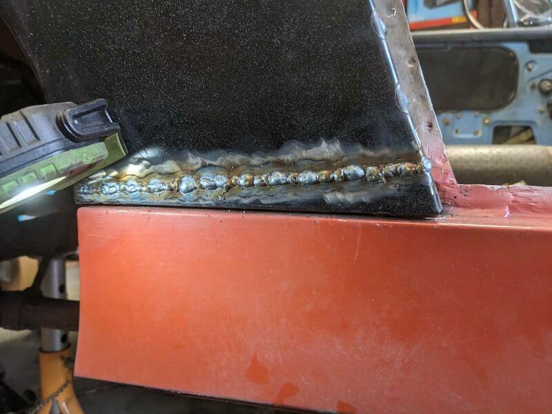

This episode is getting this rear panel attached. I lined it all up, ground back the paint on the edges and punched holes around the arch to plug weld.
Then painted the inside of the panel to cover any scratches from when I was moving it in place.
Day after the paint had dried and I lined it up ready
Tacked in place
However the two panels weren't quite flush. I didn't cut off enough between the two panels to quite get them lined up properly
Today I rectified this by running a thin cutting disc along and retacking.
Clamps helped keep the panels in place and aligned. I also used a ruler from a right angle to push against the panel to ensure as best as possible they'd stay flat to each other
Then cleaned up the welds
I now need to go along and fill all the gaps in with tacks. This is a very slow process as I need to zap the tack then blast with compressed air to stop the panel getting too hot.
Being thin metal, it'd be really easy to put too much heat through and warp the hell out of it. Slow and patience is whats needed - not something I can easily do when I'm in the flow.
This is where a less reputable restoration shop could easily cut corners here by stopping here and just slopping filler all over it. No one would know until it cracked or needed replacing again. But I'm not being paid by the hour on this and I want it done properly. So I'll be back to it in due course and finish it. Hopefully not in another few months (but I'd expect so tbh).
You can never have enough clamps when welding.
I probably went a bit too quick on the top. I get into a habit of doing short weld runs thinking it'll be okay. Its not badly warped but it's definitely not dead flat.

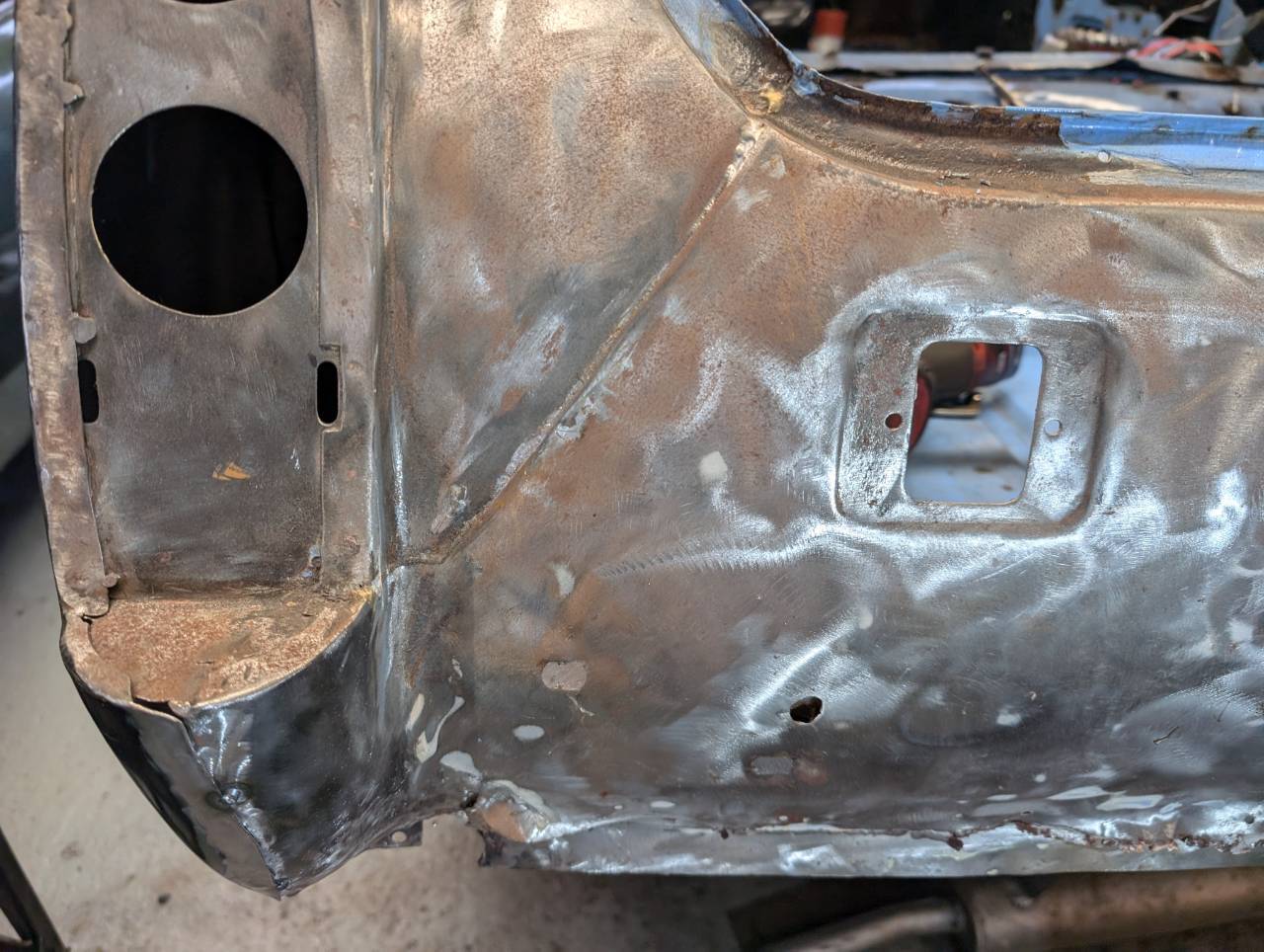

Had this hole to fill. This is the same on the other side where a previous restored made a hole. Not entirely sure why but the old patch of course wasn't welded properly.
Small piece cut to shape.
Weld and grind. Loads of grinding to get the bottom bit a nice curve. This is visible in the door jam so I wanted it looking tidy.
Then paint to protect.
That pretty much finishes this outer side now. Of course still will need filler and paint but that is a job in its own right.

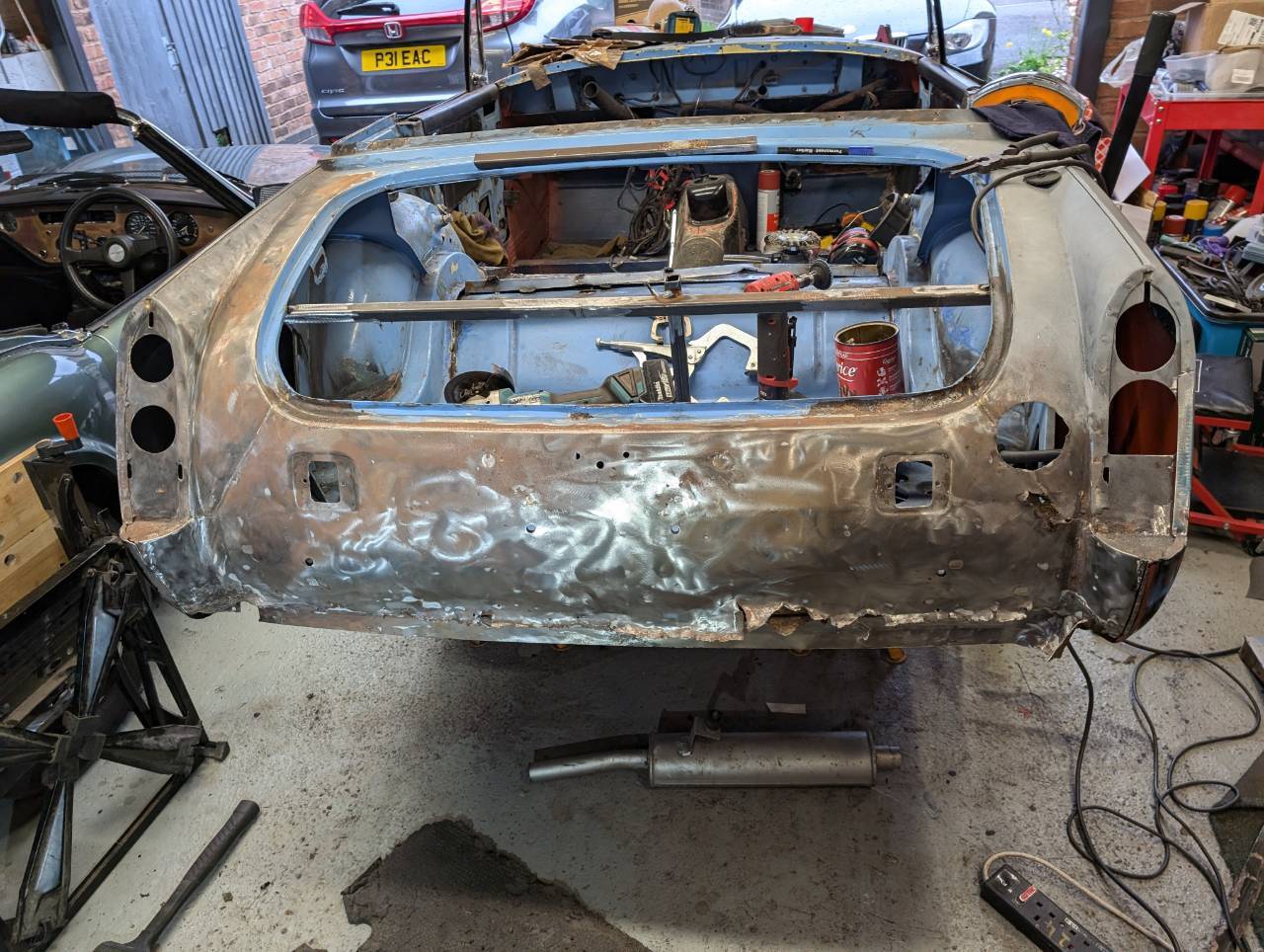

Next bits are welding the floor pans. Even though they have welds, I don't have a whole lot of confidence in them.
These welds need cleaning and redoing while I'm here
Here too.
Then the middle needs sorting. Especially the big gaps along the floor and side. Not sure exactly what I'm going to do. Probably fillets and weld. I really don't want to cut the floor off as that's opening myself to a whole world of pain and extra work.
Then this rear section needs doing.
I'll need to brace the top with some square bar. Also get the doors in to keep it rigid. It's double skinned where a replacement piece has been welded over the top of the original. There shouldn't be a flat section at the bottom either. My replacement panel (which I need to find!) should allow me to cut this whole back piece out from half of the fuel fillet hole downwards and replace it.
After that it's on the home straight. I'm going to plug weld the passenger side sill as I don't have a whole lot of confidence in those welds. I didn't replace that sill (I wish I had tbh) and the usual case of anything the last restorer touched, I'm doing again.
Likewise underneath I've found a few suspect welds on patches too. So need to weld underneath. Tbh I'm seriously considering taking the engine, gearbox and diff out. This will allow me to pretty much roll it on its side and give me far better access underneath. Also allows the engine bay to properly be stripped, cleaned and sorted ready for paint.

I've done some stuff! Actually this was a few weeks months ago and I hadn't bothered writing it up. This was in-between doing stuff on the Z4, 330i and I think E320 & Golf GTI. I did take some photos though.
First job was to unbury it. It's a useful dumping ground shelf for parts when fixing the moderns on the drive. But not very helpful when you want to work on it.
I started off by picking at some crap welds. Like most of the previous work on this car they just popped off. How this car hasn't fallen apart like a clown car I do not know.
I can't find the photos of the left side but this essentially was covering a big hole.
I plug welded this back on to make sure it was attached to the internal braces. Original this would have been spot welded on.
PXL_20240630_211703560.jpg.24fbfd6a81b9730d31838066a9e2ede1.jpgPXL_20240706_145531717.jpg.94a125c4b9d6d0510c07b2070cdd9baf.jpg
Right side was a covering a big area that didn't need patching. Once pulled off, I cut down to fit it better and leave the original factory on show.
Then welded up.
I also went round the interior and put beads on any iffy welds. Also pulled off patches and cut to a more appropriate size.
There still are a few bits of stuff to grind down and finish a few patches up. I'll get back to them soon.

Today I set upon the rear. The back panel was going to be chopped out.
Welded a simple brace in to stop it caving in. Didn't go crazy on the tack this time as I'll need to cut it off and clean up when finished.

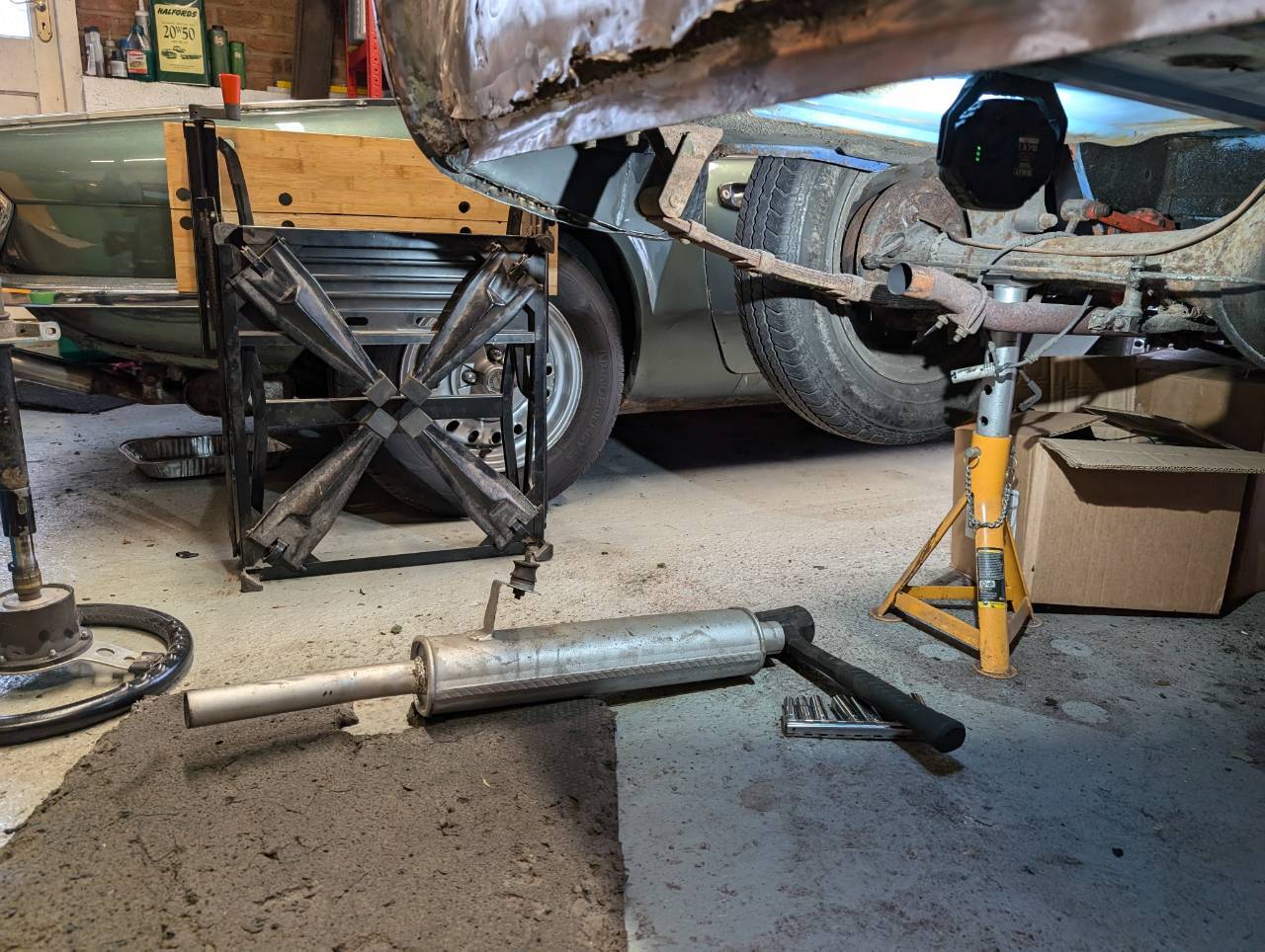

Removed the exhaust. This one irritates me as it points the wrong way. The temptation to put a cherry bomb as a replacement on here is strong.
Rear is basically looks to be a cut from another shell that has been badly grafted on. Does make a few handy clear cut lines though. Note the straight bit at the very bottom. This should be curved.
Chop chop chop
Final chop and clean up on the bottom half.
The removed metal is double skinned. Not because it's supposed to be, but because it's been bodged with an extra sheet steel piece.
