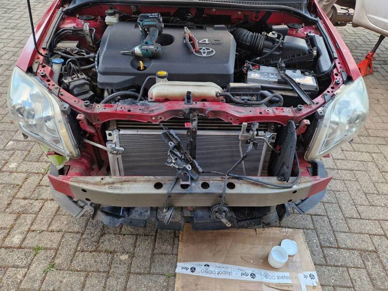

Instead I decided to tackle the Avensis air con condenser. Front bumper removal is quite straightforward, but like a dick I forgot to take note of the order in which all the bits are sandwiched together: bumper, spoiler, undertray are all held together but now I'm refitting it I can't fathom how it's supposed to hang together, and there are stupid S-shaped clips/nuts that are confusing the heck out of me.
I resorted to RTFM but it doesn't contain any detail for the undertrays and only a shit diagram for the bumper and spoiler.
I'm sure it doesn't matter that much and a liberal sprinkle of cable ties would probably solve matters.
First thing tomorrow I'll be phoning our tame mechanic Shaun to see if he can squeeze me in for an aircon regas m9 - his delightful assistant/daughter Annabel assured me this wouldn't be subject to the 3-week waiting list he's currently up against.

Ideally I'd get some bodywork whizz to weld the red one up, then a paint whizz to make it Old English Jizz or whatever my paint code is.
