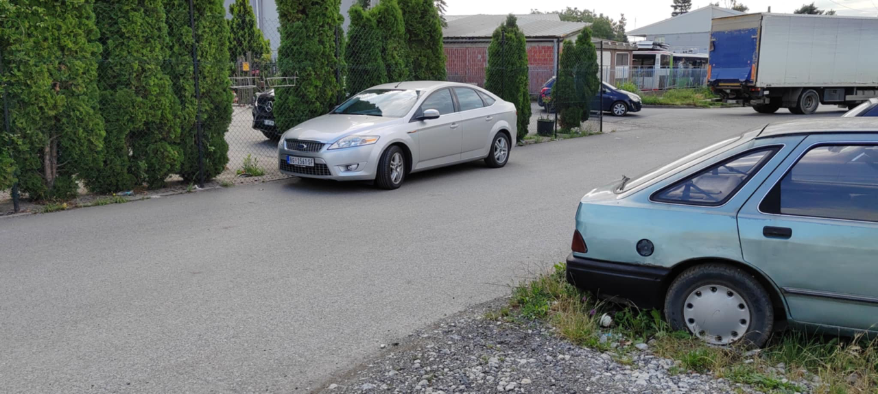

It is (assuming the same brake size as 1.8), but it looks like you're running BBurago wheels on a full-size car.
Sole photo of the friend's car on 16s I could find. It looks even more ridiculous in person. Hopelessly lost under the arches.

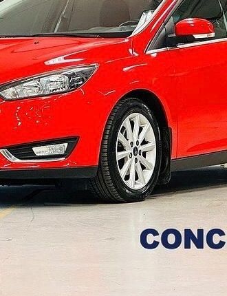

16 inch wheels fit, but I found out the hard way that at least this type of wheel (from Focus Mk3.5) means calliper interference.
I do also go for smaller wheels and more rubber if possible.
Problem is some people ask mad money for them if they’re high spec, well into Mk5 money. I’ve got almost those exact ones above fitted and they have no interference issues at all on the brakes. Upgrading the speakers to Titanium ones was a worthwhile job.

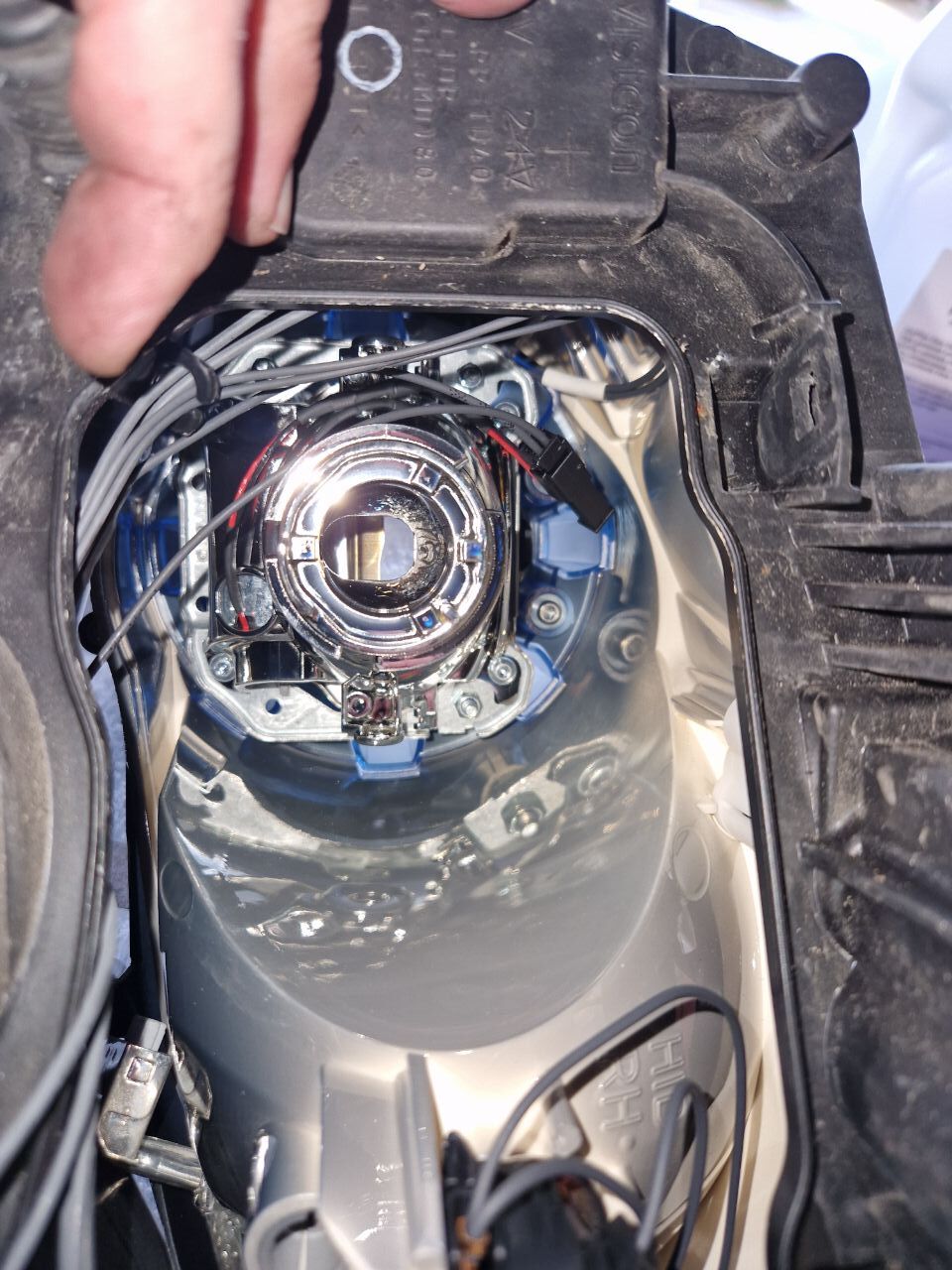

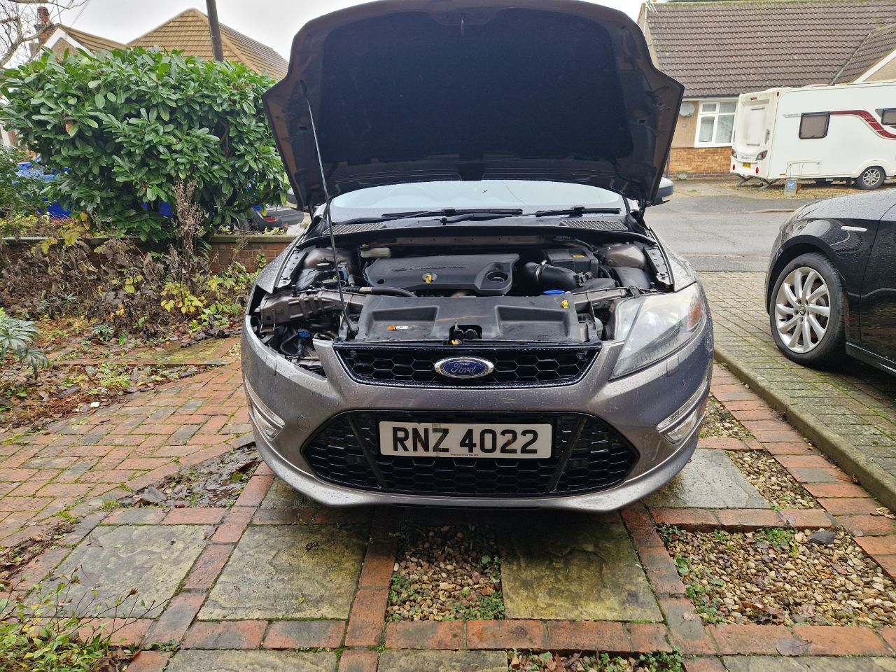

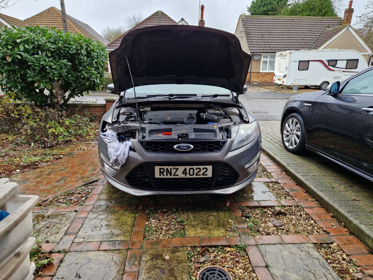

I lifted the bonnet for the first time since I bought it. Luckily, there was an engine present.
It was to change one of the the xenon burners. Dip beam feels a bit dim, and changing the bulbs worked well in my Saab 9-5.
According to @Con2K the more pressing problem is likely to be dust on the projector lens. It's possible to buy replacements but I've tried the council fix method which was blowing it out with an airline. We'll see if that's made any difference when I go to get Master Grogee this evening.
With the new bulb in, it's certainly yellower than the other side. I don't know if that's good or bad really.
I also did some fluid level topping up and tyre pressure checks to make myself feel like a competent* mechanic.
If headlamp output is still poor, id remove the projector dome to clean as only 4x bolts. If its not possible to get it out fully can prob get it turned 90deg so you can clean in situ. I done my clio and megane last year, made a massive difference to light output, the domes were covered in shite..
Inside the lens or outside it?
It looks like the projector bit might come out of that access hole, which would be good.

Honestly I don't think the lights have improved much so I'll take out the projector lenses and give them a clean (with alcohol maybe?).

Clean both inside and outside of the glass dome. Check out the shit on the outside, my headlamps went from hazy to sharp, difference was night and day. I had to do mine in situ as the domes were too big to fit through the hole.20250331_101530.jpg.7f8fa08268347e16ea7fcd7df8b8f8c3.jpg

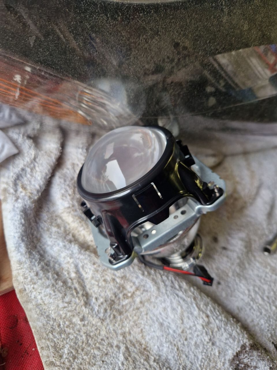

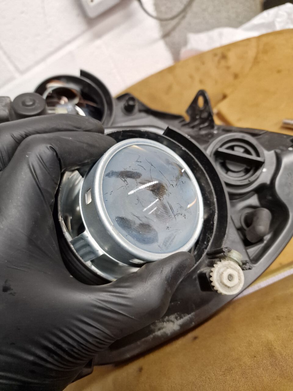

This time I removed the lenses for the xenons to clean them with a clean cloth and alcohol.
They came apart surprisingly easily and I was able to separate the lens from the bulb holder pretty easily.
In the main they seemed pretty clean. Once I'd given them a good going over, there was a yellowish residue left on the cloth, not sure if that's responsible for blocking the light. 20251222_105349.jpg.8203cf53d7432c56a85148b37518611e.jpg
I do worry it's actually the reflector at fault. Behind the bulb there is a black plastic reflector surface spray painted silver. The area directly above the bulb (where the heat goes) was cracked and a bit flaky. As soon as I tried starting to clean this bit, the paint came off on the cloth 😕
I'm not certain of the path the light takes through the lens, which is very curved. Possibly it's bounced off the top of the reflector then 'inverted' by the lens onto the road... Who knows really.

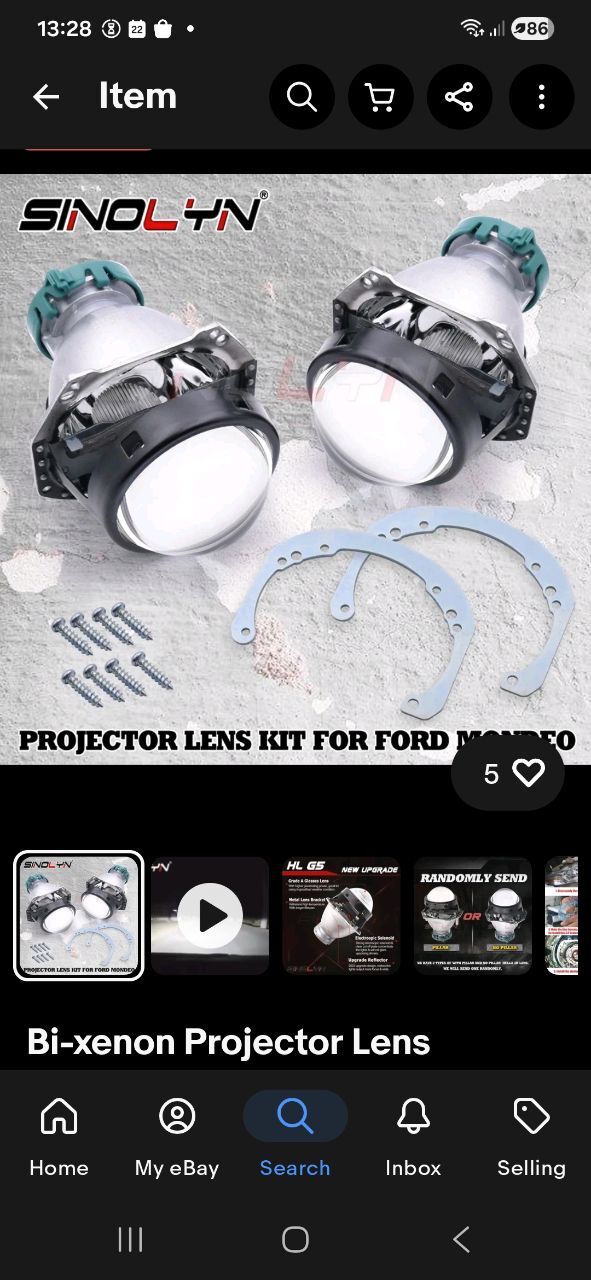

Anyway it's only 10 mins to remove the light so I can always come back and revisit with some silver spray paint if needed. If all else fails I've seen replacement lens assemblies on sale from Chy-nah. Screenshot_20251222_132844_eBay.jpg.c50dc8cda3ae54475bb4cf21f7248a68.jpg
