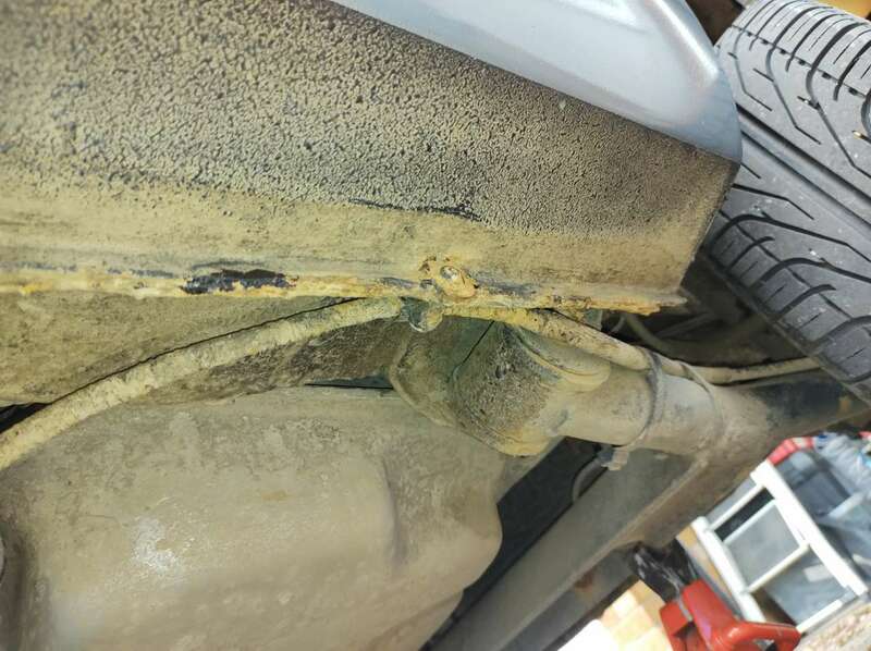

Got under the Puma today to inspect the underside after a winter of driving through puddles.
I need to wash it a bit better to find out what is mud and what is rust.
It's brutal though, I went under this last summer and absolutely blitzed anything that even looked like it wanted to rust. Underseal, paint, wax, all the good stuff.
Anyway it's been due a service for a couple of months (though only because of time, not mileage) so I dropped the oil and changed the filter. Also gave it a squirt of air con sanitizer stuff as it's been a bit musty.
Mrs Grogee needs to use it tomorrow so the rust proofing/treating will have to wait but at least I know what needs doing.
It got me thinking - most people don't do this, and then wonder why their cars rust. I don't remember there being much salt on the roads but I guess there must have been at some point. I mean, mine is a special case - old, rust-prone and a Ford. But it's amazing just how corrosive our environment is.

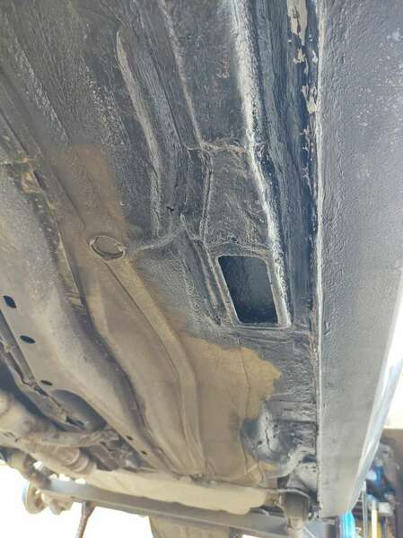

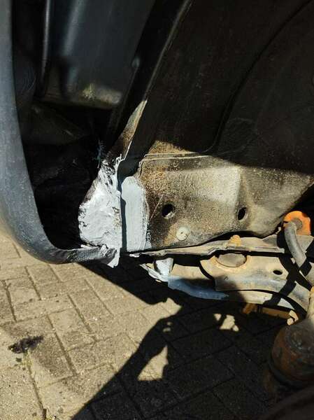

Nice day today, and the new house is approaching a semblance of order so I got the Puma on stands to deal with the rot.

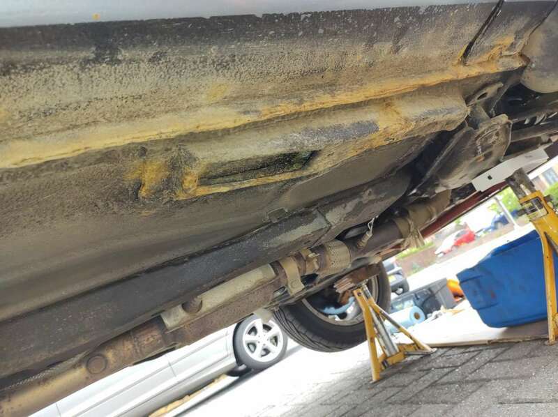

I decided that doing this properly would require removal of mudguards and wheel arch liners, so these came off once I remembered where all the fixings live.
Then having removed the liners I thought they needed a pressure wash. They're shit basically - made out of fibre rather than tough plastic. But being a nice day I knew they'd dry out after.
Once under the car I washed the worst of the shit out with a sponge and car wash stuff. Of course, being upside down, I got soaked and muddy, but I didn't want that silt sitting there.
Weirdly I found the driver's side wing had loads of sandy crud sat behind the liner, almost enough to make a brick. And hardly any on the passenger side, which is where I'd expect the worst of the road mud to sit?
Let that dry out over lunch, then attacked any suspicious looking bits with the angry wheel. I've now got an Aldi cordless grinder which is great, except the battery only lasts 20-30 mins, and doesn't recharge until it's cooled down. I need to find another battery so I've got a pair but they seem to be unavailable at the moment.
Unfortunately the wire wheel confirmed my worst fears and there are a few small holes in the floor which will need attention One Day. I think I'm safe from the MoT man though, as they're more than 30cm from seat belt mounts. I've decided the best course of action is to blob some underseal over it and fuggedabbowdit.
I've noticed the floor looking a bit crusty before but I've done my best to slow things down with regular attention. It's not because of the carpet - interior is nice and dry.
I'll need to find a skilled welder who is ok with box sections and stuff; this is quite a tricky section to weld up because of several different profiles meeting up.
Then a slop of rust juice followed by zinc primer.
To follow: black metal paint in some spots, gloopy underseal in others. Maybe even seam sealer, since I've got some in stores.

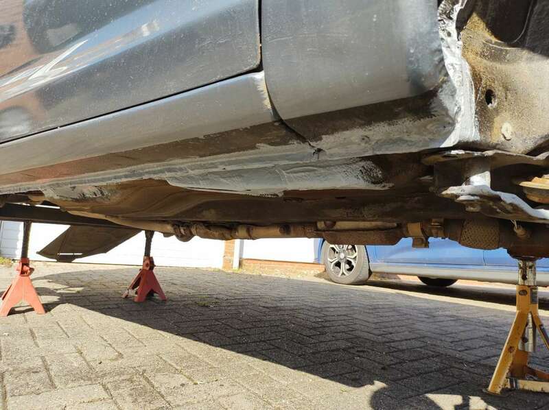

Luckily I'm not in need of the car for a while so it can stay on axle stands while I finish.
  • grogee changed the title to Grogee's spannering (Puma & MG Maestro). Puma Anti-Winterization
Ok I've slapped on some structural goo so I can forget about the rust for now. Currently in negotiations with Sister Grogee to put it in her garage over winter. It's damp, but still less bad than driving it around in the salt spray.

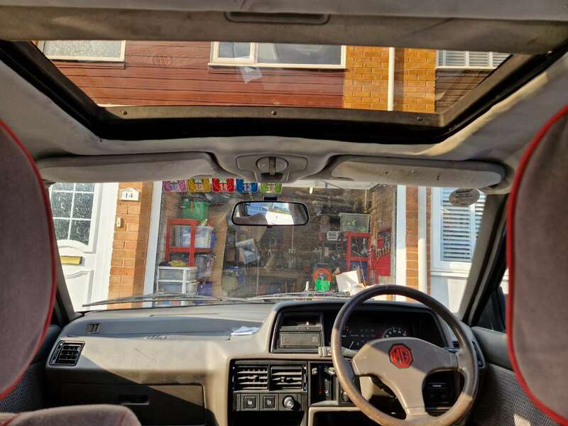

Then I tackled the sunroof... which turned into a major pain in the ass.

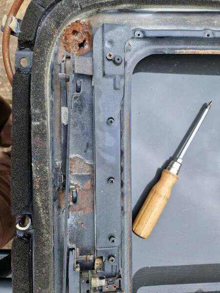

Firstly, discovered some rust in the frame that I hadn't treated before - so that was a series of treat, paint, dry, paint etc.
Then after all that, found one of the runners was cracked. Not surprised really, it's old plastic and lots of force required to move it forwards and backwards. When I discovered the break yesterday I had to walk away, having spent hours trying to get it ready to fit. Adding insult to injury,  the lube I'd sprayed on the runners leaked out over the new foam I'd fitted, causing it to unstick. Bah.
Anyway, today I took the original one apart in an attempt to understand the mech and see if it could be transposed to the 'good' frame.
Sadly not, because the way it's manufactured means the plastic runners are bonded onto the cables after they're passed through a very small gap in the frame.
I think I've succeeded in creating something that will hold the glass and keep water out, perhaps even tilt on a sunny day - but the slide back bit is too much strain on the broken runner.
I'll need a 2nd pair of hands to refit so hopefully @Cluffy is available soon.

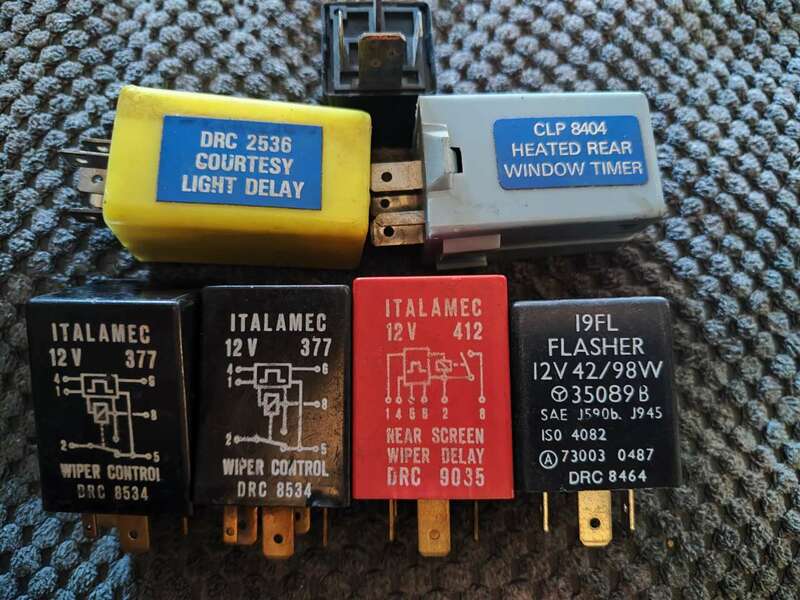

tailgate will have a motor that fires a rod into lock housing to stop button being able to push in
you can turn key to lock the boot out of c/l so it is locked on its own and button is not push-in-able
if you get hold of a montego haynes bol there are two wiring diagrams that enable constant on & iirc wipe with reverse for the rear wiper

iirc i set my wiper up to do constant wipe overide if rear was switched on
look what i just found
the smoll one at the top is a 70A ford relay
Cool! How much for the red and yellow ones mister
just seen the price of the red one on fleabay😲
what about £25 for both inc post?
Done. Send me a pm with your paypal
