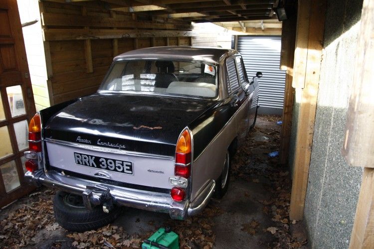

I finally got up to see my mate John in Birmingham this weekend. Proper shite spec Cambridge is occasionally daily driven - ie it gets time off now and again but is often used for commuting/other local journeys
Monza gets to do the long hauls.

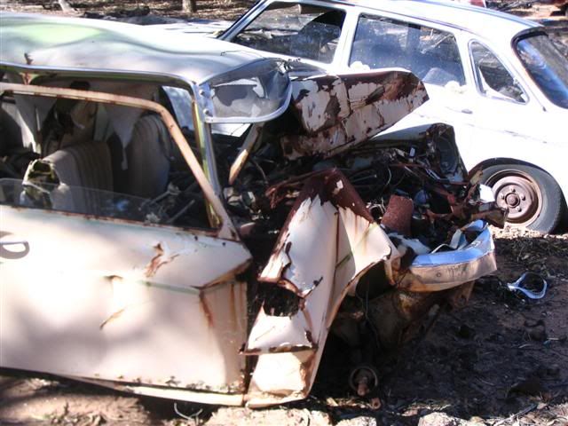

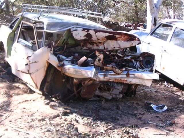

Wrong - they crumpled back to the bulkhead, and no further. The large hydralastic tube carrying the displacers across the bulkhead saw to that.
Here are some pictures of an Austin 1800 that collided with a lorry in Australia in the early 1980's. The whole axle assembly of the truck was knocked out with the force of the impact, but all three passengers of the Crab survived.
