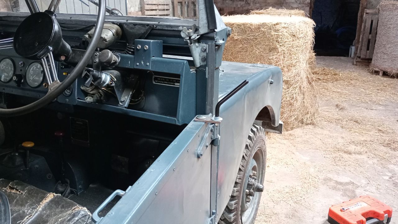

Heat / mud shields now fitted.

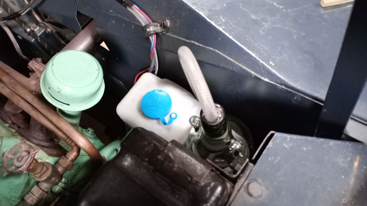

I decided to fit a coolant expansion bottle to the Land Rover.
It currently just dumps out the bottom when the coolant expands, but I found a nice 1L bottle that fits perfectly in the bracket from the old screenwash bottle.
I still need to get some hose of the right diameter to plumb it in, though.

Remember it will not suck the excess water back in as the cap on the radiator will seal once the pressure has dropped
Indeed.
I just didn't like the idea of it simply dumping coolant out, what a waste, and not exactly environmentally friendly.
Ok, it's not like the rest of a series Land Rover is eco-friendly either but...

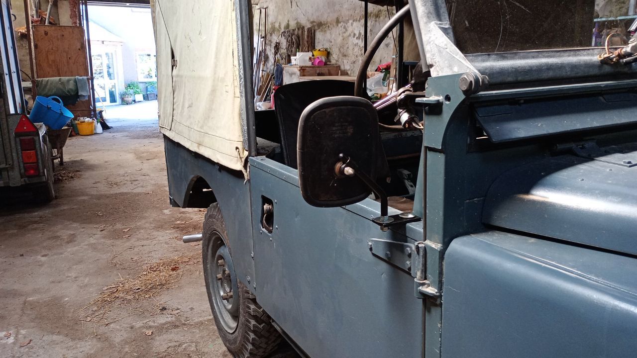

Let's turn a wing mirror into a door mirror.

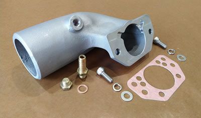

Could you fit an inlet elbow to the carb, to turn the inlet towards the front. Should help quite a bit.
I don't think yours is a HIF44, but something like this:
That definitely looks like the sort of thing that would do the job. I wonder where to get one from.

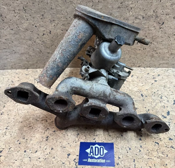

What is your carb, is it a HS2 or HS4?
If so there might be a BMC arrangement that works like this:
I believe it's an HS4.
I found this sort of elbow on eBay for £20.
I wonder if even that with a cone filter on it, pointing forwards, would quieten things down a bit.

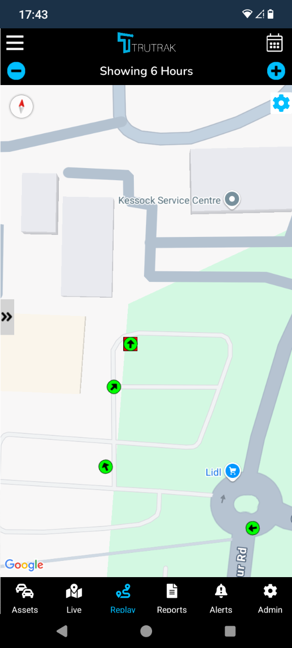

I fitted one of those Trutrak Pros to the Land Rover on Saturday.
I then took it to the vintage car show in Fraserburgh yesterday.
Here's the tracker showing me switching off the ignition in the exact parking space I parked in outside Lidl after the show.
Aye, that's pretty accurate!

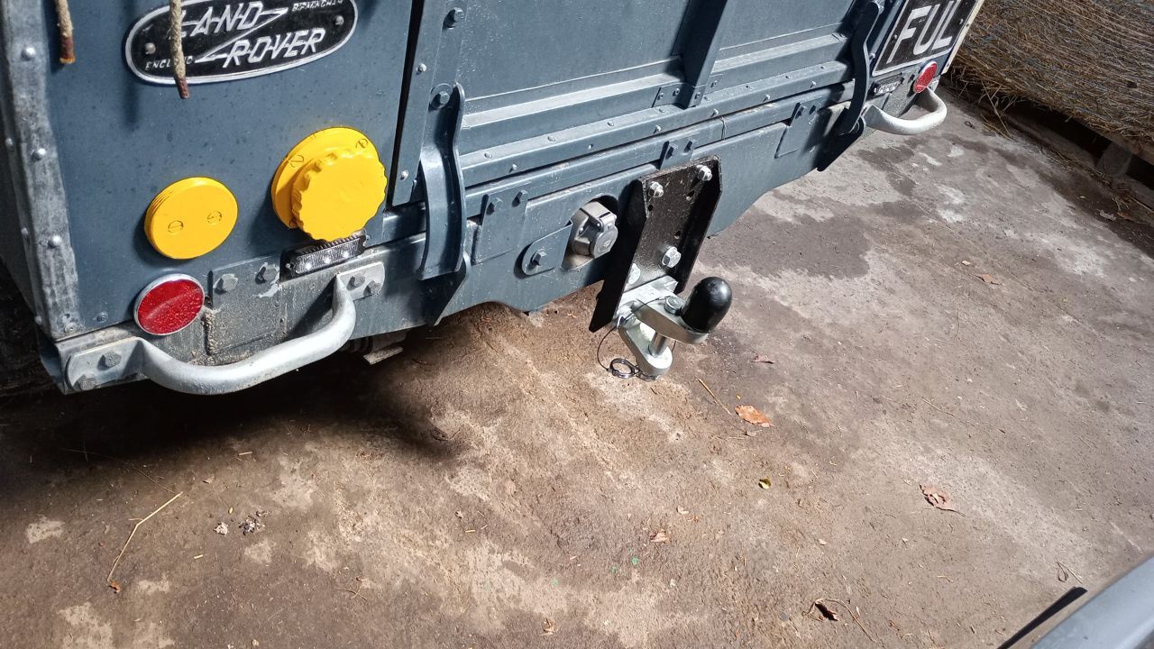

Rather than swapping between tow bars depending on which trailer I'm using, I installed this today.
The pin seems to rattle when in place so it may well get slung into the storage box under the passenger seat when not in use.
