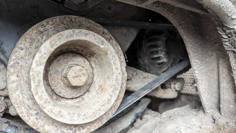

I forgot to buy an alternator belt but it definitely needs it.

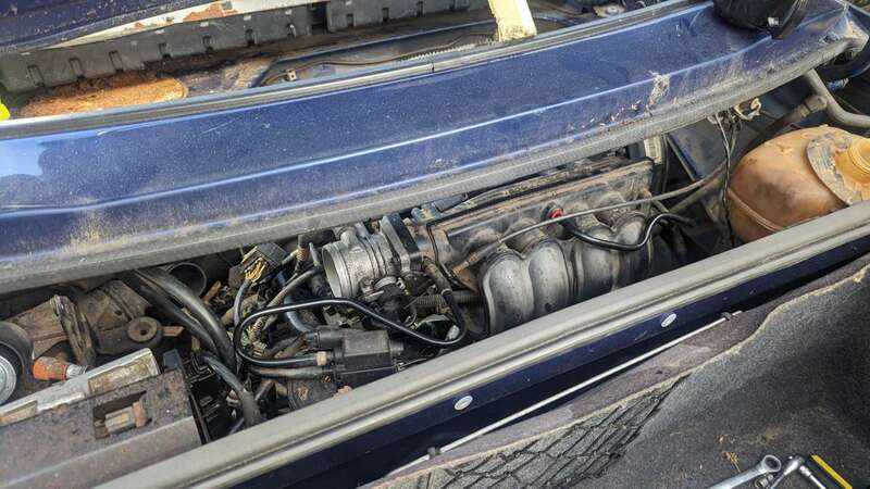

Next up was a modification to satisfy my boy racer side. Fitting a 52mm throttle body. Fairly common modification on the K series. Doesn't do much for the power but quickens up the throttle response. I also fitted a hot air intake because I'm a child.
Before.
After

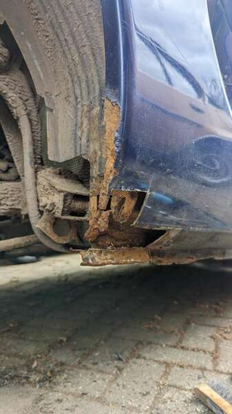

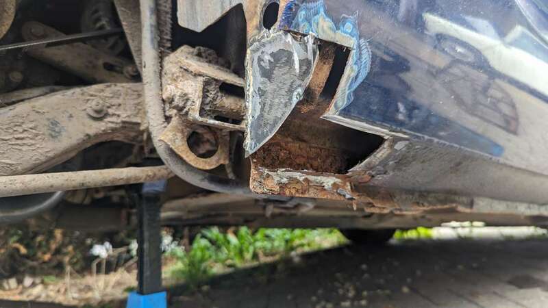

Lastly I tackled my nemesis. Rust. There isn't much of it but the corner of the sill needs rebuilding. I knew it needed some welding but there's a bit more work than I was anticipating.
Still needs a fair bit of work. I've got to weld those holes up. It needs new shock absorber bushes as they're gone on the driver's side. Brakes and pads all round.  I need to weld on a new exhaust hanger. I'll probably change the fuel filter too as the idle is a bit rough and it's not likely to have been changed in a long time seeing as the filter is still stamped Rover! Then I have to sort the horn and wipers which don't work. Then it should be MOT worthy!

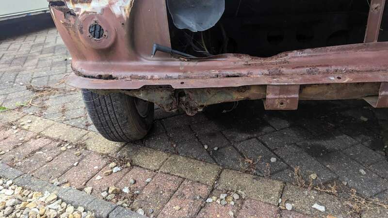

What's the only logical thing to do when you buy an unknown project that's been parked under a tree? Well if you're me it's to buy an unknown project that's been parked in an industrial estate...
It's a genuine 49k mileage 1979 Mini auto. With an engine that is definitely never going to run again. It needs welding but really not that much. A few weekends worth of welding in each corner. Everything above the sills is remarkably good considering it's age. However, it's 3579 shades of russet brown (the best BL colour ever!). It also comes with brown seats. Brown door cards. And I've sourced a brown carpet.
Did I mention brown?
  • Tommyboy12 changed the title to Tommy's A-series Misery - An brown car appears!

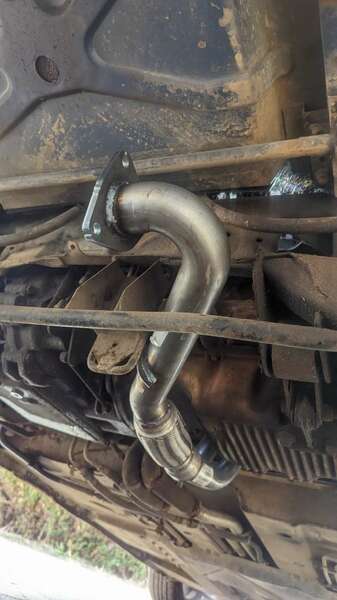

I started fitting a new exhaust

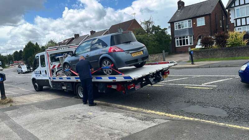

I've had a wet weekend of working on cars in the rain. First off I had a breakdown... Alternator shat it's guts. I've never smelt an alternator like it. No bearing failure but definitely on the verge of being on fire.
Thankfully I was kindly lent a noble steed by @sharley17194 to get me home as it took the RAC 18 hours to recover my Megane 73 miles...
I'm going to chuck the alternator replacement at my local garage. I don't have time or the inclination to do it.

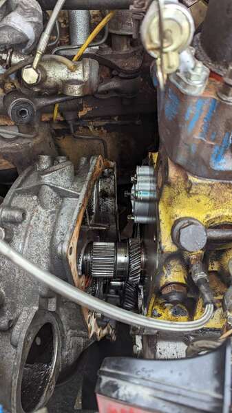

Once home I had to change the oil pump on my white Mini. Oil pressure was taking to long to build because the oil was draining back into the sump once sitting. Basically a bad sealing oil pump. I've caught it early thanks to a pressure gauge being fitted so I'm not worried about damage to the bearings. Not impossible to change with the engine in situ but a bit of a pain. Still not back together but nearly there.

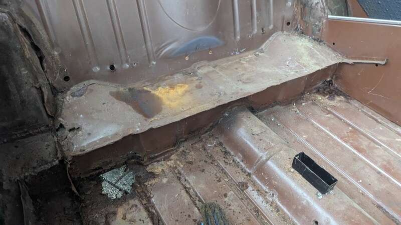

I also assessed the brown Mini (named Poonelope by my better half). It's ok. As I expected and not actually too bad. It needs a wing, front panel, both front floors, door steps, rear floor repairs, companion bin, and boot corner repairs. Some absolute neanderthal also cut out the rear seat bench which is a more painful panel to replace. Might seem a long list but nothing I haven't done before and fairly simple repairs.

Got some work done on the MG. Welded some holes up with the help of CAD.
Sill end first
Then the sill itself
Then fold over to make the roll in the end and seam seal
Then a coat of the finest direct to rust

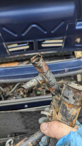

Secondly I sprang a leak in the cooling system. Water was dripping under the car when I returned home from the short drive. The temps didn't get hot but I'm not going to let a leak persist on a car with a marginal cooling system.
So began the inspection of the cooling system. I identified the culprit fairly quickly from the trail of water down the block. A crusty metal pipe with a pin hole.
Removing this pipe was a ball ache. It's bolted directly to the block under the inlet manifold with the engine look cable tied to it.
Finally got it free after what felt like an eternity. It's crusty and holey.
A stainless steel version is available which says it all but it's £160 and I don't want to pay that much so I've bought a £30 second hand steel one. This time the cars going back together with actual coolant in it. Water as a coolant is not enough!

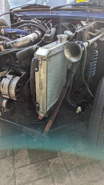

Finally I have been doing some work to further control the temps on my turbo Mini. I treated myself to a thicker alloy radiator and I've gone from a 13 row oil cooler to a 19 row oil cooler.
Before
During featuring some top notch brackets.
After
This definitely didn't help on the old radiator..
But the new one is a bigger, thicker capacity with more fins and supposedly a better tube layout.
The oil cooler has much more airflow now as less of it is blocked by the intercooler. Temps seem better although that's helped by the weather cooling off also. I'm planning to get some electric fans to help out with things too.
