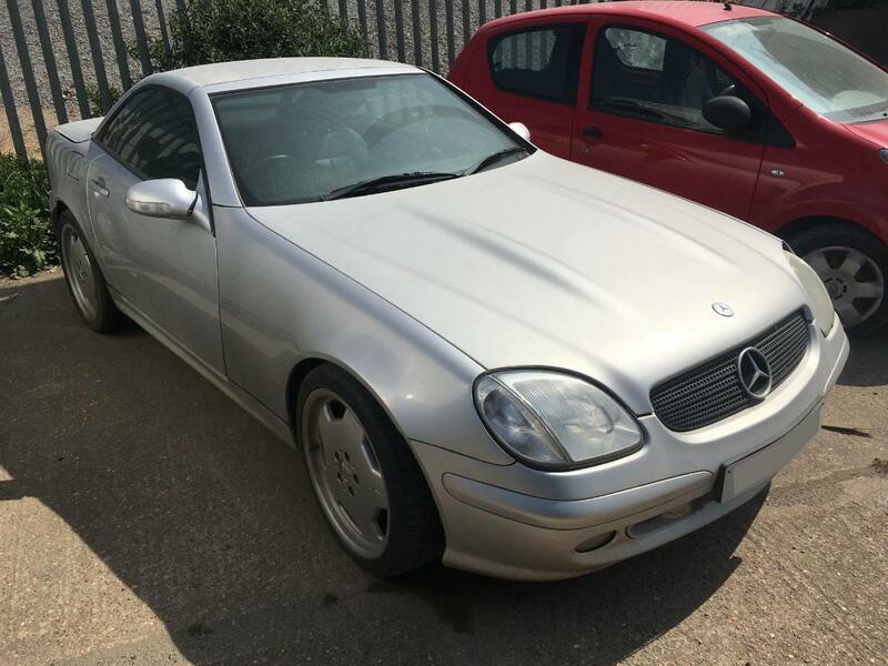

Back to the list of projects, another car that's easy to write about is the SLK320 the my brother and I picked up last year as a joint project - my brother is 6 years younger than me and just started spannering in the last couple of years, so I've duly taken him under my wing and I'm doing all I can to traumatise him with shite cars and the work involved with keeping them running.

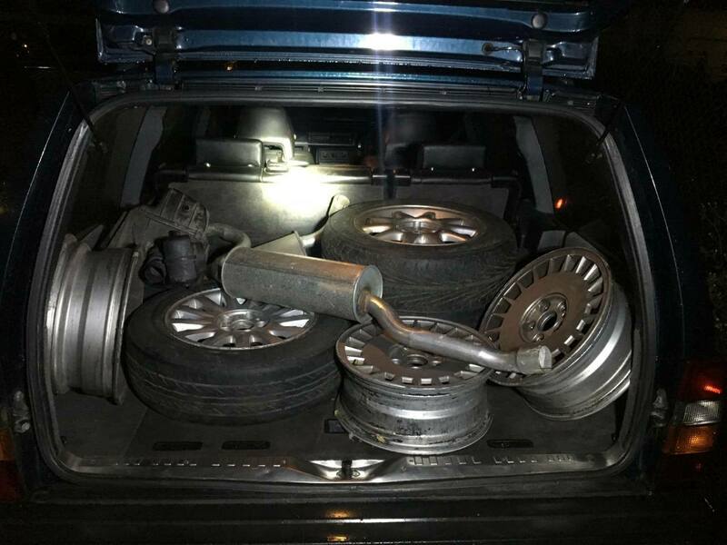

Whilst shopping for a gearbox at the merc breaker's run by a friend of a friend for my E430 (and eventually buying an AMG V8 lump as well), my eye was caught by this scruffy old thing. You'll notice the nearside arch is on the piss, this is because the control arm had snapped on the last owner whilst the car was being driven and is why it ended up at the yard.
The monoblocks were what caught me initially, and then the V6 engine drew me in further. I hadn't visited for a car though, so I left it behind and tried not to think of it. But like an inappropriate pass from your partner's friend at a party, whilst you can try your best not to think about it or act on it, an inevitable course of disaster has been set. A few weeks later I stopped in whilst passing and asked if I could have a poke around inside. The engine was knackered and the gearbox was done for, and those with sense probably would have walked away. They had an E320 in for breaking though, and reassuring myself that the monoblocks would offset most of my spend I asked about them sorting me out with a spare engine and gearbox if I took the car. We shook on £600 for the car as it stood, plus the engine and box out of the E Class.

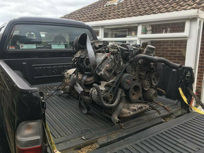

I got the car transported home, and nicked my Mum's pickup to grab the spare motor and gearbox. Random fact, I went with my Mum to view that truck with her, and when we arrived at the viewing it was Micheal Cooper (son of John Cooper) selling it as it was his truck that he used for gardening and didn't need it anymore 😅 I think it still only has about 45k miles on the clock, and my Mum has been running it for a few years now!

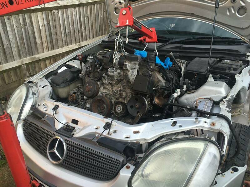

We didn't waste much time pulling the old motor out, here she is mid surgery. Not many photos taken I'm afraid, the original plan was to rattle through the work and use the car as it still had MOT...
Then things got a bit mad on the Covid front, and my brother being a manager for a food delivery company suddenly found himself with little time spare. I didn't want to have the fun/pain to myself and him to miss out, so it sat neglected on  my driveway for some time.  We did do some fettling to the engine on the odd occasion, as the E Class has the starter on the wrong side so we had to cut a hole for it to got the correct side, and had the starter flange machined down a bit to provide the right engagement (Inevitable pain in my arse later).  I seem to recall I had to swap the inlet plenum too, and a few other bits. The manifolds were different too, due to the space restrictions in the SLK engine bay, but again they were easy to swap.
On my week off work we spent 3 days fighting the new engine back in. I can't say I'd like to do it again, the engine bay is crazy tight and long and the engine and gearbox combined is probably on the limit for my cheapo chinesium crane at full extension. We got there though with the supervision of a responsible being
It's looking a bit more together in there now. We still need to repair the wing as it was badly damaged when the control arm snapped but a replacement is about £250!! New front arms are on the cards also. We have also swapped on some cheaper alloys for now as we will possibly sell the monoblocks.
One small problem is that I didn't get enough machined off the starter 😅 So I will sadly have to try and get that removed at some point. I feel like this car may get left to sit for a little bit as I'm really not looking forward to that job!!!

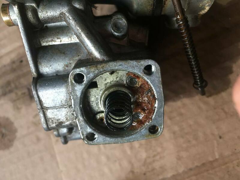

Time to check the diaphragm
Should probably replace it, will do at some time - there's always time to do it right the second time. More jelly hiding behind the diaphragm

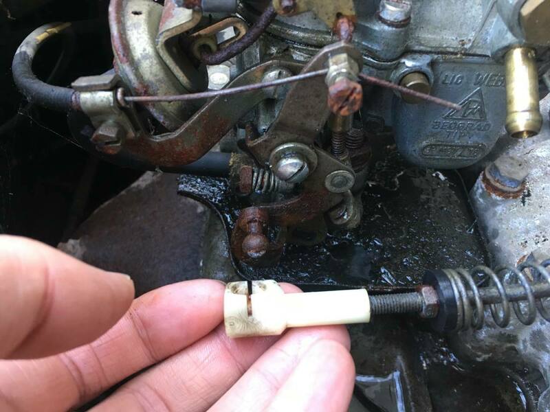

Cleaned it all out, briefly lost the spring, found the spring and reassembled.
Adjustments next. The choke was fine (from memory), but this arm wasn't right
It needed a bit of help to get the full range of movement it should have. Luckily I found a carburettor rawl plug.
Don't worry, I cut the tabs down later 😉 I did try straightening the arm (it looks bent) but that didn't really help. I suspect I'll need to revisit this at some point, but for the sake of getting it running short term I'll live with it.
Good enough for me...

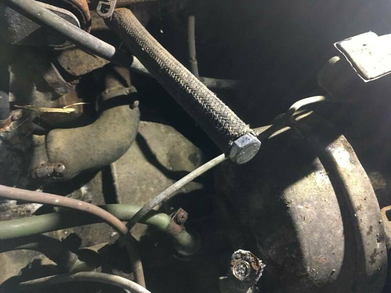

The banjo union at the brake booster had snapped. I reckon some air might have been getting in through there 😅 Luckily I had a part in stock
I ordered a new length of hose, a non return valve and a new banjo bolt and fitting. This would do for now though.
Much better 😅
At least she idles now and doesn't run away/stall under throttle. We will deal with the noxious fumes later.

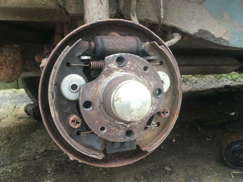

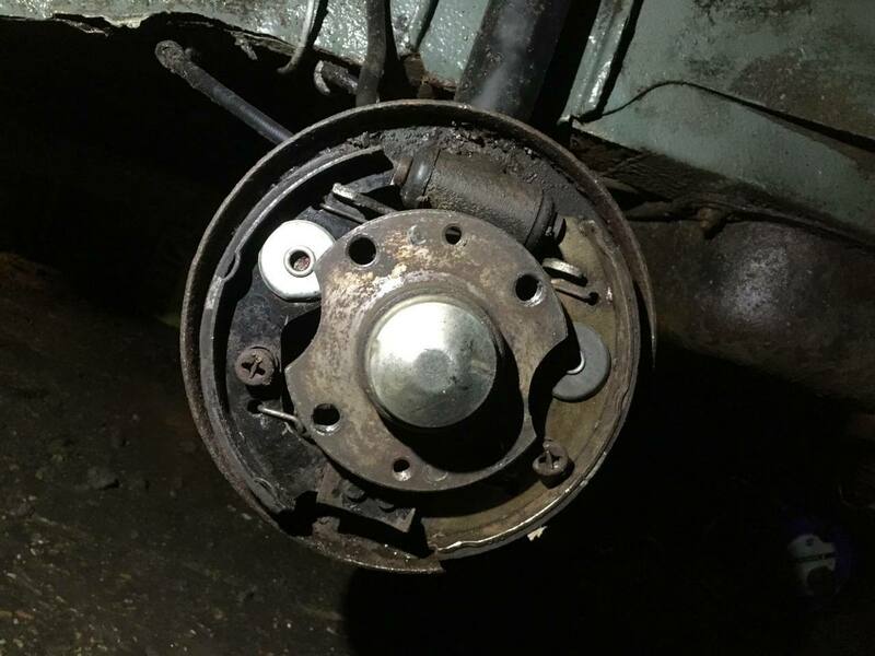

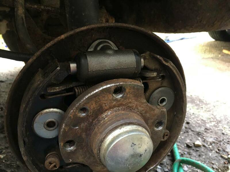

So when I bought it, the brakes were all in the boot. Rear shoes, springs, refurbed front calipers, carriers, pads, hoses and clips. So I set about figuring out what went where and fitting it.
Whoever mothballed it had cable tied down the rear brake cylinders to help with reassembly. As you can imagine, they did not slide back out afterwards 😅 I didn't have replacements so started putting it together anyway as I'm impatient, but I did splash out £10 for a pair of replacements.
One side done... note the gap between the shoes and the pistons!
And the other side done in the dark for balance
The springs were utter bastards, and as punishment for my impatience I had to tackle them twice. The locking washers on the shoe retaining pins and springs were not fun either, they were a little bit flexible and I had to give them some delicate fettling with a hammer and drift in order to stop them pinging off repeatedly. Got it sorted and the new cylinders on though so all good.

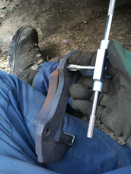

With that we were on to the fronts. The threads on the carriers weren't looking too clever from where they'd been exposed to the atmosphere whilst removed, so they got a bit of love from the thread tap. I don't know why, but I find chasing threads very cathartic 😅
Good as new lol

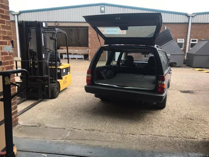

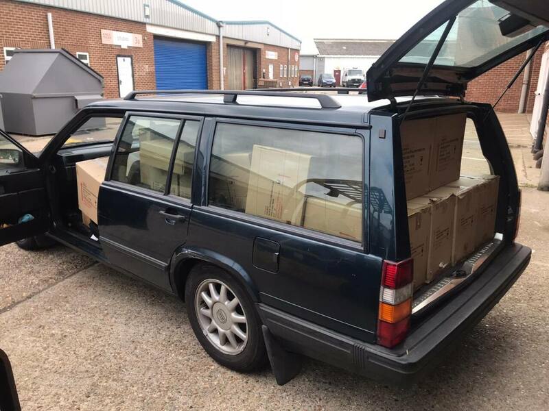

So i had a couple of weeks off work to play with projects and in between the heavy rain I was having a serious case of everything I touched turning to shit. In the usual fashion I’ve shelved the things that are annoying me and sought a distraction... I’ve just bought this locally:
forgot to take photos whilst I was there so a low res pic from the ad will have to do... non turbo but manual box. Will get some more photos up once I drag it to the tool shed and have a poke around. It’s rough outside, but it’s probably going on to daily driver/tool & parts lugger duty quite quickly provided I sort out the small quirks it has.

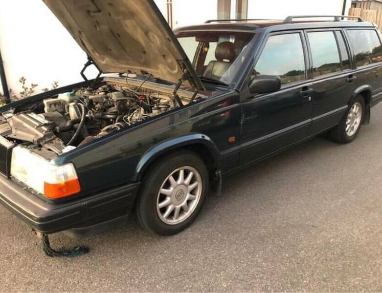

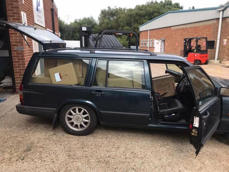

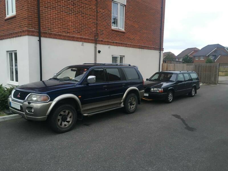

I picked up the Volvo after work this eve - I bought it with a no start fault, but it has an MOT, I've taxed it and insured it so I decided to drag it back with the mitsushitty and a stunt frame. Here she is attached and ready for action:
I do love the Mitsi, that Volvo isn't light by any measure and I was driving through undulating roads on the Sussex Downs; It pulled it up hills without missing a beat, we came back down hills and she braked like there was nothing on the back, and going round corners she was completely stable even though there was ridiculous changes in camber on most of the bends (if anyone is local, the twistiest part of the journey was through Ditchling and along the Plumpton Green road). It seems to tolerate a lot of hard work and all it ever wants for is basic servicing and an endless supply of cheap Chinese ball joints...
Once I got back it was too dark for any useful photos, but here's a pic of the shit in the boot
My mate was with me, and we checked the fuel pump relay which seems to work fine, cracked the fuel line and turned the ignition on and fuel pissed out as you would expect (tomorrow I will do it scientifically with my pressure gauge). We found that 2 ignition leads were completely snapped, I doubt they were the original cause though I suspect they were just the victims of heavy handedness by the previous owner... He says he checked for a spark, I can only assume he did this by chewing though the ends of them judging by the state they are in 😅 I'll try and get replacements tomorrow, and I'll check that the timing belt hasn't jumped any teeth as I get the impression this thing has been ragged hard for the few months the lad had it.
If we're lucky I might get some pics after work tomorrow so that we can all enjoy the beaten glory of this ancient brick.

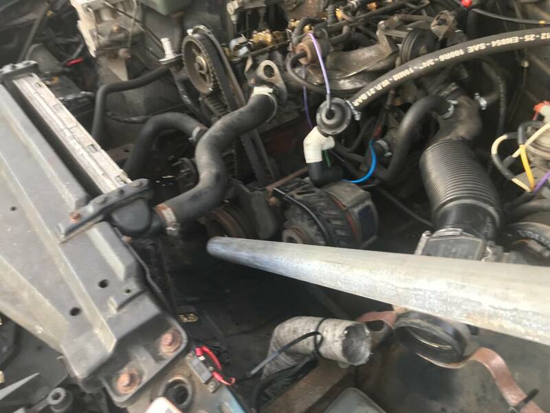

I spent some time with the Volvo yesterday afternoon.
I’ve temporarily repaired the damaged ignition leads, and checked for a spark at all 4 plugs. There’s a spark so I’m happy that it isn’t a fault with the crank sensor and also that the ignition equipment must be in some sort of functioning order, at least healthy enough to start the engine.

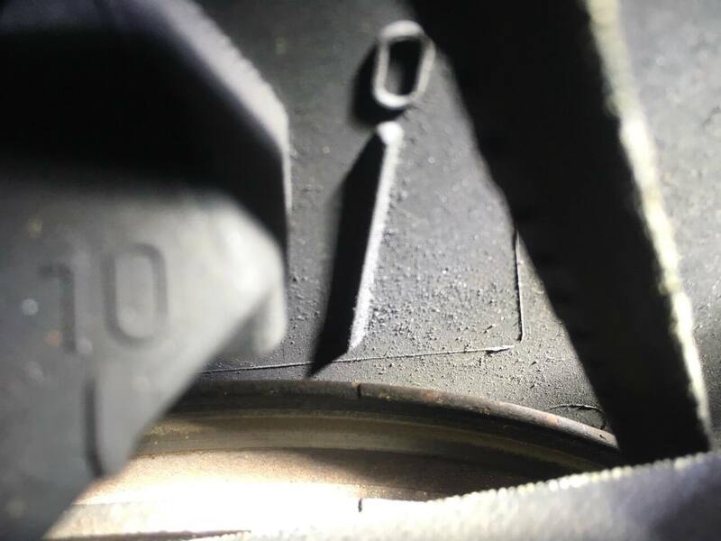

I had my timing gun on me, and I checked the ignition timing on cylinder 1 - the plug fires at 10 degrees before tdc which seems right to me.

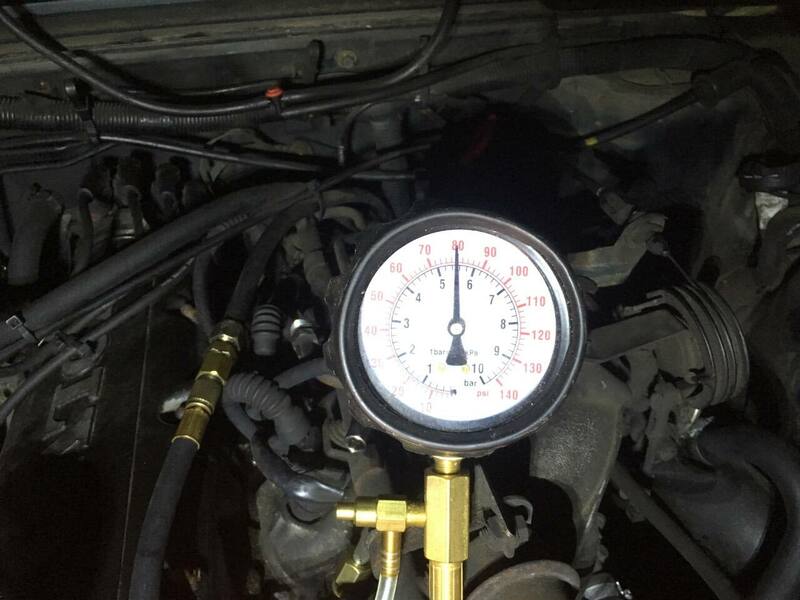

Fuel pressure then. I was fairly sure this was ok as the plugs were wet with fuel when I pulled them, and my gauge confirmed I’m getting 80psi from the pump so I reckon we are ok there.
Whilst getting my mate to crank the car I noticed you could smell fuel at the engine bay but not at the exhaust. Using a highly calibrated piece of plastic bag, it would appear that air is being sucked in the exhaust and pumped out the inlet...

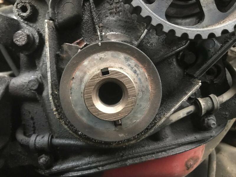

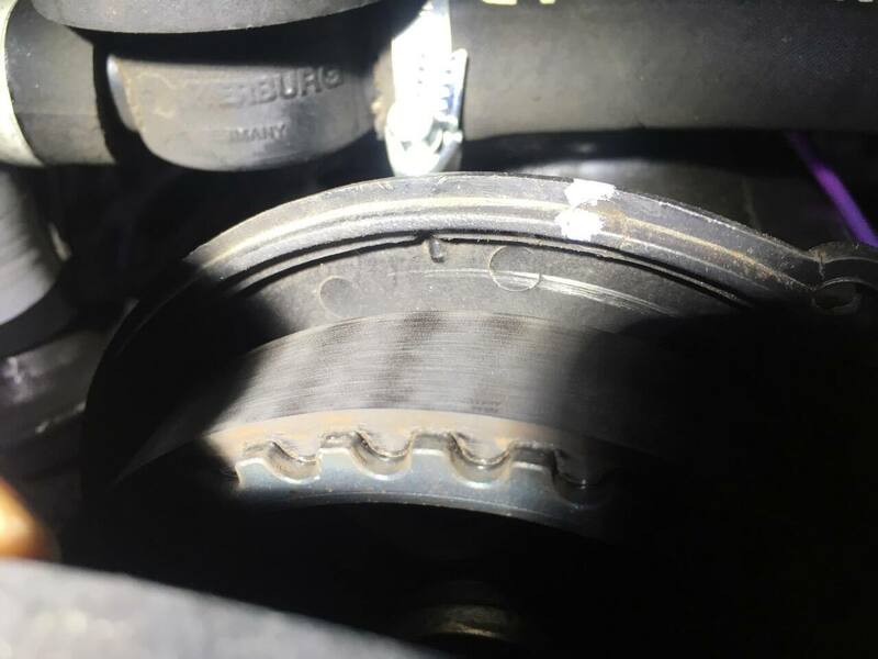

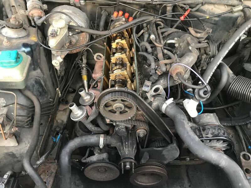

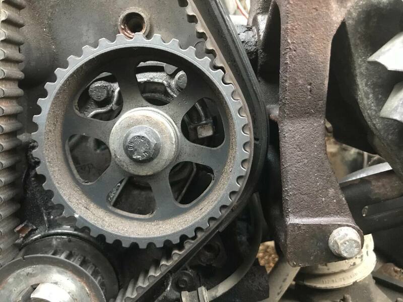

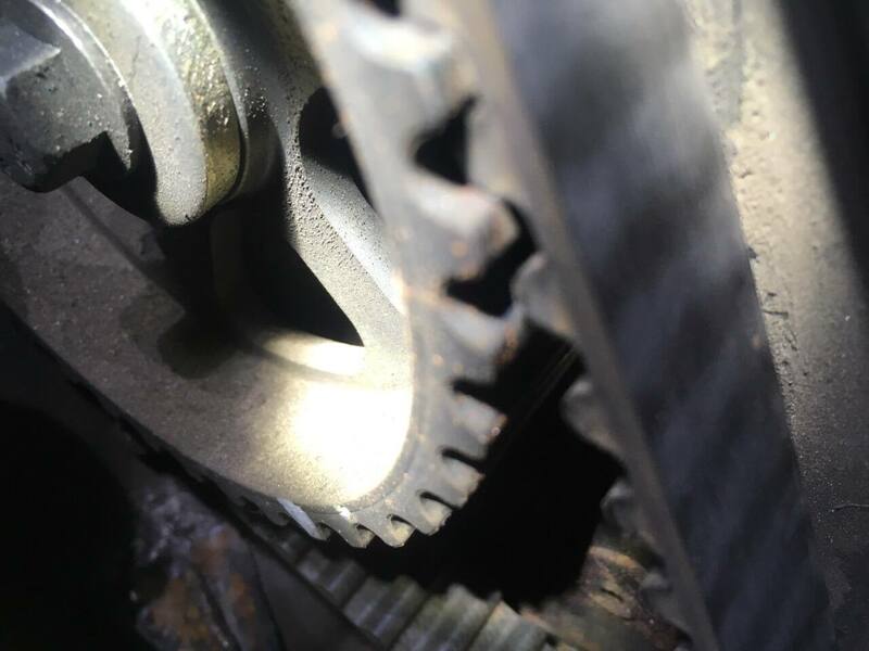

Engine timing inspection time then... I didn’t have time to pull the timing covers off properly, but the crank pulley has markings on it and I could get the top cover back far enough to view the cam.
Yeah, that doesn’t look right. I couldn’t see the intermediate shaft, but I’m assuming it’s timed up and this is where the ignition timing is taken from giving me a spark at the right time, and that my cam being out is screwing up the valve timing and causing weird shit to happen. The cam gear has a woodruff key from what I’ve seen online so I don’t think it’s just that the gear isn’t aligned.
I'm hoping to pull it apart this evening and get it back together, fingers crossed this sorts her out.

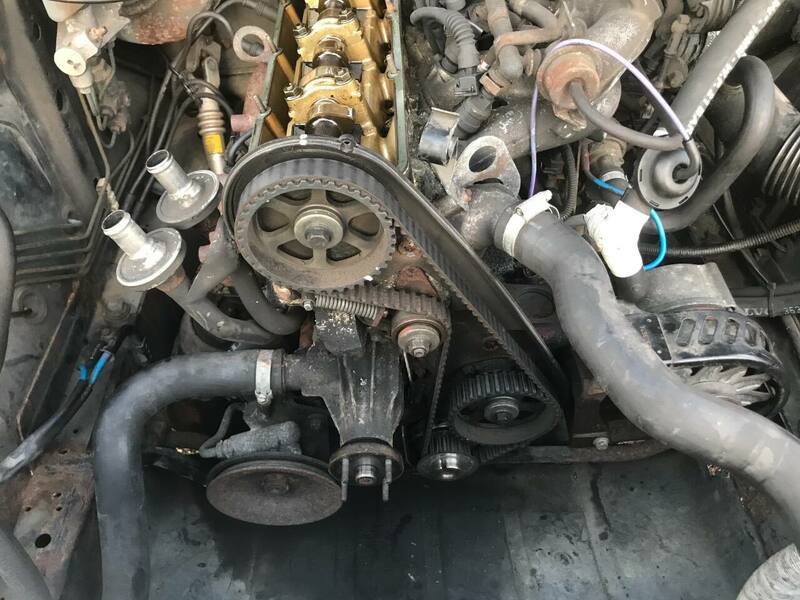

So I managed to get some time in on the Volvo this evening.

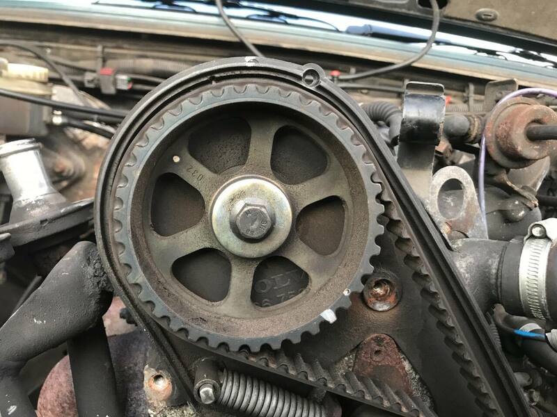

The mission for today was to get into the timing belt and check what shenanigans have occurred in there under previous ownership. The glorious thing about the Volvo being that it has a longitudinal engine in a huge engine bay - it was a piece of piss to remove the fan, shroud, belts and covers. There’s no plastic dress up wankery in there to fight through, or notions of space efficiency trying to cram lots in a small area 😅
And we’re in;
Crank bolt next - forgot my impact gun so I had to use the pikey impact gun...

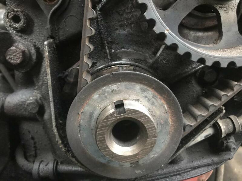

A length of tube and the starter motor, never fails to break something 😅 this time it broke the tension on the crank bolt as planned.
And the cam timing was out, but I was also surprised to find the intermediate pulley out too.
A little bit of tweaking and it looked a bit better.
I put the belt back on, turned it over by hand a couple of times and it all seemed right. Fired it up and the belt walked off some 😅 went back, corrected the belt, straightened the tensioner pulley and put the lower cover and crank pulley on. Second start and she ran fine. Happy days!
Took it for a test drive, it ran as alright as could be hoped for, warmed up to temp and sat there happily. Once warm it did start missing, so I took it back down the tool shed. On inspection, my temporarily repaired ignition leads came apart in my hand so that answers the question of ‘how good a crimp can you make with a tack hammer’...
I've got some new ignition lead at home, so I’ve taken them back to chop up and see if I can’t make something better on the workbench.
But the main takeaway is, it actually works!!!

So as I have probably mentioned previously, my partner is Slovakian. Due to the pandemic she hasn't been able to travel home to see her mother for some time - the last time they were together was October 2019, back in those halcyon days before the world did a shit.
Cue yesterday then, which was the scheduled arrival of mother in law for a visit to us in our 'new' house. Normally we fly between Gatwick and Vienna and vice-versa for convenience when travelling to and from Slovakia, as Vienna is about an hour from Bratislava and flights from Bratislava didn't land in Gatwick which is our 'local' airport. Seeing as crossing from Slovakia to Austria before flying to England would be a bastard in terms of filling out locator forms for mother in law and her partner, we opted to go a different route this time and fly them in direct from Bratislava to Stansted, which was the nearest airport with regular flights from Bratislava currently.
This posed an interesting situation: out of the cars we had running, which vehicle was best suited for driving myself, my partner and our Labrador to an airport 2-3 hours away before collecting mother in law and her partner plus luggage.
The contenders then:
  • The Renault Clio - probably the safest option, it's a 2007 so practically futuristic by my standards and it's economical and so far has proven reliable since I fitted the 'new' engine. However, it is abysmal on the motorway, sitting at just shy of 4000rpm at 70mph in 5th gear. It's also tiny inside, judging by the size of it the boot is presumably for carrying your lunchbox or something, not 3 bags and a dog. I really did not want to take this car, despite it being the cheapest and potentially the most reliable, as 3 hours of sitting at 4k rpm would probably result in me just driving the car into a bridge pillar at 70mph just to get some peace and quiet.
  • The Mitsubishi Shogun Sport - 3 litre V6, auto box with leaky transmission line that I still haven't fixed (I'll do it at some point! just not right now 😅), 20mpg and all terrain tyres for a nice bit of noise at motorway speed. I know just how pleasant she is to drive for long periods of time at high speed, as she was a last minute stand in when we drove to Zurich a couple of years back... Lots of space for family, luggage and dog... Would probably be hammering the last few nails in the coffin of the automagic box by doing that trip though, and there'd be no petrol left in the South East by the time I'd done that journey. That's a no then.
  • The Honda Insight - Yeah, a 2 seater with no useable boot... turn up to the airport, wave at family, drive home. Spend about £1.37 in petrol overall, but achieve fuck all of use. Nope, nope, nope.
  • The Skoda Favorit - Well, at least it would remind them of home. And I've no doubt it would do the miles, it's been very reliable of late. It's spacious enough inside, and not bad on fuel. However, it is by no means comfortable at 70-80mph (at 80 you feel like you are breaking up on re-entry) and it is gutless, which is no fun going uphill on a motorway. Plus my partner flatly refused to be seen in a 'villager' car by her family 😅
  • The Volvo 940 - Bought from a chap who apparently cocked up the engine then wasn't quite honest about it. Fixed on a Friday night whilst having a burger with a mate, and half heartedly test driven on Saturday for a bit round Beachy Head, Polegate and Hailsham. Otherwise unproven in terms of reliability, and if it should fail then I would most certainly be banished for being an idiot and constantly trying to run ancient cars that I buy broken and dick around with in the hopes of having something useable. Mother in law and her partner would be stranded, and we would probably spend a small fortune getting a private hire car to run them down to us. On the plus side, it's pleasant to drive at motorway speed (it had been tested for all of 4 minutes on the A22 on Saturday after all), and it's like a small house inside.
Volvo it is then 😅 I chucked a good selection of my tools in the boot 'just in case', and we set off.
I'm pleased to report, that after a nearly 7 hour round trip due to multiple road closures, we all arrived home safely at just before 4am. Not a single problem with the Volvo, she performed admirably and is now at work with me sat proudly in the carpark in place of the Insight who previously held the top spot as daily driver.
I have to say, I am somewhat pleased with this one - I wish I hadn't waited so long to buy an ancient Volvo 😁

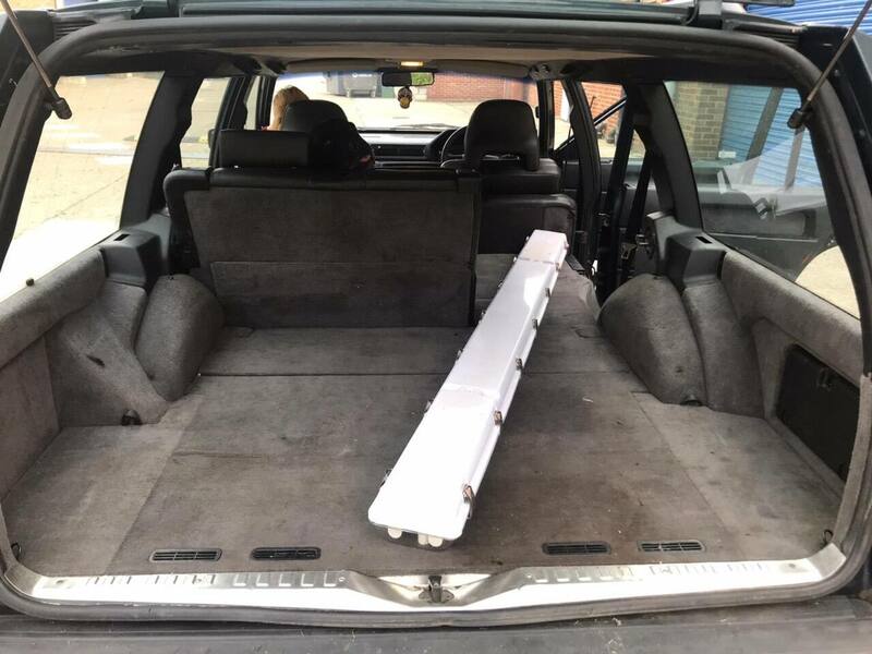

It came in handy today at work, we had a job that ran over and we had 34 cartons to ship to a local client today. We thought we were going to have to take mine and another manager’s estate car when we saw the size of the pallet of goods. We were wrong.
At the distribution depot it drew a crowd as we unloaded it and built up a decent sized pallet. Despite having seen it before I loaded it in, I was still impressed once the pallet was built back up again. You honestly wouldn’t have thought it would’ve gone in.
Light duties for the drive home...
6 foot lighting unit for the garage reclaimed from another unit, no trouble at all for the Volvo.
