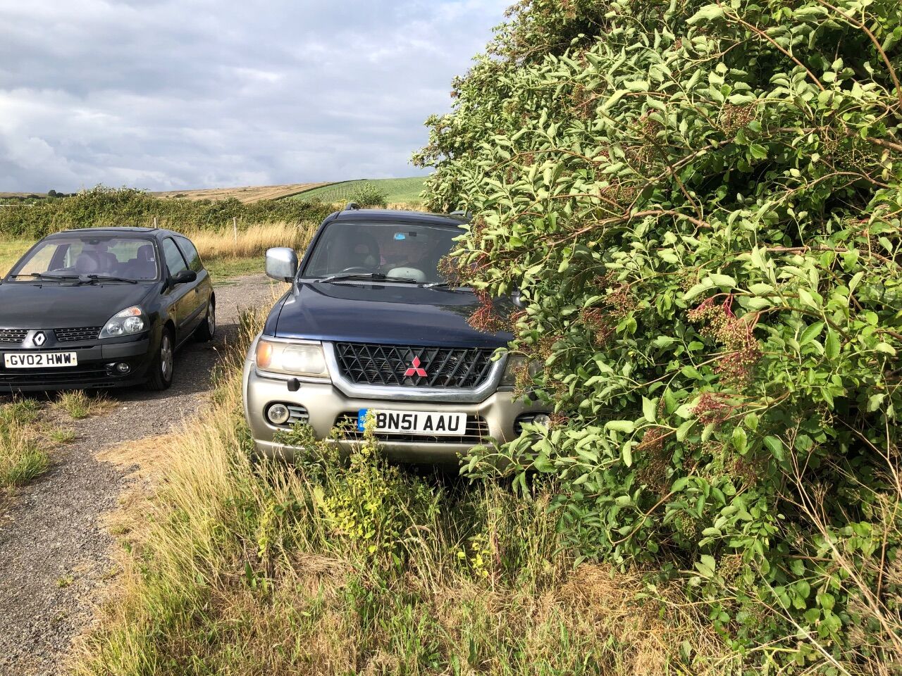

I went to go and look at the Shogun last night, and it’s just as good* as I remember:
Whilst it did fire up and drive, the alternator (or possibly the wiring - rodents aplenty up at the stables) isn’t charging.

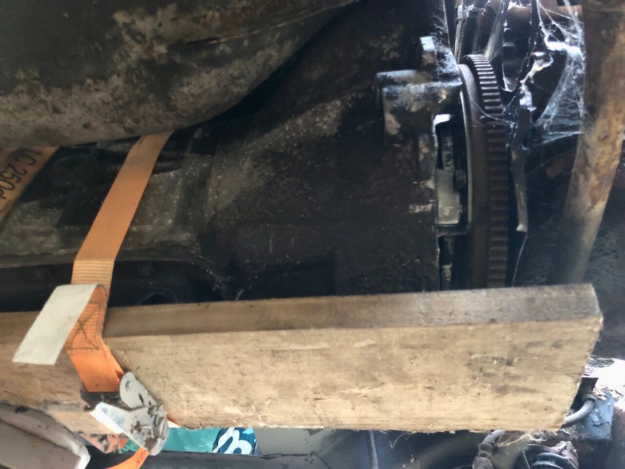

I want to move the disco to the courtyard to do this work, which means moving the Lada. Moving the Lada means putting the gearbox back in. So I set about that.

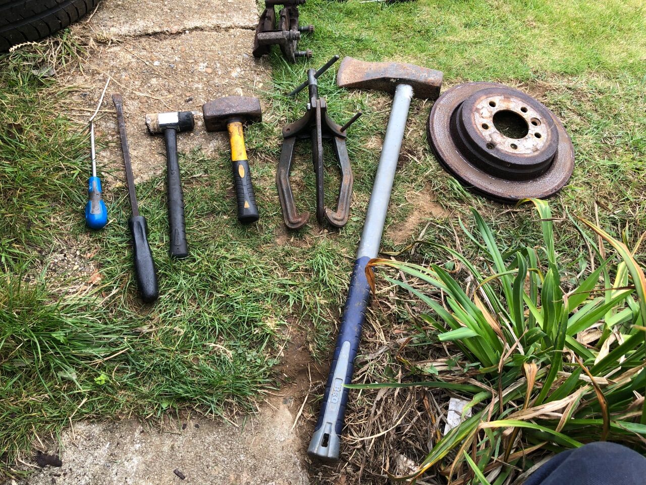

Despite my best half-arsed efforts, I couldn’t get it home. The clutch plate is aligned and the input shaft has meshed with it, as I can turn the engine over by rotating the prop flange, but I can’t get the right angle to get the last bit of travel. I suspect I need to be a bit less lazy and remove the rear bracket from the gearbox so I can lift the tail higher.
I did get a second pair of eyes on it, just in case I was making a daft mistake:
But all they came up with was ‘just fucking scrap it M9’

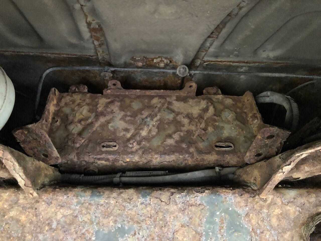

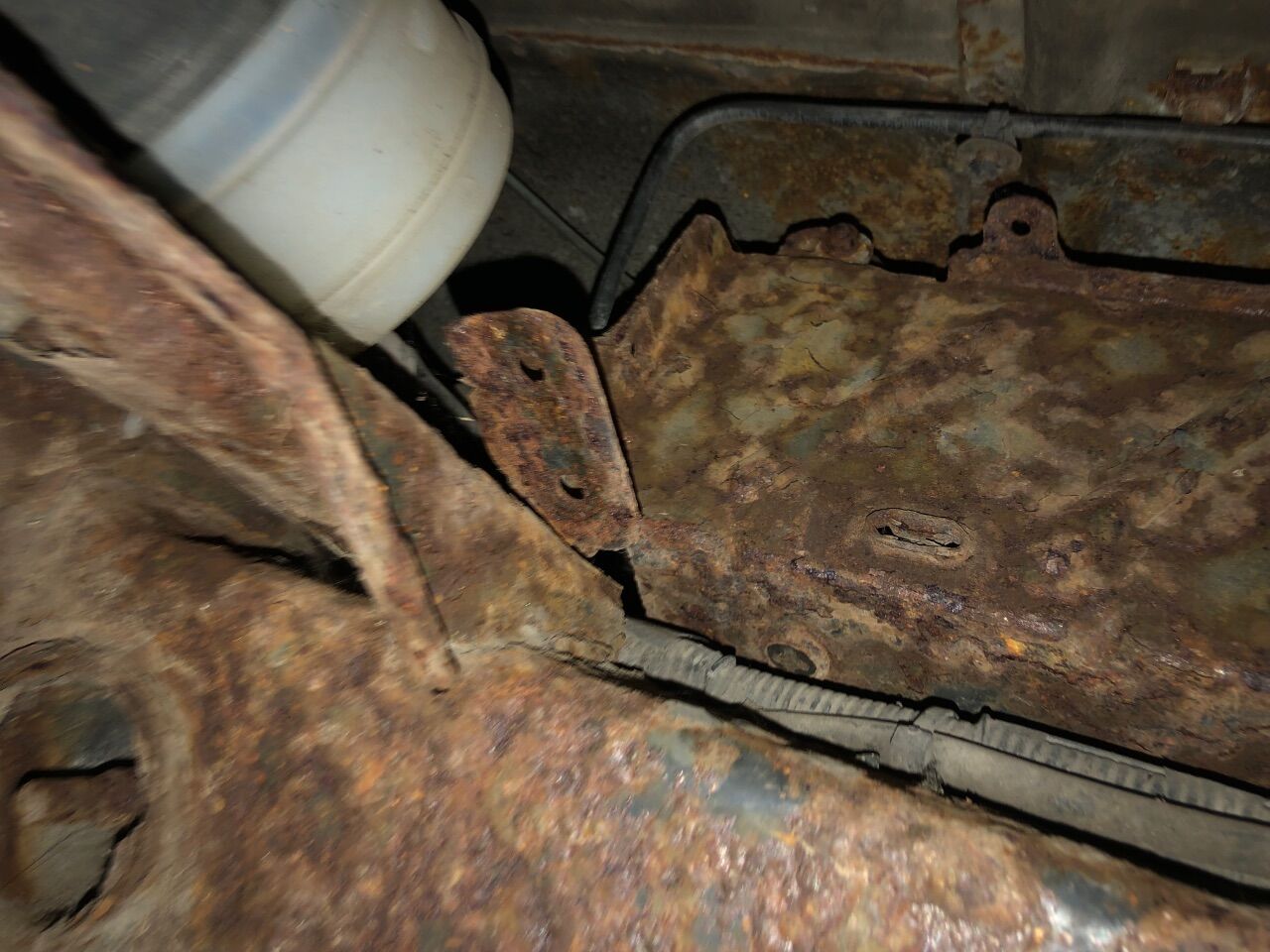

Now that I’ve refreshed my memory as to how the parking brake will be parted from the disco, I took a peek under the arse end to check how shite my future could be.
It’s nearly as crusty underneath as the shitsubishi is. So surely unbolting this will be pure misery… hold on!
What bolts?! Turns out whoever was in here last did not put them back in. That saves me a job then, although might be worth tracking some down for when I refit it.
In a bit of pathetic moment of straw clutching, I did look to see if the creeping green death had made its way into the connector for the handbrake.
Looks good to me. At least that increases the possibility that the new(ish) parts won’t be a total waste of money.

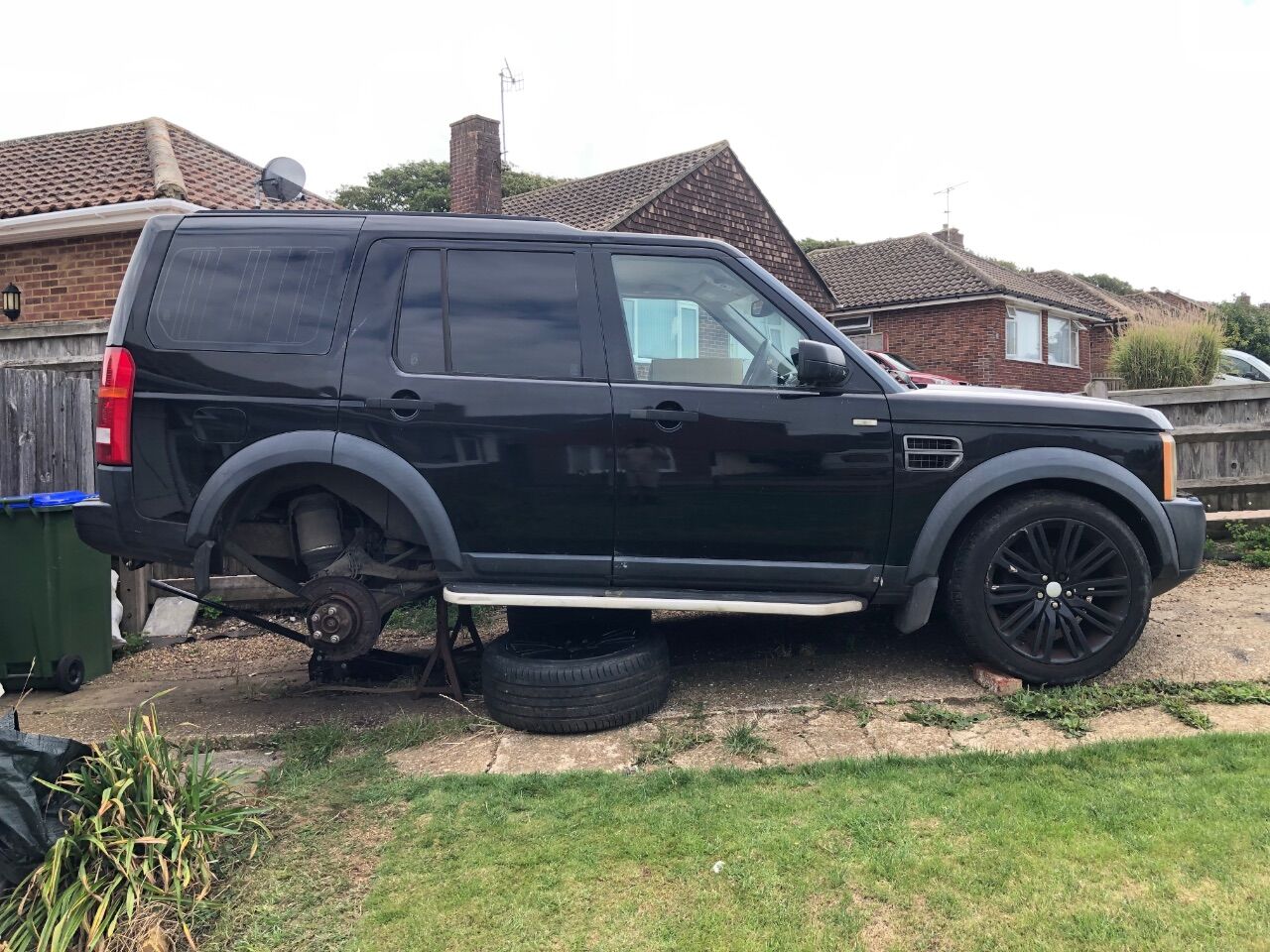

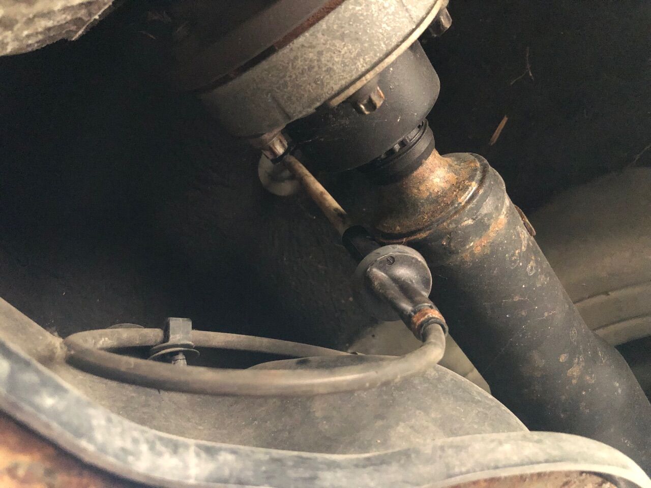

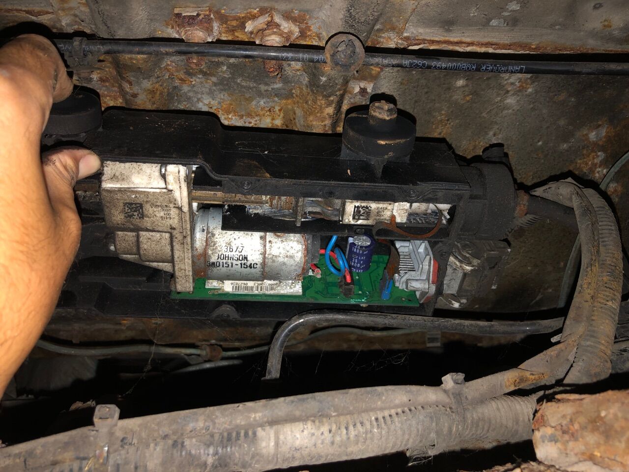

For context, this is what I’m up to.

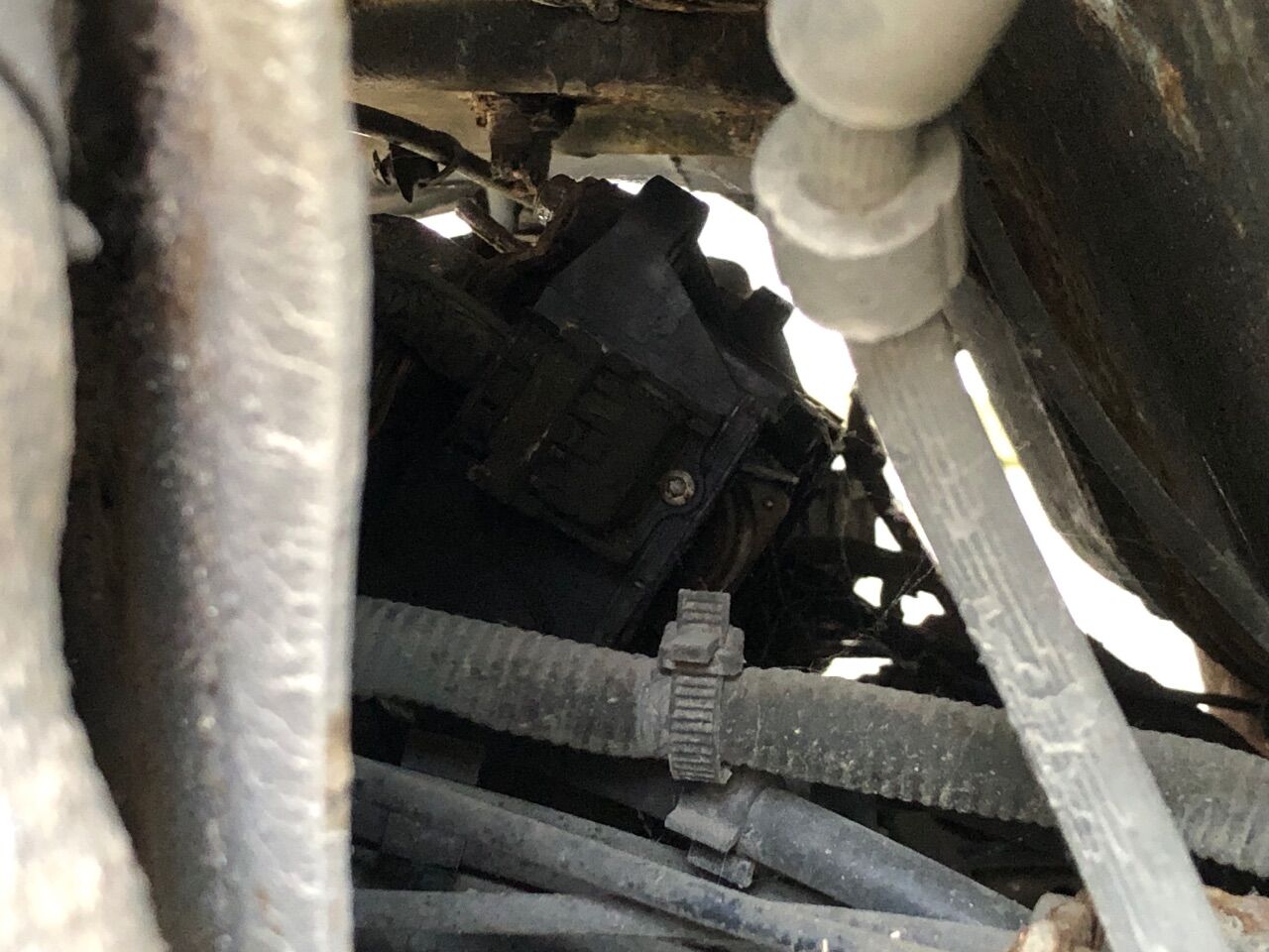

The prize* is lurking here, above the diff:
I’m now taking a break to go and visit family friends with the kids for a change, as the ‘new’ module hasn’t fucking arrived (same day despatch apparently, which appears to translate to ‘do fuck all for three days and ignore messages’) so it’s not like I can finish the job.
Hopefully once I’m back then I’ll get the other side apart, pull the handbrake cables out and free the old parking brake module.

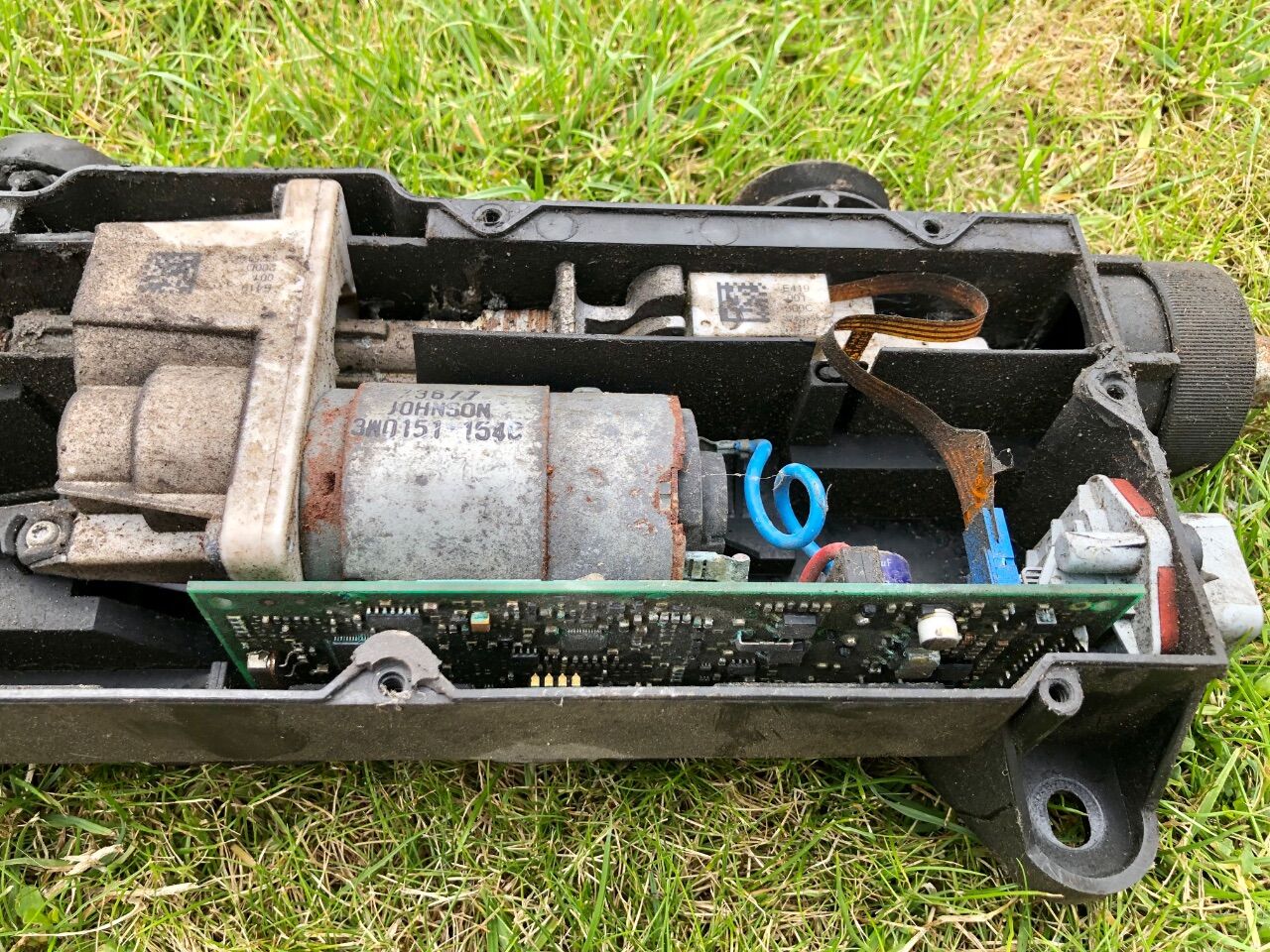

This one was ok(ish) until I submerged it in water - I had no idea someone had left the cover off the handbrake module, and the electrics didn’t enjoy taking a bath.
I think the common failure point on these handbrakes is the plastic gears, but I wouldn’t be surprised if there’s other fun stuff they can do to break.

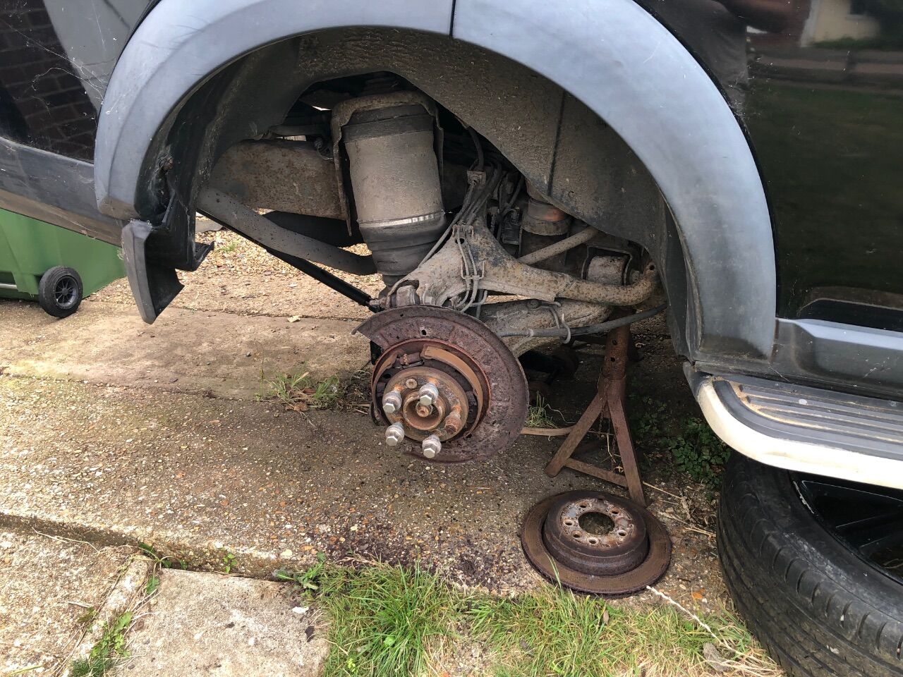

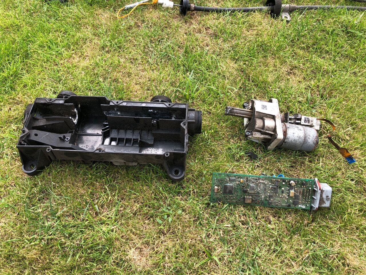

After the kids were in bed I got back out to the Land Rover, and took the calliper, carrier and disc off the other side.

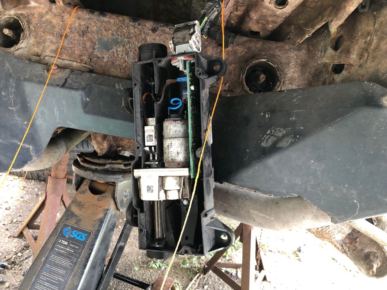

I then removed the bracket from the parking brake module, so I could have a better look at the guts of it.

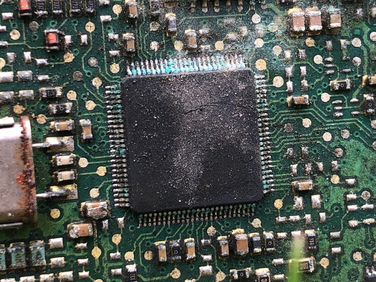

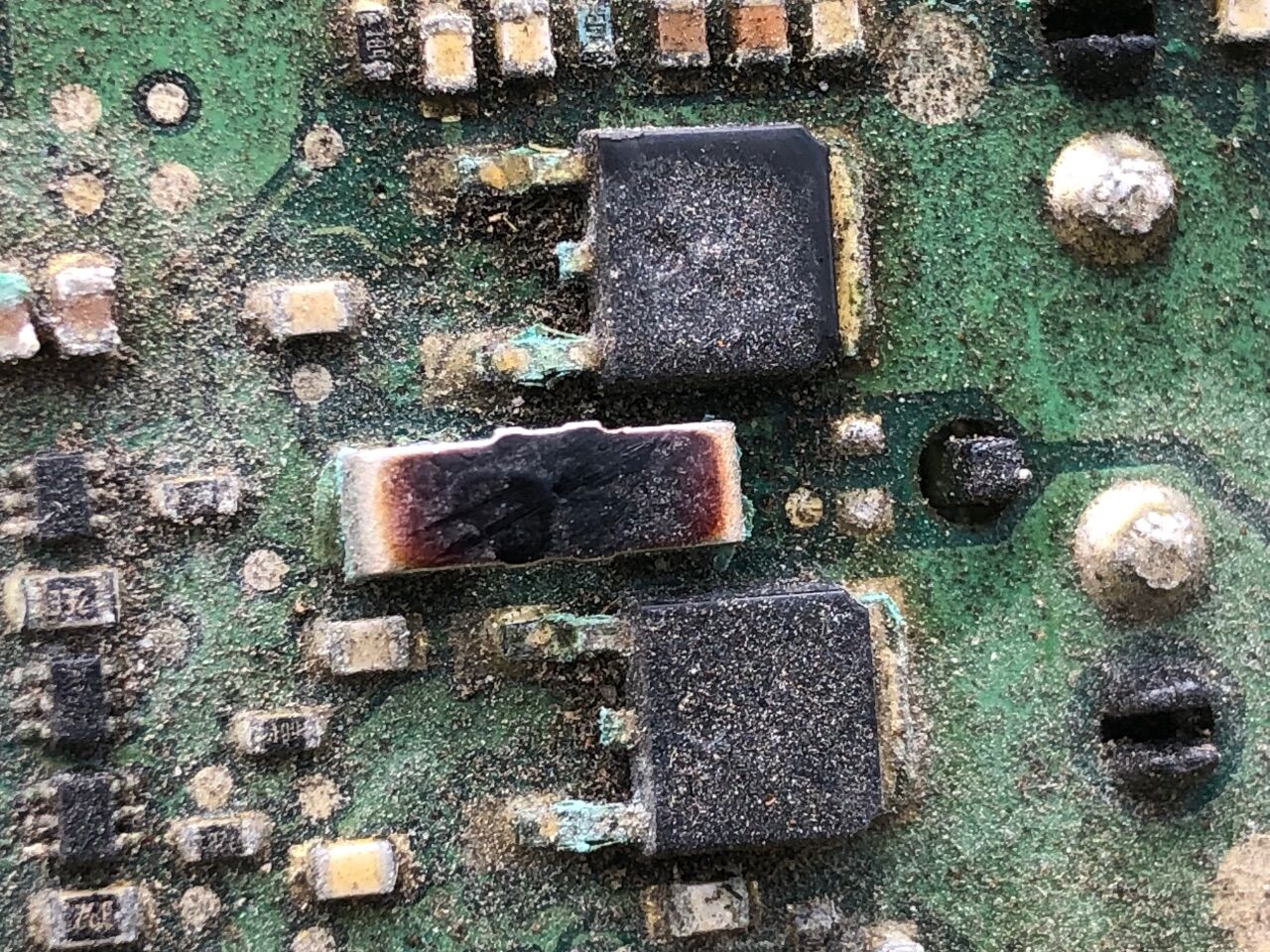

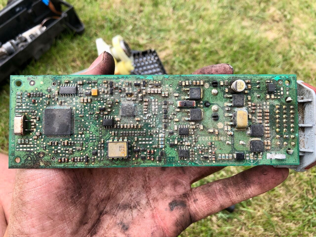

Not sure how well it shows in the photo, but there’s damage to the tracks on the PCB plus a coating of general sadness across the rest of the components.
Tomorrow I’ll be pulling the parking brake shoes out so that I can release the cables and pull everything out.
I think it’ll be interesting to strip it down and see exactly what shit its pants, but if you’re not as sad as me then YMMV.

More progress today, nearly there now.

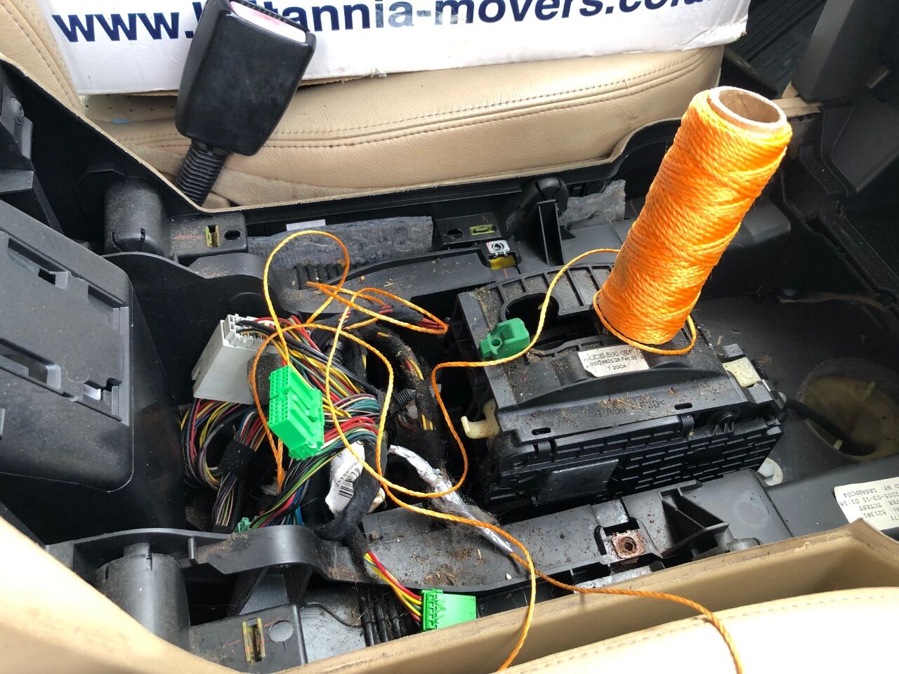

I had to pull the centre console out so that I could get to the end of the emergency parking brake release cable.
The plan being to chuck string on the end of it so I can hopefully have an easier time pulling it back through later.

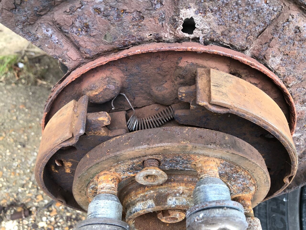

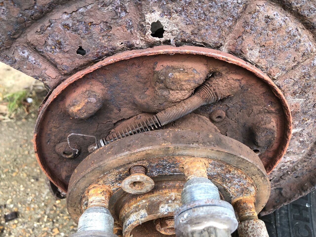

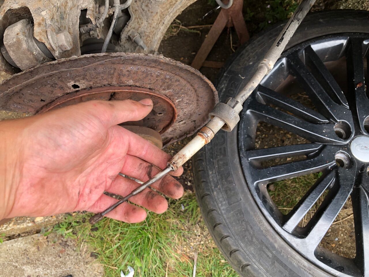

It wasn’t actually too bad to remove this from underneath the car, one heat shield had to be cautiously removed (including a lump of rust falling in my eye, and the exciting stumble down the driveway in search of the first aid kit).

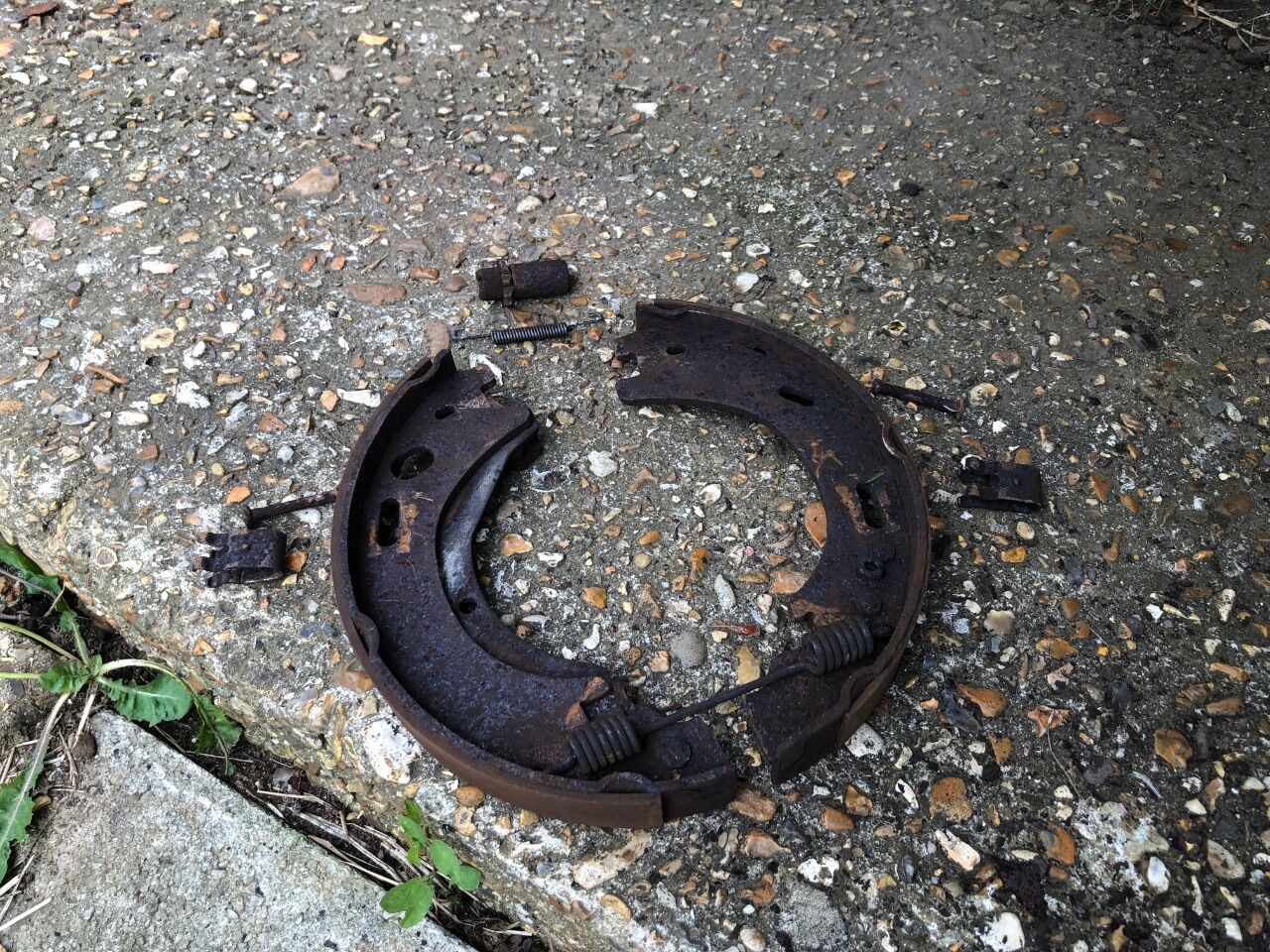

I’ve now turned my focus to the rear cables, these are coming apart without too much grief at present.
The parking brake shoes are pretty shagged, but they’re going to have to do for now - if it passes the MOT then it’ll get sorted in the coming months.
I just need to do the nearside, and then I should be ready to start pulling the module out.
That waterproof* lid probably only served to hold the water in anyways.
Well that sucked.
It’s out now though. Pulling the cables through was probably the most miserable part. To add some enjoyment, I laid down in an ants nest whilst doing the offside.

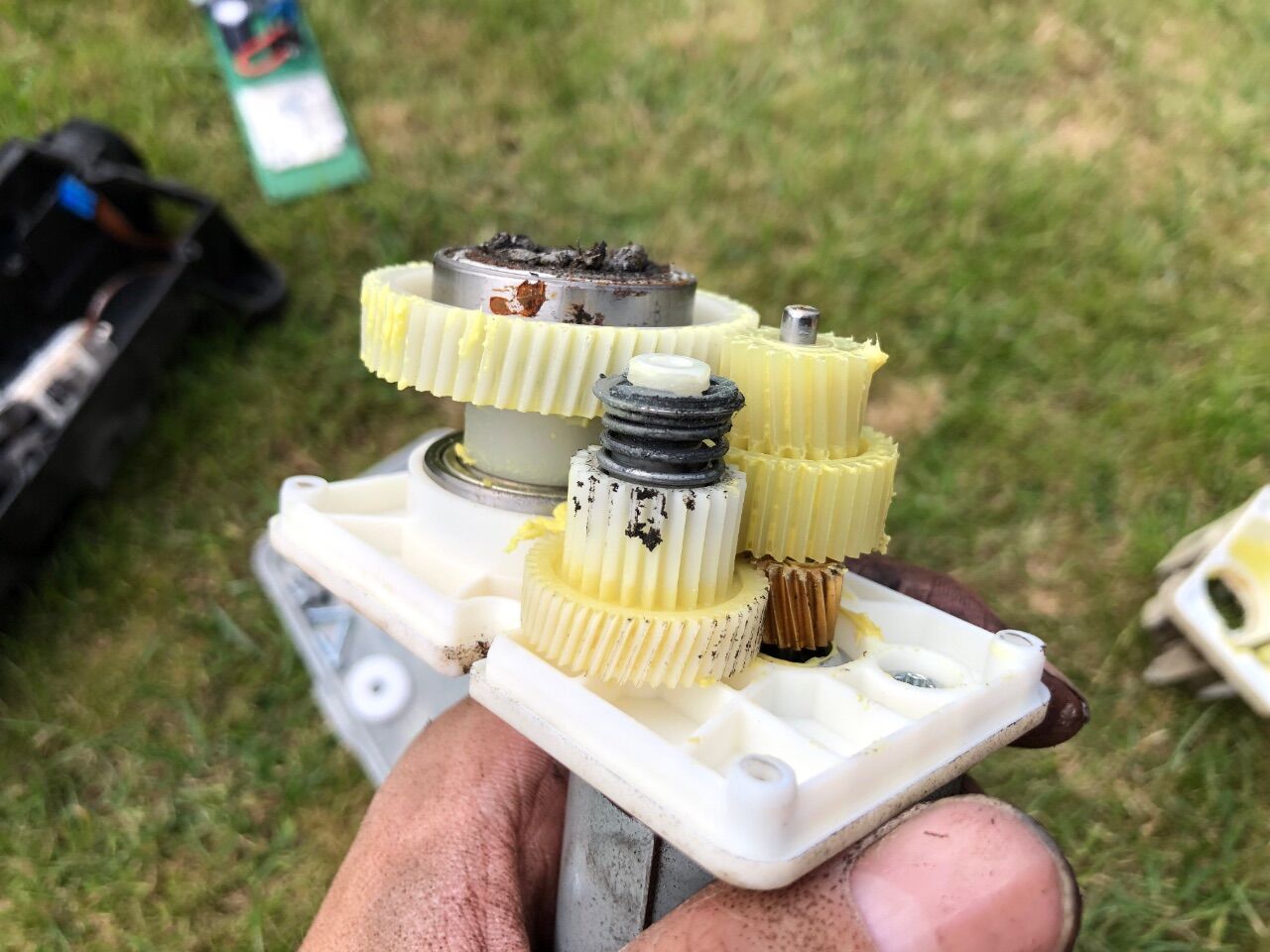

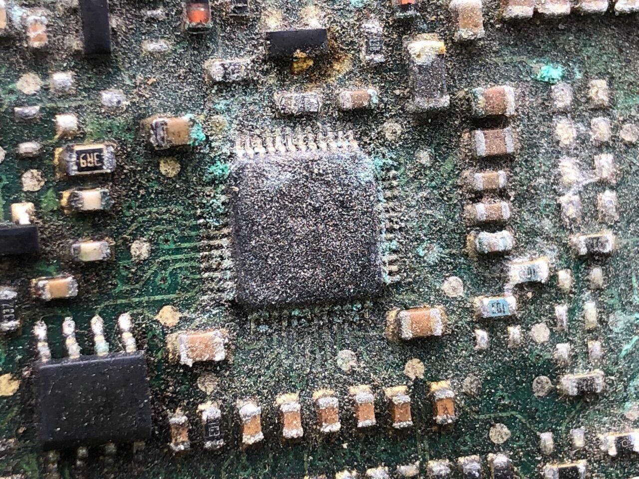

I did pull everything apart, but there’s no smoking gun I’m afraid.
The motor and gear box were tested on the bench, and they’re tip-top (if you ignore the dirt I got on the gears) which is what I somewhat expected.

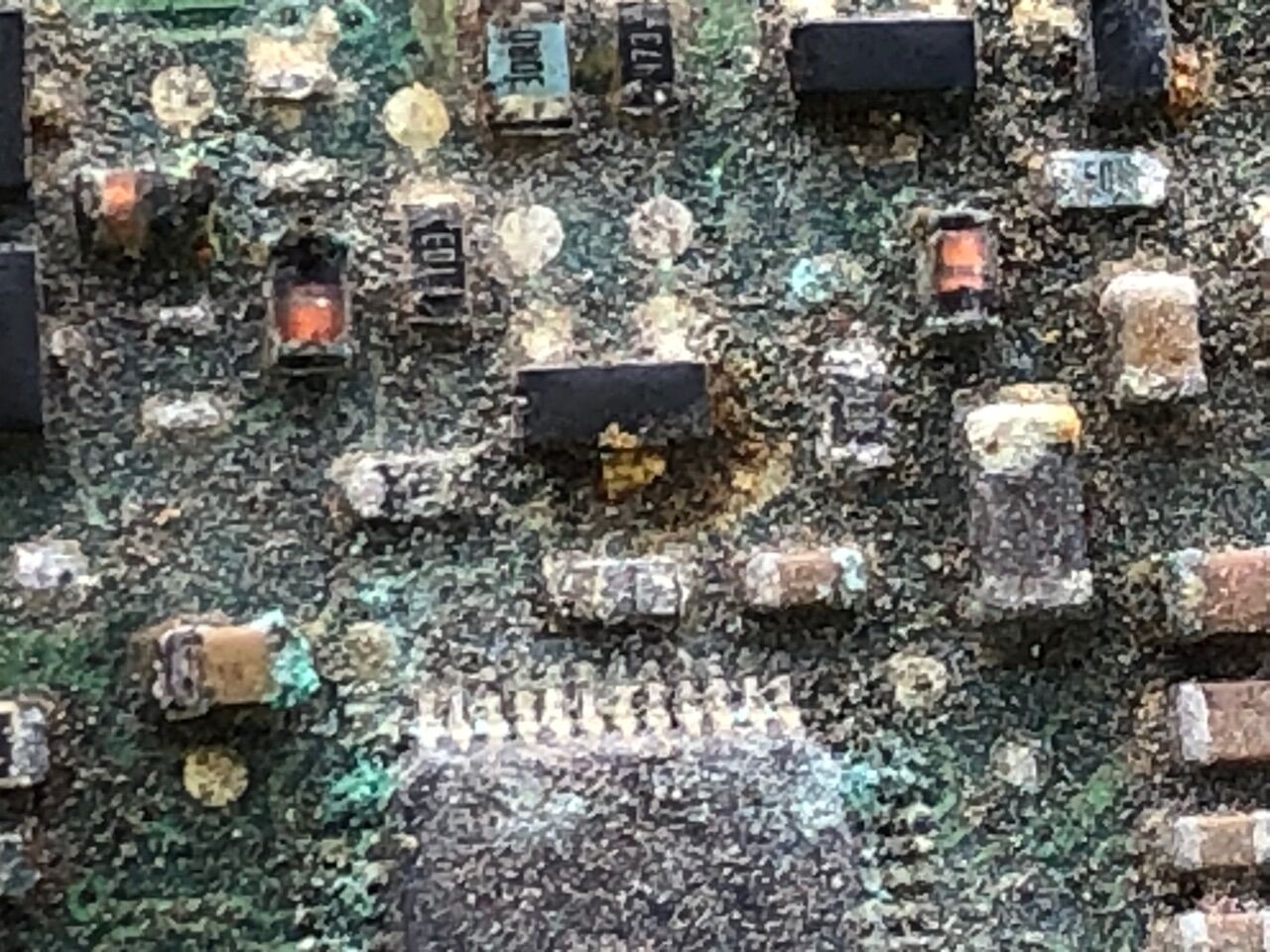

The board had corrosion over pretty much all of it.

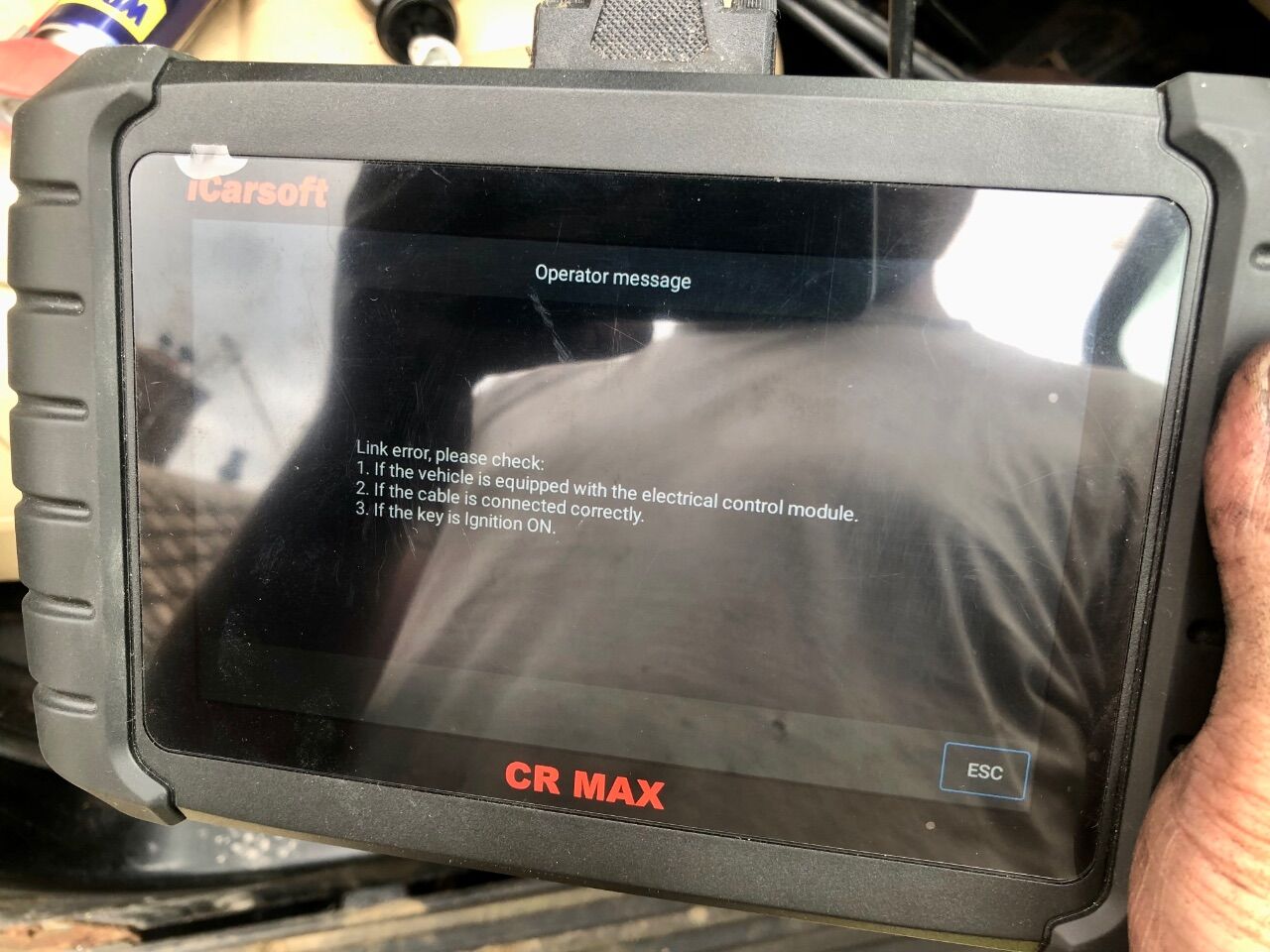

My gut feel is that corrosion and/or a short has killed the microcontrollers, but I have no means of testing them. I did completely clean up the board with contact cleaner and a toothbrush, just in case…
No luck though.
I’ll just have to be patient and wait for the replacement.

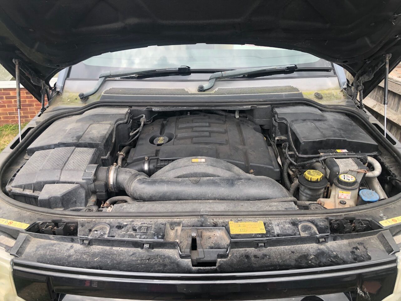

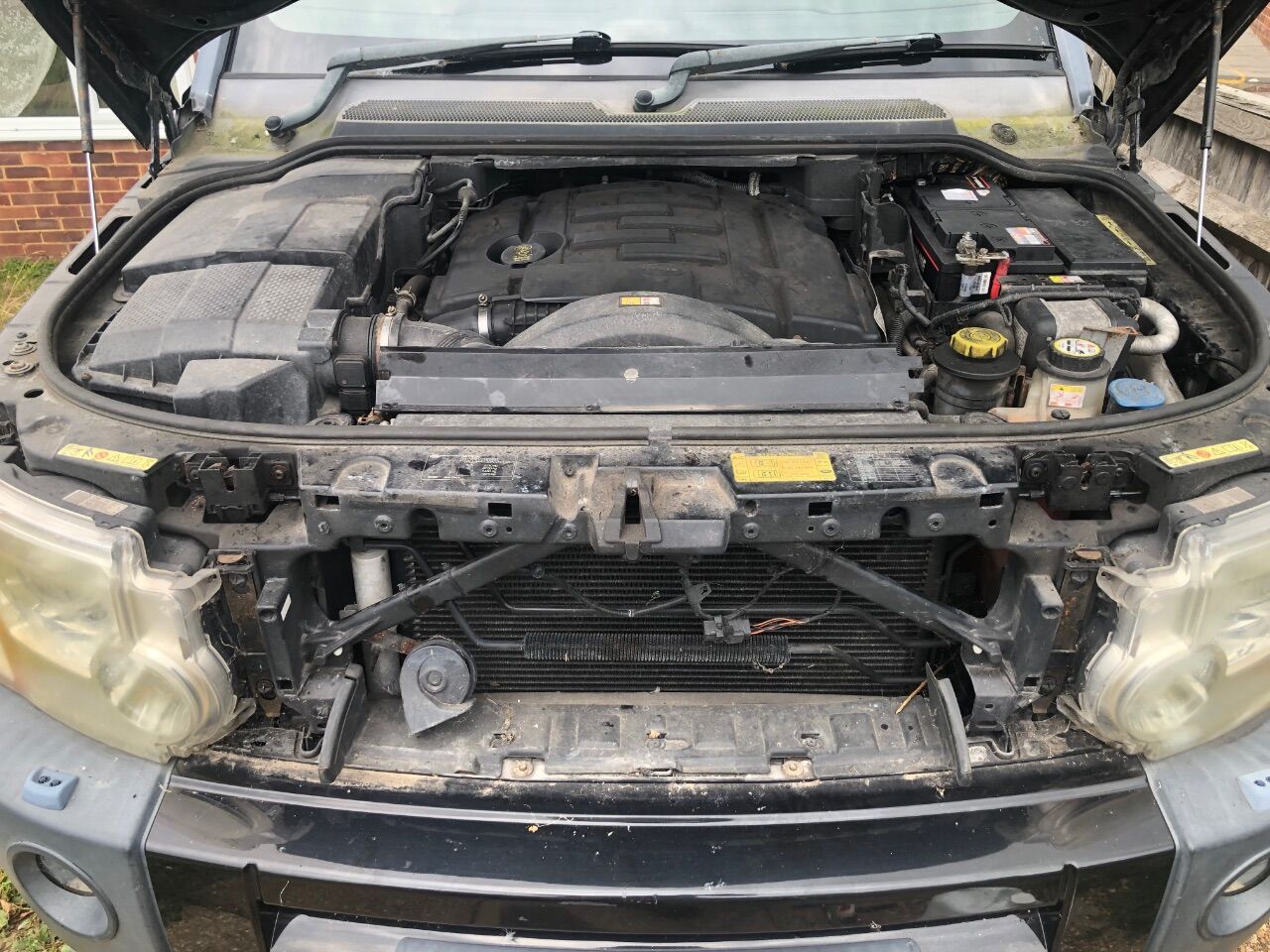

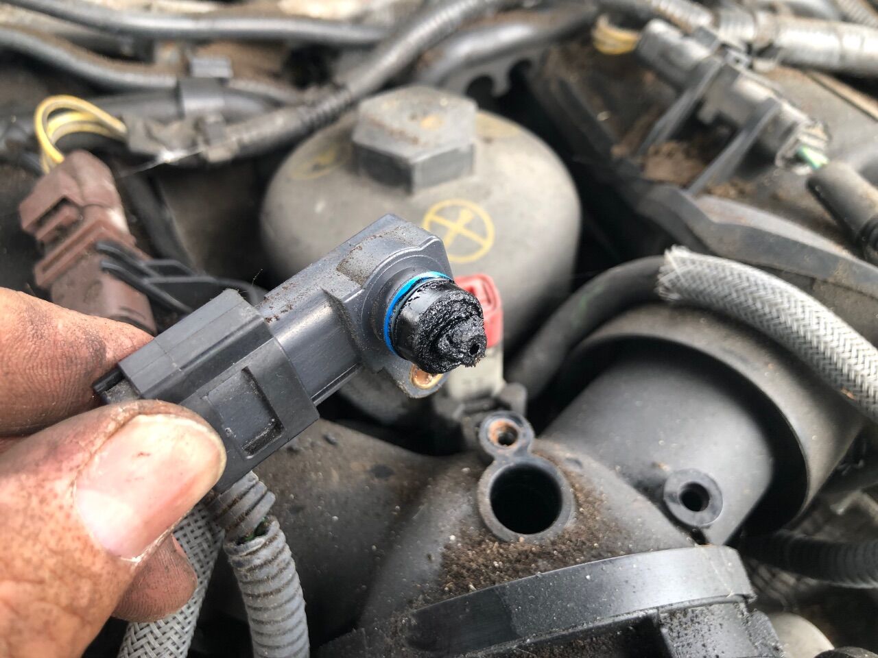

In the meantime, I pulled the MAP sensor out to check it. Apparently if these get gummed up then it affects the performance*. My mum’s D3 feels like a rocket ship compared to this one, so I thought it worth a try cleaning this.

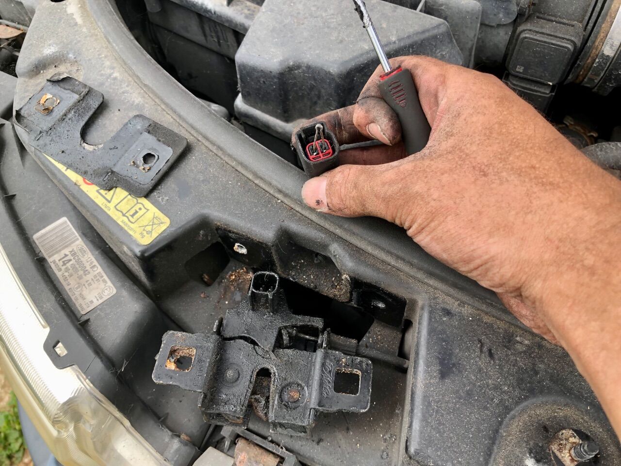

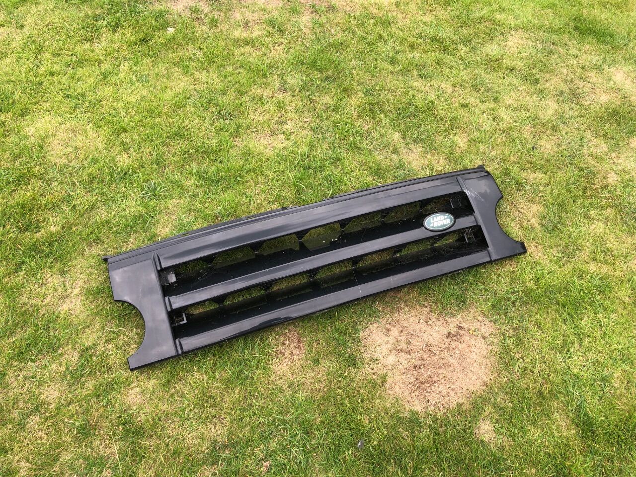

Once that was cleaned out, I set about sorting out the bonnet cable. At present, the bonnet doesn’t latch shut and relies on being poked with a pick in order to close - the man from the ministry won’t like that!
Credit to JLR, the grill comes off with no tools needed which is a good shout in my book.
In another good move, the bonnet pull is made from two separate cables which join in the engine bay - it’s the engine bay end that is bad on mine, so no need to fuck around pulling the dash end out if I decide to clean it.

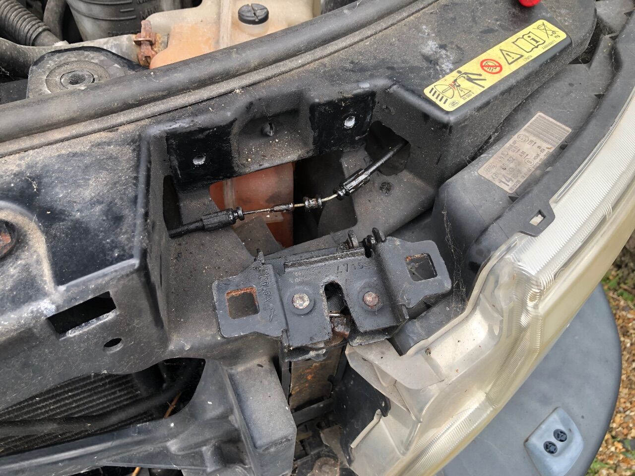

Whilst pulling the latches out I found someone had been here before!
I tested the switch, and it seems like the paper clip will be staying.
This is where I fed oil in, once I had the cable vertical:
Working the cable for a while and feeding more oil on gradually seems to have freed it up. The bonnet releases and closes correctly now.
Last thing I did was chuck all the engine dress-up back on, as I’m hoping not to need to come back here now.
