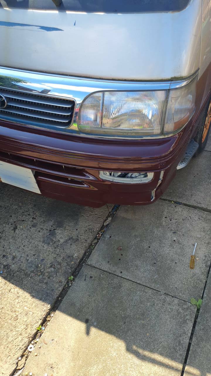

This is one coat of Rustoleum Combicolor applied to the front bumper using a Harris gloss brush,  paint thinned with normal white spirit
Rollered one side but will have to take a better picture as it's a bit tight to my fence.
Just wanted to tidy up the bottom bits and i think it looks okay ish was going to pop another coat on today but reckoned it was too hot and paint would drag
Oh and ignore the wheels they are getting stripped and done in gloss grey but that's a next weekend job

Hi i found the combi colour need thining a fair bit . . Coverage very good very good gloss  . . Reckon thinned three to one part thinner but it was massively hot.  If not thinned it dries with bubbles but thinned you can work them out

There is a  bit of orange peel where it's rollered but where i brushed it on especially the bumper it's really smooth with minimal brush marks.  Will be flattening the back panel then giving it a g3 then polish as a test but I'm very happy with results as it was very shabby
The gold is a rattle can . . Deep copper metallic the centre cap cam out amazing however lack of prep on my part as in not removing flakes makes it look rather shite.   Also the gloss grey has a better coverage and was also going to dn the door steps and the very bottom two inches that were stone garded.
