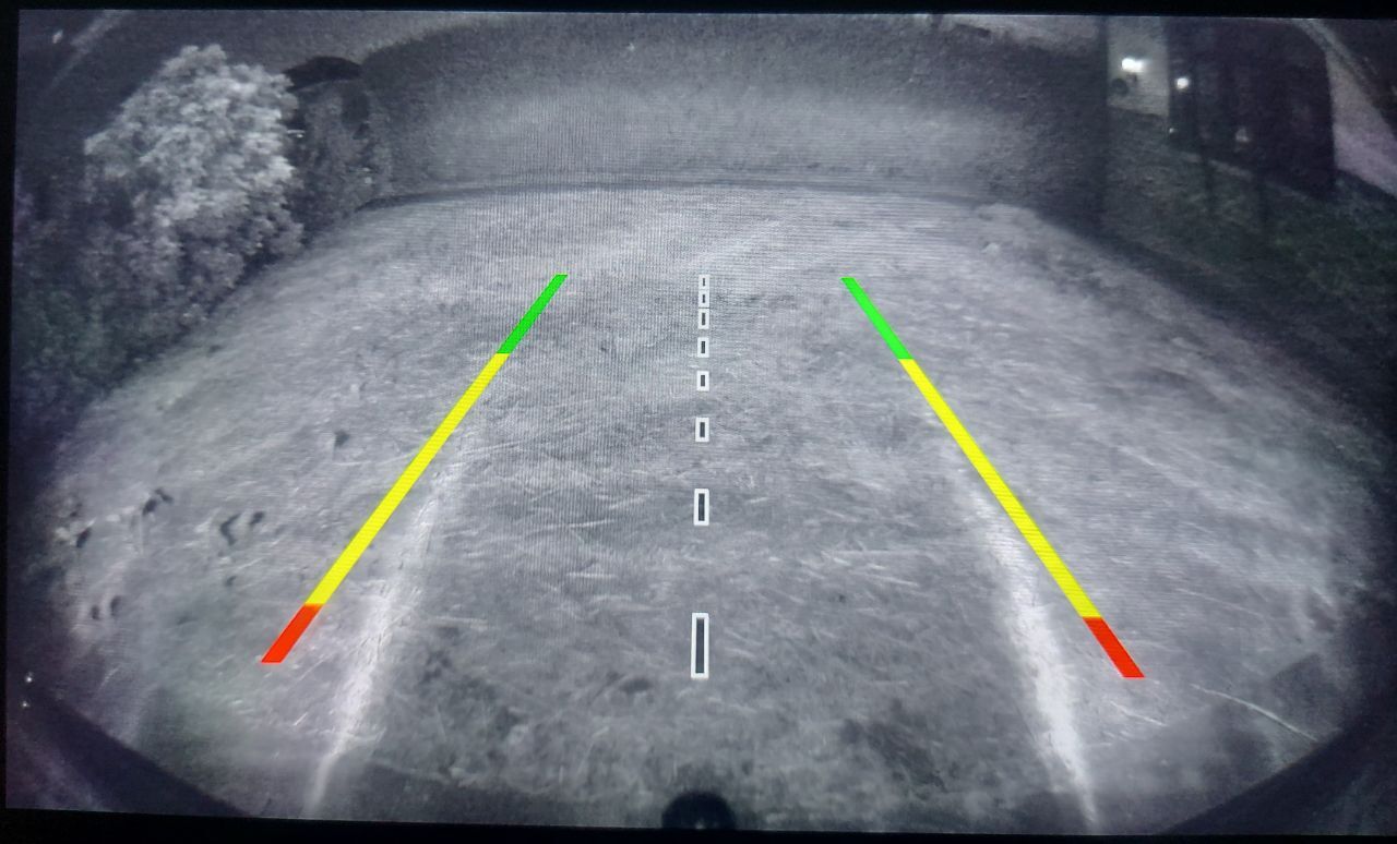

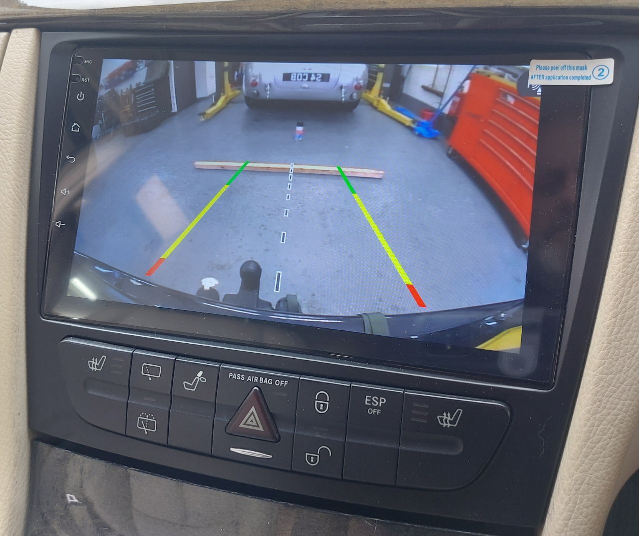

Experimenting with cameras as the Xtrons Android head unit will accept a front and rear camera. Tried a couple of different positions on the rear but the tailgate release being central means a slight offset.
Discovered in the settings this head unit will accept AHD cameras so l have ordered a dapm expensive 1080P with Infrared LEDs.

Did a temporary fit of the new reversing camera just above the rear number plate, this will have to be experimented with a little further as access to the tailgate handle is restricted.  May just be a case of shortening the release lever a litte to give a bit more finger room. The view may be better if the camera was out a little further like the other one I tried, l'm liking the infrared night view.
Day/night shots in the same spot.

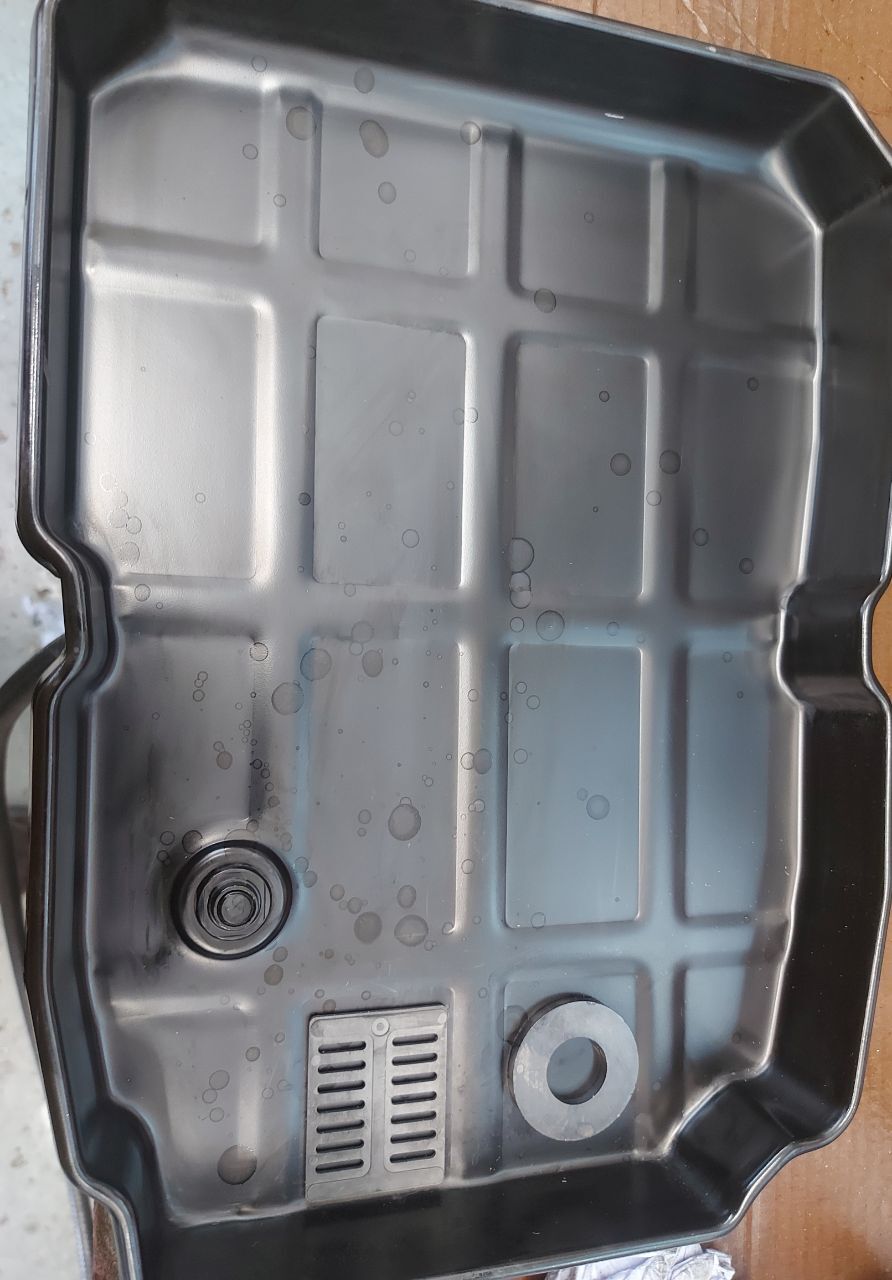

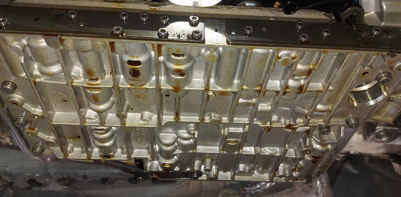

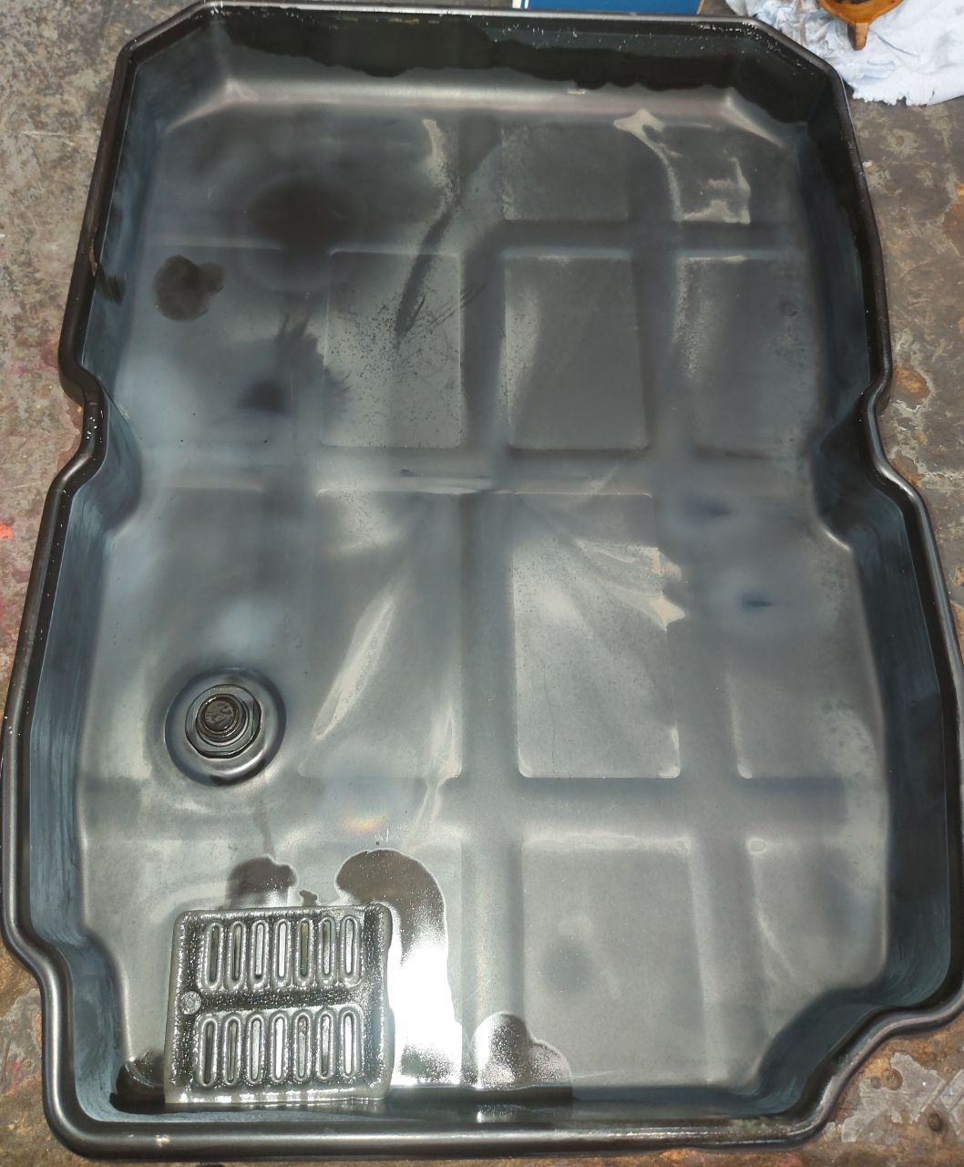

The S211 Meyle gearbox service kit has been sat on my bench long enough to grow moss and an opportunity came up to use the ramp undisturbed today. The oil vacuum pump l bought recently was handy, made dropping the pan less messy and no fighting the drain plug. I dropped the valve block, gave it a good clean inside and made sure the speed sensors were clean. Despite flushing the converter and oil cooler on startup, the oil is not as clean as l would hope. Thankfully, the wee filters inside the valve block had no debris.
Oil colour can be seen dripping.
All the balls came out easily with a little vacuum from my brake bleeder, filters and non return valves with tweezers.
Oil on the plug was a bit concerning as it can wick up to the controller, seemed to clean up ok and no oil dripped out whilst hanging free.
Sump pan cleaned up ok, added the additional magnet.
Gear changes are much smoother, yet to try from a cold start. I will give it another oil change and flush in a couple of thousand miles as I'm not happy with the oil colour.

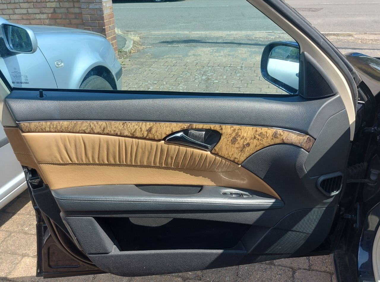

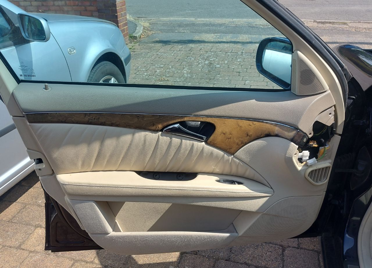

I decided enough was enough looking at some the beige interior in my S211 as it reminded me too much of tired old medical equipment l used to work on. Swapped all my Designo door cards over from the old S211, eventually the rest of the interior will follow. Bit of a mismatch inside but makes me feel better.
Before.
After.
Designo had extra felt on the front door cards.

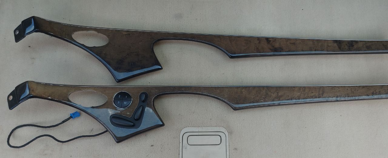

Drivers door was a little more involved as the wood trim had to be swapped over. Had to run an M5 die down 3 of the mounts as they had speed clips and not nuts.
Rear door.
The old  rear door cards had the extra felt.
This looked odd.......
Hand finished as opposed to the old plastic cap. My passengers will know it's a posh car when they see it.
I think that darker trim with the Caramac insert looks a lot better than the beige. But I've never been a fan of light interiors, I know people moan about boring black trim, but as a father of 4 kids, darker trim is easier to keep clean from grubby hands/feet and snotty noses.
Seats are the same colour as the door inserts trimmed in Nappa leather with air adjustability. I'm hoping to make a hybrid drivers seat using the memory function from the beige on the tan Designo seat. Need to pinch all the bladders out of the passenger side too or repair them. I quite enjoyed being a passenger in the old car as the bladders stayed pumped up!

The really reliable part of the Xtrons has been the expensive reversing camara, nigh on an OE setup the way it works and last night the IR vision reversing in the dark was superb. Just a shame the whole Xtrons experience has not been the same.
