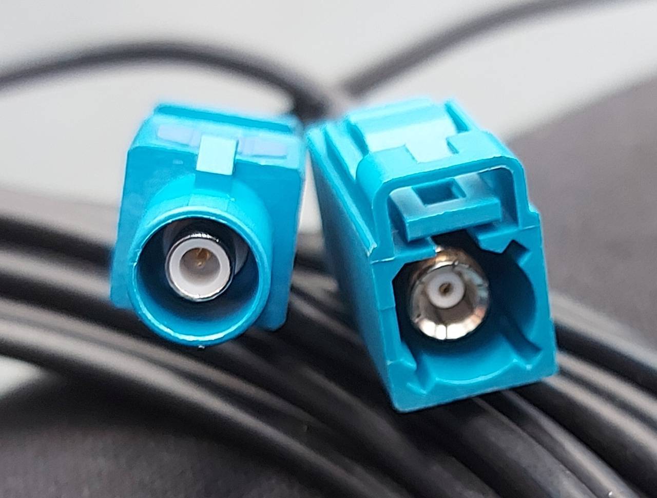

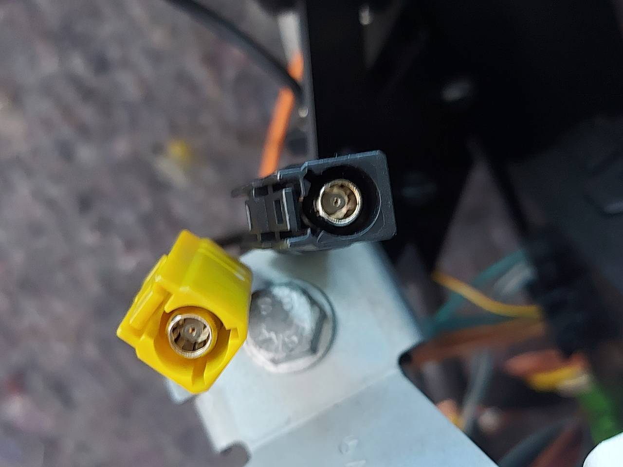

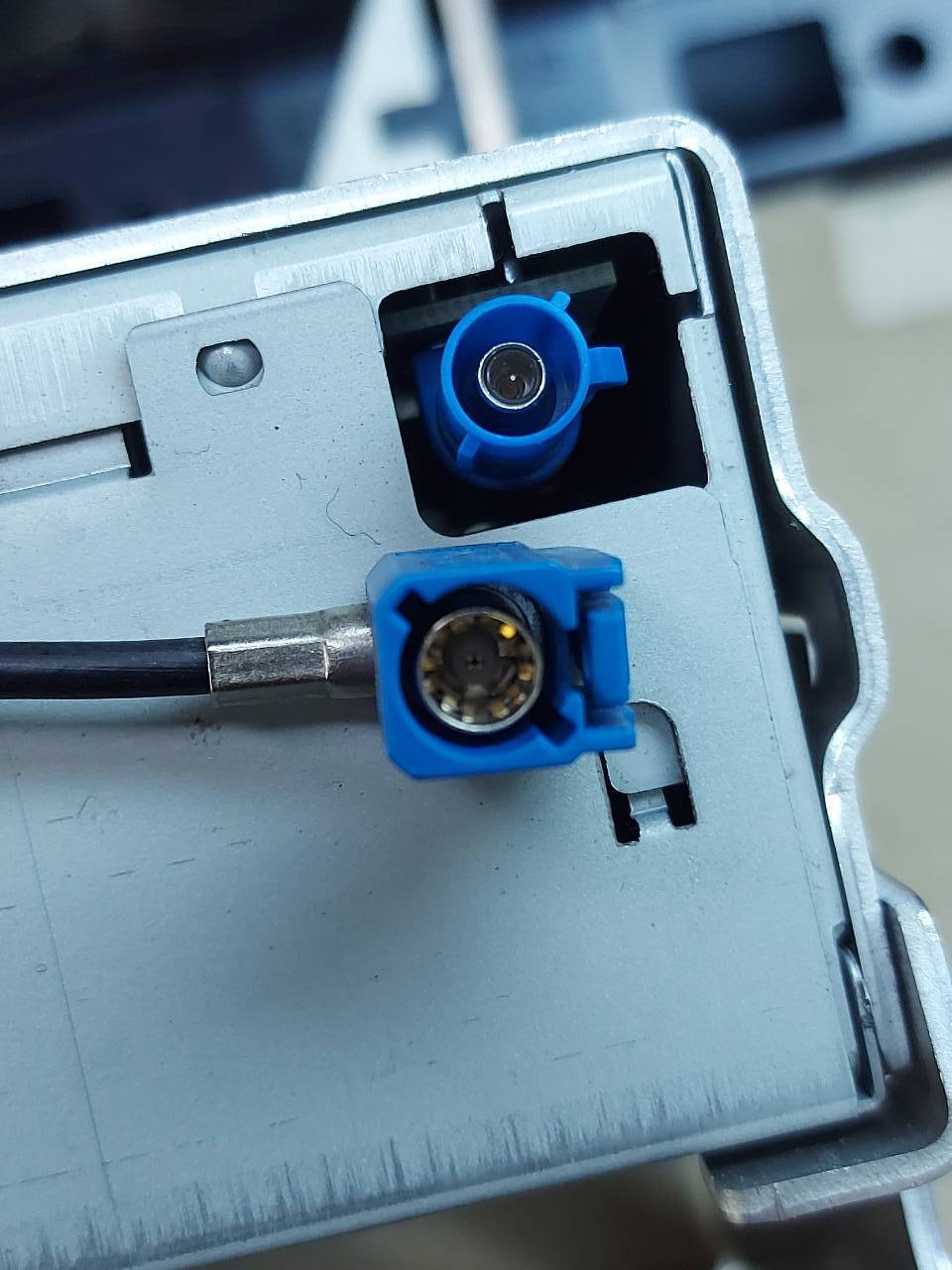

Had a good look at the navigation CD unit and infrared amplifier connections so I can order the correct Fakra cable from the antenna amp up to the head unit. Oh the joys, I found 3, one on the navigation unit and two on the amplifier. Hours of fun to be had now on Google confirming my suspicions as to which on it is.
1 hour ago, Westbay said:
If it helps, on my Audi the nav fakra is blue ...
Thanks, my car seems to be the same.
I am 99% certain the radio Fakra is the black connector. From what I have researched so far, the universal Fakra extension cables seem to have all the slots on their sockets and no protrusions on the plugs.
Seems the problem was easily sorted by looking on Amazon for a "Universal Fakra Extension Cable"!! 🤣
Just need to find out what controls the antenna amplifier power now.

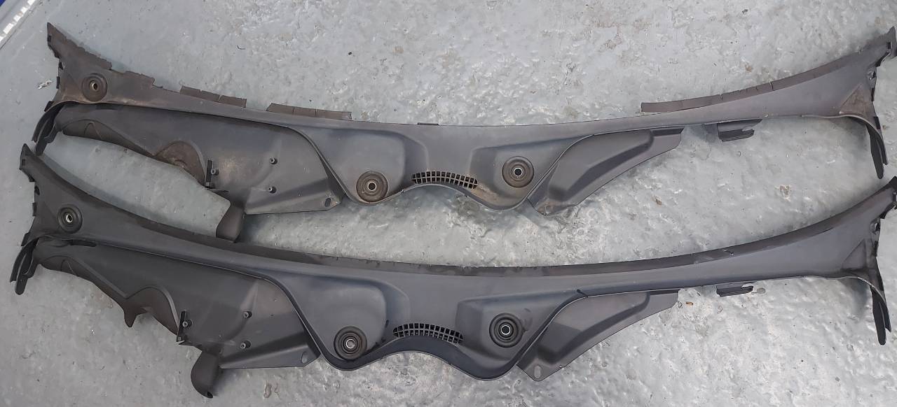

Stayed on at work last night and swapped the plastic scuttle panel over from the old S211 as the screen seal was almost non existant. The replacement is not perfect so I will look into the cost of a new replacement.
I must have broken the drivers wiper clip as heading home Monday on the M25 the wiper did a U turn so I had to pull over. Made it home and rescued the spare which was on this car when I bought it. Slightly annoying as I have not had my money's worth out of it yet but should be able to swap the blade over when needed. 🤑

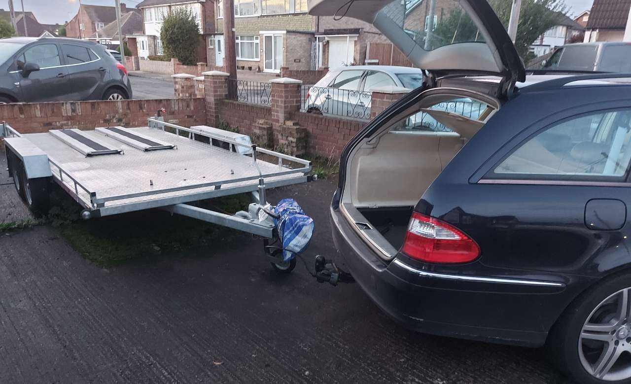

Swapping the rear bumper and detachable towbar ended up with me buying a 7 to 13 pin adaptor. I tested that last week in case I was called upon at the last minute to collect a replica AC for a young man on this forum. ;)
