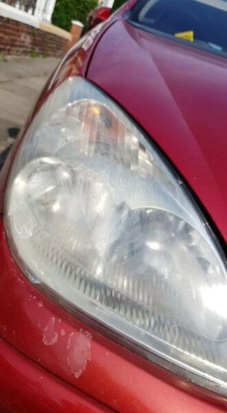

so here is the before, passenger side is fine as the previous owner replaced that due to the original being defective
so the drivers side being original has yellowed and faded quite badly
218143482_996962847786683_2057644189903751305_n.thumb.jpg.b68dcf0939b5b59a5b54ed0113dee000.jpg
so an awful lot of wet sanding and the polish the kit came with
could feel the sand paper working tbh, which surprised me
217520316_403674191388277_7188727928754516785_n.thumb.jpg.867ecd4bd892da9fe5ba24b74fafaaa4.jpg
and here we are, not perfect by any means but still a massive improvement
wacked the sealant on and tbh you couldn't tell it was still a bit faded from a distance

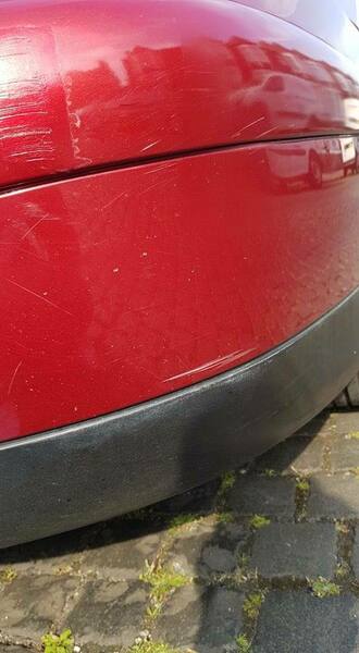

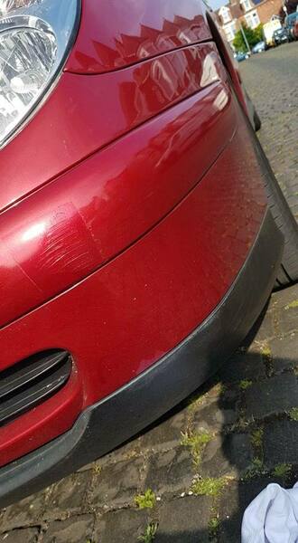

whilst i was doing that i happened to notice someone has scuffed me.......or i scuffed someone and didn't realise
nothing too bad, note my previous repair up close, not perfect
220006097_521074475874206_6918930178834142266_n.thumb.jpg.51b2b6398483345296ebf305226a689e.jpg
i suppose this is a weird technique but it's always worked well for me
218374244_338924114432312_8704635100935219031_n.thumb.jpg.dea71b0f5713592f55ec456e131c0069.jpg
and here we go, all done, also spent some time tidying up the stone chips and the rest of the marks on the car

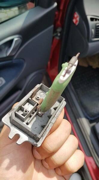

heater blower has stopped working on speeds 1 and 2
works on 3 and 4
resistor?

Look at the ebay image of 'your' resistor.. I bought a rover one for £6 to fit *straight into ToMM© £30
*OK.... I hacksawed a 1/4" all around face but it was like chocolate ;)

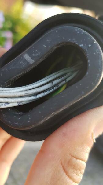

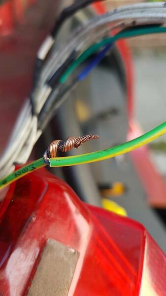

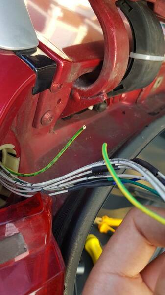

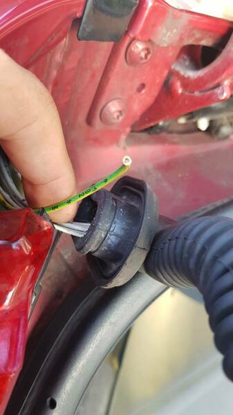

was investigating why the rear wiper wasn't working and decided to pull the rubber tube off the wiring properly
yeah that'd do it
oh so you decided to break right in the join to be awkward
why of course, you're french
and yes that wiring is as shit quality as it looks, really impressively bad
also note the hilarious amounts of previous repairs
oh boy the french are great
i has bodged it
bodge feels alright
shall solder tomorrow
don't worry i have wrapped it in crap quality tape
BUT LOOK
WE HAS SUCCESS!!!!!!!!!!
HOT WIPER ACTION YO

Same issue I had on my xsara, just with less broken wires! Good luck putting all the rubbers back! I left mine out as I'm sure the wires will snap again, and it'll make the job easier next time!
that bastard rubber cover won't slide back over, oh and the trim covering it is now broken cos french
not going to put it back properly cos it will just break again
i mean, look at the utterly hilarious amount of previous repairs

Mine were very yellow and looked like they had been sandblasted.
Spent hours on them with little improvement - Autosol, toothpaste, a glass polishing/scratch remover from work, wetordry - nothing seemed to help.
It actually had but what I was seeing was inside - looked like some kind of algae growing in there - weird as there was never any condensation.
Bought a replacement pair from eBay, fifty quid.  Much better.

honestly, i'm thinking of just buying a replacement
only need the 1 as the passenger side has been replaced previously

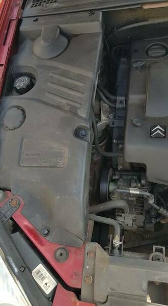

also regarding the starting issue
did it today and i happened to be listening carefully
oh, the starter sounds a bit weird when it's doing it
seems the starter is my main suspicion now

Weirdly both my headlamps were original. But the n/s was completely crazed and yellow and the o/s perfect when I sold it. I’d tried polishing kits etc too. I also had the headlamp protection / eu adaptor kit from Citroen with the correct masking. ( even though, yes, the hid bulbs have a perfectly flat projection- my French was simply not up to explaining to Le flic the intricacies ).
it does almost seem as if only 1 side seems to suffer most
i'm relatively pleased with my results, will give it more work before no doubt replacing the headlight

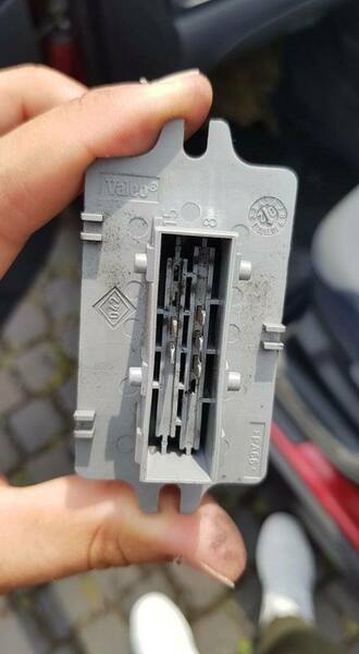

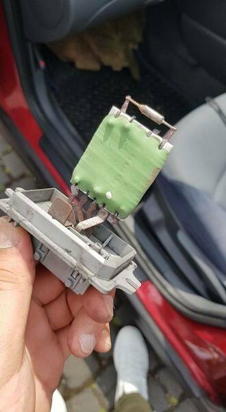

when you decide just to take a look at your heater resistor to see what it looks like and check for wiring damage
wiring is fine, you have your phone on with the ebay page for a resistor open that you are sure is the correct one, cos you know it seems the common one
haha
cos french
221803781_348719643373272_3980046422198836996_n.thumb.jpg.a40eb59d46e3d5bbc583d3eef9cad3bd.jpg
221539731_1010611459737276_1925669990784005968_n.thumb.jpg.968275ec7aca7d7cb88b1f94fe74f6f7.jpg
222559763_353628356132527_4635553542676528476_n.thumb.jpg.768ec6129f674c542f2e7c7bde41dad2.jpg
what in the fuck kinda resistor is this? never seen aything like it before, certainly not what i've seen on other C5s etc
of course, i can't find it for sale anywhere
great

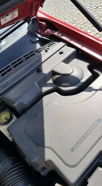

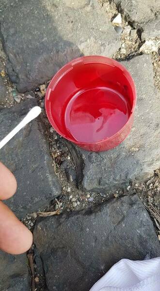

but in other news my package arrived today
tomorrow should be interesting then!
correct fluid of course

great
It's a giant resistor bank that's been bonded in ceramic or something. All the terminals on it will consist of a common, full speed and then the resistor combinations to give you the speeds the dial gives you. You should be able to find a blower resistor for your car but it'll probably look different.
had it in the garage today having a service and trans fluid change
wow
massive difference! not a single rough shift
only time will tell, need to see how it behaves when cold in the morning
24 hour update
it isn't silky silky smooth, it never will be
however, it's indescribeably better!
weirdly much quieter too, only slightly rough when cold, nothing like it was but otherwise once it's done it's first 2 shifts it's fine
