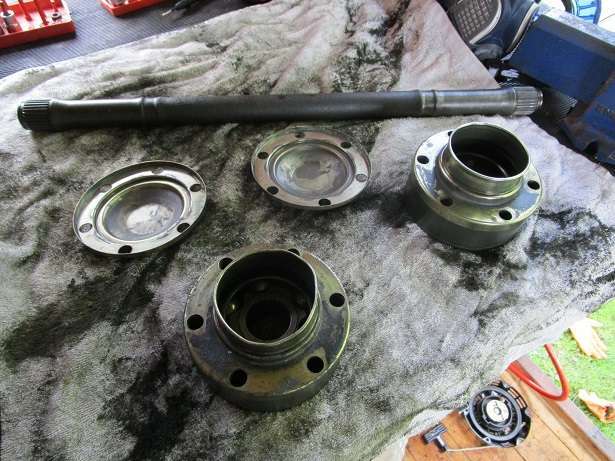

DeLorean: took one of the rear half-shafts out  to change the CV boots. Messy job cleaning all the old grease out.
As you can see, one joint has a damaged mouth where the shaft was allowed to drop down unsupported on one side. I've just clamped the new boot on tight and hoped for the best as I didn't want to replace an otherwise serviceable joint.
Upgraded the hardware, too; the original bolt is on the right and leaves no room to actually get a socket on past the CV boot.

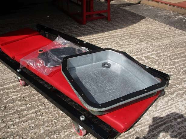

Transmission service on the Mustang today. Just like the LTD, there's no drain plug. Just like the LTD, there was plenty of spillage.
Previous service used silicon sealant which had to be scrapped off. Plenty of wear material in the sump, too. No chunks, just really fine silt. Everything cleaned up nicely though.

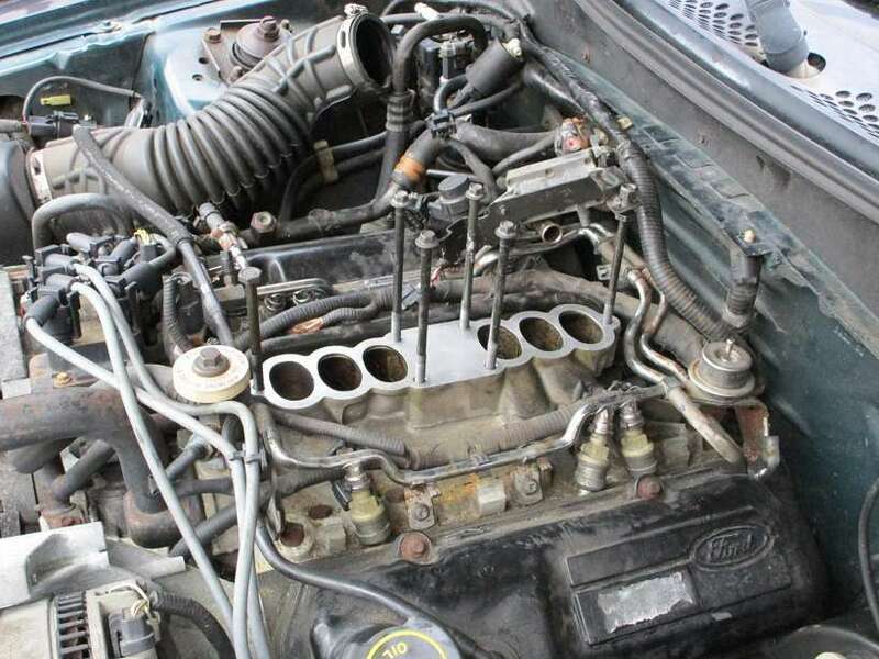

The car came with incorrect injectors installed which caused it to run slightly rich.  Not badly - it passed MoT inspection. I was given a set of known good OEM injectors by the seller though, so thought I may as well change 'em over. Tore the intake gasket during removal. Surfaces prepped and new gasket ordered.

Intake manifold is back on the mustang. New exhaust hangers and diff oil, too.

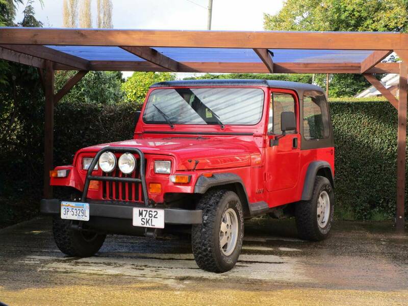

Right, enough lip quivering. The sacrifice wasn't in vain as the sale facilitated me getting another car off my buck-list. Meet my new Jeep Wranlger YJ!
Started tinkering with the Jeep today. Here's what we're dealing with; it's the base model 2.5 ltr 4 cylinder.
I replaced the rust-water it had for actual coolant as I didn't want it going through winter with inadequate protection. From the state of the stuff coming out, I knew I should have flushed it, but couldn't be bothered as I didn't have enough empty containers to put it in. Well, pretty sure I've wasted the new coolant as it turned murky straight away, so that will need changing again soon. I think the thermostat needs changing anyway as top hose never got hot, just warm. Oh, and I'm not a fan of the inline temp sensor put in the top hose either, so I'll probably ditch that.
Also, suctioned out the power steering reservoir and replaced the fluid with new.

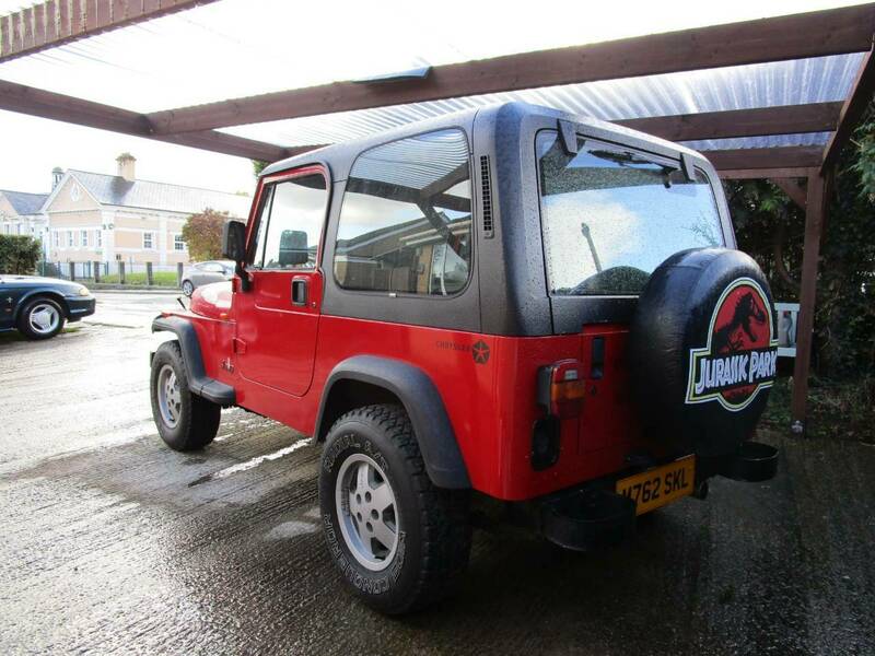

Next up, I removed the front bull bar and installed more Jurassic Park appropriate bumper mounted caged fog lights. I've not wired them up yet, just installed them as a test fit. Also removed the American plate on the front bumper. It's a UK car from new, so I'm not sure what significance it has. I've hung it up in the garage instead of binning it.
Round the back, I removed the steel spare wheel and put the matching Mopar/Chrysler alloy on. The tyre was fucked and had water sloshing around in it, so I drilled some holes in the bottom to let it drain out. All the tyres are perished and need replacing.

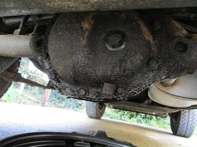

Long-term leak on the Jeep's rear diff. Luckily still had oil in it.
Scrubbed the cover with a wire brush and petrol, then a quick coat of paint.
Re-installed with a new gasket and oil. No more leak!

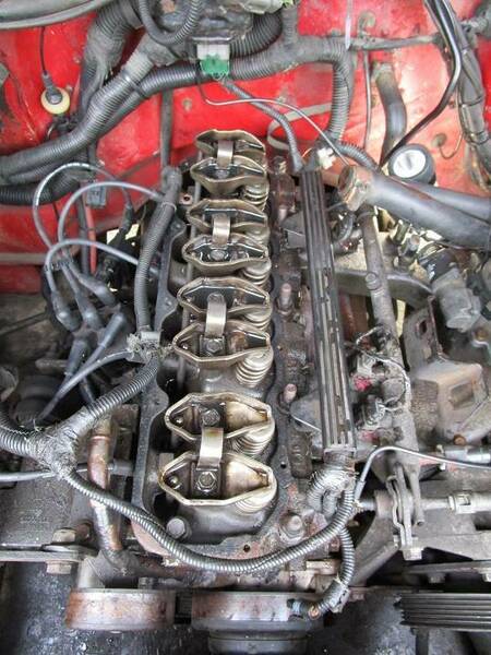

Next leak was the rocker cover gasket*.
Turns out, there was no gasket, just silicon sealant...
The sealant didn't adhere very well which made it easy to scrape off. Reinstalled with a new gasket (which came free with the car - bonus).

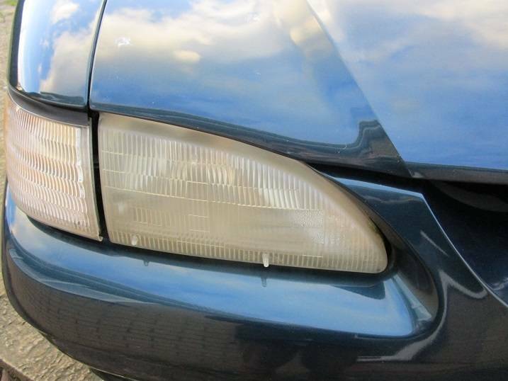

Headlights on the Mustang are ineffective for such modern* car. I tried one of those headlight restorer kits. It worked alright, certainly got all the yellow haze out of the plastic. The headlight units condensate inside which doesn't help. I'll know more when I take it for another night drive.
